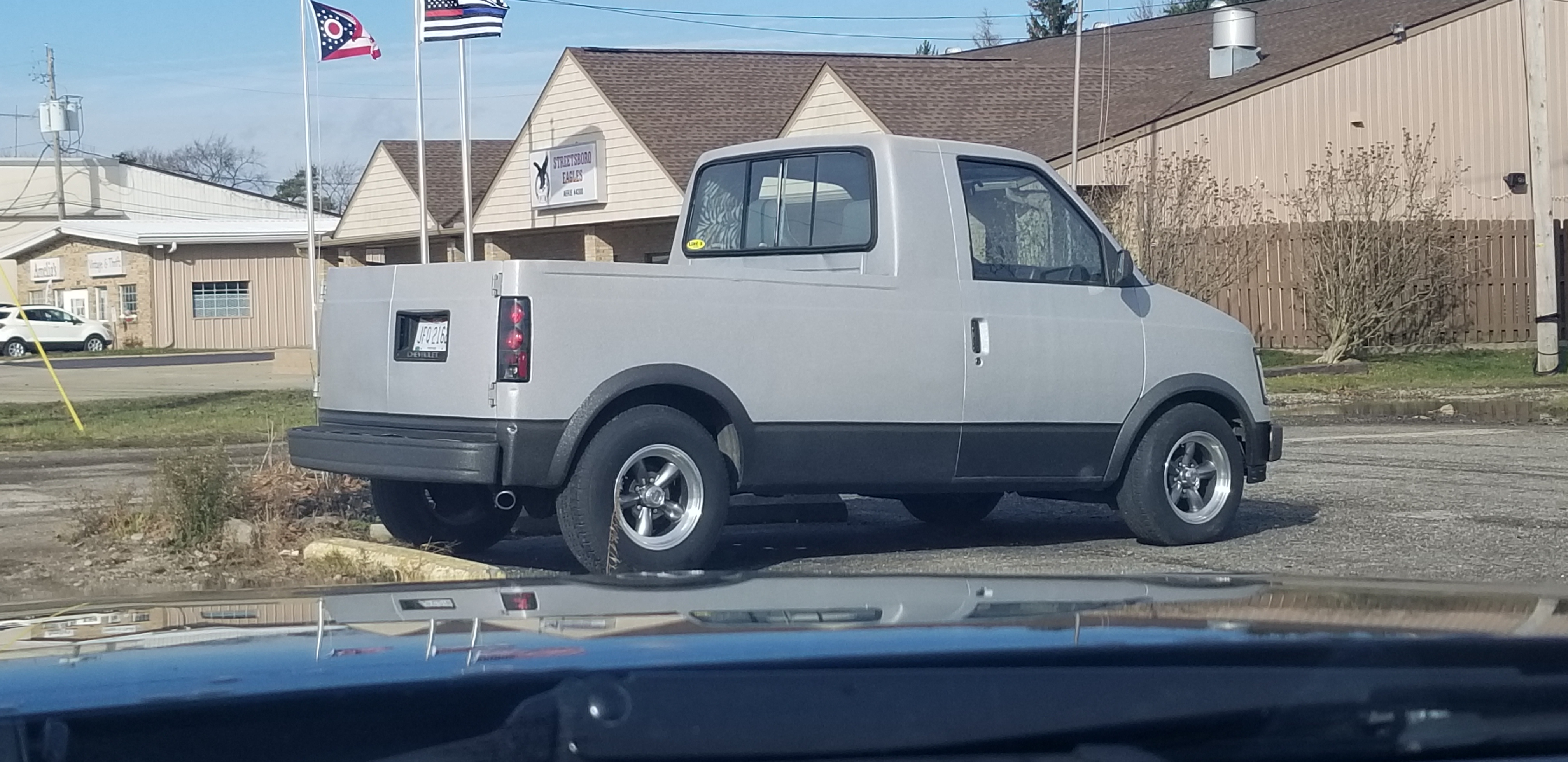

I saw these on my adventure to Streetsboro. I was talking to BP on the phone, and was literally saying the word shitbox right before I saw the Fiesta and just started laughing.
Re: 2014 Ford F-150
"Wadaya lookin' at?"
