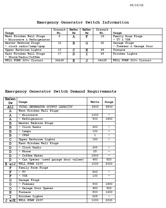

Switch Panel
Switch Panel
Doc tells me what is on which switch and loads.
I've watched the meters and have never been close to an overload situation.
I've serviced my generator and do run it every few months.
