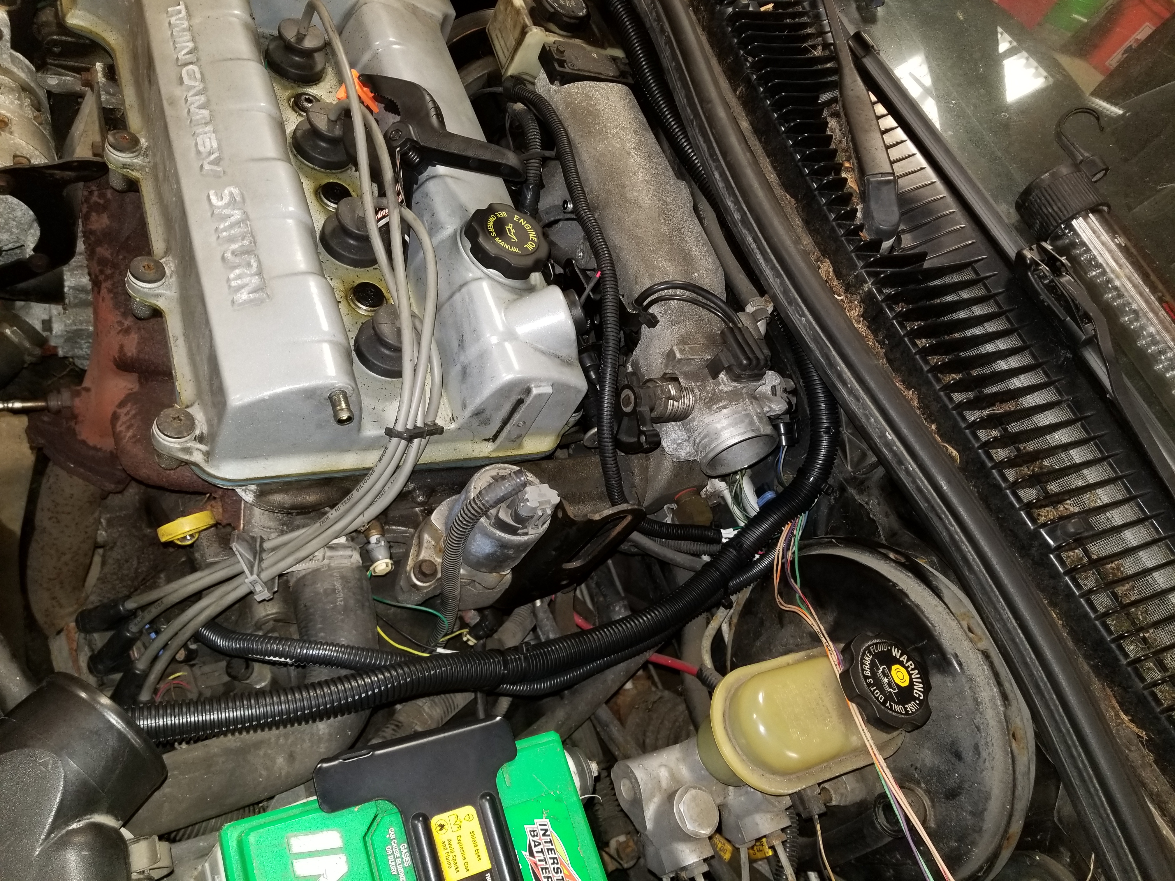

Today, I drilled a 2" hole in the passenger floor board. I fed the wire bundle down through the hole and up into the engine compartment and started laying out the wires where I want them to go. I got the injector harness done, the main ground, the tach signal from the Saturn ignition-control-module. I was able to temporarily jump power to it, I cranked the engine over and the Megasquirt registered cranking RPM. Woo hoo! That's an important hurdle crossed.
Despite having the car for a year, and having it up on the lift before, I never noticed the two (!!) holes in the transmission. Andy had told me there was a clutch or driveline issue that might need attention before trying to drive this on the street, but didn't think it was this bad..
In the mean time, I found a good deal on a used MS2 3.57 box. This is essentially the same thing I use in the Chevelle. I bought a 12' wiring harness / wire bundle that has the Megasquirt adapter on one end, and just bare wire on the end. I'm cutting/splicing/soldering connectors as needed. It's a complete standalone harness that once it passes proof of concept will get transferred over to the racecar.

Ho hum, just another hole. But, the picture of your wiring harness looks like a sweet start.
When you have a chance, more pictures and maybe a starting video. Grins.

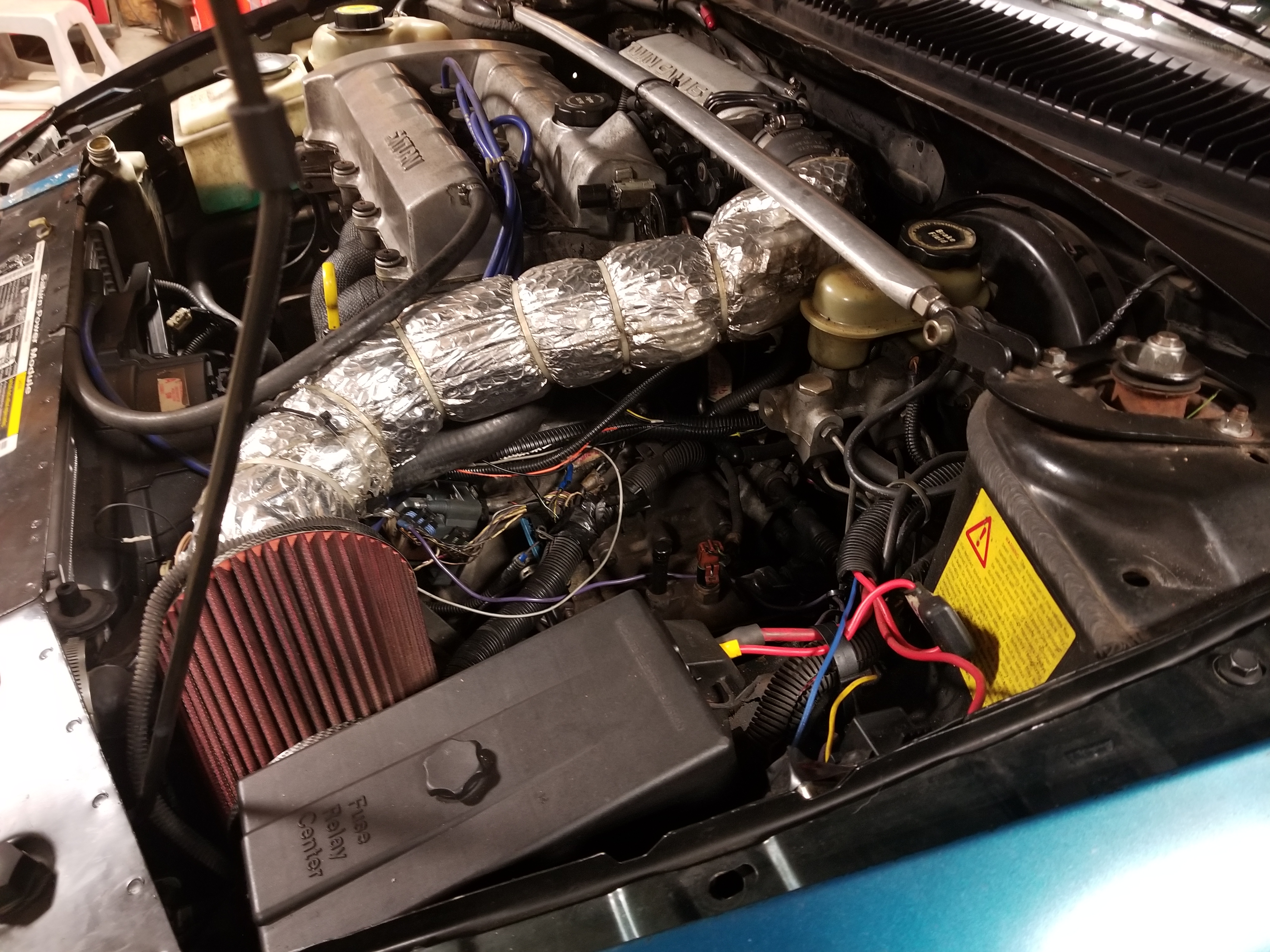

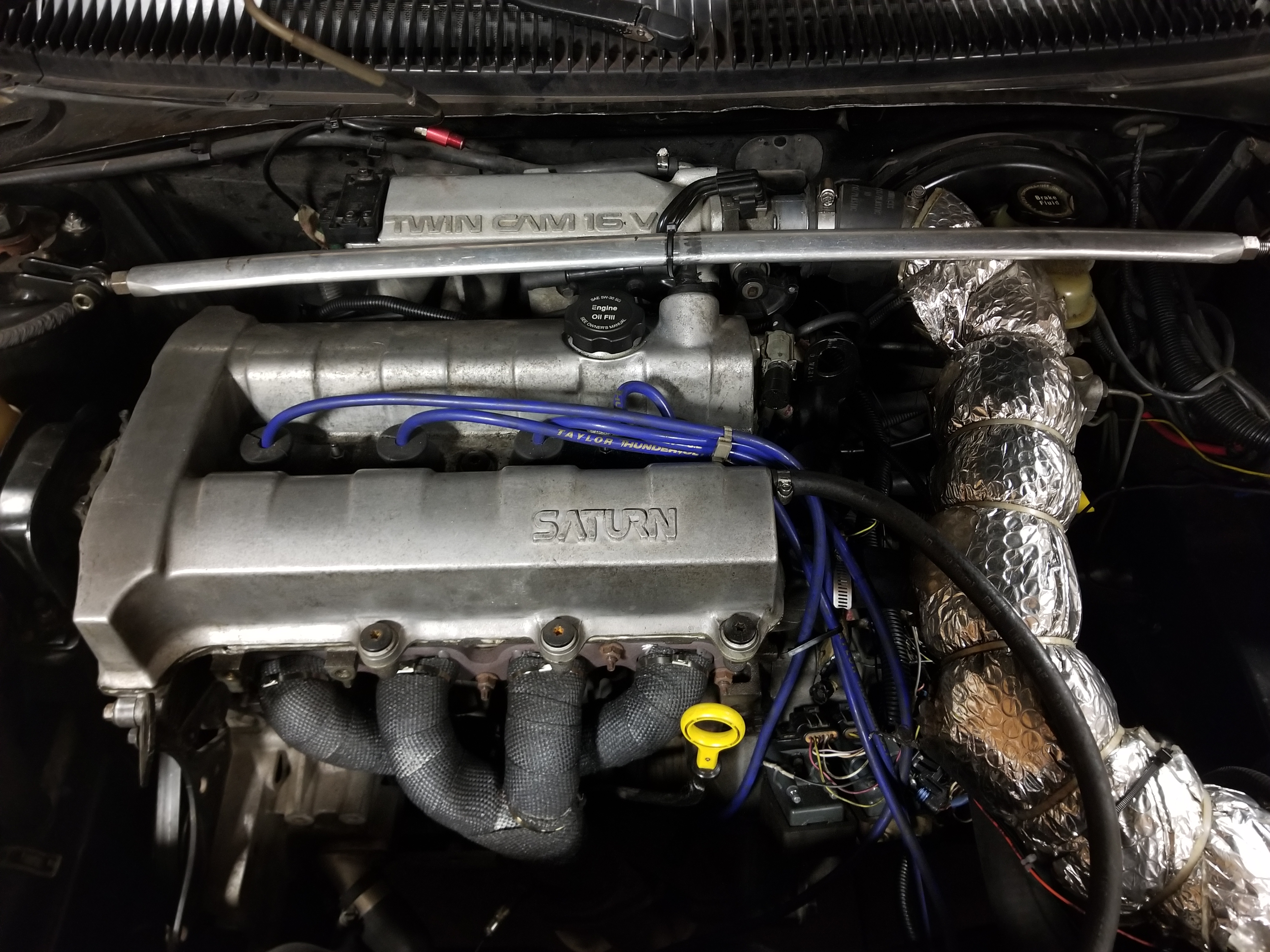

It runs!
I'm still waiting to get a couple pieces, but I was able to connect enough stuff together to make it start. Started right up, no issues! I've been wanting to do this for a long time, so this was pretty satisfying.

Successful first test drive!
I first started it in the garage and raised the front wheels off the ground. I was able to put it in 4th and just apply a little throttle and brake to let it do a little bit of learning. After this, I set it down and took it for the first drive around the block. After that I got a little more adventurous and went up Wilson Mills, 306, Mulberry, East Hill and back home. I have one small issue to work out where it wants to stall when coming to stop and clutching in. Just a tuning issue, I've seen others post about it. Other than that, just fine tuning to be done.
Other than the minor issue, I'm pretty confident I could drive it back to MostMint central at this point. Not saying it's perfect, but certainly drivable.

So, I guess I'm due for a little update here. I got the tach working. There was an extra wire on the IgnCtrlModule.
I have all the external wiring completed for the knock sensor. I still have to build a small circuit board for inside the case.
