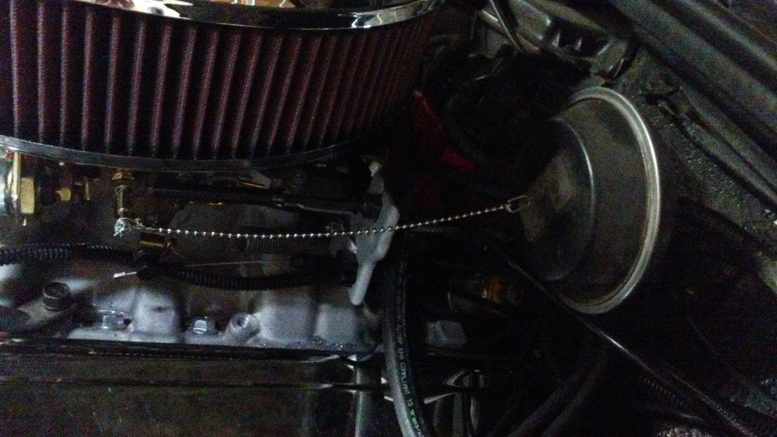

Still in search of bracket(s) to mount the cruise control servo. This is the non-cruise throttle cable bracket currently on the Edelbrock manifold, where it only used one carb mount stud. To stabilize it, I added a piece tacked on to the bracket and also bolted to the intake.

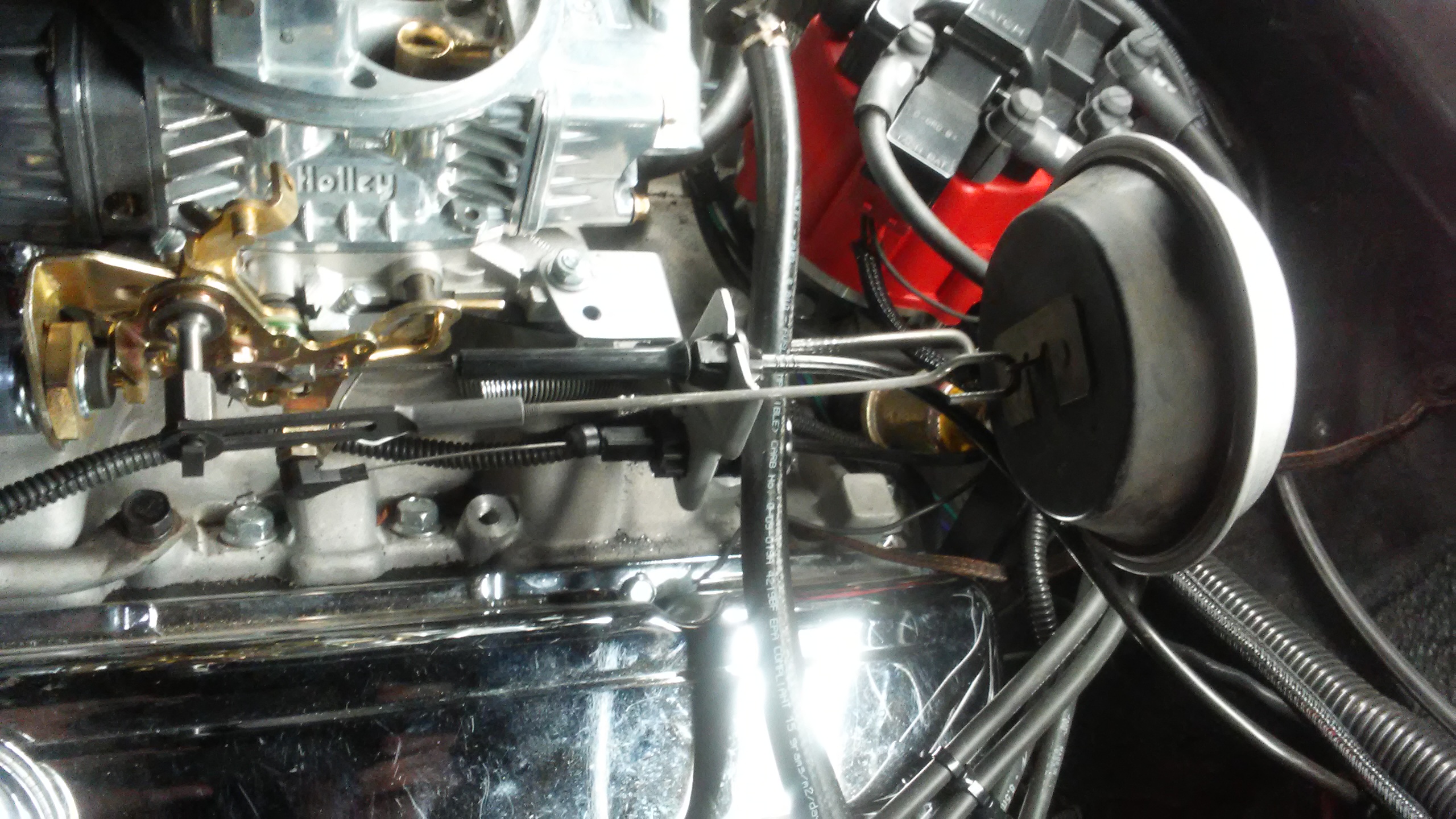

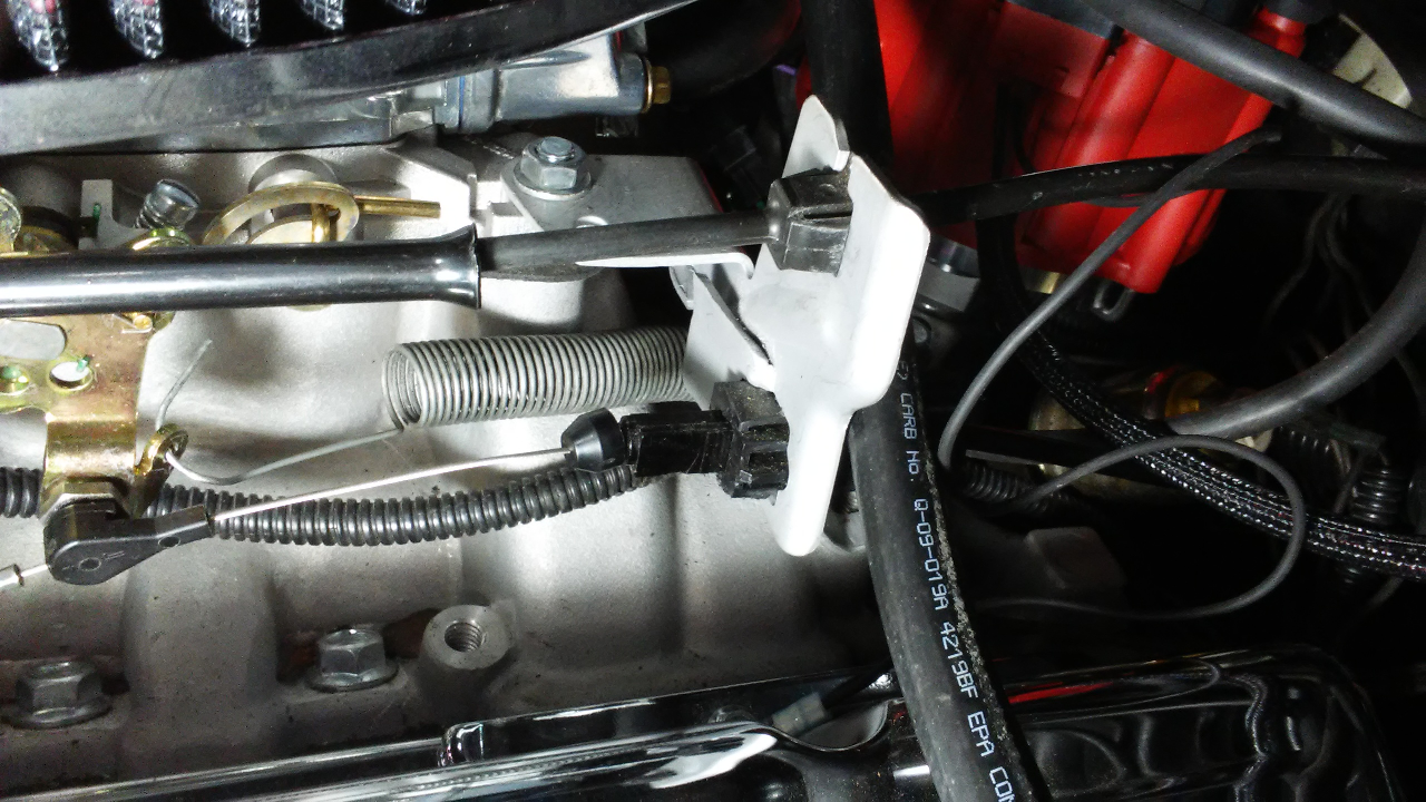

After searching unsuccessfully for a second bracket that would stabilize the one servo bracket I have, I decided to improvise. Bent one end of a 1/4" steel rod 90*, threaded the bent end to screw into the welded-on nut on the bracket, threaded the other end, drilled a 9/32" hole in the throttle bracket end to receive the rod, and the bracket is secured.
Everything lines up nicely EXCEPT, at full throttle the servo is being pushed. There's a slot in the rod end that I'm sure is supposed to allow the throttle to be fully opened without pushing on the servo.
Looks like I'll have to enlarge a hole on the carb throttle lever to mount the rod end with a shorter radius and less throw. Maybe first I'll get the transducer installed and wired, run the vacuum lines and see if it all works.

Holley sells this stud to mount both the throttle cable and the cruise control rod on the same hole in the throttle lever.Everything lines up nicely EXCEPT, at full throttle the servo is being pushed. There's a slot in the rod end that I'm sure is supposed to allow the throttle to be fully opened without pushing on the servo.
https://www.amazon.com/Holley-20-36-Car ... lley+20-36
That will shorten the pull for the cruise rod. Ordered from Amazon.

Got the cruise transducer mounted, wired and vacuum lines connected. Put it up on jack stands in the garage to test it. Cruise was functioning
but with binary (well, not quite) throttle control.
RPMs bounced between 10K and 20K.
Thought maybe throttle control would function better with a load so took it for a test drive. Still surges too much to be useful. Maybe too much slack in the pull chain?
Surely it has to have some slack. I'll have to see what diagnostic info is available in the shop manual and on the Internet.

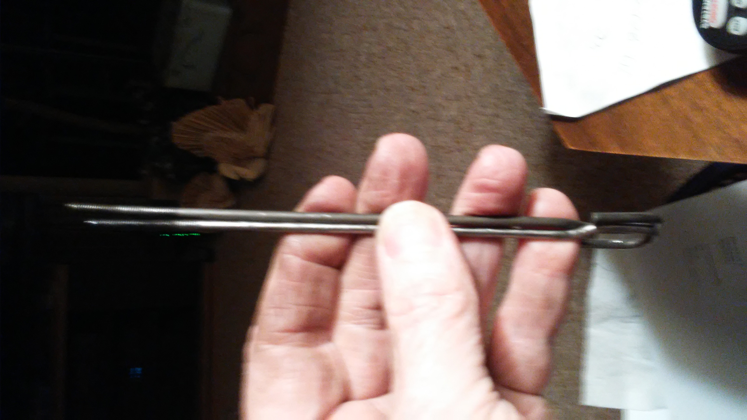

Got another original pull for the servo from a guy on the EC forum. It's 1/4" shorter than the one I had.
That turns out to be the right length so no shortening of a rod is necessary.
