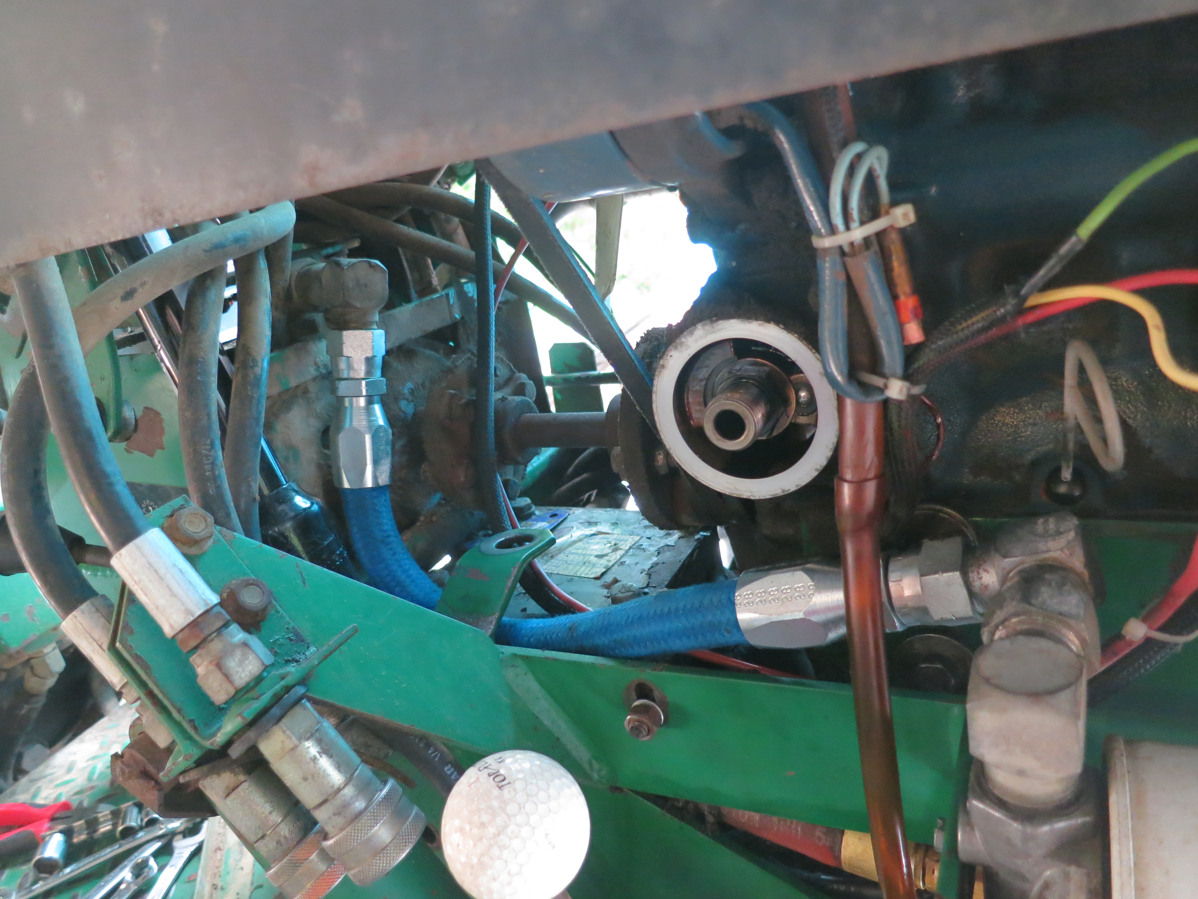

I spent most of the day today working on Gladys. I had to remove the radiator to get to the other end of the kinked hose. It was not a trivial job. It's amazing how good the antifreeze in the cooling system looked after 18+ years of neglect. It was still clear and green.
When I was able to put a wrench on the other end of the kinked hydraulic hose, I found that it was loose. It was just a bit more than hand tight!! I took it down to a local hydraulic place and had a new one made which is 1.5 inches longer. Sixy five dollars later, the new, blue, hose looks great in it's place.
It just keeps gettin' better.

If you keep on doing this type of work, I can get you a job at a rental store! The blue hose
looks good. Make sure that it isn't touching the bracket that is by it. If it does, the vibration
from the motor will cause the hose to wear and it will blow out there. The cool thing about
those hydraulic lines is that they can be positioned by putting a bit of torque on the hose.
Loosen up the nut that is connected to the fitting on the machine. Put a wrench on the inner
nut and move the hose to a position where it won't touch any framework, then tighten down
the fitting and it will maintain its position of not rubbing the frame.

GM, after I took that picture, I discovered that little positioning technique you just described. The hose is now positioned away from anything that would cause it harm.

I'm glad you fixed it. I'm like the hose-Nazi at work... a hose rubbing steel is just a ticking
time bomb! Good work!
