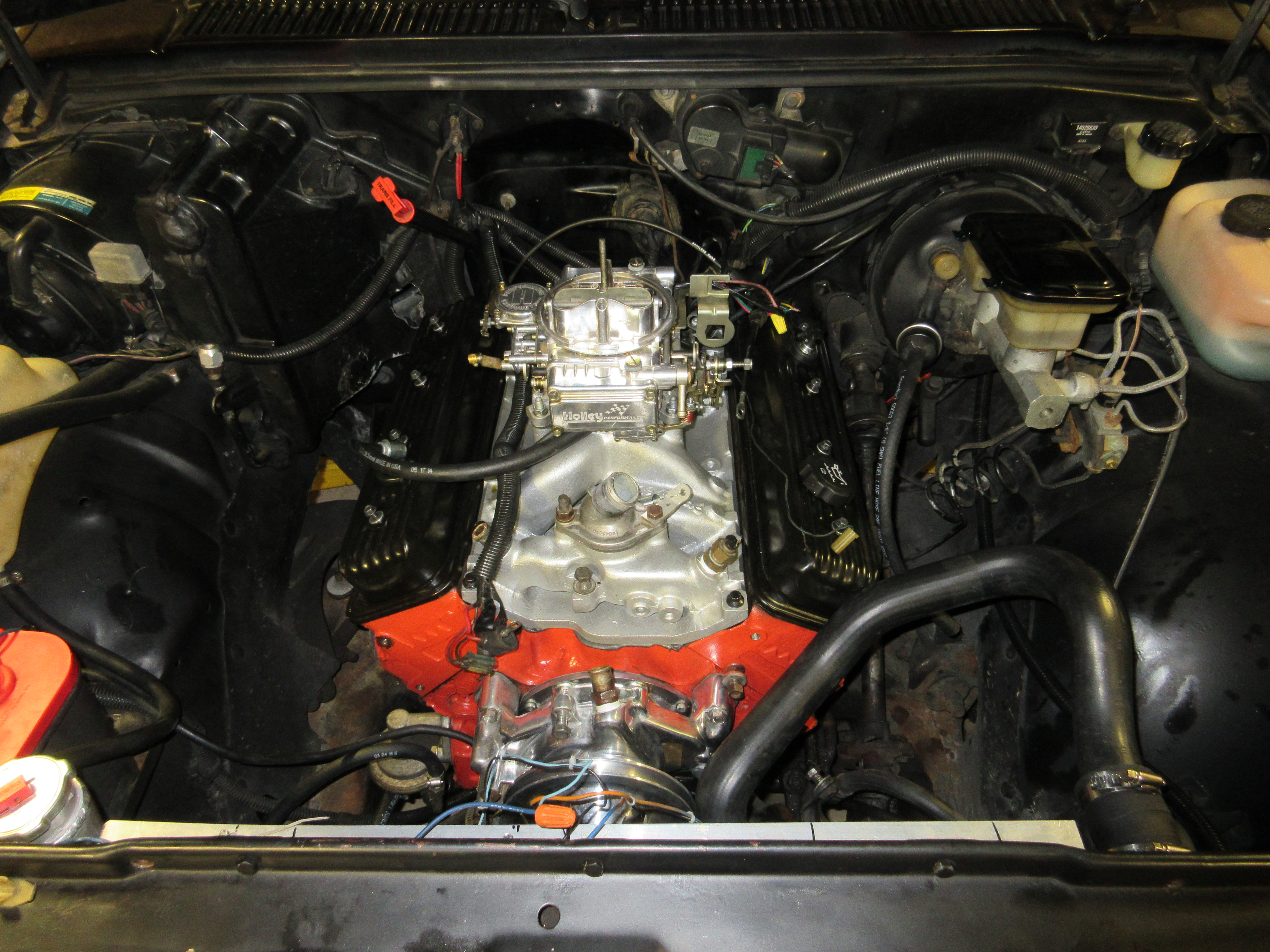

Got a late start tonight -- didn't get out of work till 6:30, went to Summit and picked up new heads. Got home around 8:45, ate some dinner, helped Gwen move the TV back into the family room, and just as I was about to head outside, my cousin stopped over with his new puppy, Archie. So we hung out for about an hour. I finally made it out to the garage about 11pm.
I got all the major stuff removed short of the heads and intake. The intake is unbolted and ready to be peeled off. The heads still need to be unbolted, but I think that'll go pretty quick.
I think I made an error in order of operation -- I didn't unpack the heads until I was done working, right around 1am and I'd really like to get some paint on them. I should've done that first. Might try and do that first thing in the morning. Paul will be here in a short 7 1/2 hours.
Mmmmm... new heads! Troy's puppy Archie (and my new kitchen flooring!) Engine compartment stripped down -Dave

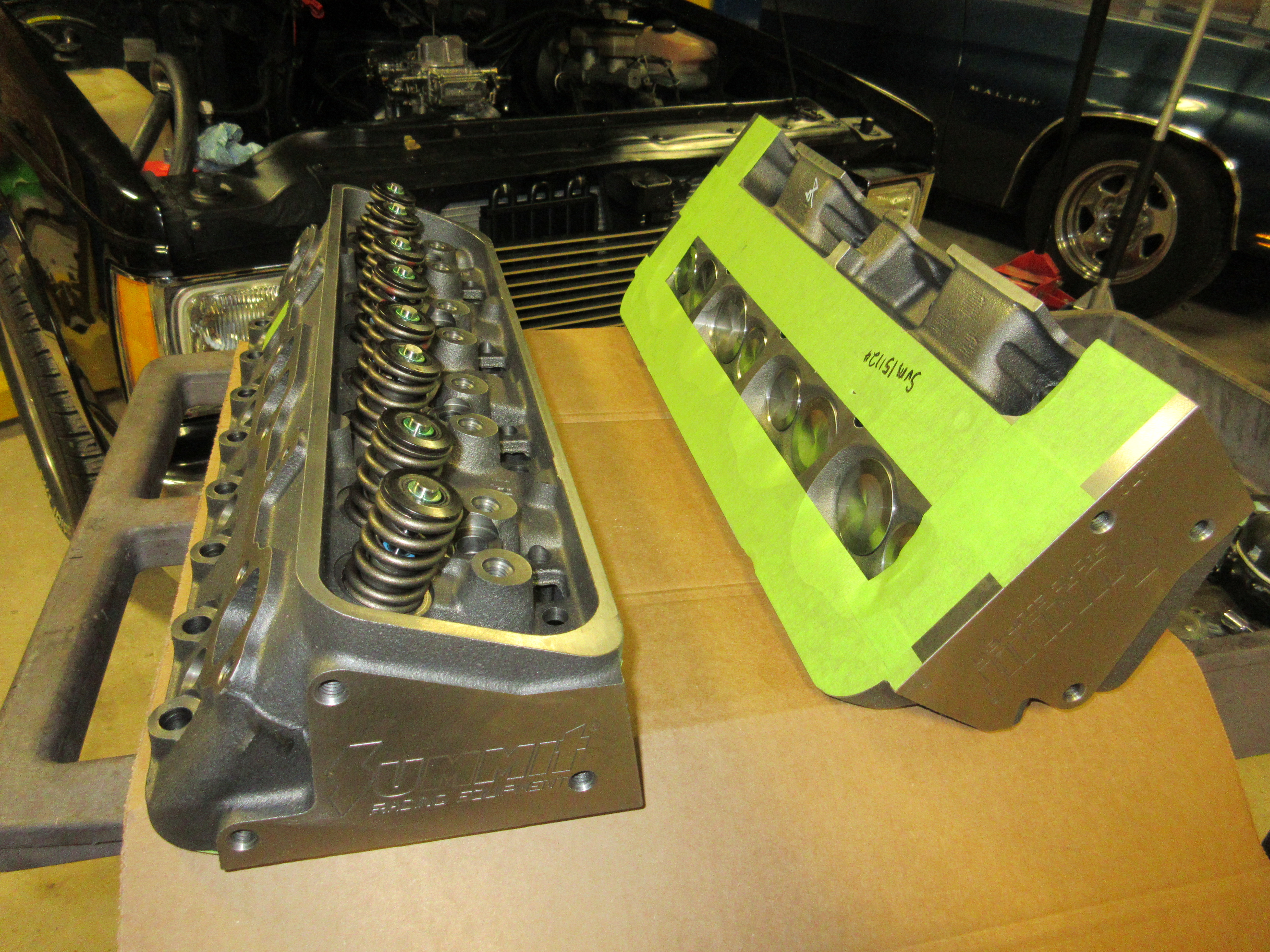

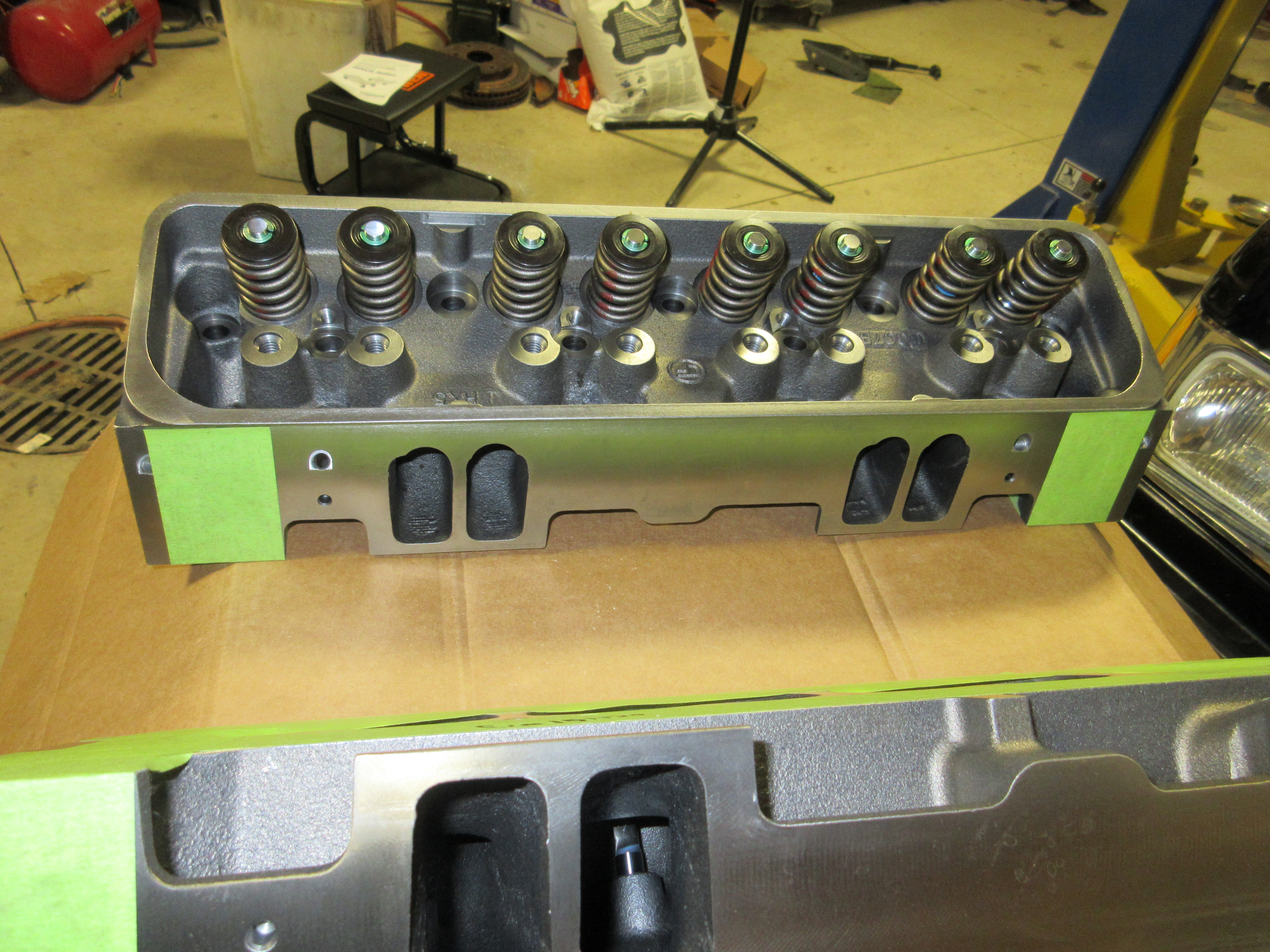

Well it's been a very productive 24 hours at Tiresmoke Central. Paul came over this morning and he taped/painted the new heads while I worked on getting the old heads removed. Had to disconnect the steering shaft to get at a couple rear head bolts on the drivers side.
Once the heads were removed, we looked at number 3, and found that the exhaust valve was indeed bent. I was pretty happy to see a definitive problem. After removing it from the head, we chucked it in the drill, and you can easily see the wobble. I looked at #3 from the motor they came off of and didnt see a mark on the piston, so not sure how/when it happened. I dont recall seeing a mark on the Blazer's #3 piston either.
Paul wire-wheeled the head bolts while I scraped the gasket surfaces on the block. We took a quick lunch break and Autozone trip for blue towels and then came back and got the heads bolted on and torqued. It was 2pm by now and Paul headed for home. Thanks again for all the help today!! I went inside for a little bit and ended up crashing on the couch for a few hours.

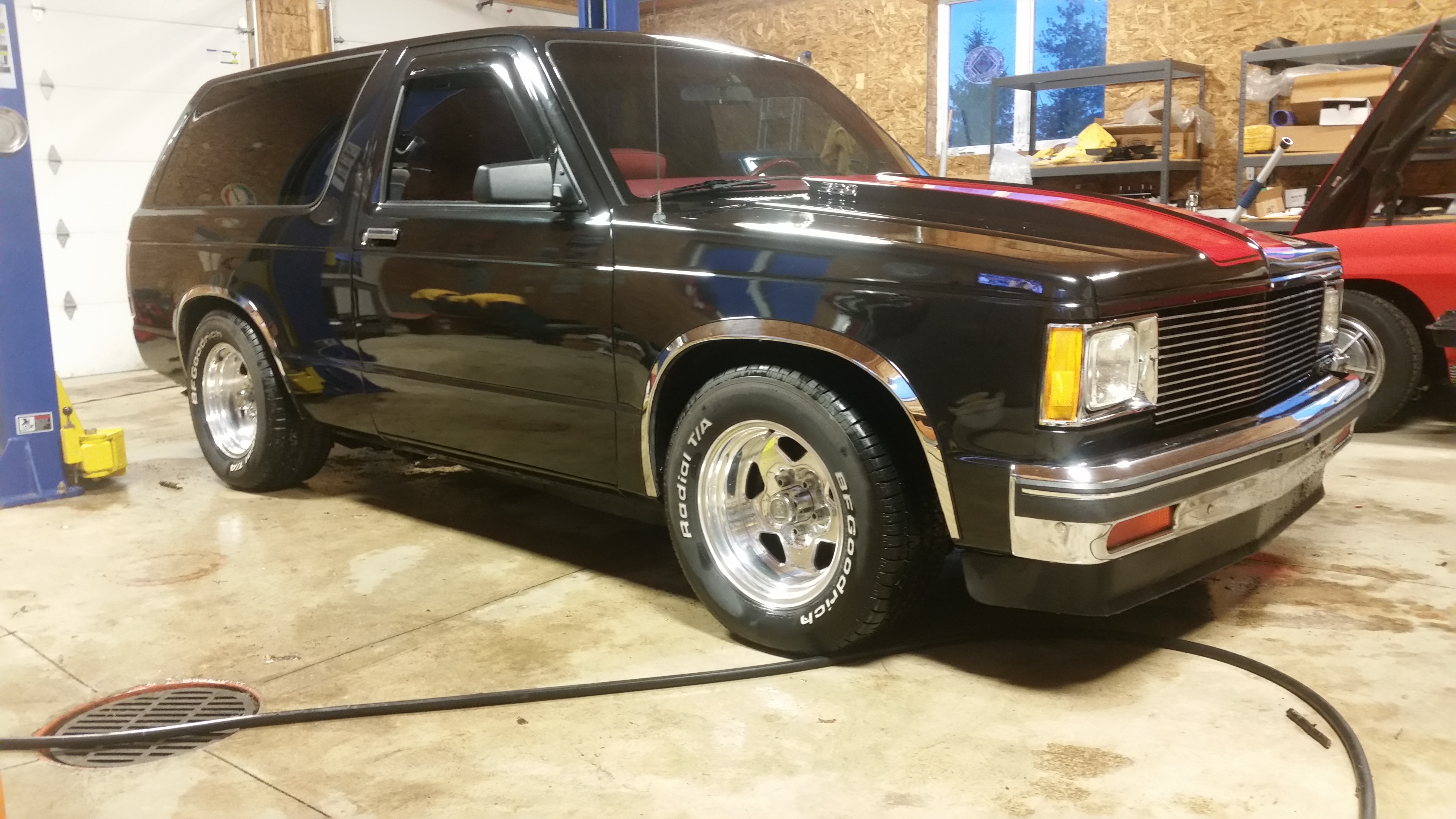

- Posts: 3414
Re: 1985 V8-S10 Blazer
Smoke stopped over yesterday with the Blazer and Holley. The stance after putting the blocks in the rear is awesome! It's low and flat and IMO looks perfect. It sounds pretty sweet too and definitely looks like it's got some kick to it.

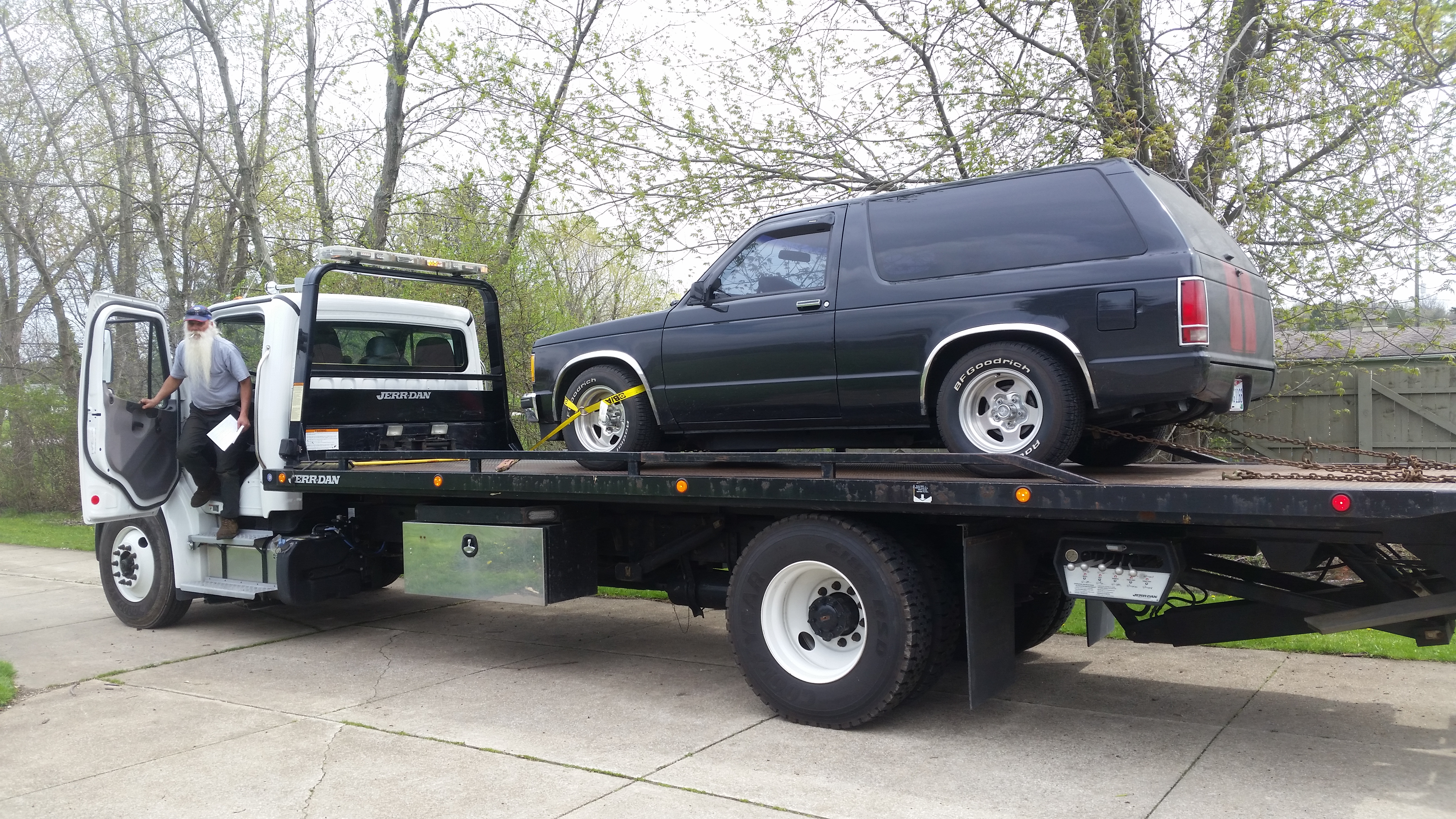

Well, speaking of flat, that's how it came home from my attempted trip to Carlisle -- on a flatbed. About 2.5 hours into the trip, i started hearing a noise from the engine. I got off the turnpike at the nearest exit (PA Rt 31, Donegal), and it didn't sound good. Oil pressure and temp were fine, but definitely a rapping noise near the front of the engine. I pulled both valve covers in the Subway parking lot where I ended up, but couldn't find anything obvious. I figured it was only gonna get worse, so I threw in the towel.
To call it disappointing would be an understatement. I pulled it into the garage, washed & covered it, and pushed it to the back. The Chevelle needs front brakes and an oil change before drag racing. The Corvette needs a rag joint installed, plus it had a running problem the last time I tried to drive it in 2016. Nothing serious, hopefully a dirty carb or worn out points.
To be continued at a later date....
