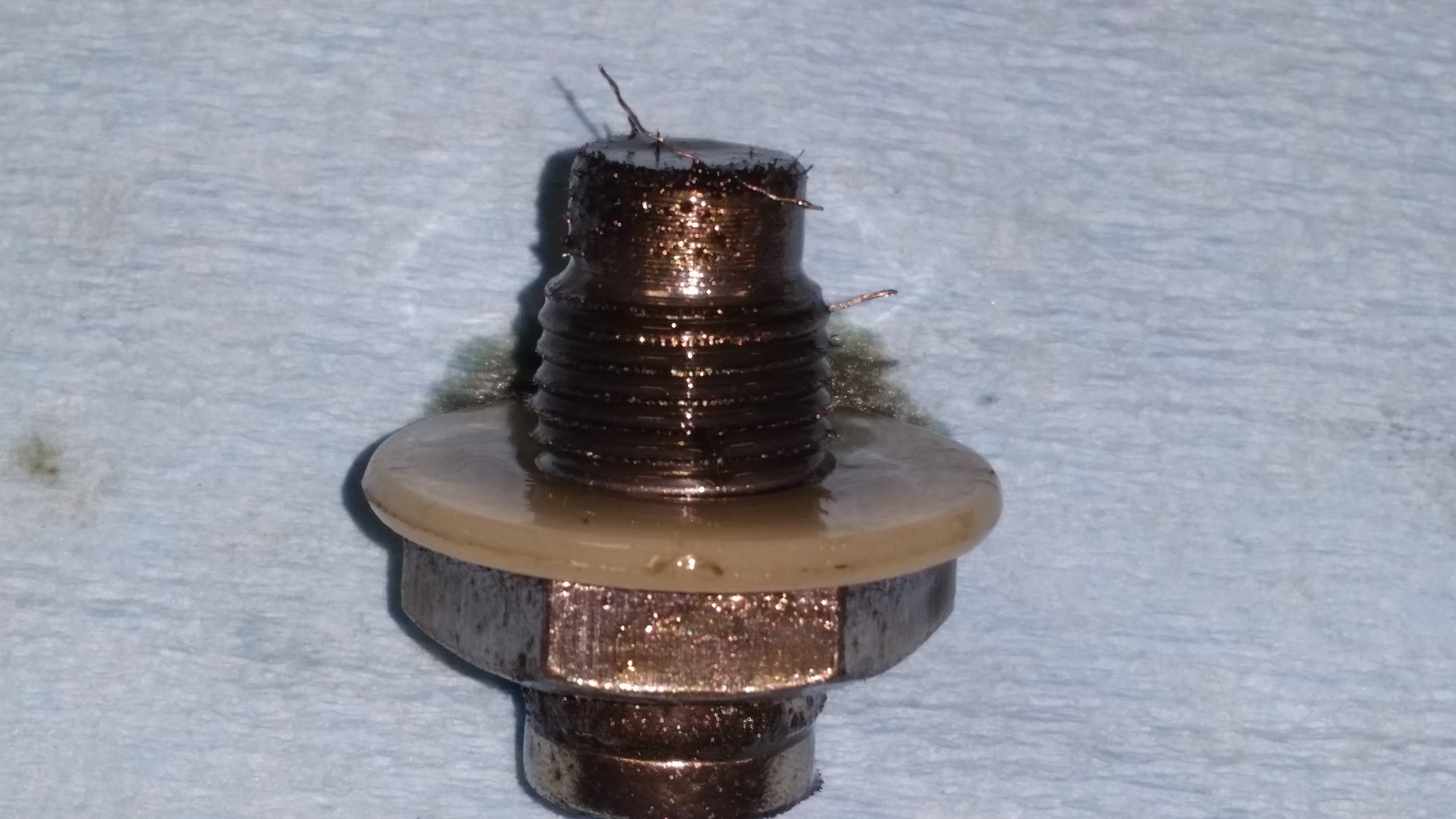

A little bit of debris. Looks like a couple wires from a wire brush?? But overall, not bad? I should cut open the oil filter, but my tin snips aren't getting the job done.
