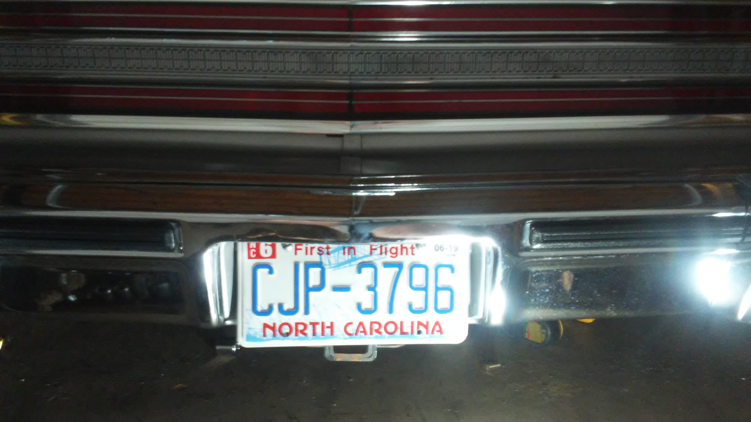

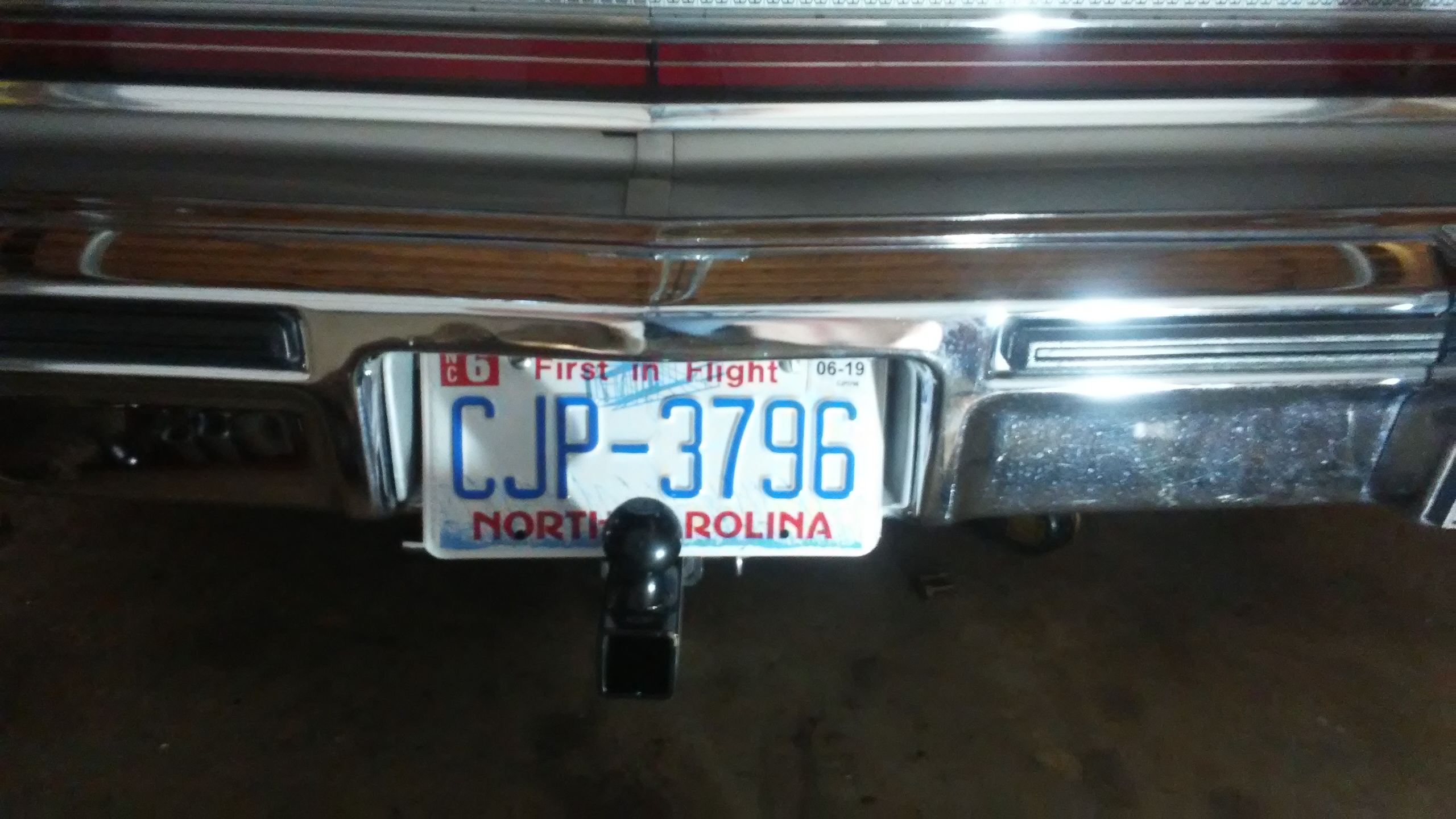

We'll be working on it next week. This week I'm installing a trailer hitch. My 2002 Explorer is having some non-fatal problems but could croak any day. At my age, 80 in March!, I don't think I need to buy another SUV so maybe the trailer behind the Lincoln will do for a while. The hitch has me fantasizing about a cross country trip in the Lincoln with a tiny camper trailer in tow. :D
I got a used, universal hitch for $25 and cut it up to make it work. Took it to a great welding shop in Raleigh that welded it all together for $60. Was able to hide the hitch pretty well.
