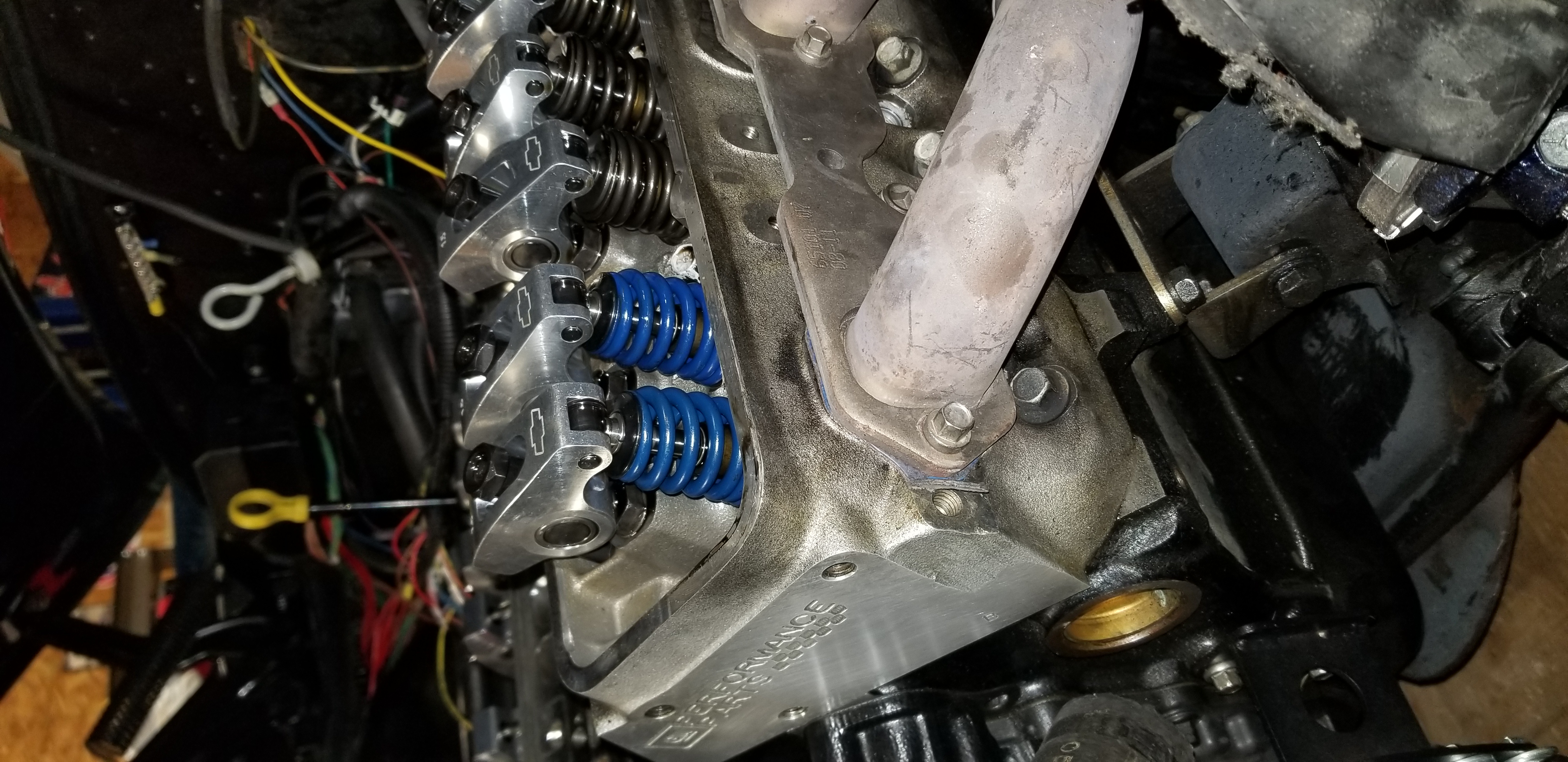

in 2020, so far I will be upgrading to LS6 beehive valve springs and cleaning/painting my intake. (in progress).

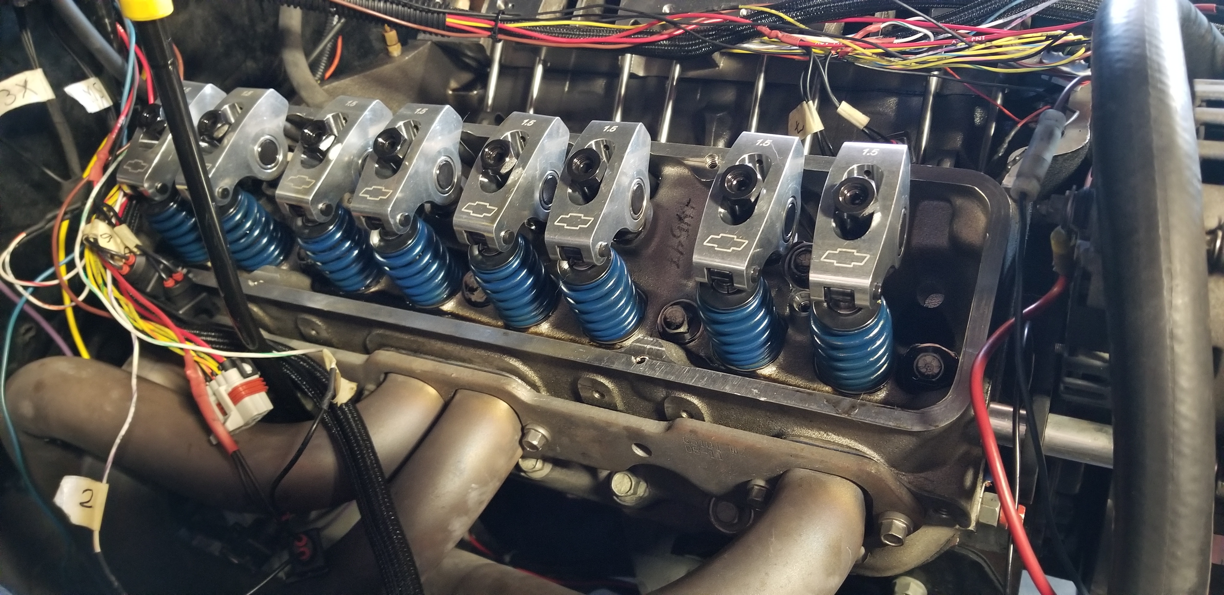

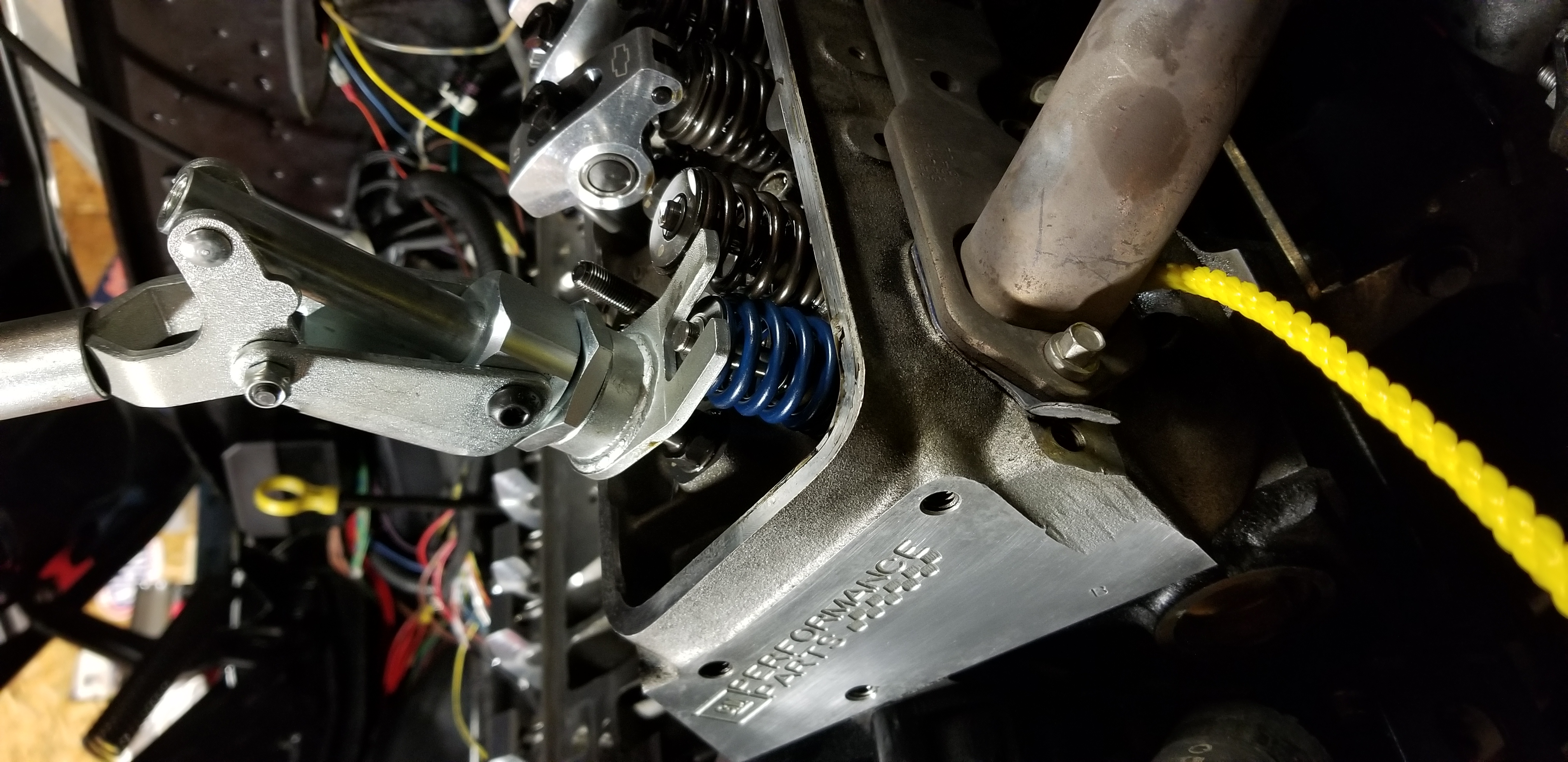

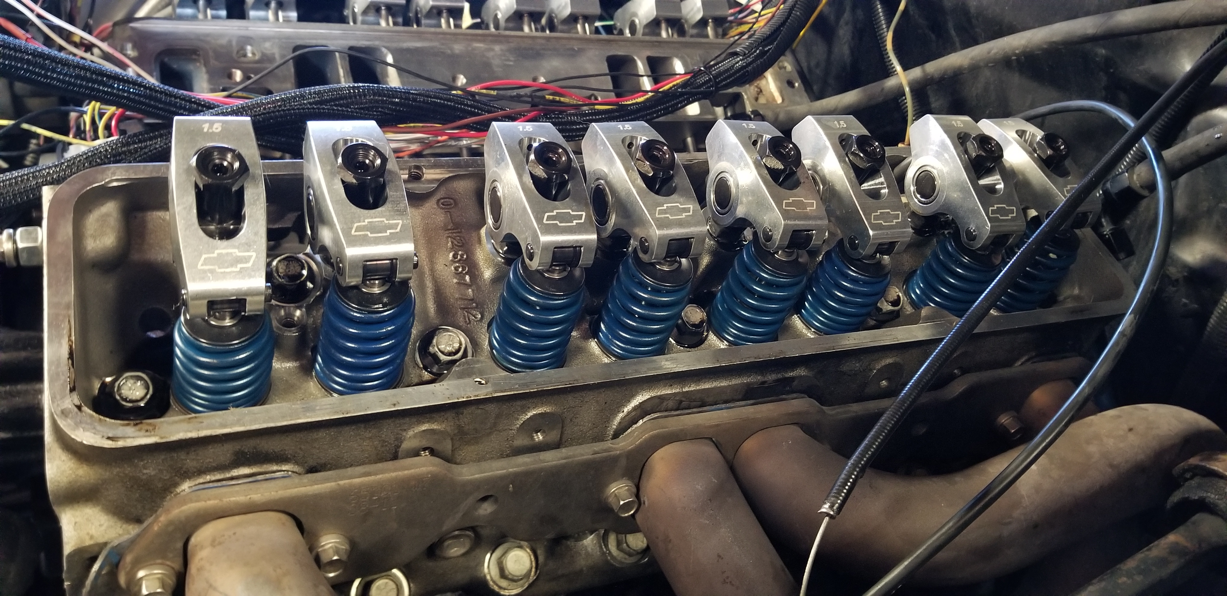

Changing the valve springs seems pretty easy. Bring piston up to TDC, feed some nylon rope into the spark plug hole, then screw the tool onto the rocker stud. Sometimes it's a little tricky getting the keepers in there. But 1 cylinder done, 7 to go. Didn't make any progress today.

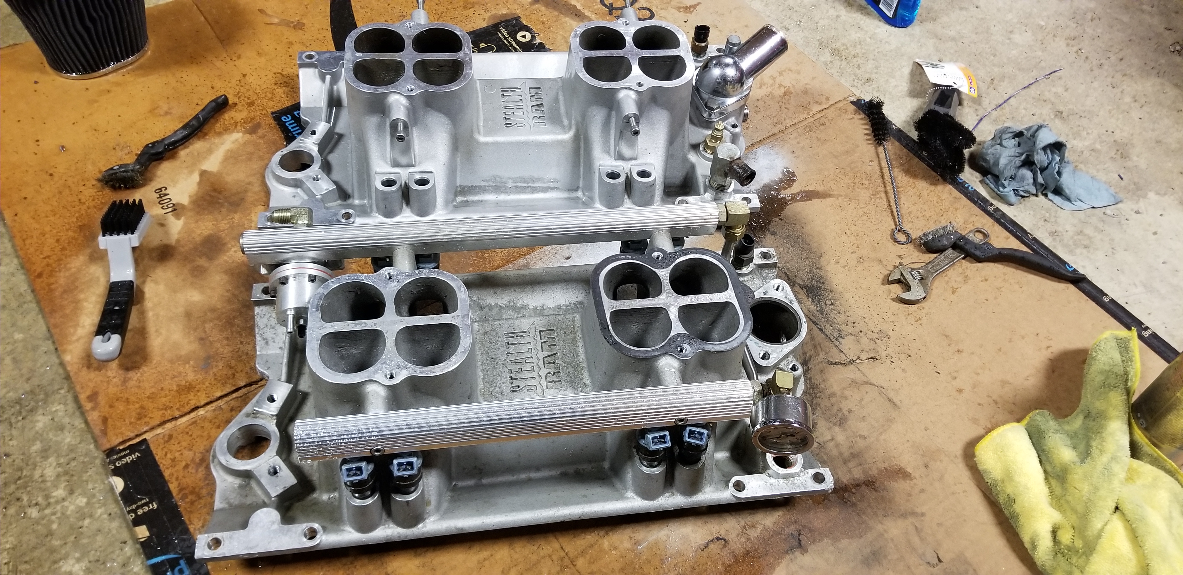

The intake on top is the one that was one the car after I cleaned it. The bottom one is another one I have that was noticeably cleaner than the one on the car had been. I was originally going to just clean it and then clear-coat it. But the dirty marks in the middle won't come out -- tried kerosene, mag wheel cleaner, brake parts cleaner... so I think I'm going to use some aluminum color paint with a matte clear on top. I experimented on one of the plenums (not pictured) and it looks good.

Have you considered getting that thing bead blasted - or maybe with some other material other than sand - to clean that up?
Posts: 2618
Re: Chevelle Upgrades, 2020
I remembered having an intake "glass beaded" (i think) when i was a lot younger and being kinda disappointed with how it looked. Im not even sure where I could get that done now.

The rope trick is pretty interesting. I've had to do a bunch of valve spring work on
my many Oldsmobile's in the past. I always used air pressure to hold the valves
closed.
Posts: 2618
I bought the fitting to use air, but my headers were making that look like more hassle than it'd be worth. I already had the rope, too.
Posts: 3020
I was thinking the rope trick was due to the headers making it difficult to use air.

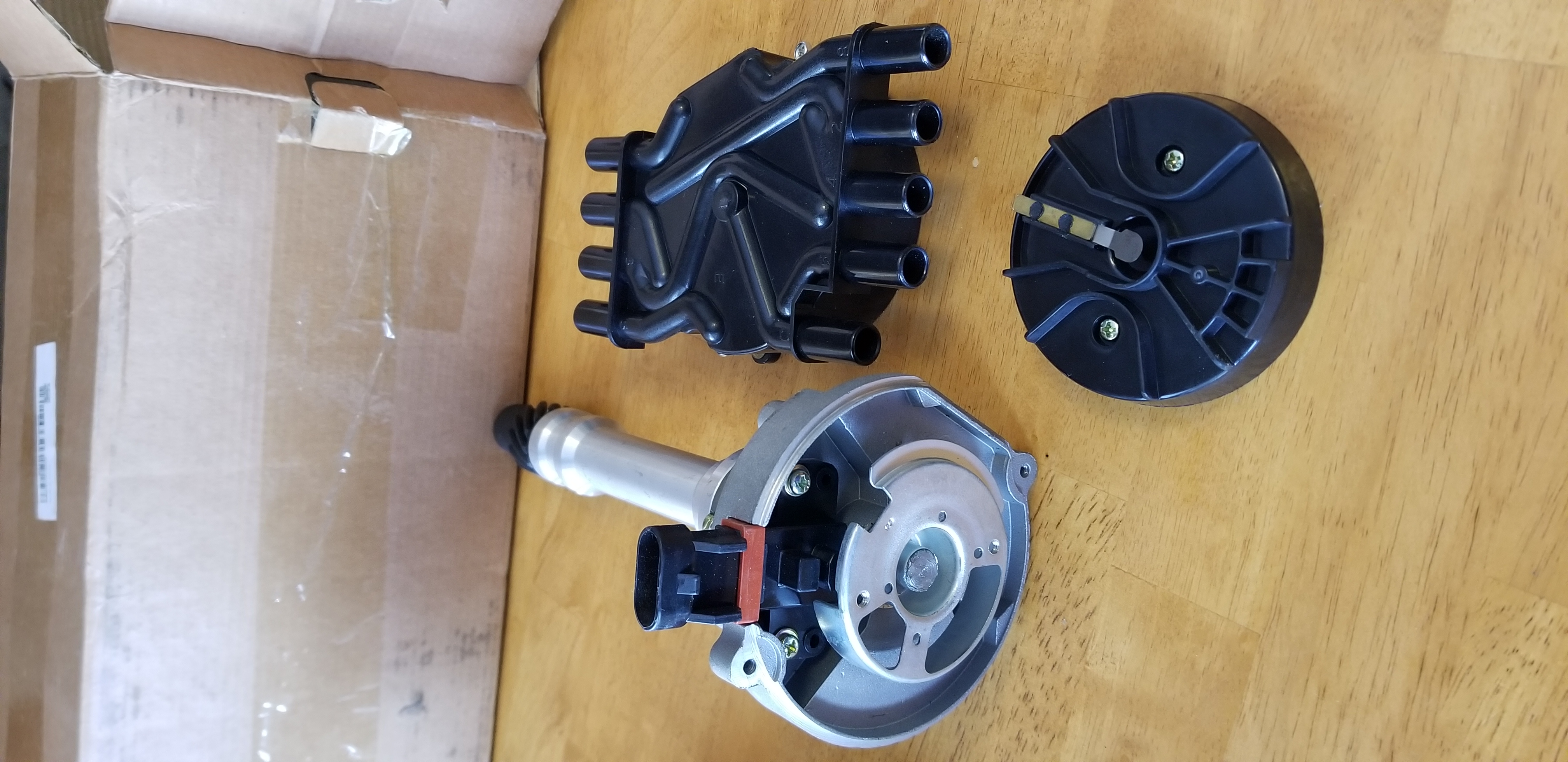

Valve spring swap complete. I got the intake base re-installed too. I'll finish getting it all put back together this week. I will replace the distributor with the cam sensor distributor.

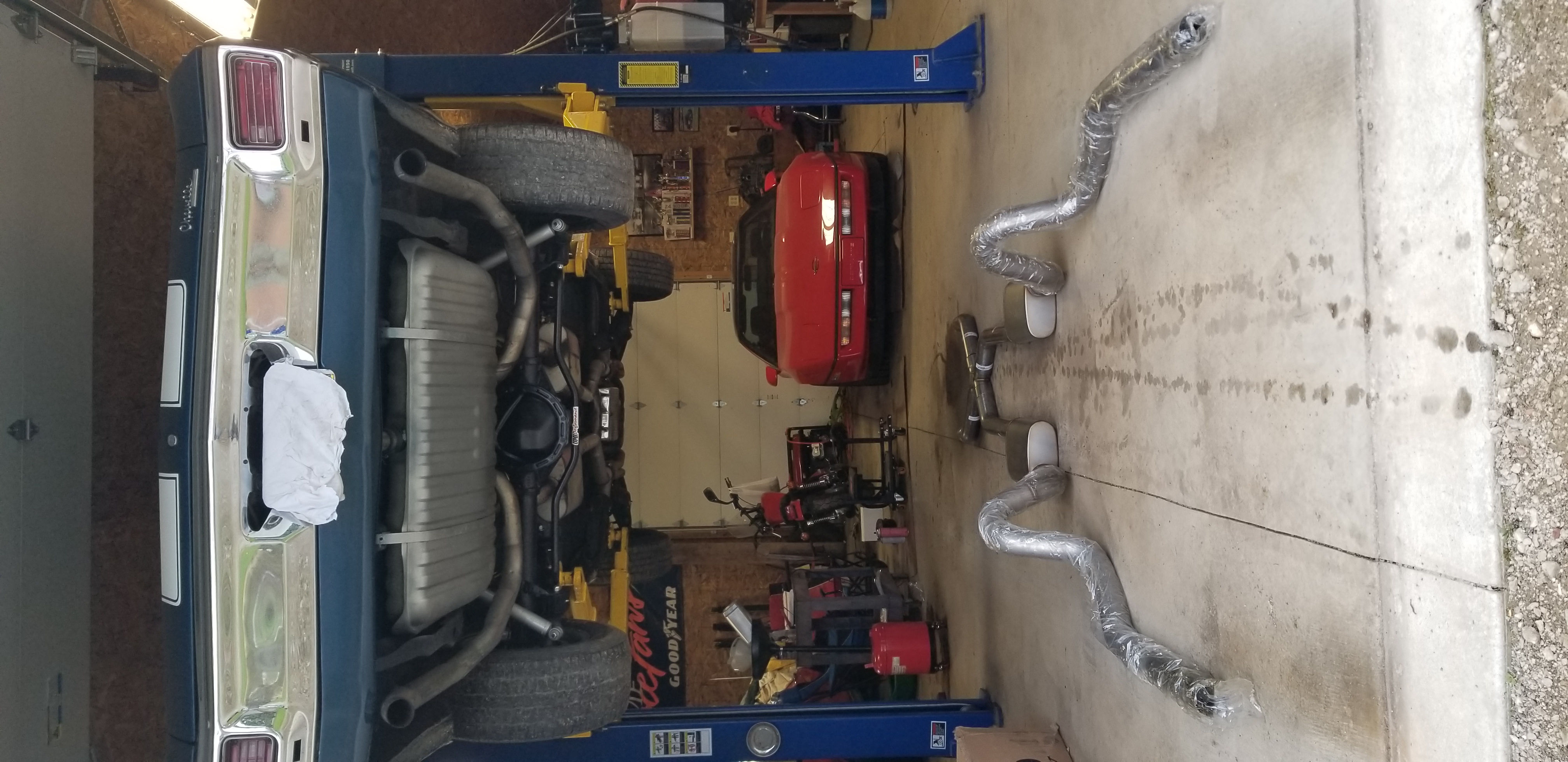

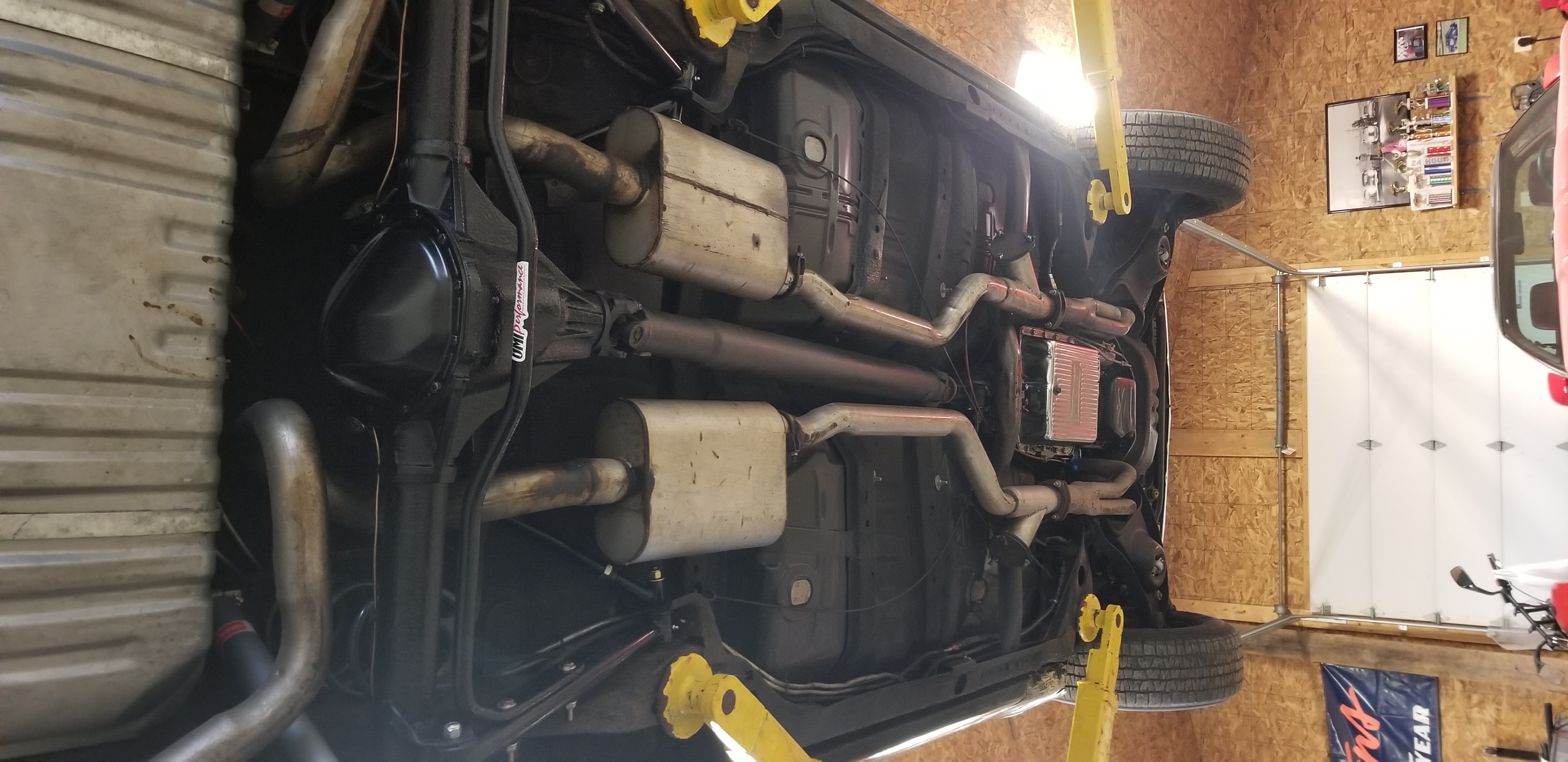

So the smoke out the back is definitely transmission fluid. It is leaking quite profusely out of one of the cooler line fittings by the trans. It seemed to get worse at I tried tightening it a little (not sure I got 1/16 of a turn). As the headers and the exhaust hinder access, it's time for them to come off!

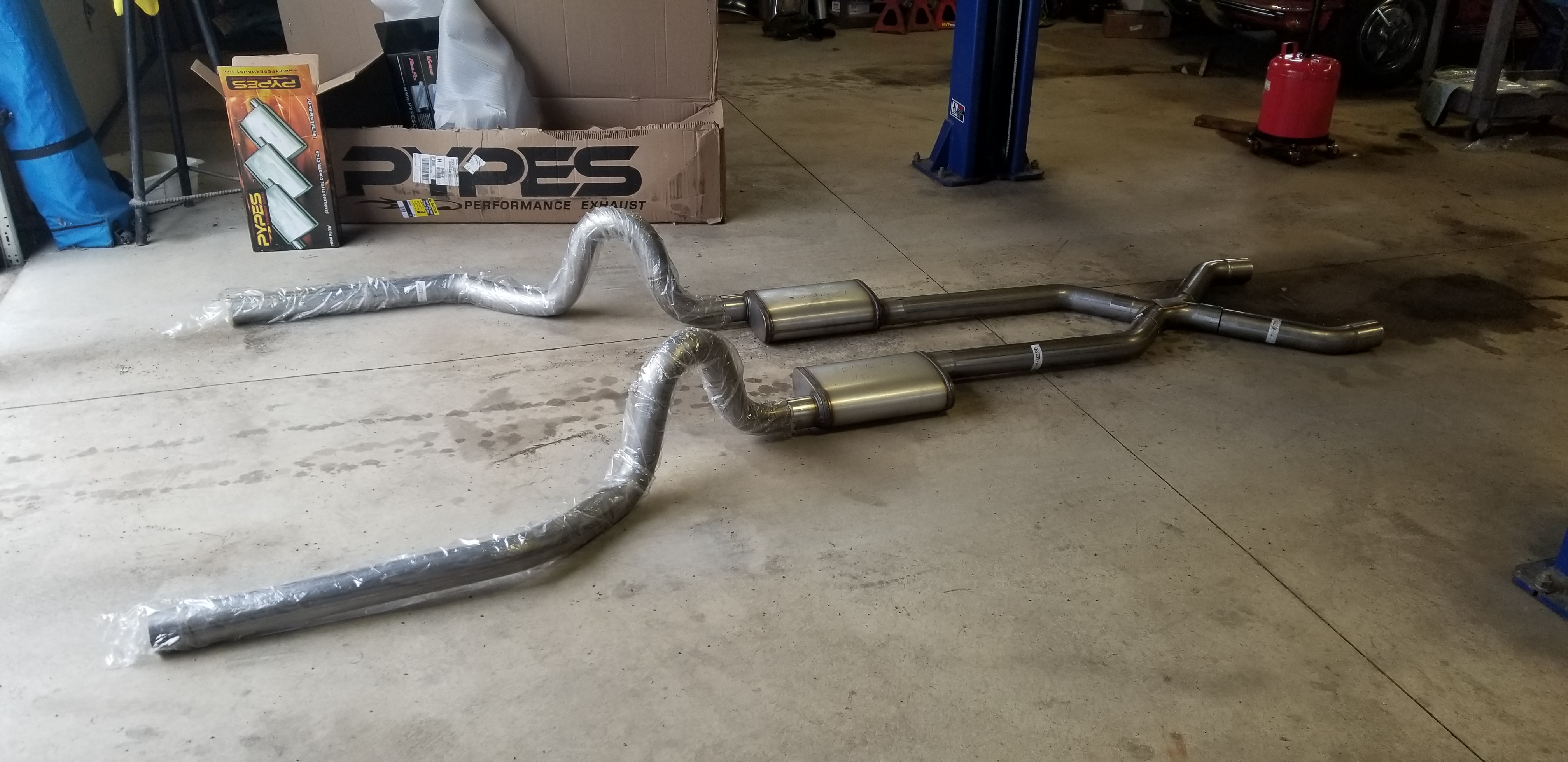

It turns out this is a clamp-together kit with traditional style clamps, not band clamps. Everything slid together pretty easily except for one connection where I can see a small ding in the pipe. Installation looks pretty straight forward, although it looks like I'll need to get some adapters for my headers, as they use a ball/socket setup, instead of the usual flat mating surface w/gasket.

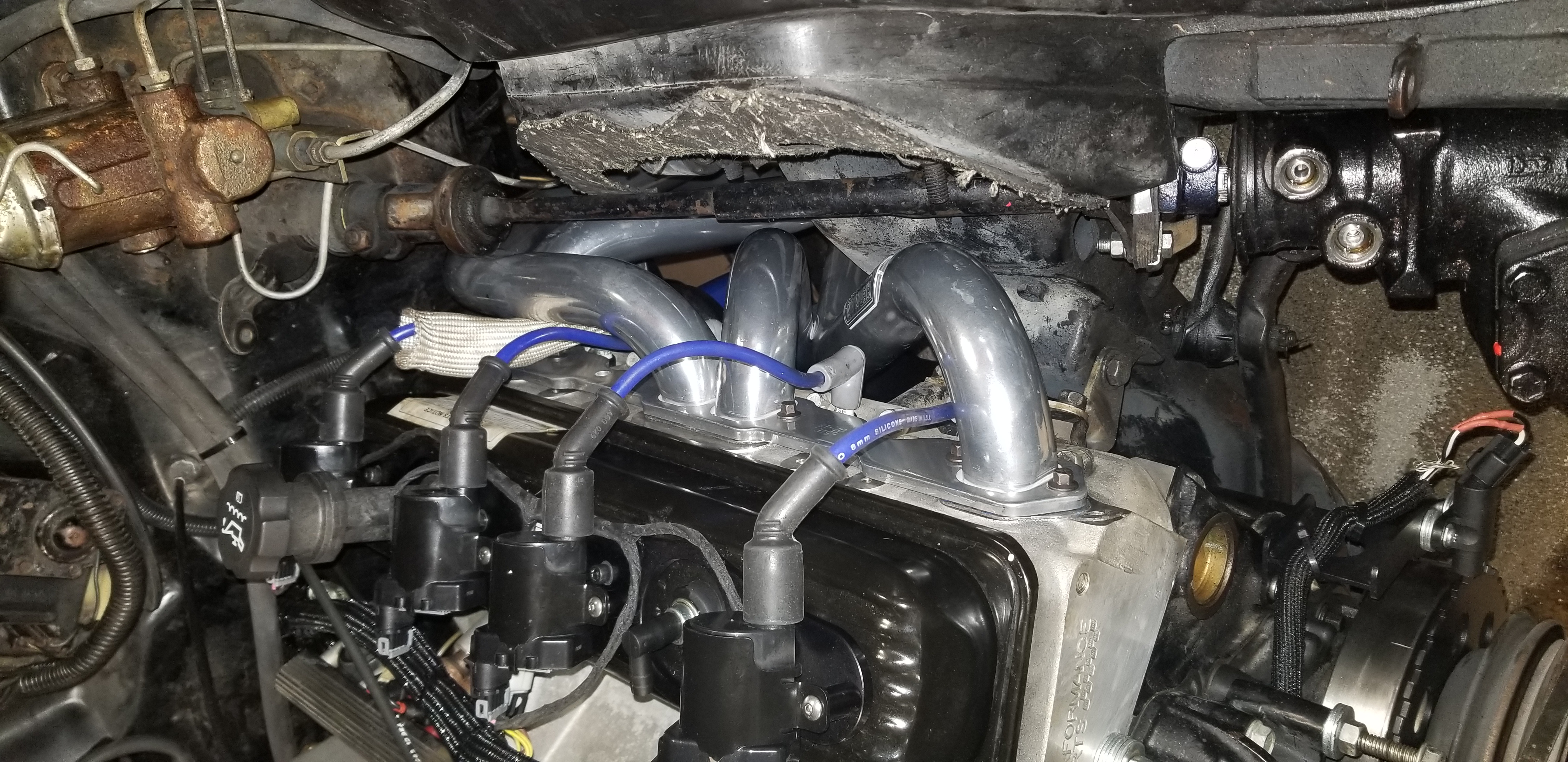

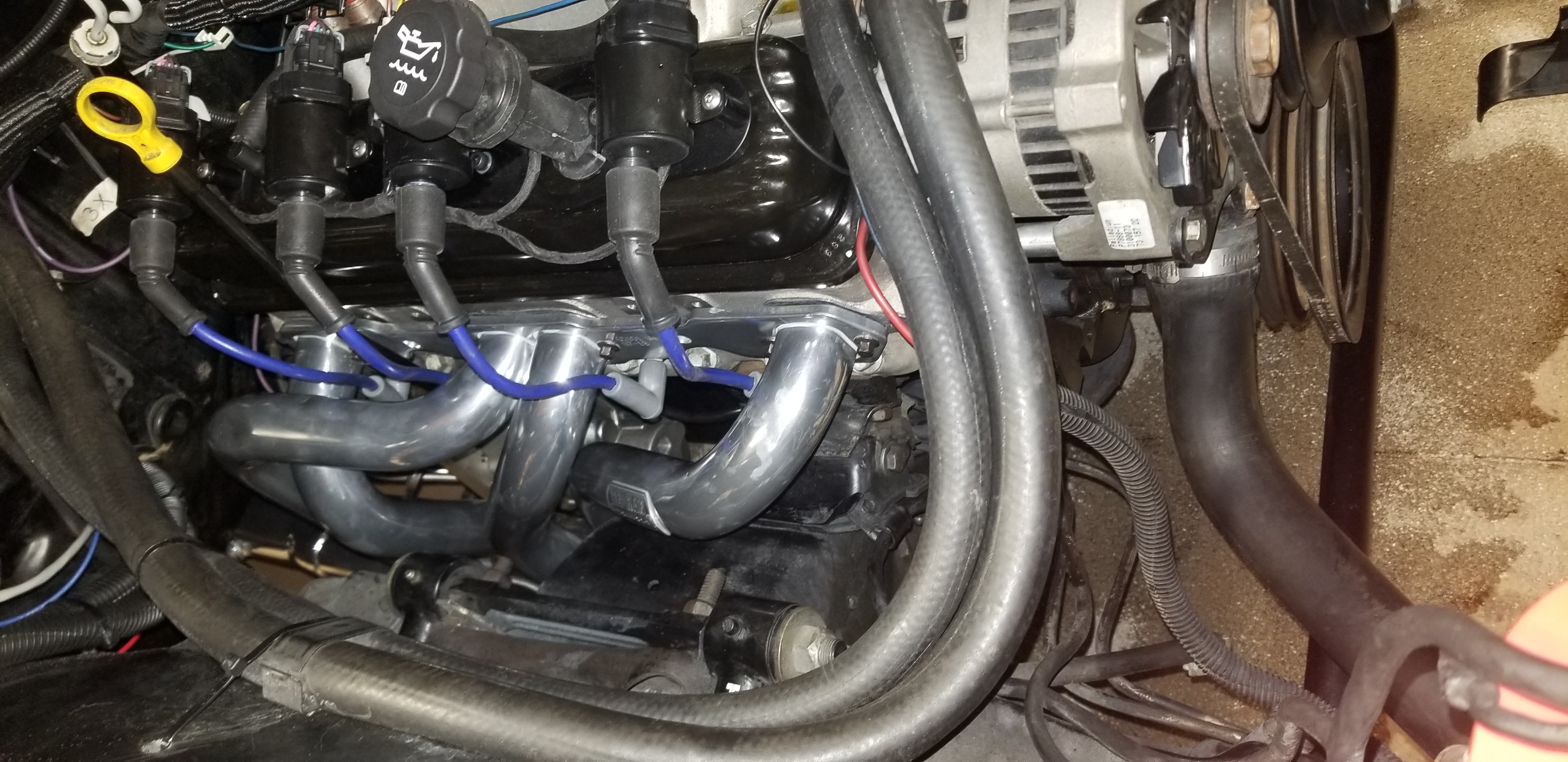

Sometime back in the past year, I saw a craigslist ad for the exact same headers I have, Hedman 65101, 1 3/4" primary, ball/socket connection at the flange. New at Summt they are $275. I got them for $50. When I bought them, I had zero need, but I couldnt pass up the price. Now that I'm doing a new exhaust, I retrieved them from The Basement and dropped them off @ Advanced Auto Clinic (old Ricks Garage location) for a couple O2 bungholes. They did a real nice job.

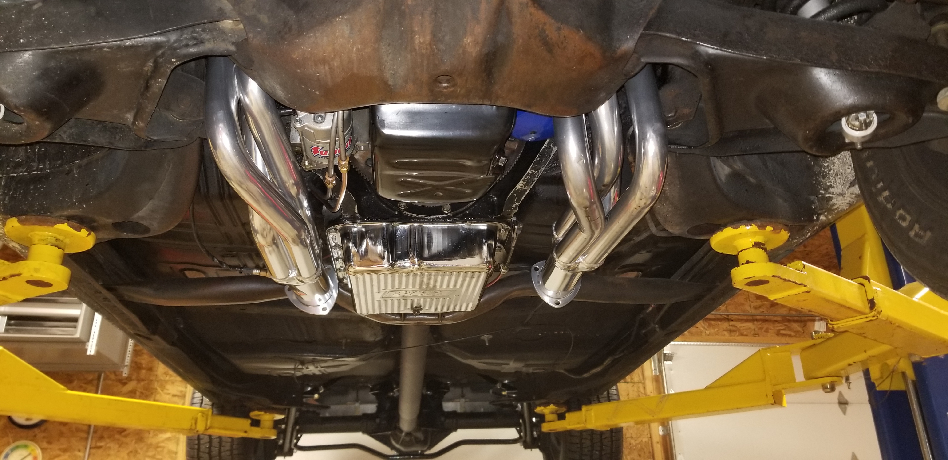

The exhaust is almost done! My headers came back a couple weeks ago from Jet-Hot and they look GREAT! Unfortunately, I had a clearance issue with the steering shaft, so I did have to dent them, but I was careful about it and I think it looks ok with clearance now.

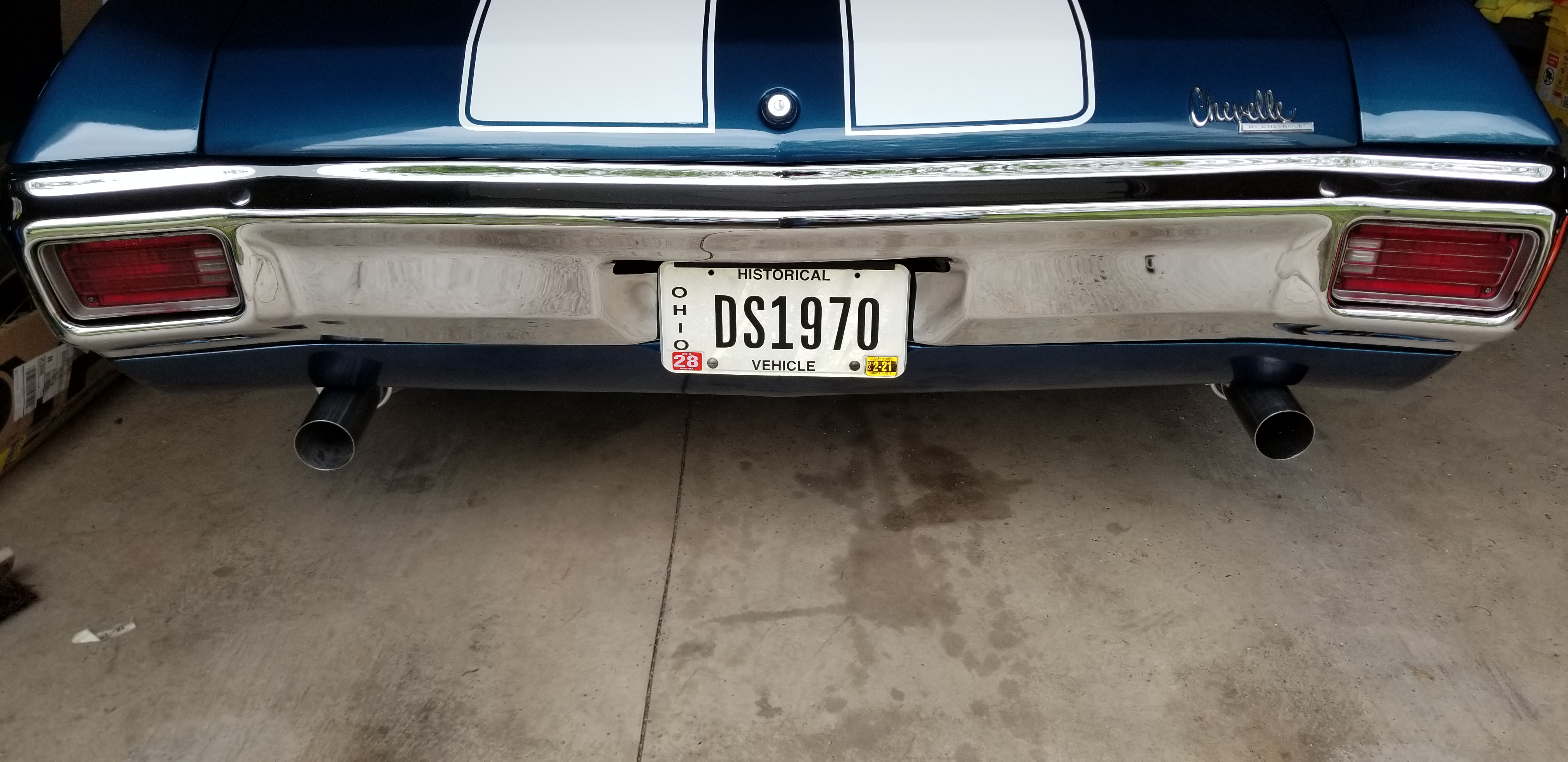

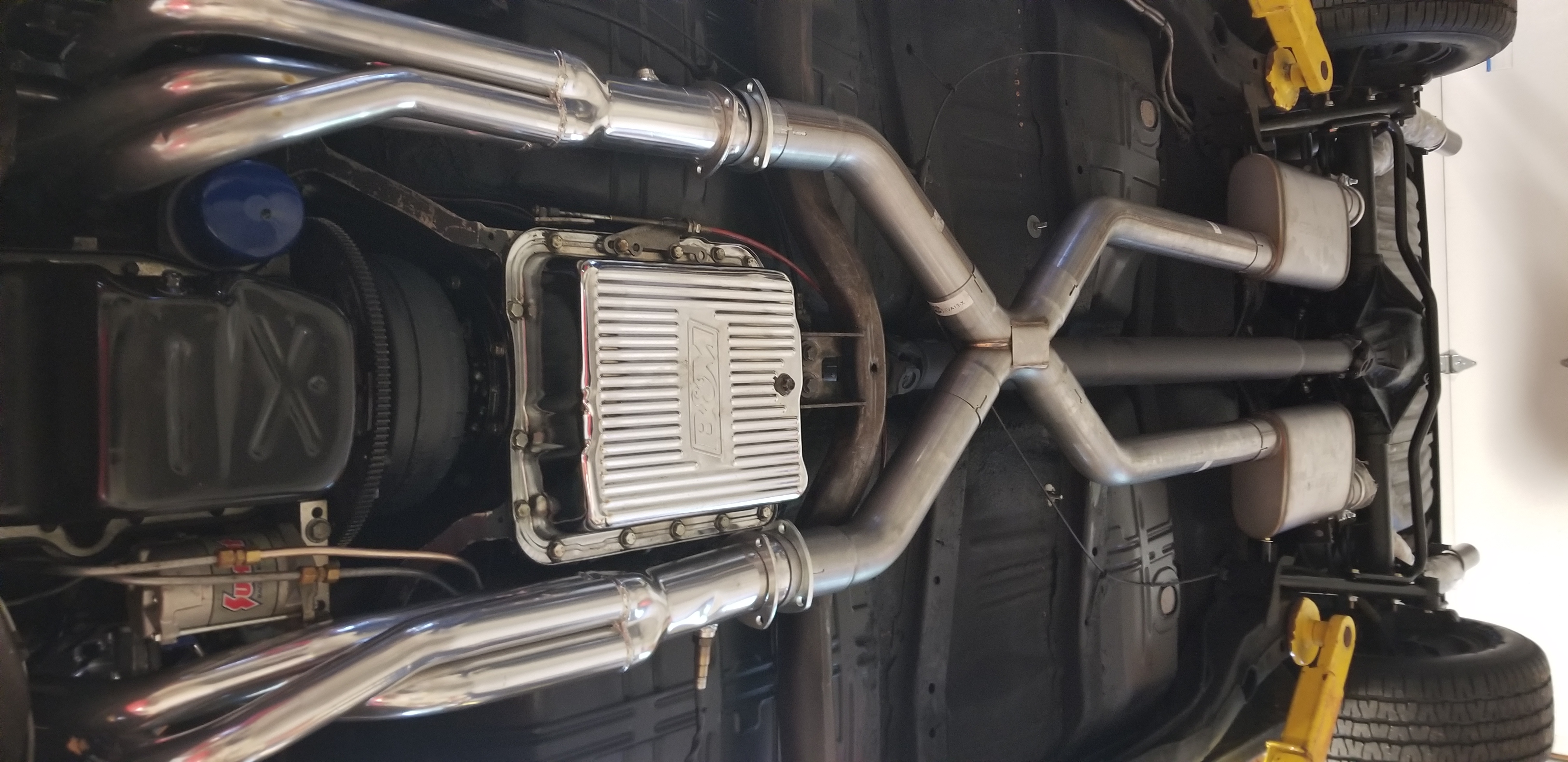

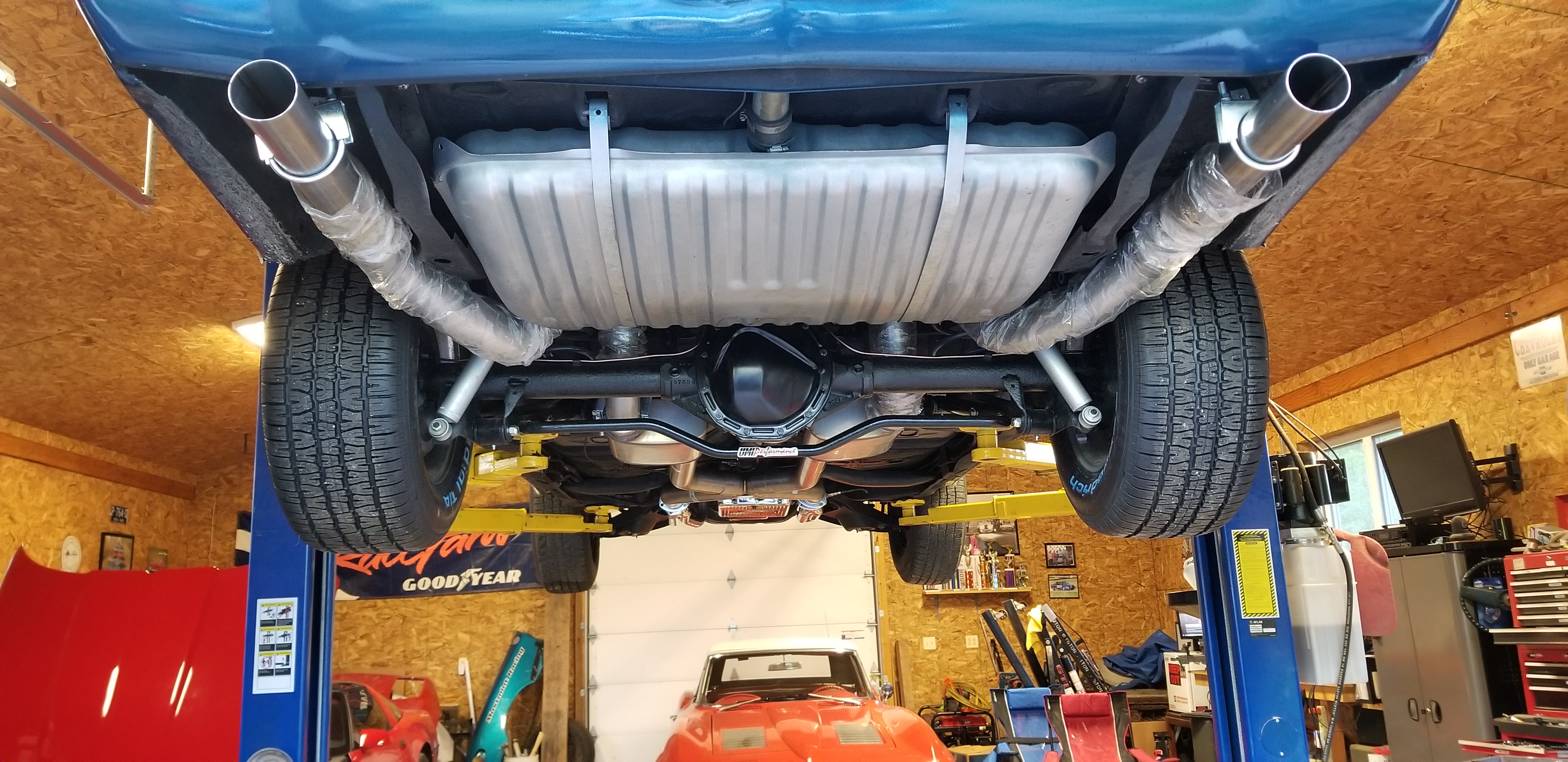

I got the rest of the new Pypes exhaust hung this week. I still have a small gap to contend with, but I think I just need to adjust the pipes a bit here and there. I have some 3" SS-style cowbell tips on the way from Summit. I'll need to trim the tailpipes back a few inches, but it should look really sweet when its done.

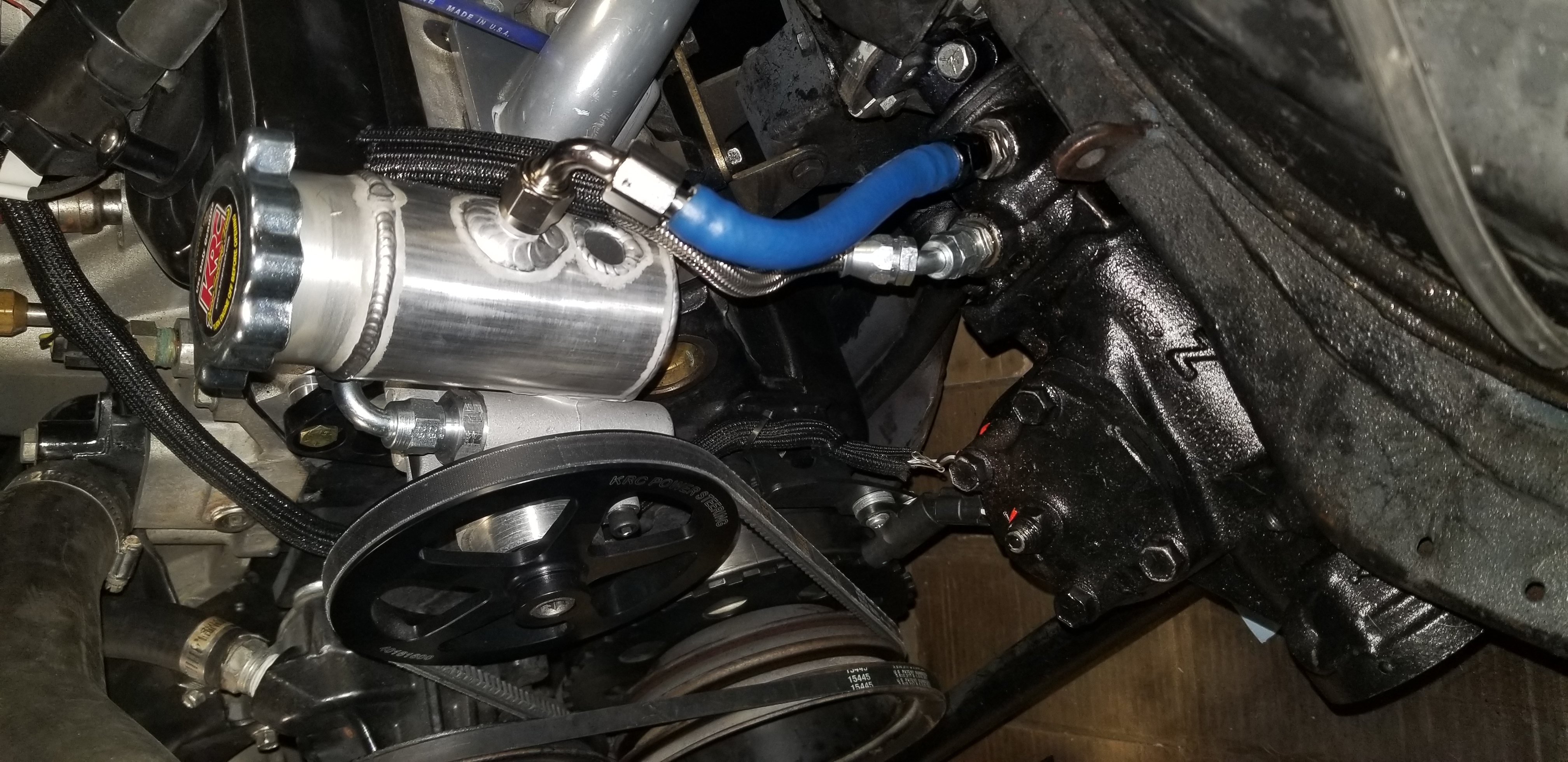

I completed the power steering conversion! This ended up being way more involved than it should've been, but the end result seems looks good and seems to work as expected. So because of where I mounted my crank sensor, most of the power steering brackets wouldn't work. I *do* have a factory bracket that would've worked, but I couldn't find the appropriate pump that would bolt up. So, after that I ordered this aftermarket setup from KRC. The way it mounts to the head was the selling point for me. You can buy just their bracket, but then you need a matching Type II pump with either an attached or remote reservoir, the right pulley, blah blah, so I just got a complete kit from them. Pricey, but it works. The next challenge was putting together a custom high-pressure hose. I ended using Aeroquip Teflon lined -06 hose and TFE fittings. Finally, I needed a 41.5" v-belt, Duralast #15415
In hindsight, I should've made a new crank sensor bracket that goes on the passenger side of the block. That would've been the really smart thing to do. Anyway, the upgrade to the faster-ratio steering box is complete.

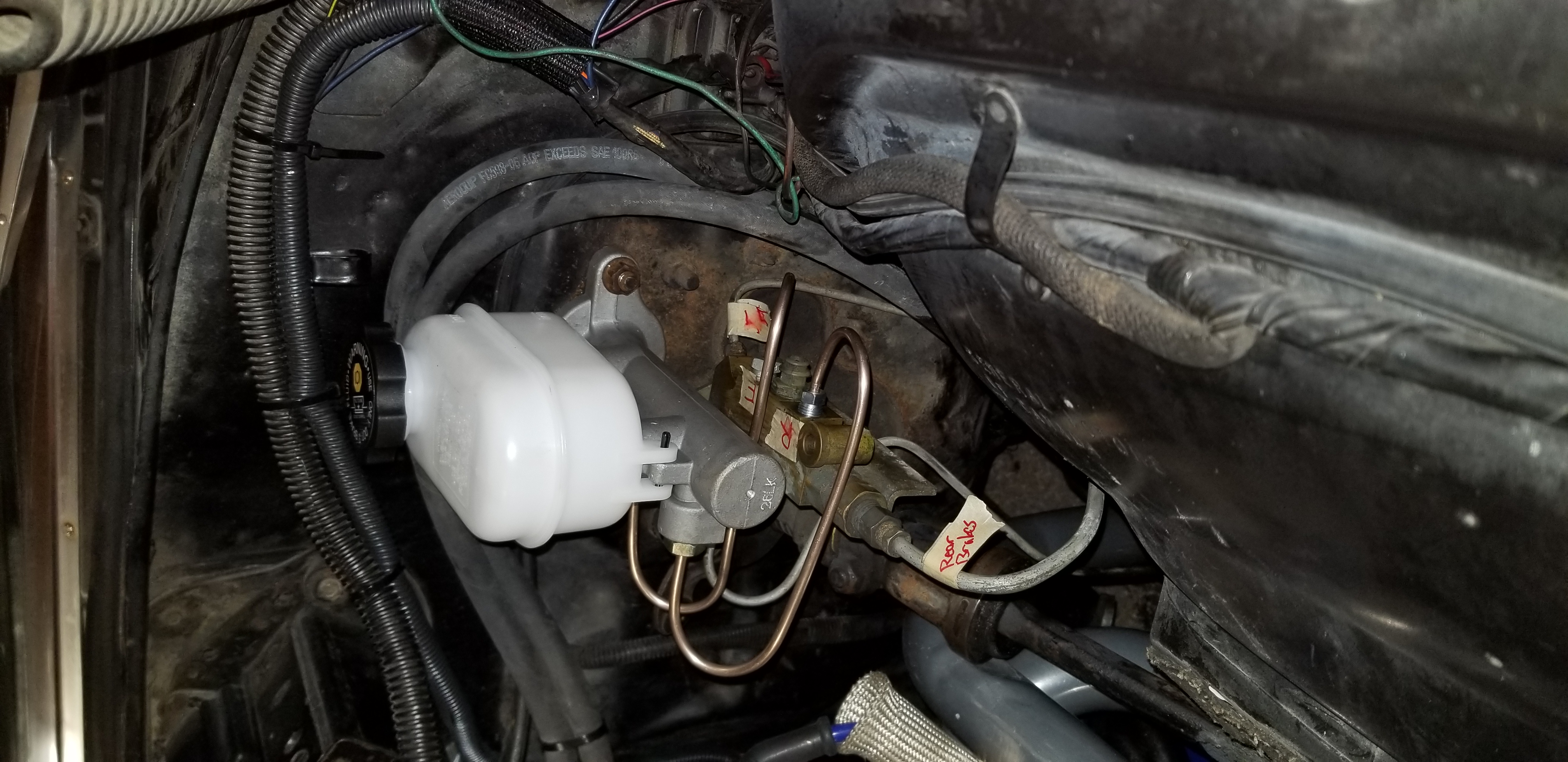

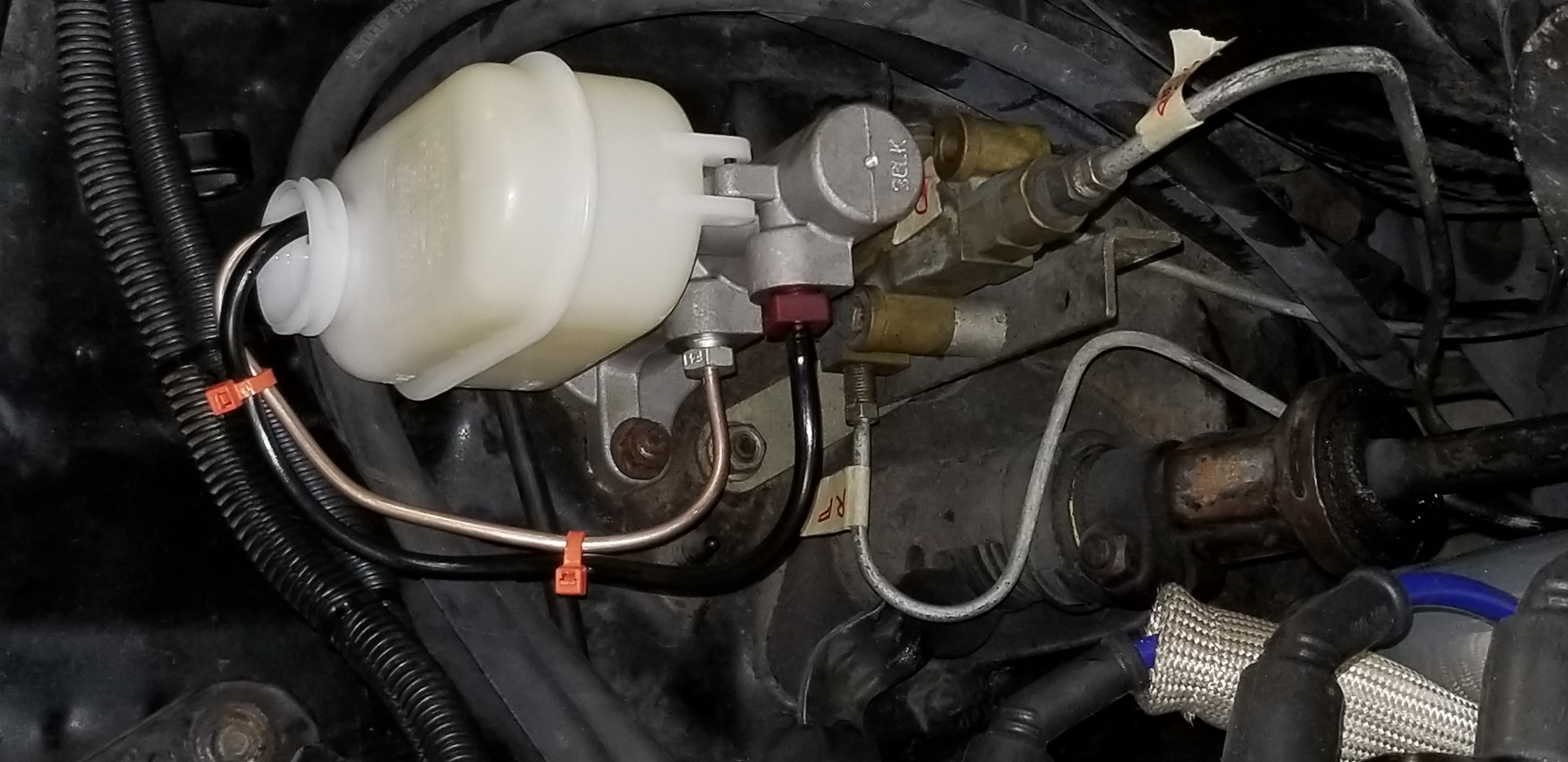

Just as I was finishing up the power steering upgrade, the master cylinder started failing. I bought this new 'universal GM' master cylinder from Master Power Brakes. It's super light, maybe 1-2 lbs. The old one was ugly and 10+ lbs. Of course, nothing is easy. New master has outlets on passenger side, old one has them on drivers side, so I had to make up a couple new lines from the master to the proportioning valve. I also had to remove the pushrod from the pedal and shorten it up. I replaced the jam nut with one half as thick and have it screwed together as short as it will go. (shortening the rod about 1/2 inch) I might still need to grind the other end a bit. And I just need to do a final bleed on the brakes before I test drive it.
Despite the failing master, I was able to do some test drives around town and the exhaust sounds killer! I still need to get the Cowbell tips installed.

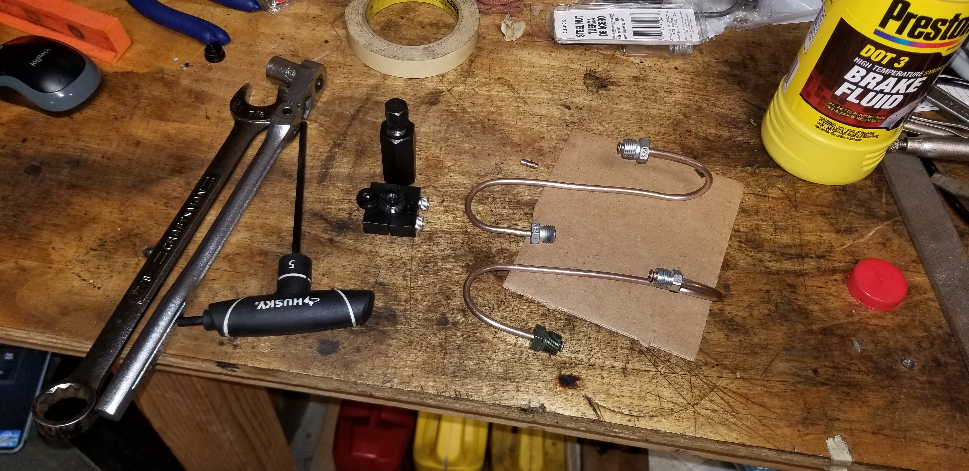

After taking the pics, I discovered I have a bad leak at the port labeled F in my pic (driver's side, 2nd line back). Pours right out despite fitting being tight. I'm using 3/16" NiCopp, same roll as Blazer and Chevelle rear brake lines that I cut and flared. Same flaring tool. After the first leaked, I made a 2nd line. It leaks just as bad. Not sure what's going on yet.

Well, after what felt like an eternity, I got my new combination valve (proportioning valve) from Master Power Brakes, mpbrakes.com So we are on new Master Cylinder and new Combination Valve. Everything is sealed up, not leaking -- but can't get a good pedal from it. I did a bench-bleed of it on the car, with temp lines routed back into the reservoir, pumped the pedal (Gwen) while I watched for air bubbles to stop. I then hooked up the regular lines and proceeded to bleed the car.
RR, LR -- pedal improving
RF -- after first bleed, pedal goes to shit, ton of air came out. Tried several times with no improvement. This is basic stuff, not sure what's going on. Sent an email to Master Power. I'll see what they say.
