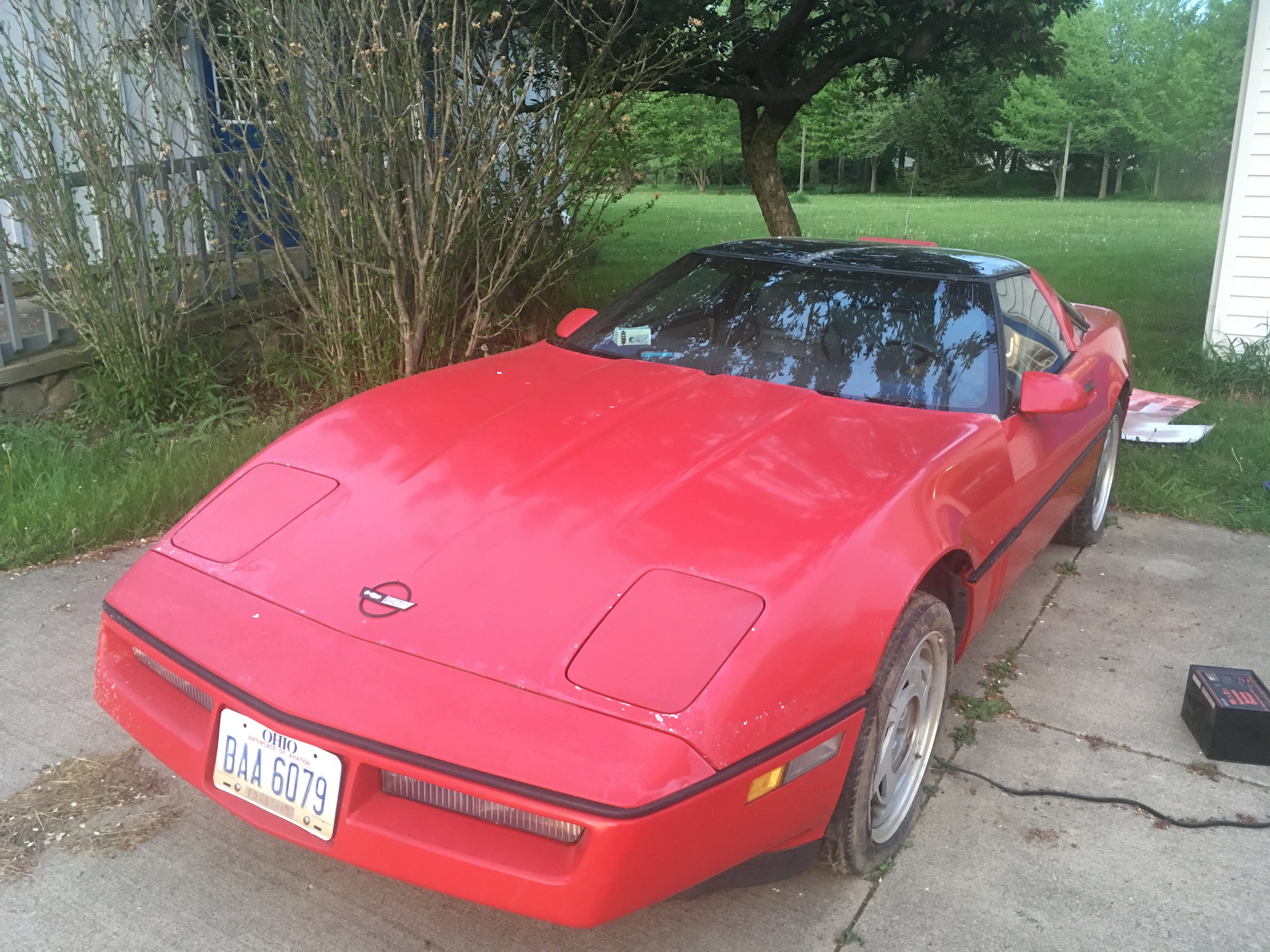

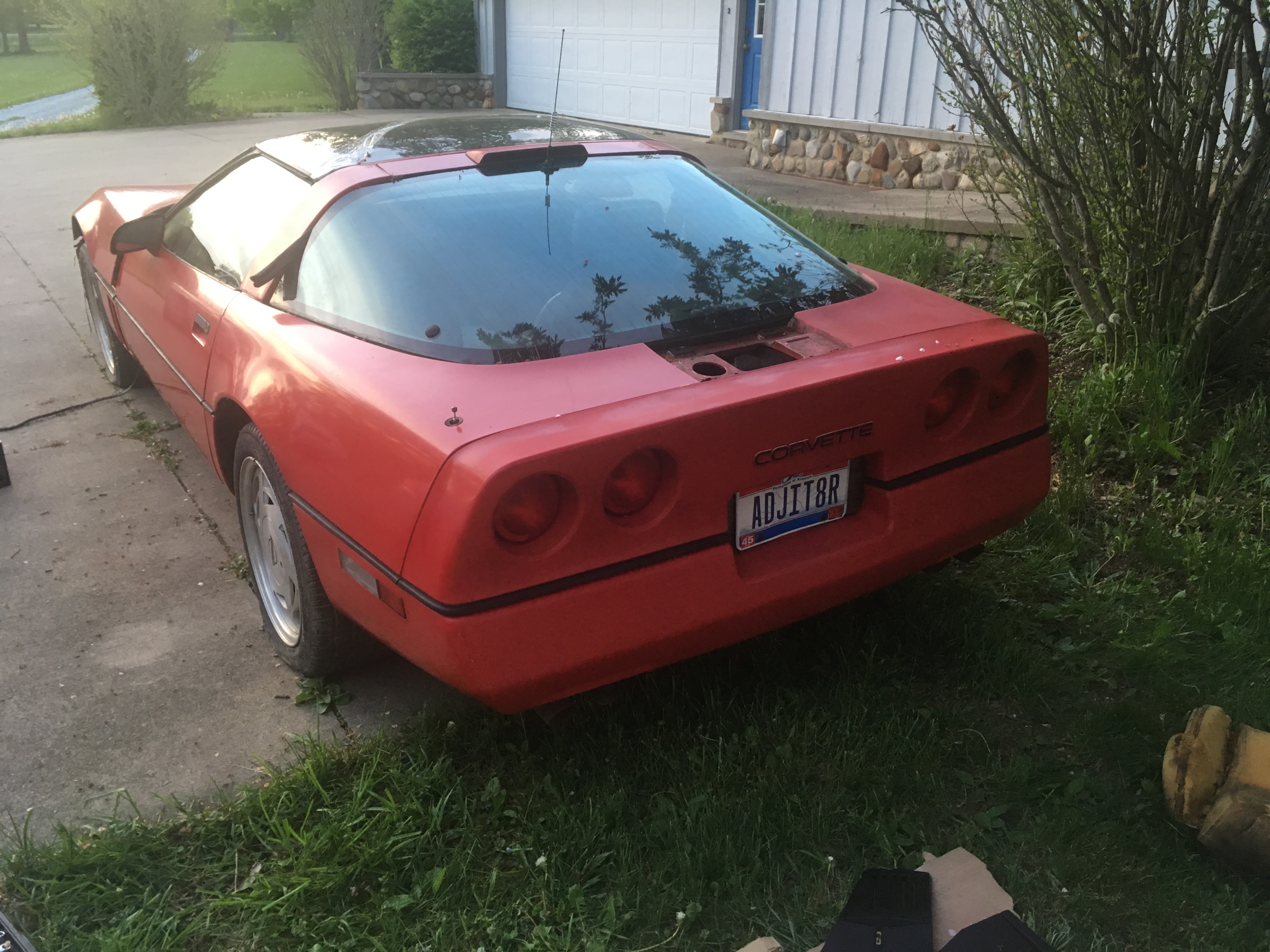

In the meantime I've still been casing them in my free minutes and came across this car.
It is an 89 with 61k miles, the TPI L98 and automatic transmission. The underside looks clean, no signs of damage repair, a couple cosmetic flaws nothing major. It is not a running car at the moment. The prior owner had the engine rebuilt and has it reinstalled in the car. It is mostly reconnected except for all the accessories driven by the serpentine belt. The fuel system has been gone through and the gas should be good. There was a long story about how his brother in law was the original owner and somehow the drain plug came out after an oil change. Whatever. I'm figuring the car is probably worth close to $1500 with the engine in pieces.

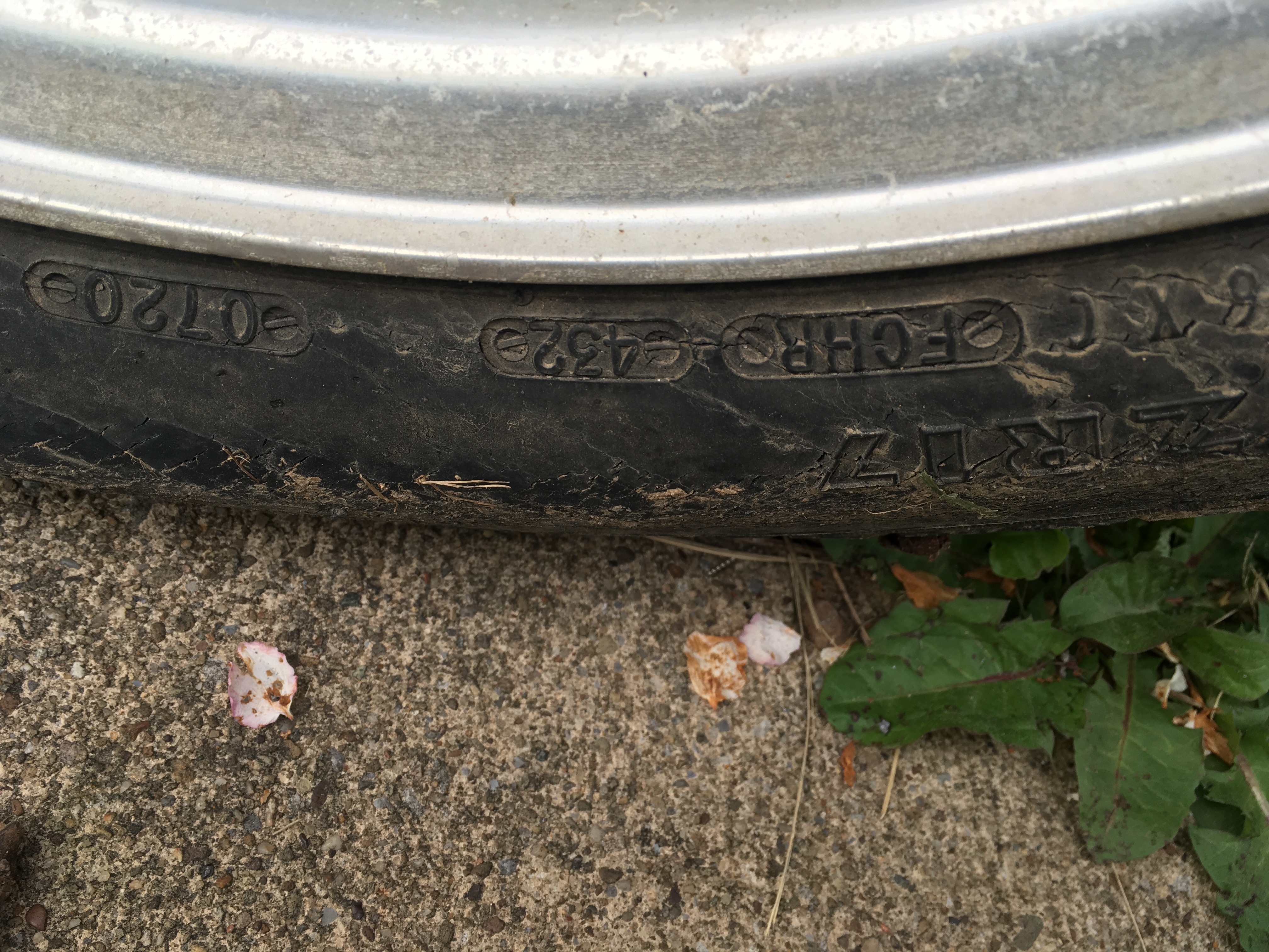

The tires on the car are from 1992, and the plates were current as of 2010. Suffice it to say the car has not moved much recently. The guy kept it in his garage for like 20 years. He is moving to Florida and is not taking the car which is why he decided to sell.
The reason it is not running is he no longer has the key with the chip to satisfy the anti-theft system and so the ECU will not deliver fuel to the engine. Kurt is looking into this already he knows what to do just has not bypassed it yet.
I have the RPO codes from in the glove box but have not decoded them yet.

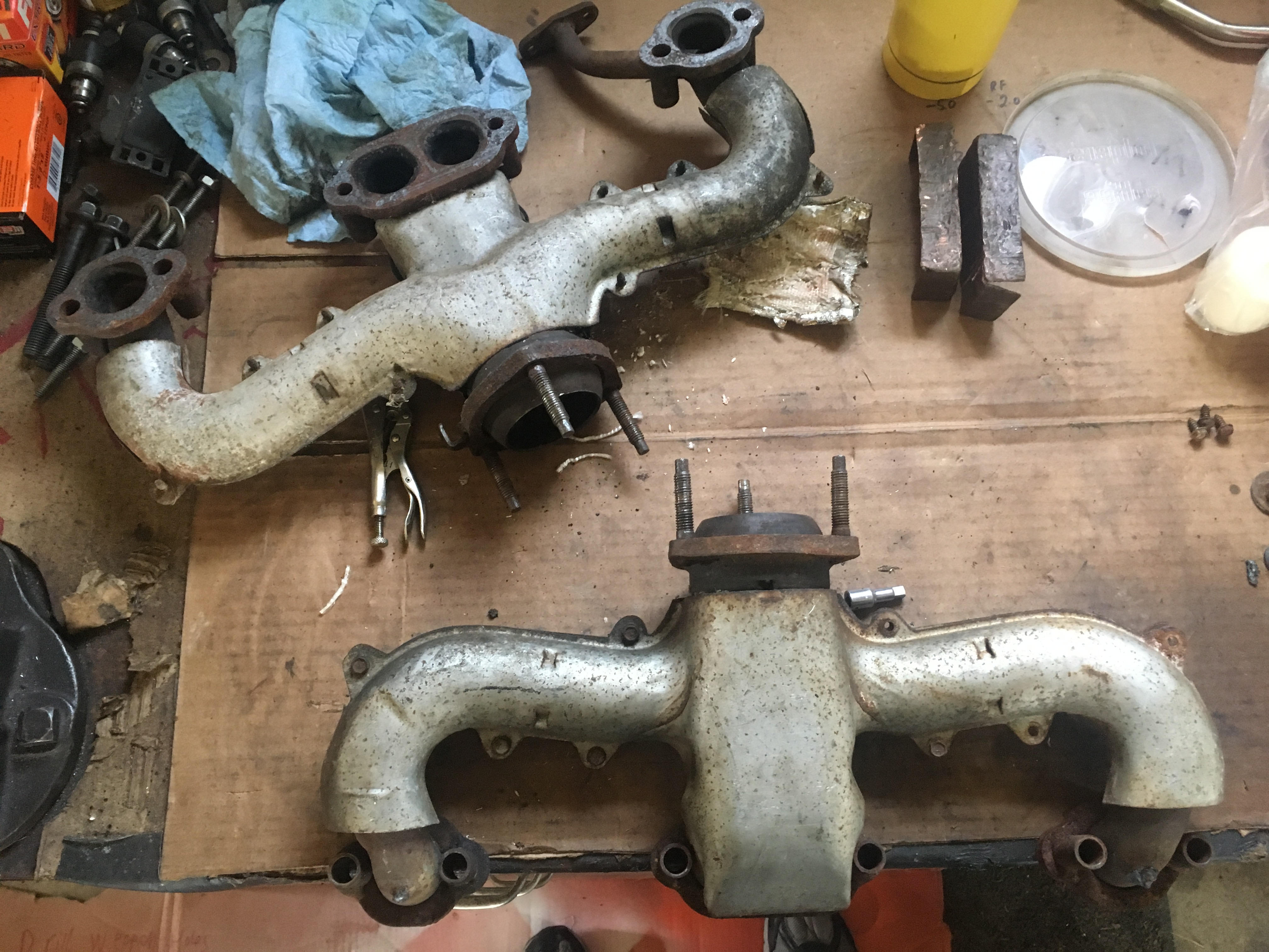

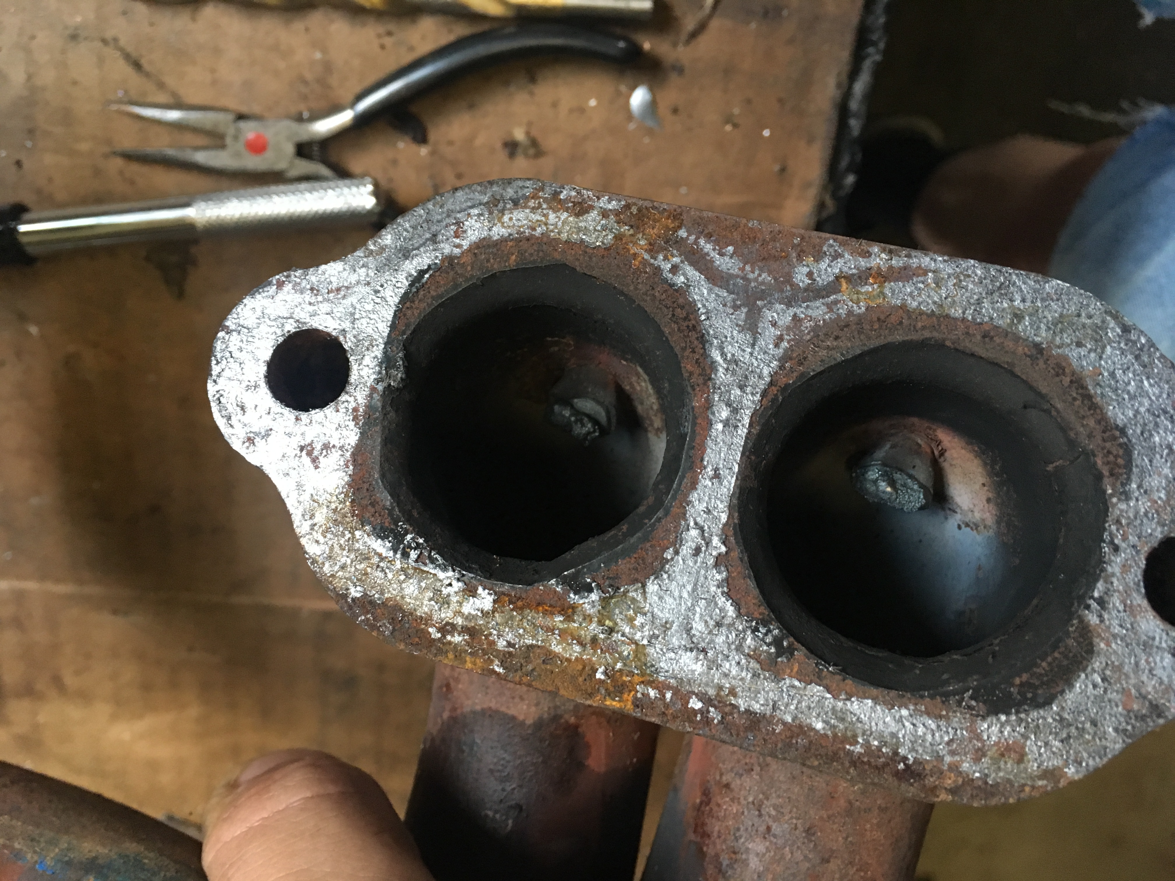

Last weekend I did my first project on the car - I went to work on the exhaust manifolds. Plan was to remove EGR valve, clean up the threads on the studs, and clean and paint.

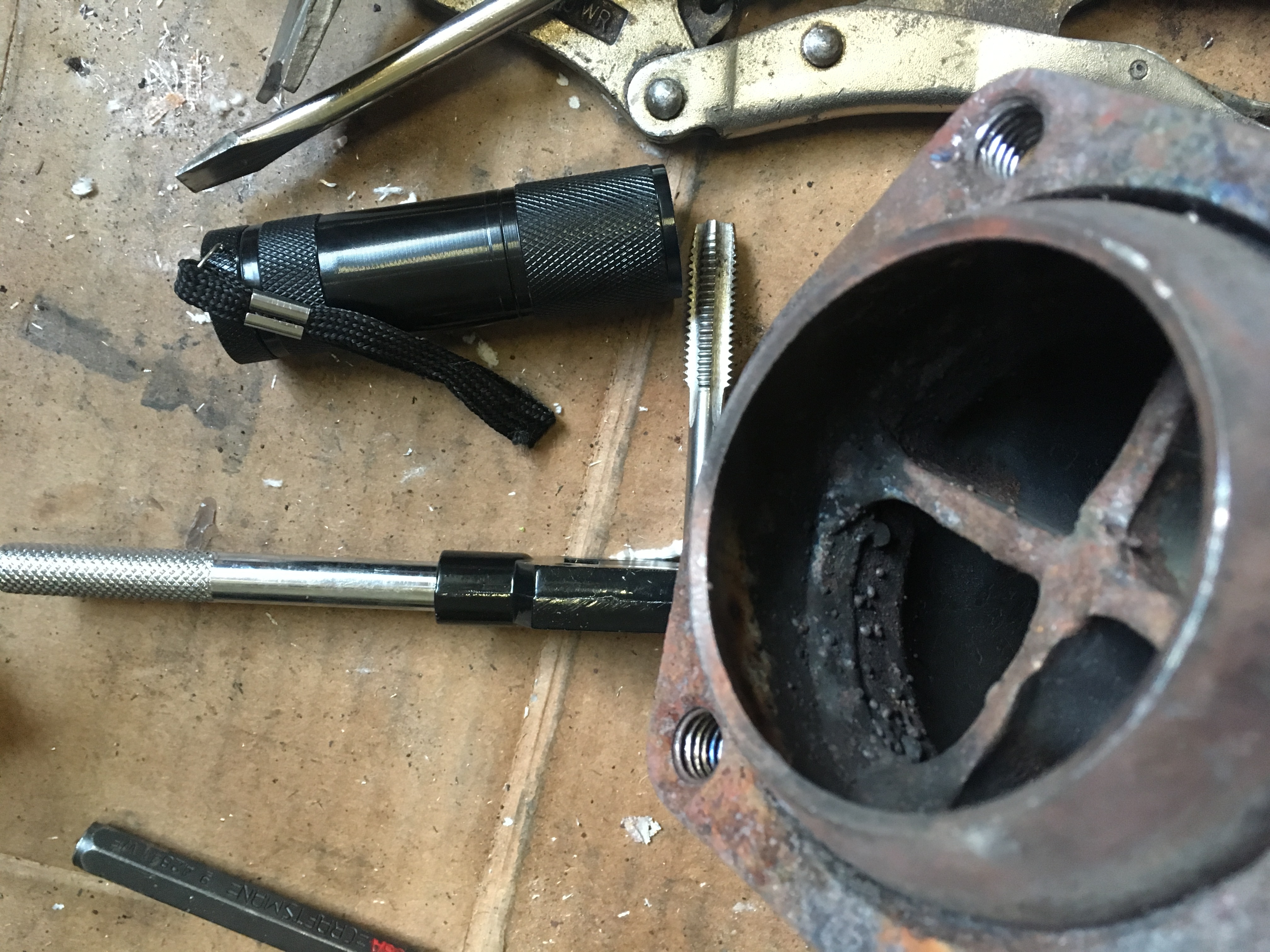

That plan fell apart on first inspection. The prior owner had welded the small EGR pipes shut but they protruded into the header pipe. These I ended up grinding out.
I tried running a die on the studs but since they had been cross threaded with American thread (these are metric 10x1.5) I could not get satisfactory thread. This led to removing and replacing the studs. With heat and candle wax I was able to remove four of the studs but broke the other two. This led to quite a bit of monkeying around to drill out the old studs. In neither case was I 100% satisfied with the threads I tapped so I added a metric nut at the top and had Kurt weld it on.

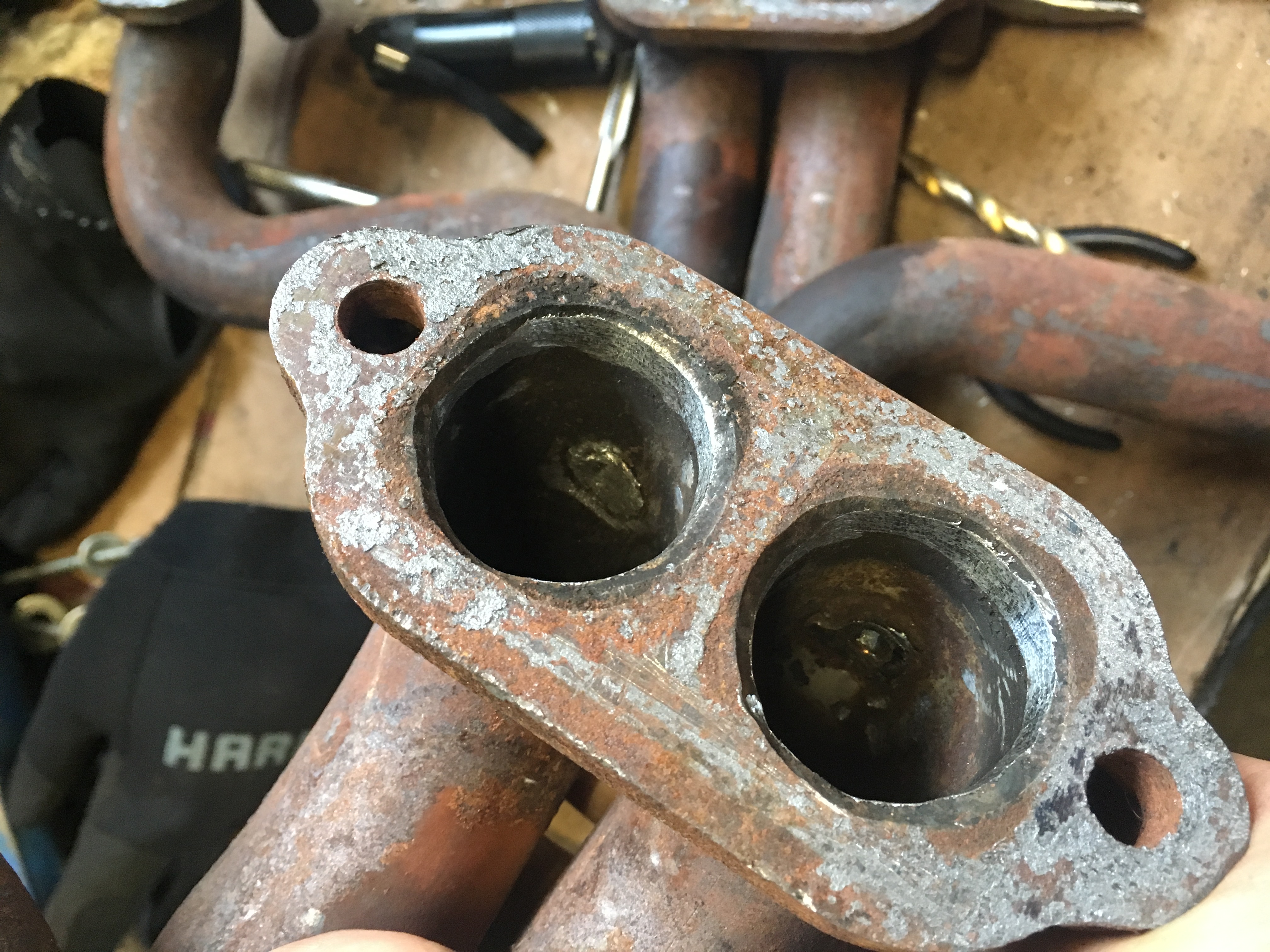

The exhaust port of the header was another thing. First off the factory header is 1.5" OD which I find small. Second where the flange attaches to the pipe is between 1.2" and 1.3". Yikes I went to work with the die grinder cleaning up these welds to improve flow. The 4 into 1 end was also quite sad there was weld splatter and the openings are even smaller. I spent over an hour grinding out extra metal on each one before I got burnt out. Maybe more on another day.
