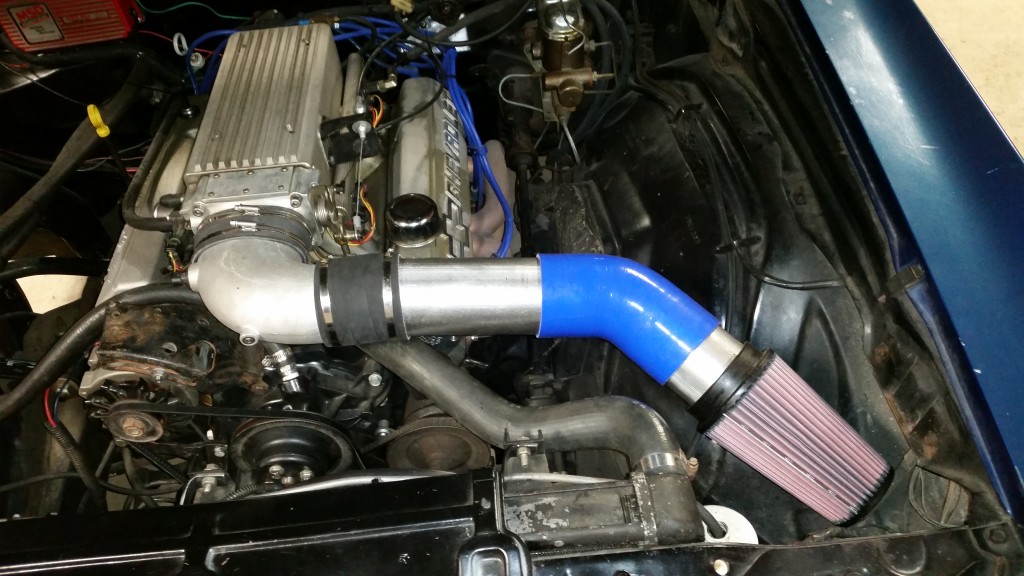

I got around to making up a cold air intake. I had been buying a couple pieces here and there and finally got it all together. With the setup I had been using, with a filter right on the throttle body, it was essentially taking in hot air right off the radiator. I bought an elbow off ebay that was oddly expensive at $80, and also oddly sized at 3.5". I picked up a piece of 3.5" exhaust pipe from Summit, because the 3 different exhaust places I stopped at had nothing bigger than 3". I found a 3.5" 45* angle piece on Amazon, and a 3.5" Summit-branded K&N cone filter. It looks kinda cool, but it was worth absolutely nothing at the dragstrip. Next time I go, I may try some back-to-back testing to confirm, but I've only been there once since putting it in.

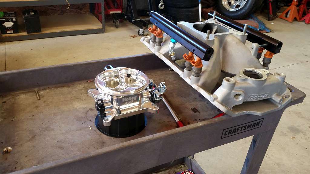

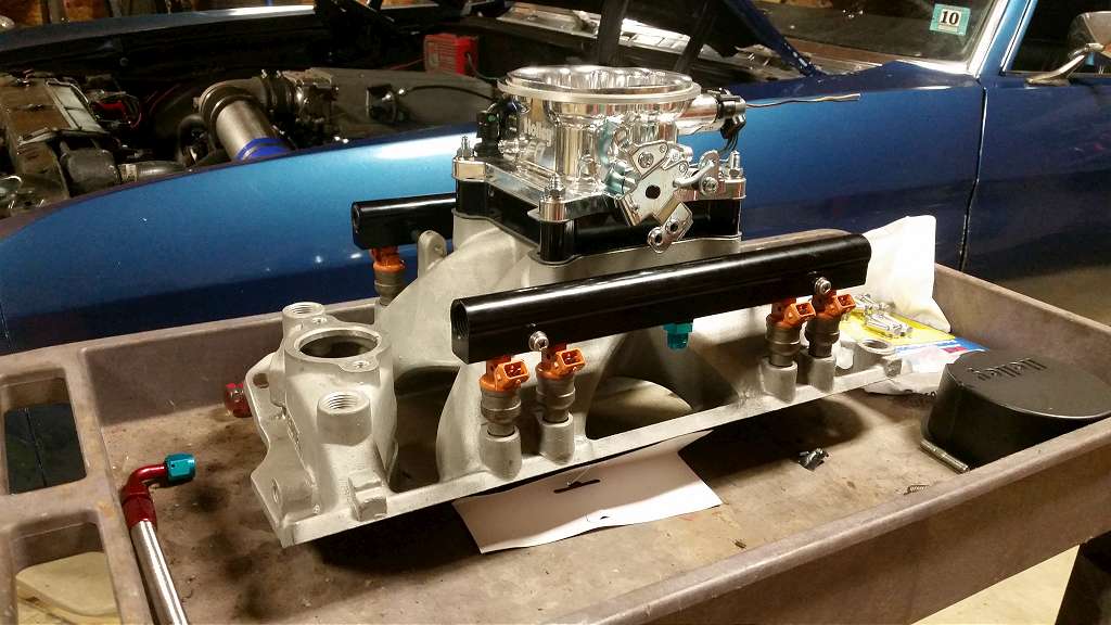

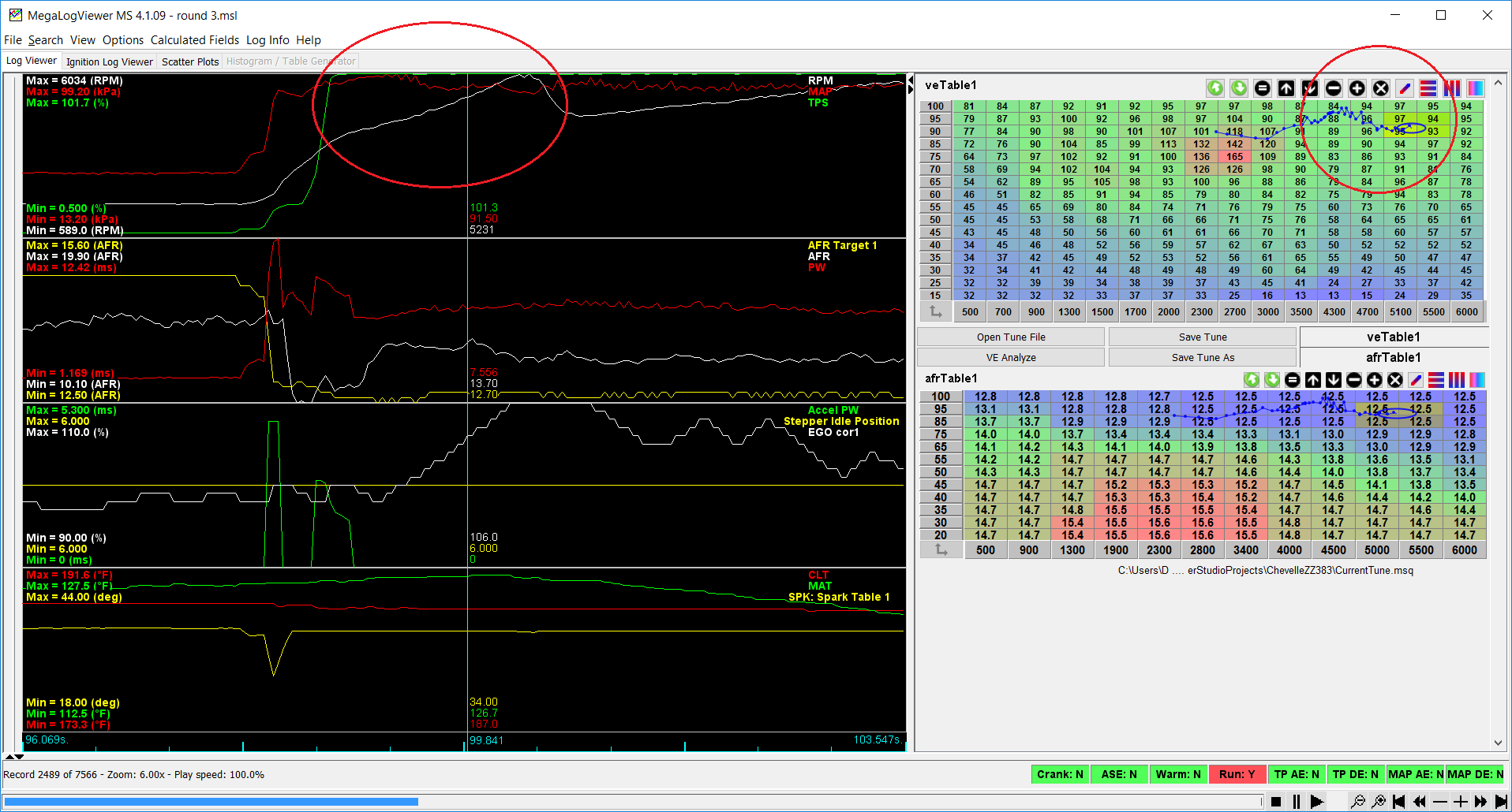

So while I just posted about how much I love that its a good street car again, I have the pieces to make up a new induction system. The fact that my car doesn't MPH like two other known ZZ383s (110-111 to my 106-108) has been bugging me. The ports on my Holley Stealth Ram looked noticeably smaller than what was on the 4-bbl single plane that it came with from GM. Well, I'm not about to give up my EFI, but I think I need a better intake.
If you look at my datalog screen shot, you can see how the red line (MAP sensor) peaks around 4300, and then MAP goes down a bit for the rest of the RPM range. That's the same thing as seeing some vacuum with your undersized-carb, at WOT, yes?
And so like any good project, this one has begun with a craigslist purchase. I found a guy selling a 4-bbl single plane style manifold, but an EFI version, with fuel rails, so I picked it up. He had a pretty serious looking turbo-LS S10 in the garage. The injectors pictured are from inventory. Holley makes a pretty nice 4-bbl EFI throttle body that has an included TPS and IAT sensors, and IAC motor, and the throttle linkage is 700r4-ready. The ports on this thing look like it should move air a whole lot better than my current HSR.
After I got the throttle body, I quickly found out the Holley linkage didnt clear the fuel rails. Crap. A 1-inch open spacer solves the problem, but the intake is now starting to get a bit tall. And the bracket I thought I was going to use for the 700r4 TV cable doesn't clear the fuel rails either. Another option may be to get an elbow adapter and use an LS-style throttle body. Those just don't look as cool, though.
To be continued...
To be continued...
