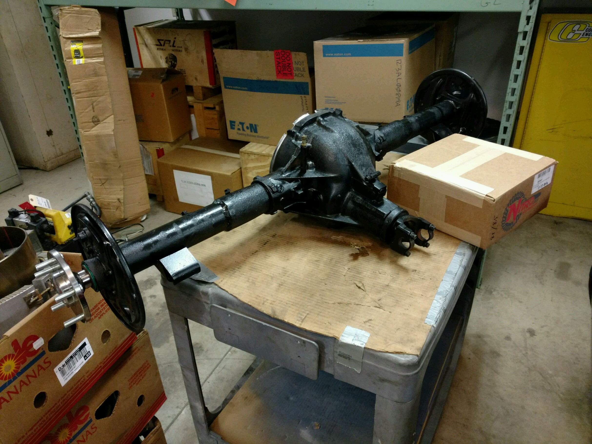

My early morning mission yielded the pile of parts shown. Now I need to go get some diff fluid and rear brake shoes. Maybe I'll start tearing into it next weekend. I have some garage rearranging to do this weekend to get ready. Hopefully by Christmas I'll be all geared up.

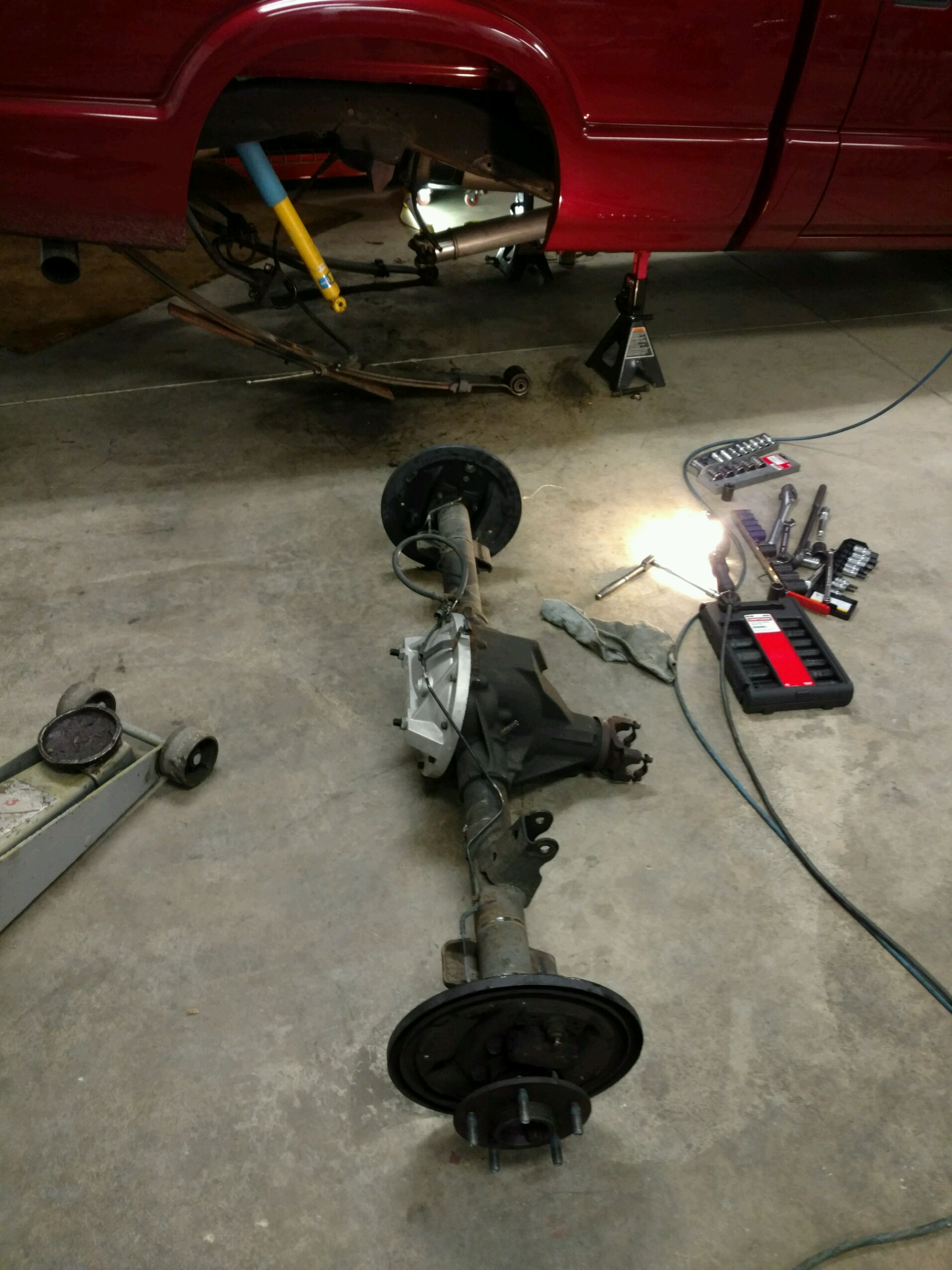

I spent a bunch of time last weekend getting the new rearend mostly in the truck. I took Friday off and removed the 7.5 rear and got far enough to have the new 8.5 resting on the perches in their proper location so I could measure the driveshaft that needed shortening. With the correct measurements, 32V and I set out bright and early Saturday morning for a trip across town to Henderson Driveline in Westlake for an 8am arrival time. These guys made this driveshaft for me a few years ago, and they were able to shorten it by 1 3/8" and press out the front leaf spring bushings for us in less than an hour an a half. We were able to go get breakfast while most of this was happening, so it was no big deal.
I have since got almost everything finished. All I have left to do is bleed the new wheel cylinders out, install and adjust the Cal Tracs lower bars, and figure out how to install the rear sway bar on the larger diameter axle tubes. I have an idea that will get tested most likely this Saturday. Unfortunately we'll be looking at some snow by then so testing and break in will have to wait for a thaw of some sort.

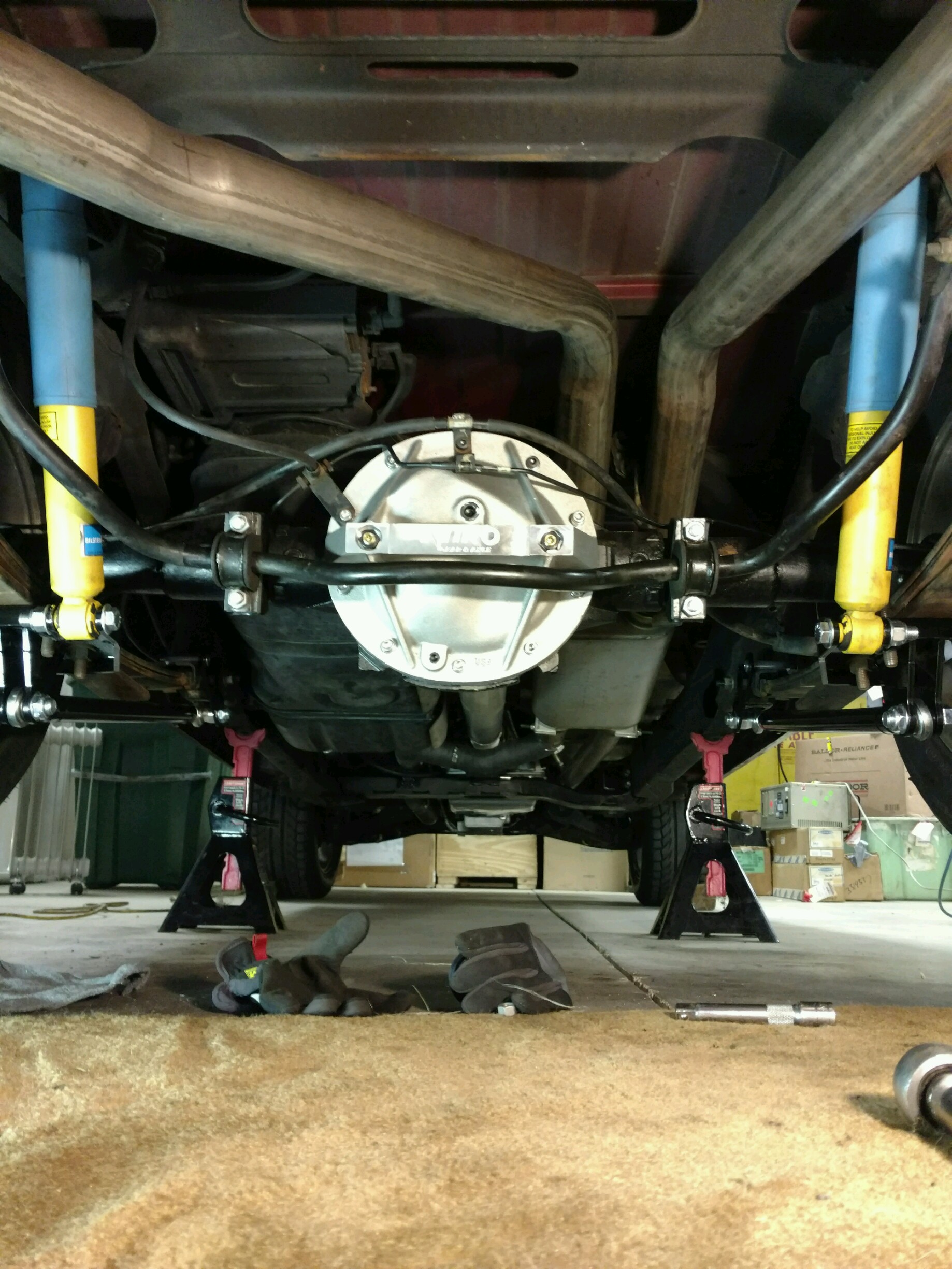

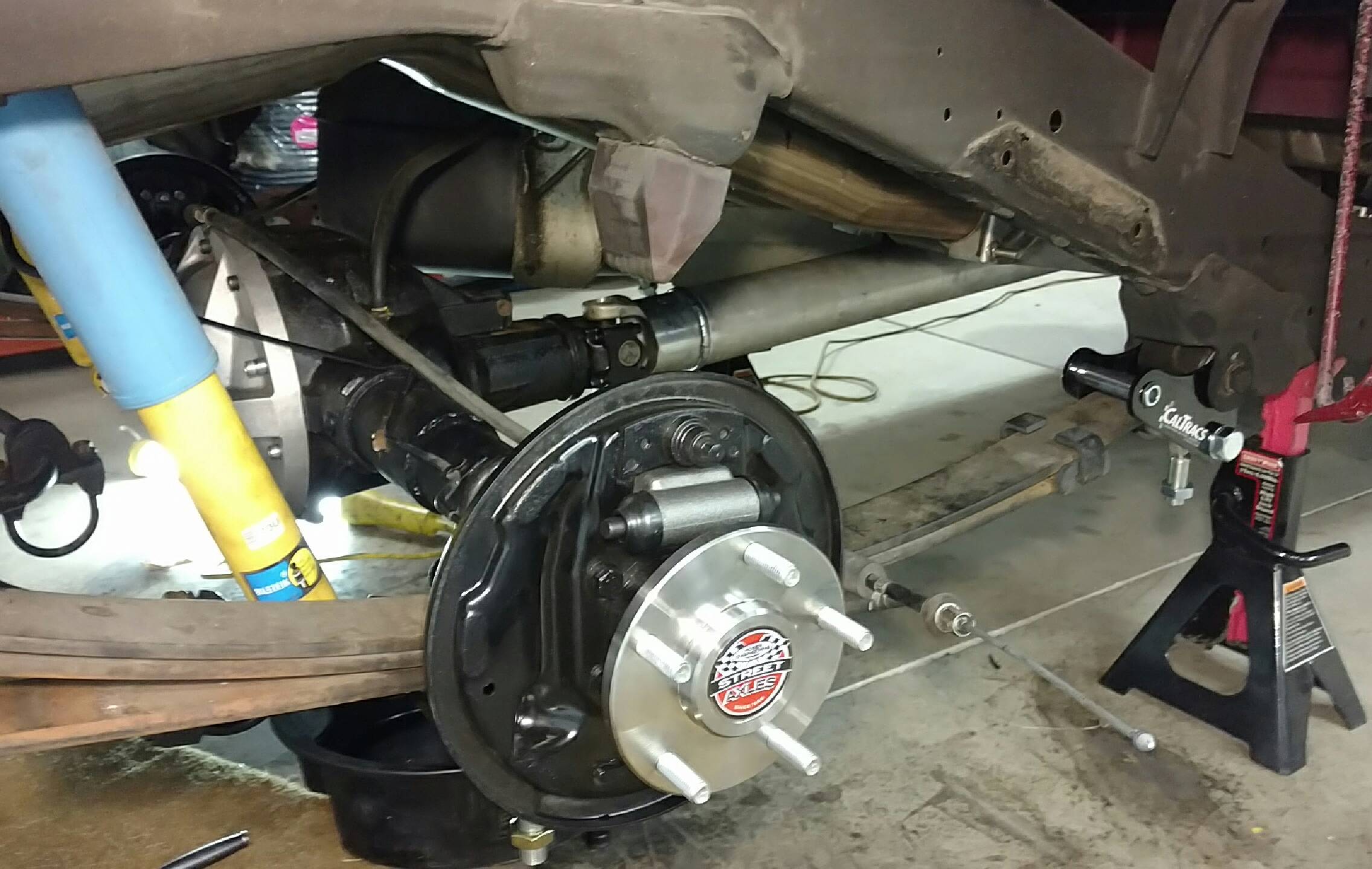

So despite the ridiculous weather yesterday, we were relatively toasty inside my garage finishing up the rearend install. We bled the brakes, gently opened up the rear wheel hubs on the factory wheels to go over the new axles which are slightly large diameter, finished hooking up the CalTrac bars, and finished fabricating a new way to make the rear sway bar work with the larger housing. End of the day it looks like this:

Most of that effort was straight forward until we got to the sway bar modifications.
I was only there for the fabrication of the prototype passenger side. (I left after the snow stopped.)
BP said he would complete the driver side before the day was done.
He has to be one sore puppy this morning. Great job, everything looks stock!
