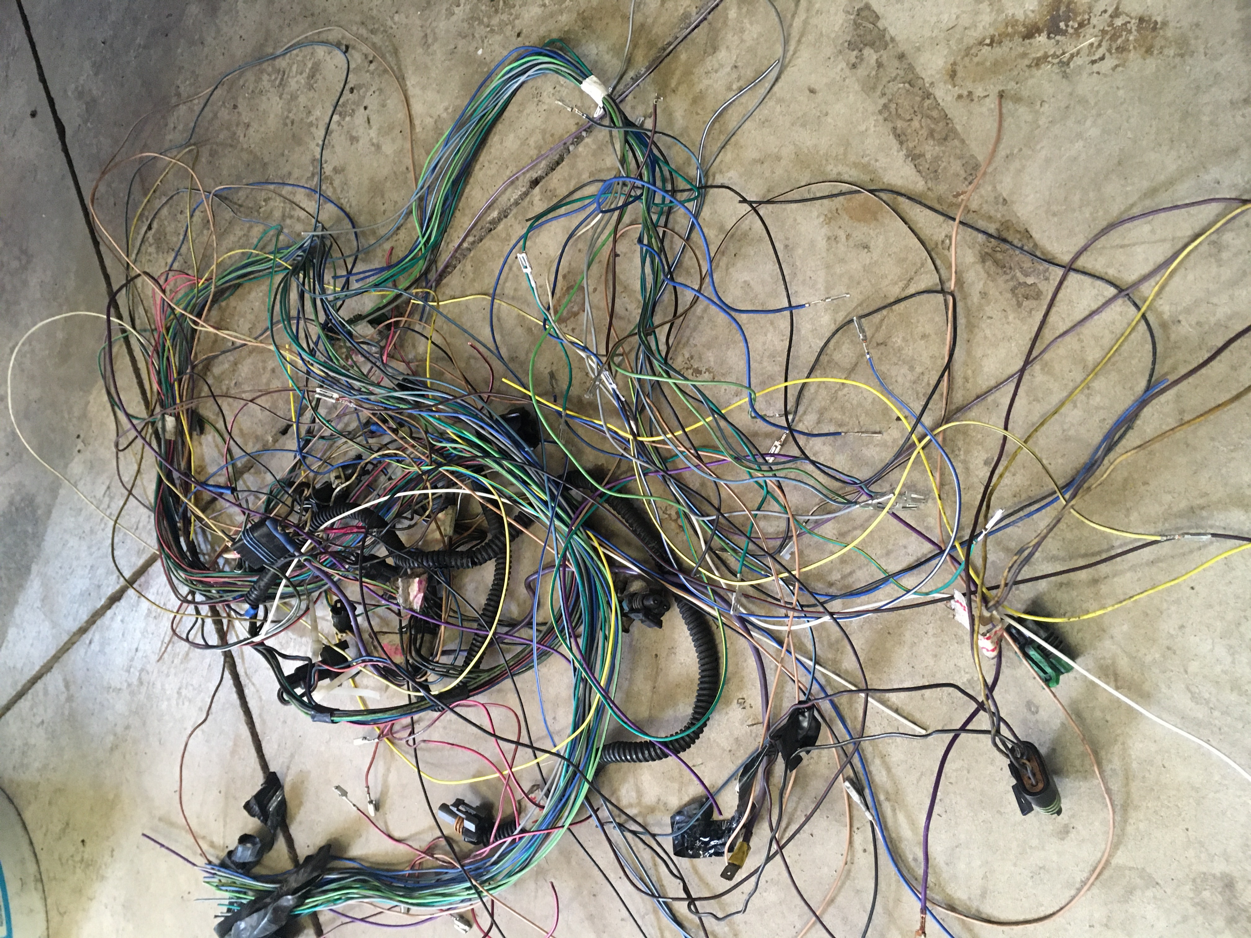

Removed the stock engine wiring harness. We've done 68 hours of racing with the Megasquirt it has proven itself. We'll get a spare Megasuirt set up for the next race

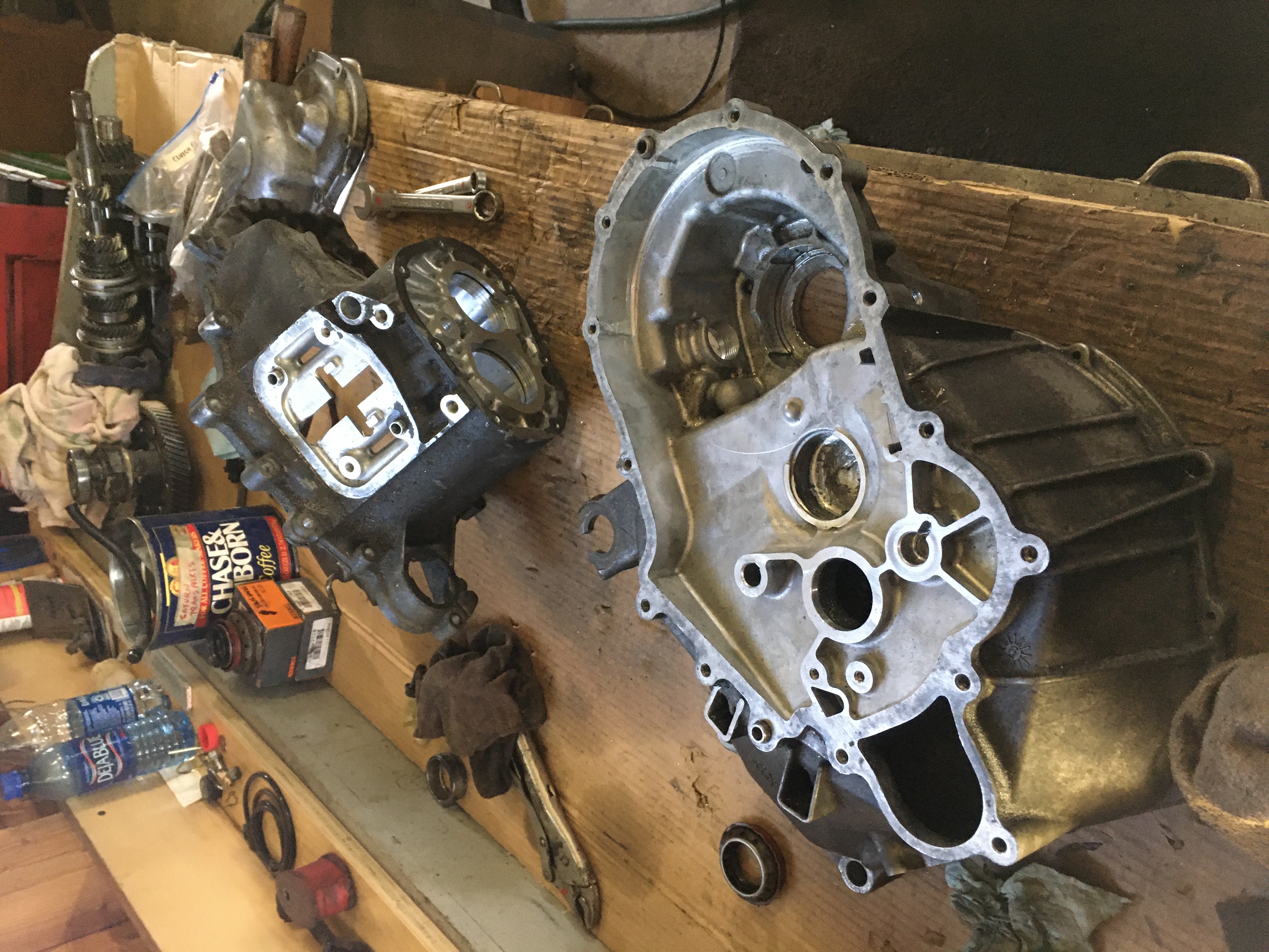

Also started on a transmission. I have enough parts to make one - so today I got to work preparing the case that lost a bearing at the end of the VIR race. Kurt had welded it shut but there was a lot of cleanup needed to install replacement bearing.

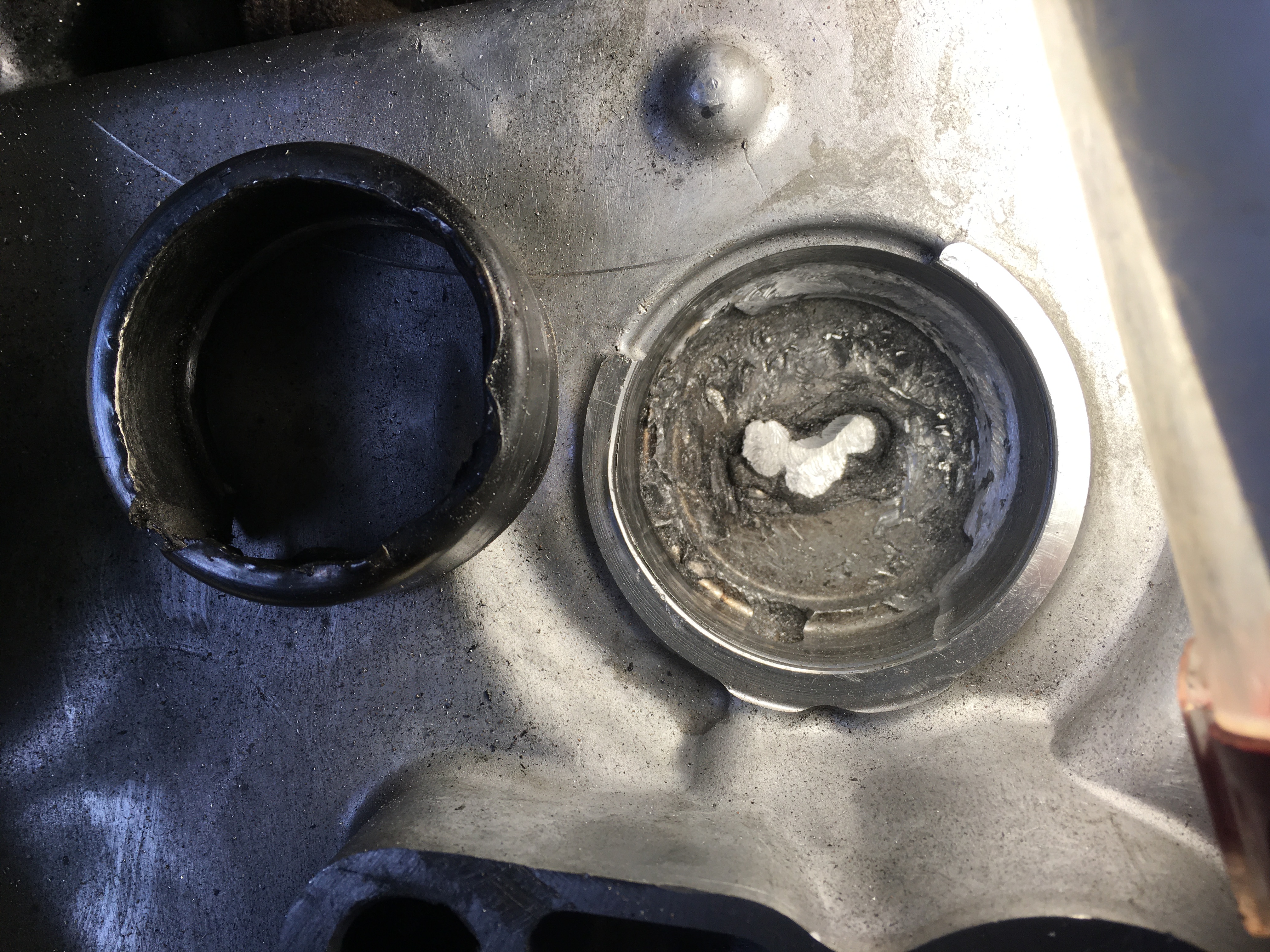

With no races in 2020 there was not much action after the track day in 2020. That day the car performed well.
This year we took the car to track day again, with very little prep work. Did make some adjustments to the tune as it was not idling right. Test drive left me thinking it was a bit down on power, but we still went.
We ran maybe three hours at the track day. Colin did not make over 101 on the back straight, and with 1:22 lap times I don't think the problem was the driving. Also loading it on the trailer uncovered some knocking.
Compression check found all the cylinders in good shape - over 180 psi. Oil and filter check found a fine sheen of metal in the oil and bits of metal in the filter. Engine of course had to come out. Tear down uncovered all the bearings in good shape. Further tear down located the source of the metal. The pistons in cylinders 3 and 4 both had cracks in the skirts and little bits of metal were breaking off the bottom edge of the skirts. By my records these had about 85 hours of track day use. They are Speedpro hyperteuctic. The rings were just seating into the bores. I went to get another set and they are discontinued - found a new set on eBay.
Reassembled the engine with same bearings and rings. Got help from Fred32v, Tiresmoker on the remove and install processes.
Draining the transmission I noticed a high amount of metal in the oil. This trans had only done two track days. With it sitting on the floor I chose to disassemble and inspect. Found everything to be in good order - I can only assume the parts that were in the blown up case had lots of shavings left over so I cleaned what I could see off the case and put it back together.

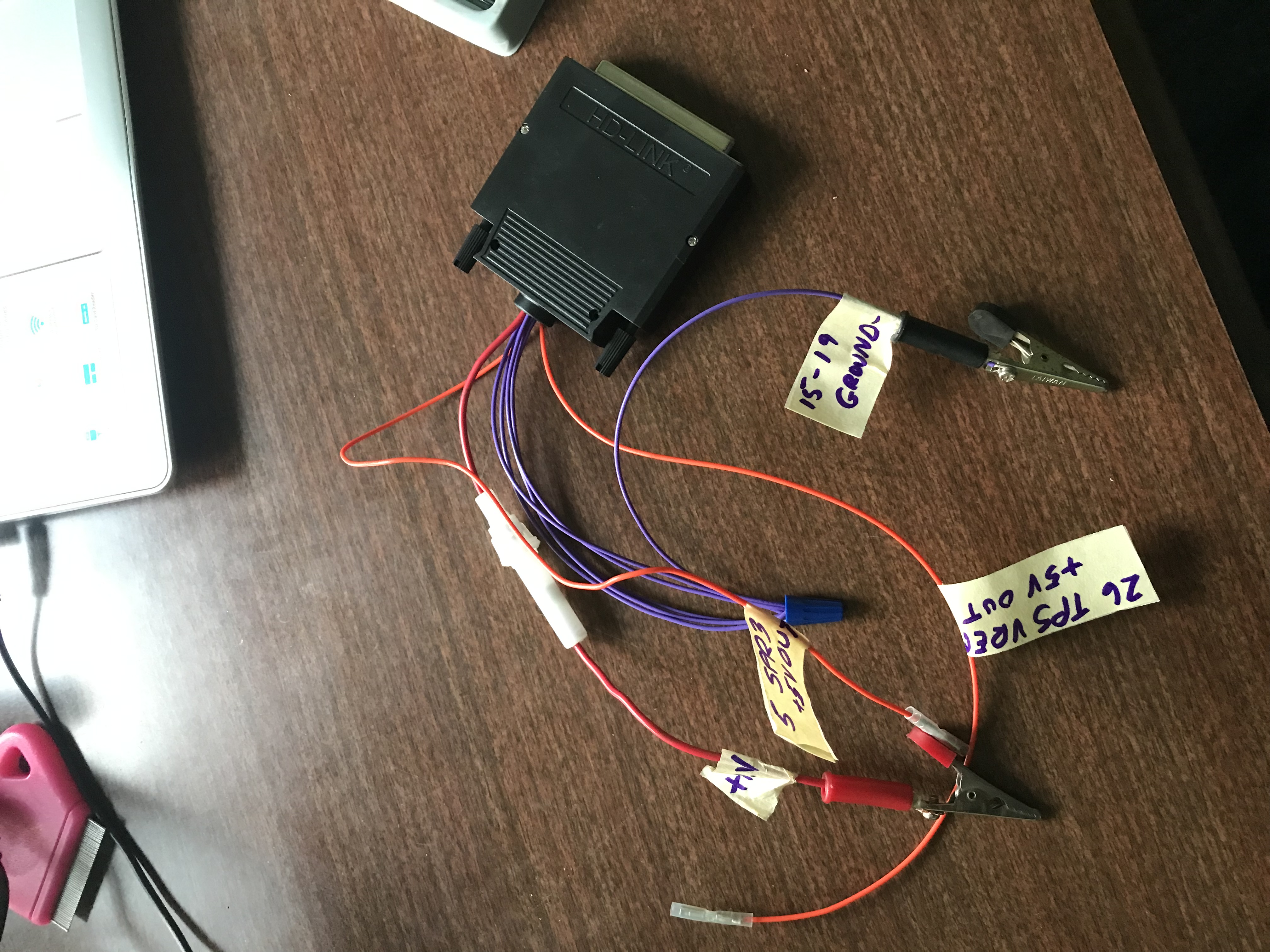

So on to the next problem - why was the DIS not getting the signal from the ECU. Well there are two wires going to the DIS from the Megasquirt. One provides instruction on when to fire, the second is a "signal" wire that tells the DIS to use the instructions from the ECU. The signal on that wire is +5v DC, but the wire is only sending +4v DC. When I send +5v DC to the DIS it works just fine off the ECU instruction wire - which I can see with the timing light. Kurt had a device where I could specify what DC voltage I wanted and when I hooked it up to the signal wire the timing changed.
Now the Megasquirt is supposed to send +5v to the TPS and down this signal wire. Last night I was able to confirm that the TPS wire is getting +5v while the DIS signal wire is just below +4v.
I know which pins are outputting these two signals so the next step is to figure out why the DIS signal voltage is low. I'll check the resistance in the wire then try to get the voltage output right at the pin coming out of the Megasquirt. I might need to look in the case. If all else fails I can experiment with splitting the TPS +5v and see if it will work for both, or make my own source of +5v and make it so the car requires the ECU signal at all times. For reasons I do not understand the factory configuration has the car starting with the DIS not using the ECU signal.

I now have a temporary harness for testing. Should have some test results tomorrow
Posts: 3046
Re: cheap car racing
Made a lot of progress. We had one wire set up incorrectly. With that sorted out I put the unit back together, bench tested, then put it back in the car.
There is another problem. The signal wire to the DIS from the ECU should be 0 volts until the car runs for 5 seconds then send +5 volts. 0 volts tells the DIS to control the timing and 5 volts tells it to accept the timing from the ECU (how the factory ECU works as well). The problem is that the signal wire is doing the exact opposite. The DIS has a very basic timing advance and while it will run this will not be optimal performance. I've got some digging to do to figure out why this is so.

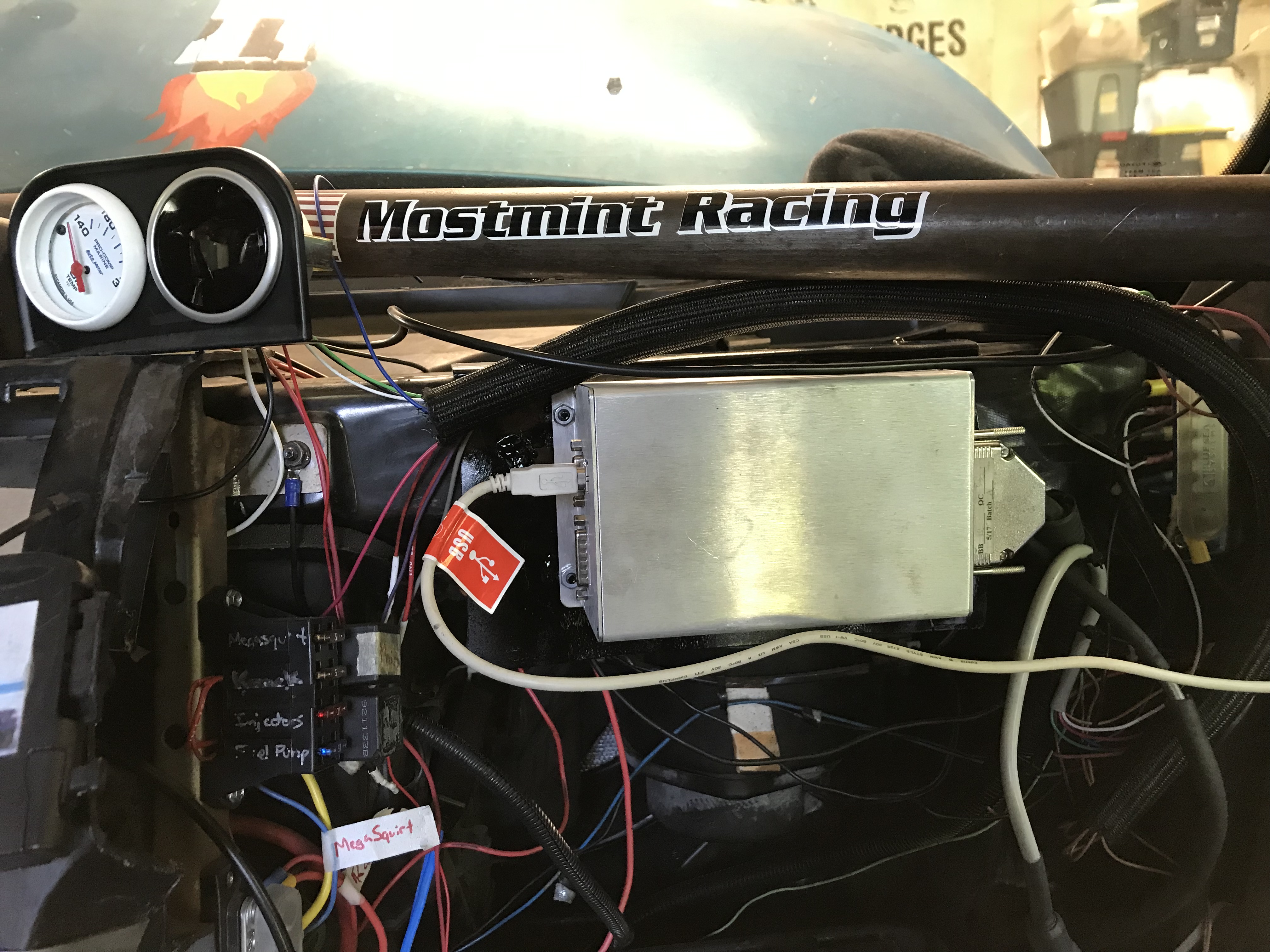

Getting closer to calling the MS3 conversion complete.
I have a laptop sitting on a card able next to the RF fender with easy access to the remote start switch. When I'm in the garage this is where I do most of the work.

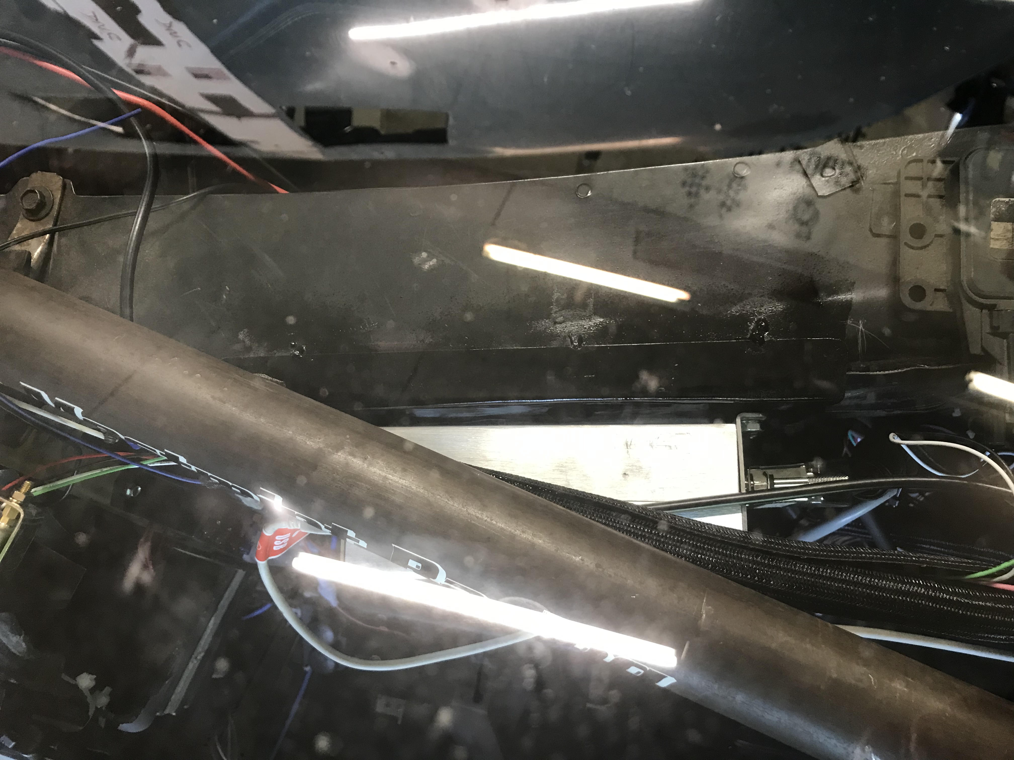

Also created a plate on which to mount the Megasquirt - building something sturdier to keep it in place during the rigors of racing, relabeled all the plug wires and coil packs, fixed the low coolant light (it gets power from the fuel injector fuse - which had been removed since we not using those wires anymore).
Posts: 3046
Today the mounting plate project for the MS3 is complete. We had some adventure as the welding caught some material in the duct on fire but it was tiny and we just used a syringe to shoot some water in there and put out the flames.
If I had it to do over I would have made the plate bigger and mounted the fuse and relay block on it as well.
