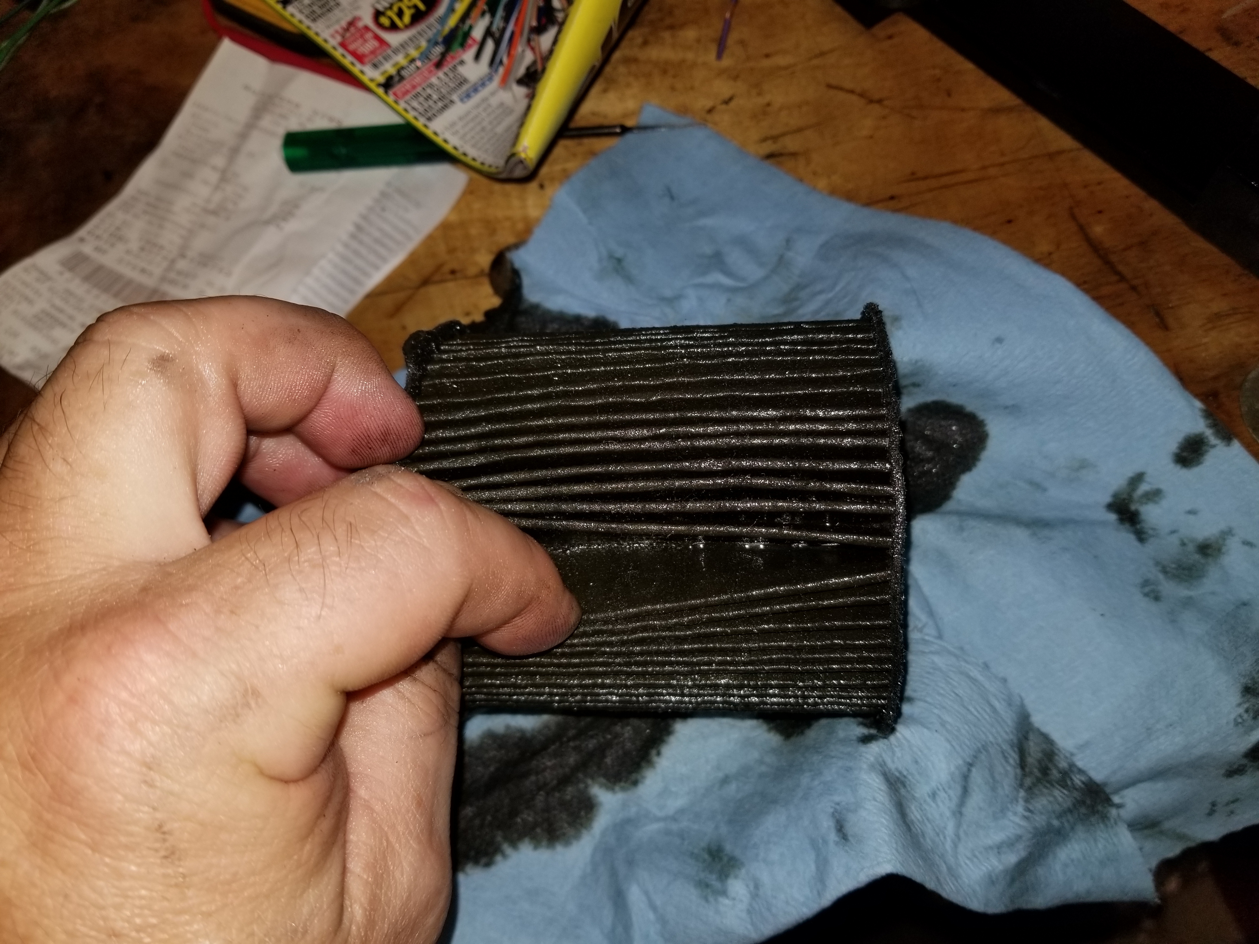

I checked under the valve covers before the tow truck arrived. Looked good to me. I cut the oil filter open tonight, but I'm not seeing any real obvious garbage. I did glue a couple magnets to my drain plug, but havent drained the oil yet.

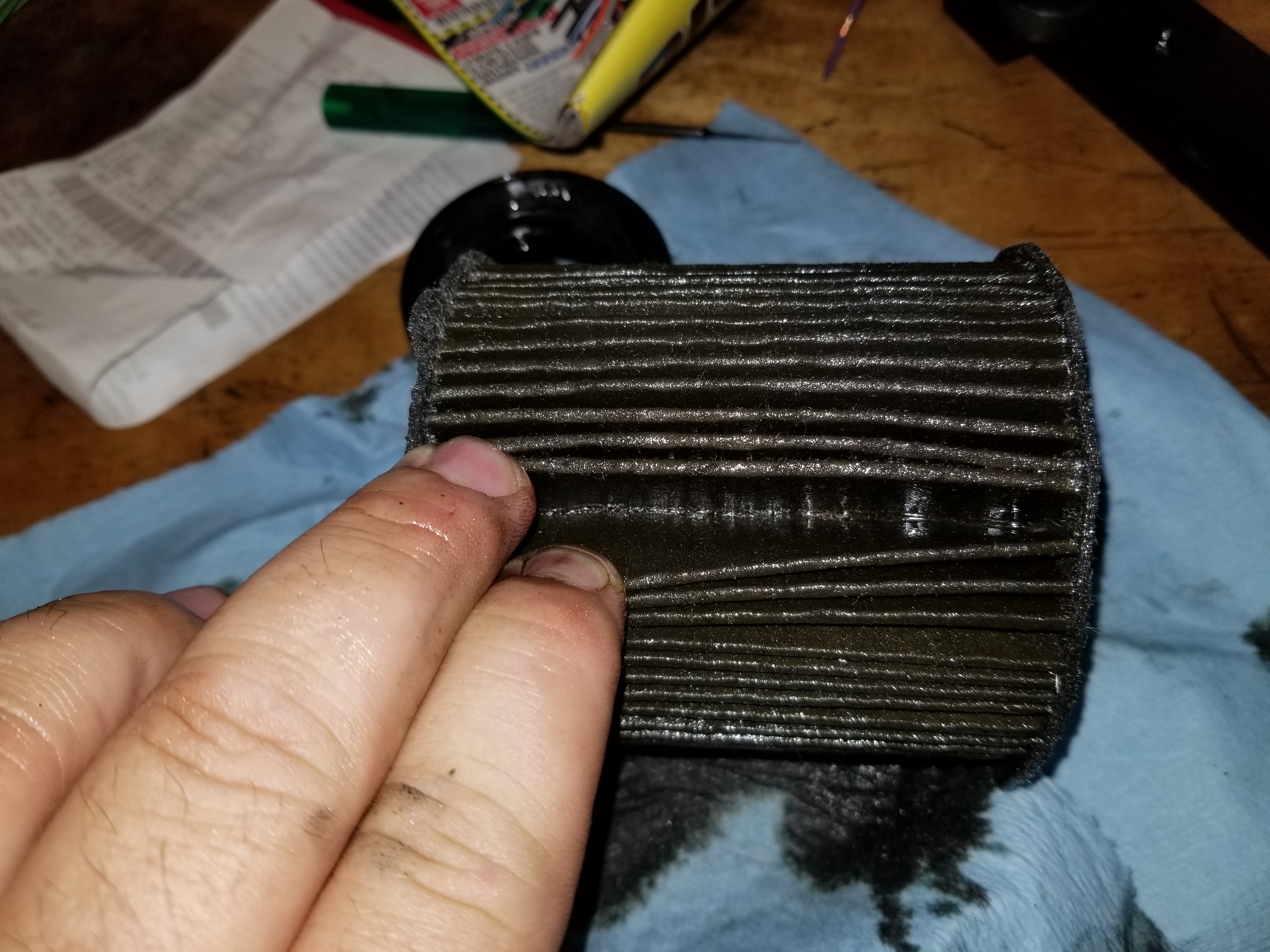

After a suggestion to actually pull the pleating apart on the cut-open oil filter, I'm seeing plenty of metal fragments, confirmed by running a magnet and picking up pieces. The engine will be coming out. It's just a question of how much collateral damage there is.

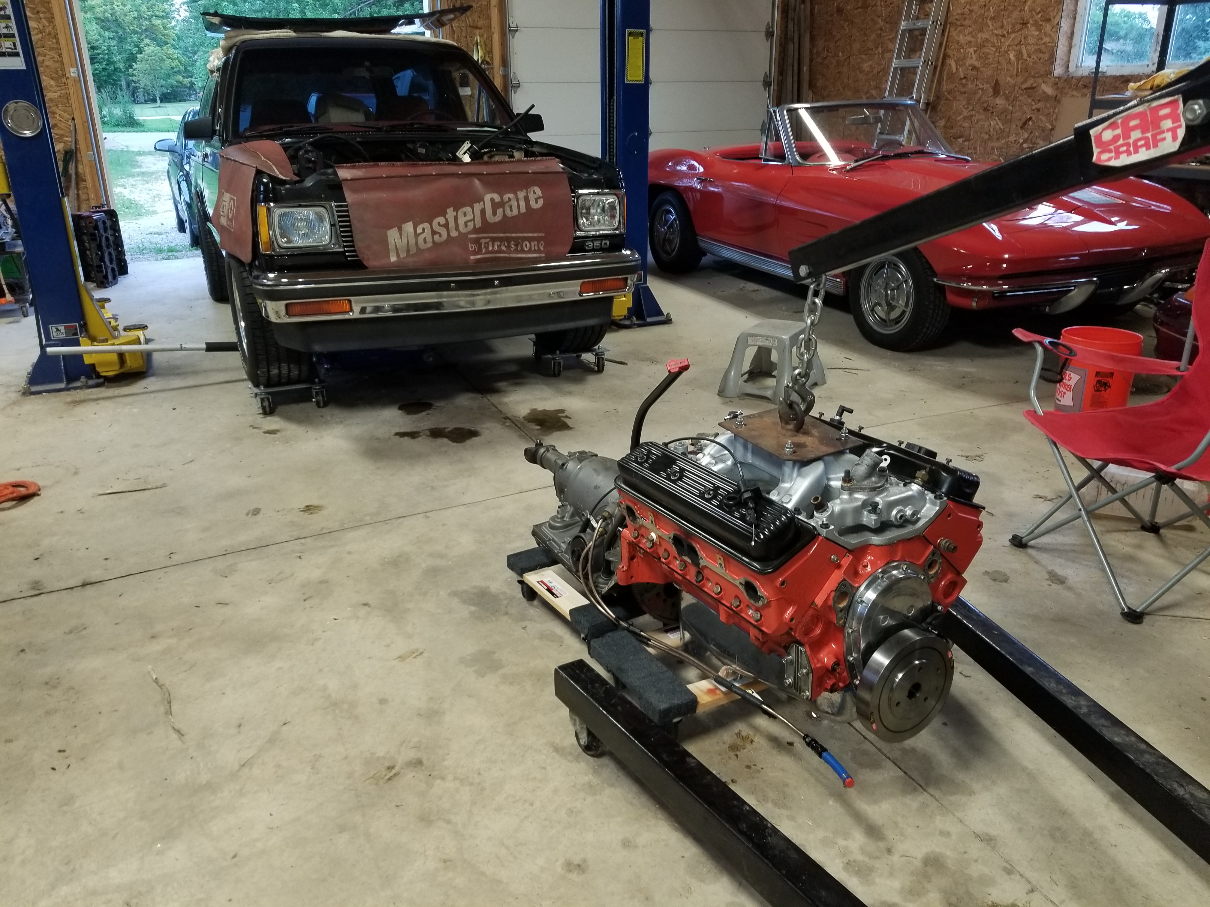

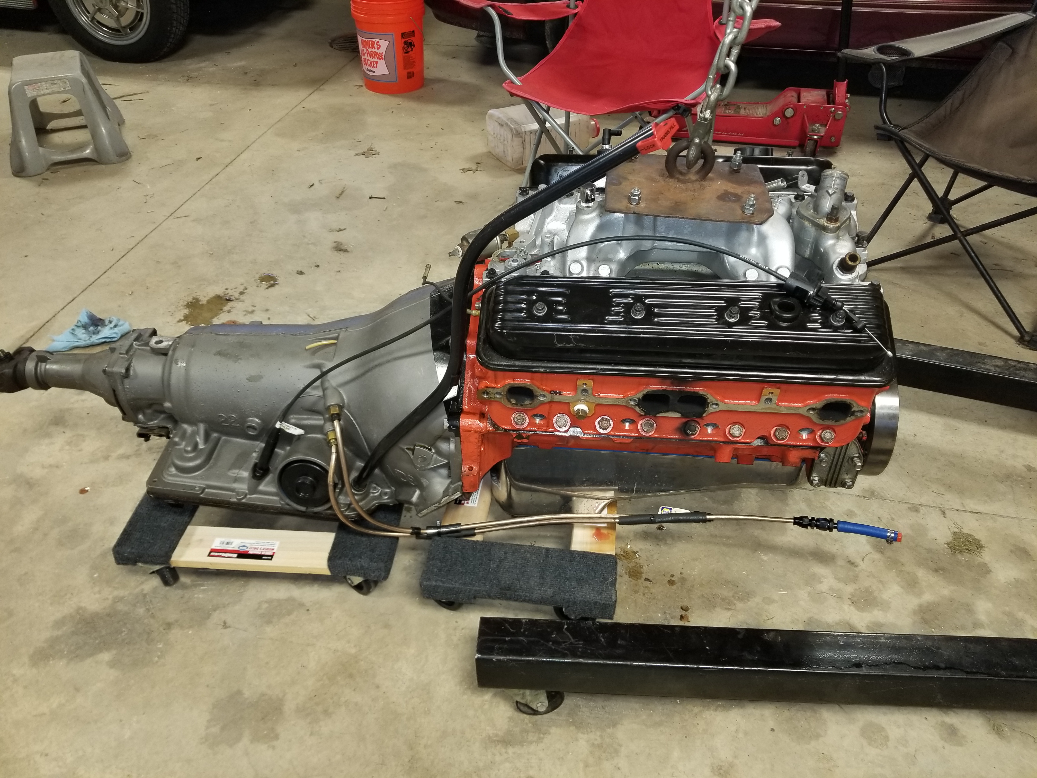

Re: 1985 V8-S10 Blazer
Got the engine out last night. Paul came over in the evening and we had it out in probably 10 minutes since I already had everything disconnected.

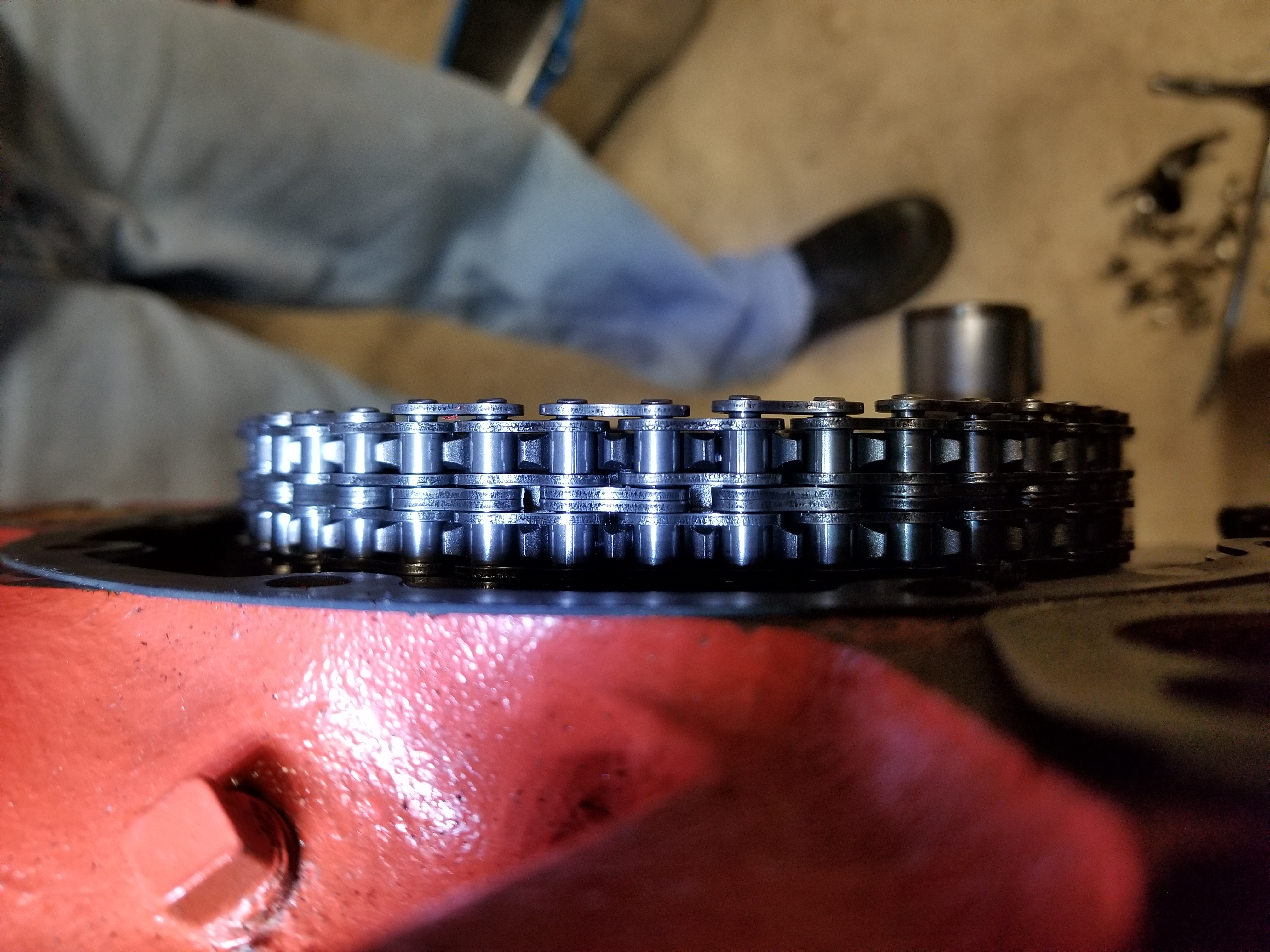

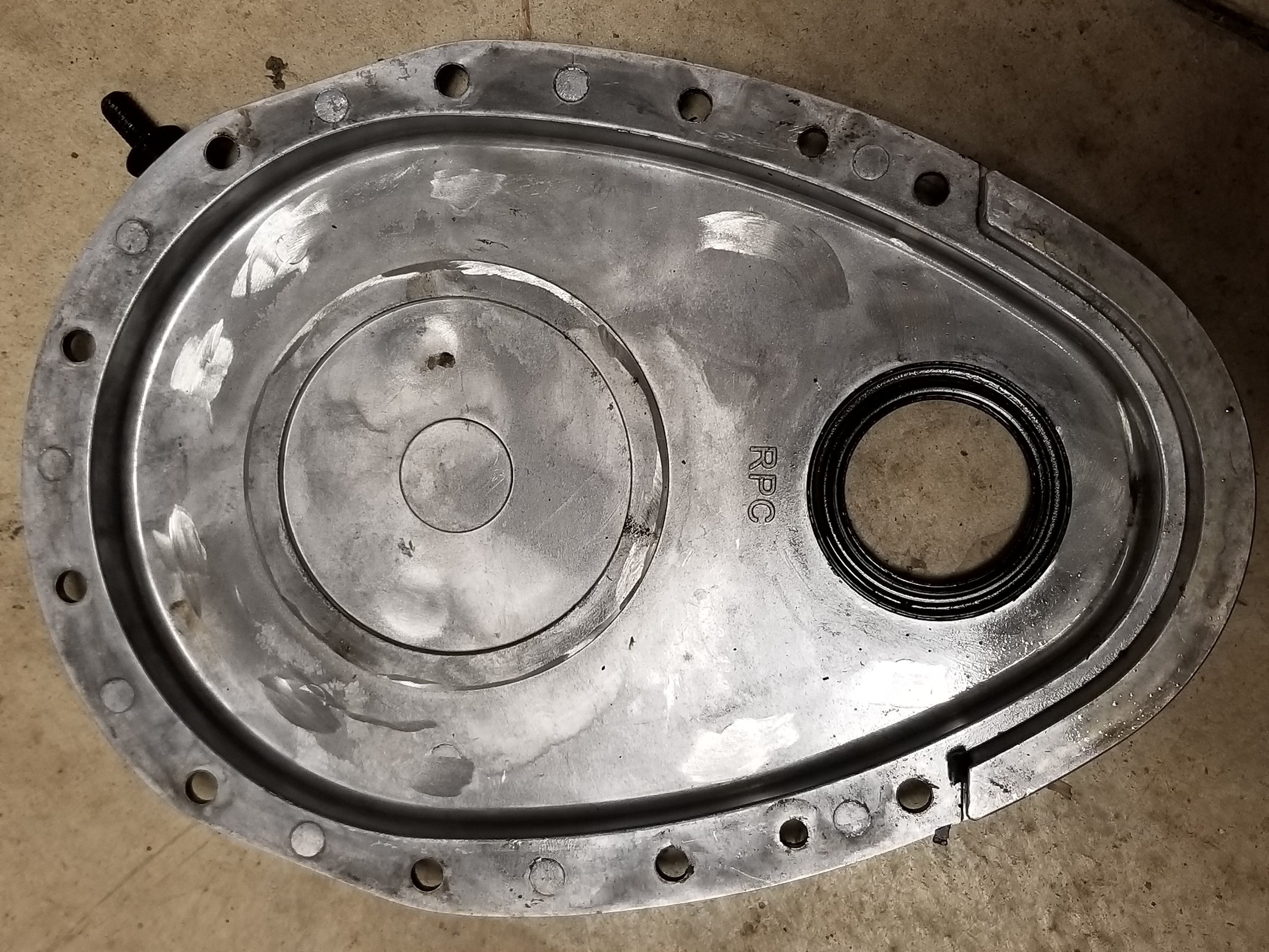

After some disassembly and inspection, it appears that the timing chain was making contact with the cover. Luckily, the cam and lifters all look fine. We didn't pull off any rod or main bearing caps, since it still had oil pressure.
The plan right now is to replace the timing chain, timing cover, oil pan.
Any guess as to WHY the timing chain was rubbing the case?
- Posts: 2638
Because it's junk I bought off ebay?? Not sure other than that. We measured depth of the cover from the mounting flange, and the old stock-like steel one that was removed was 0.1" deeper, which certainly seemed like enough extra clearance. I checked a couple ebay listings of a similar looking part to see if there was any mention about only using a single-row timing chain, but nothing found.
