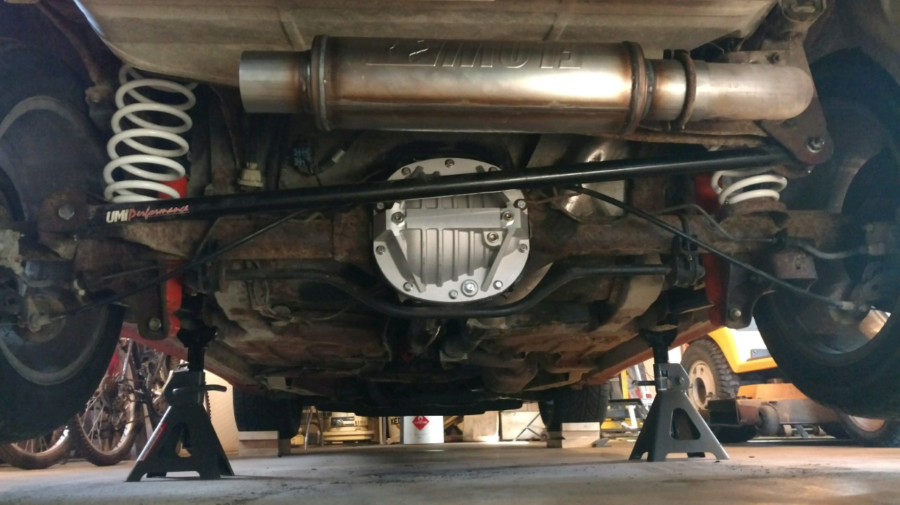

- Posts: 3684
Re: 1997 Pontiac Firebird
Today we basically finished the new 3.90 gear install. During the week 32V finished the axle stud install, so all that was left was to add fluid and put the new muffler on it for our test drive. During this process we also installed the new urethane torque arm bushing, the "new" aluminum driveshaft with actual new u-joints, and the "new" used tubular lower control arms. We still have to fabricate a bracket extension for the exhaust hanger on the drivers side and we'll be able to put at least one tailpipe back on.
The new muffler fits perfectly and is actually a little quieter than the flowmaster we took off. It's also a lot smaller and lighter, but the smaller aspect is the best part as we can now actually slide a jack under the pumpkin from straight behind the car, which we couldn't do before because the car was too low and the muffler was too big. We'll only have one tailpipe now, but I'm willing to sacrifice a little look for more function, simplicity, and weight reduction.
We got the wheels back on, dropped the car down, and did take it for a quick trip. We didn't beat on it because the rearend gears still need a few more heat cycles, but at least everything we did seems to function as designed. With the nice weather sticking around for several days, I expect 32V will be happy to finish the heat cycling and put a few miles on it after that.

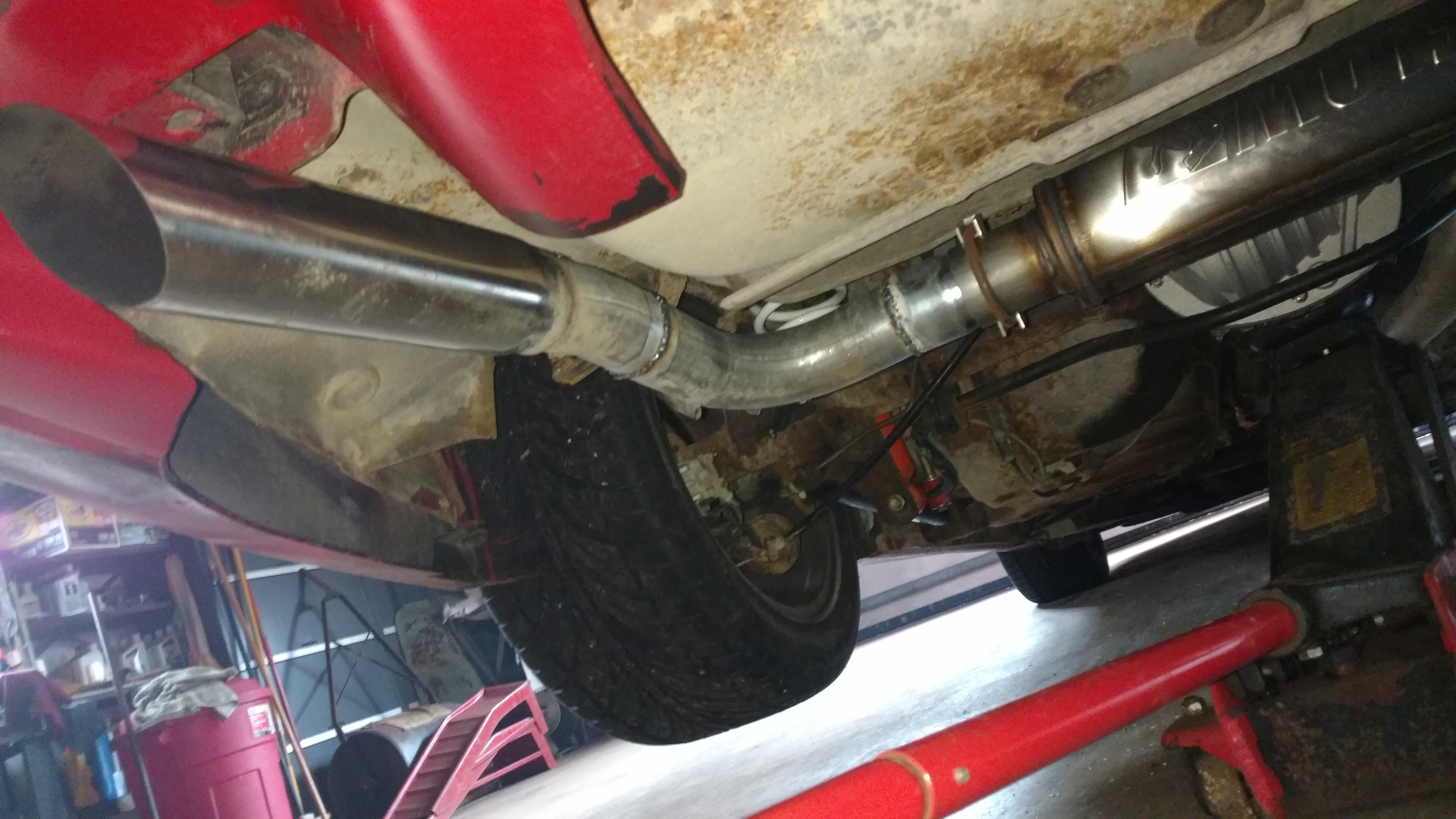

Yesterday we were able to finalize the exhaust after I brought the welder over to 32Vs place. We welded up an extension to the hanger, welded a spacer into place, and then had to cut out a section of the tailpipe to complete it. We also got the new steering wheel install done.
32v got the rearend break in done over the last week, and we went for a more aggressive test drive. The new exhaust sounds good, and the new gearing and aluminum driveshaft have definitely helped out the performance. It's noticeably quicker than before.
Next we turn our focus to the interior. We'll be removing unnecessary parts and fixing the holes in the floors.

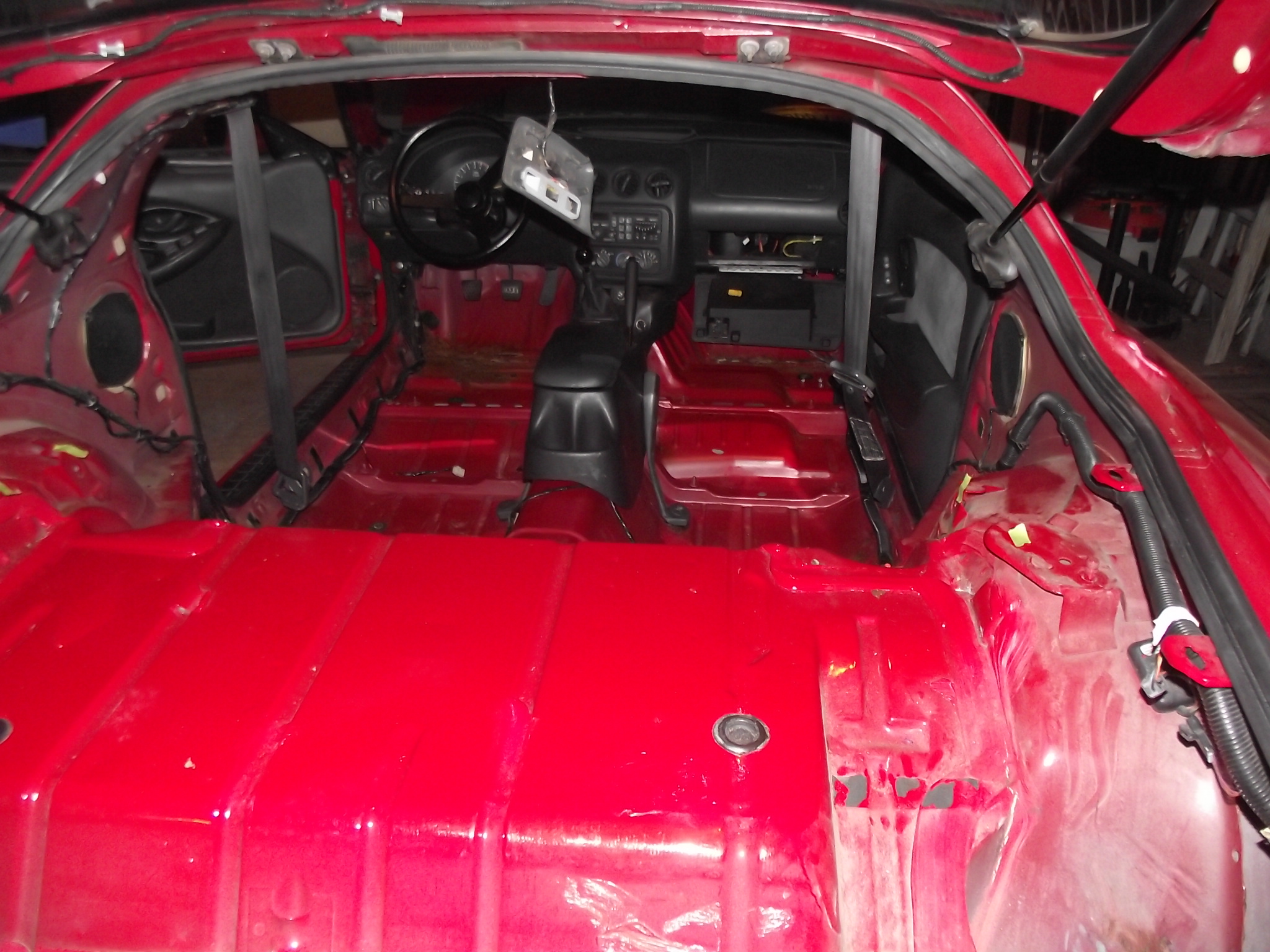

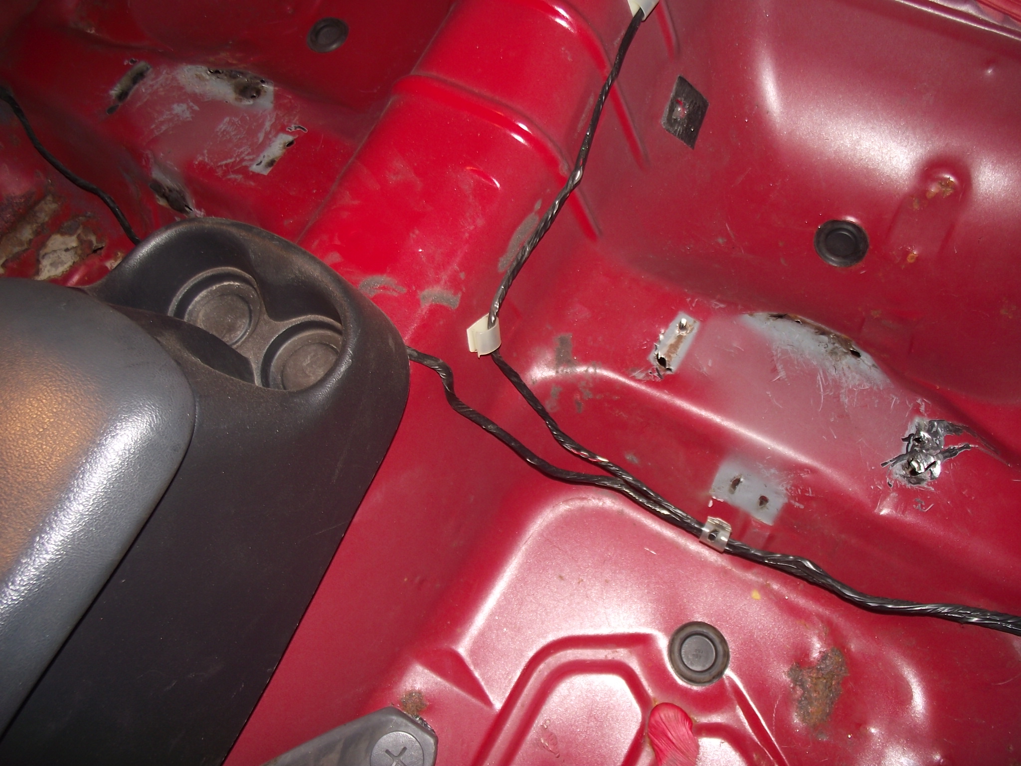

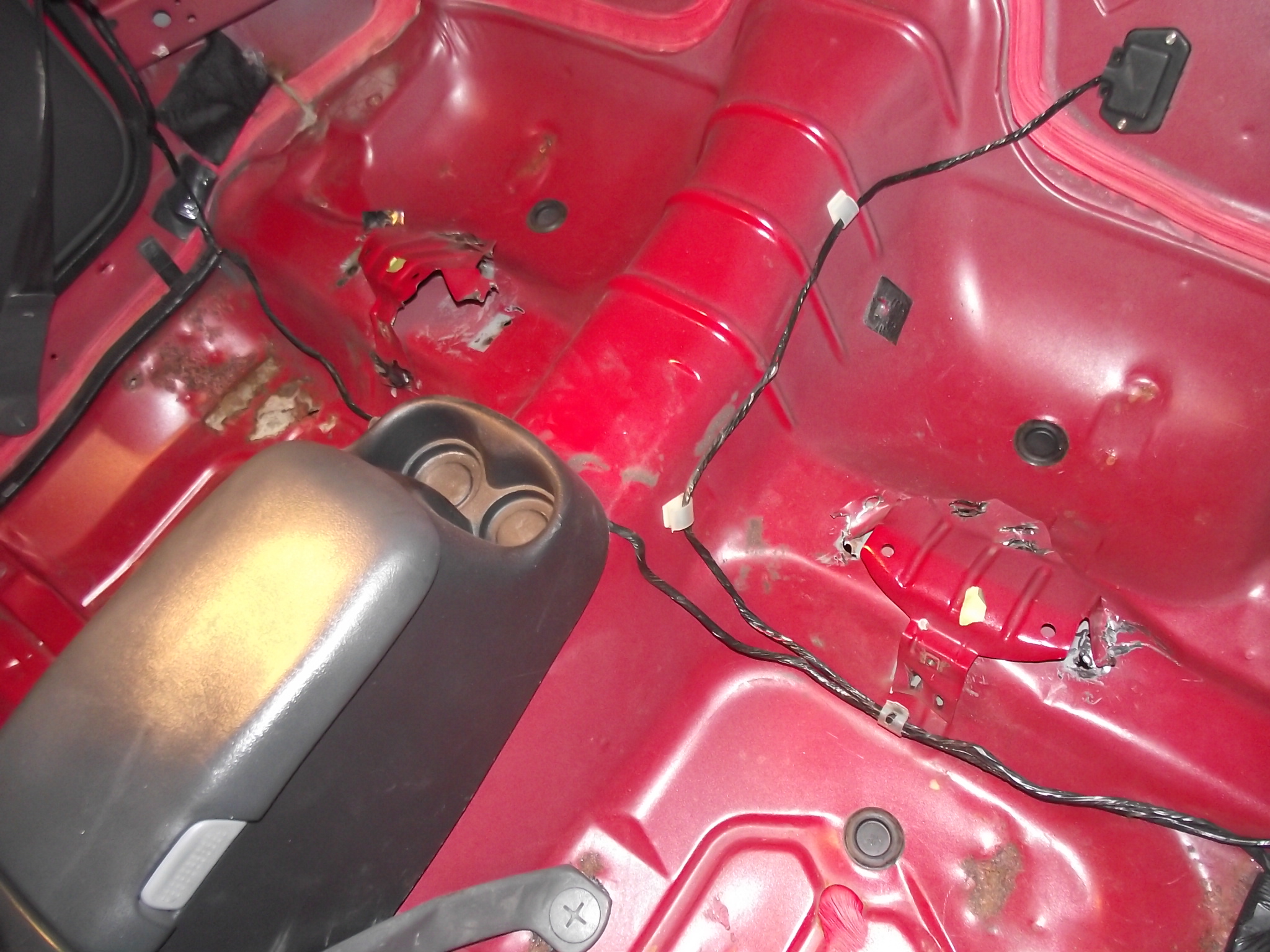

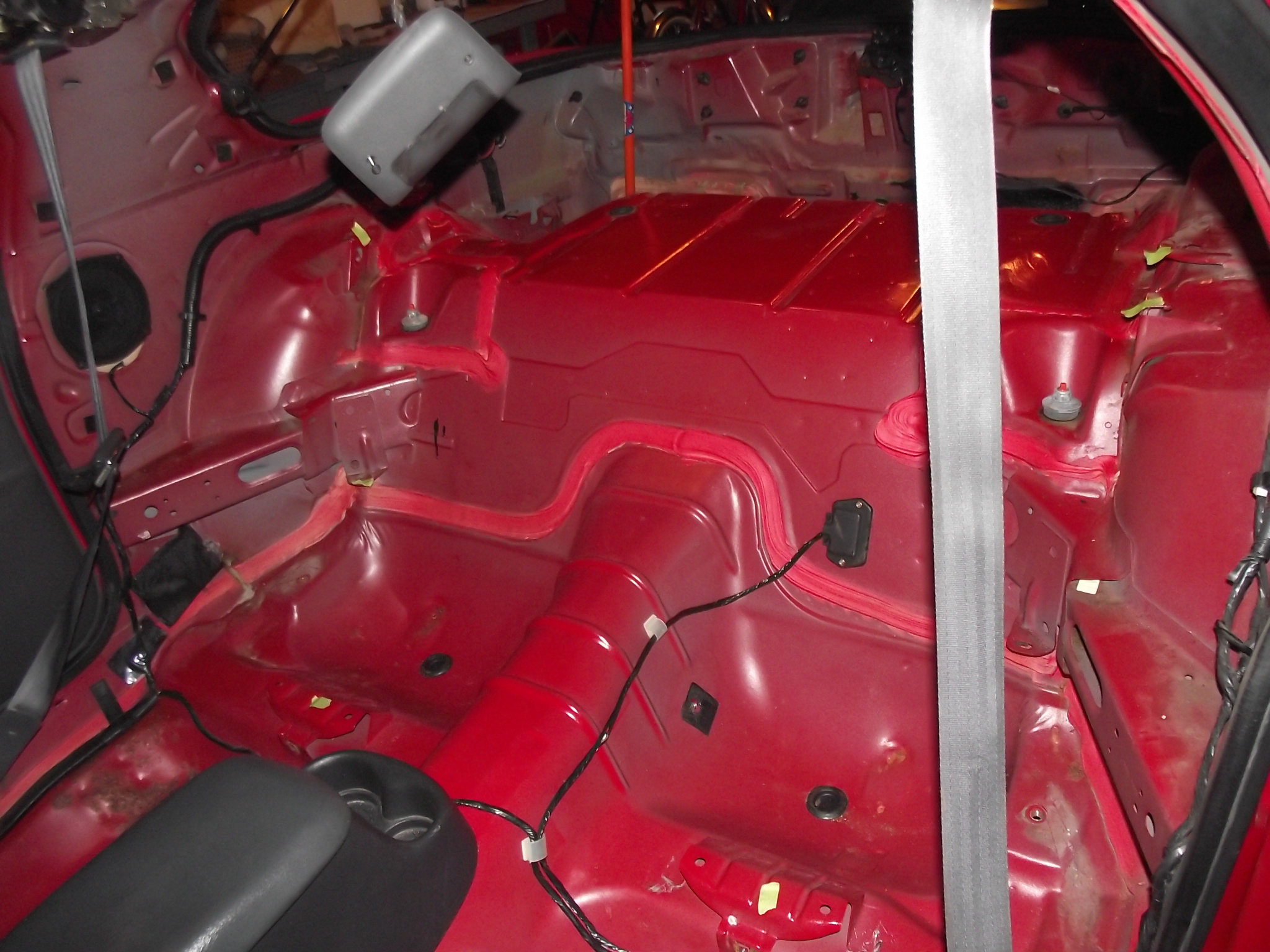

Re: 1997 Pontiac Firebird Interior cleanup
Shortly after Saturday morning breakfast at Bob's with BP and 'Smoke,
there was a fun busy couple of hours in the 32V Garage.
The pictures show what's been done.
So much more to do.
(Looking ahead to what this could turnout to be.)
So much more to do.

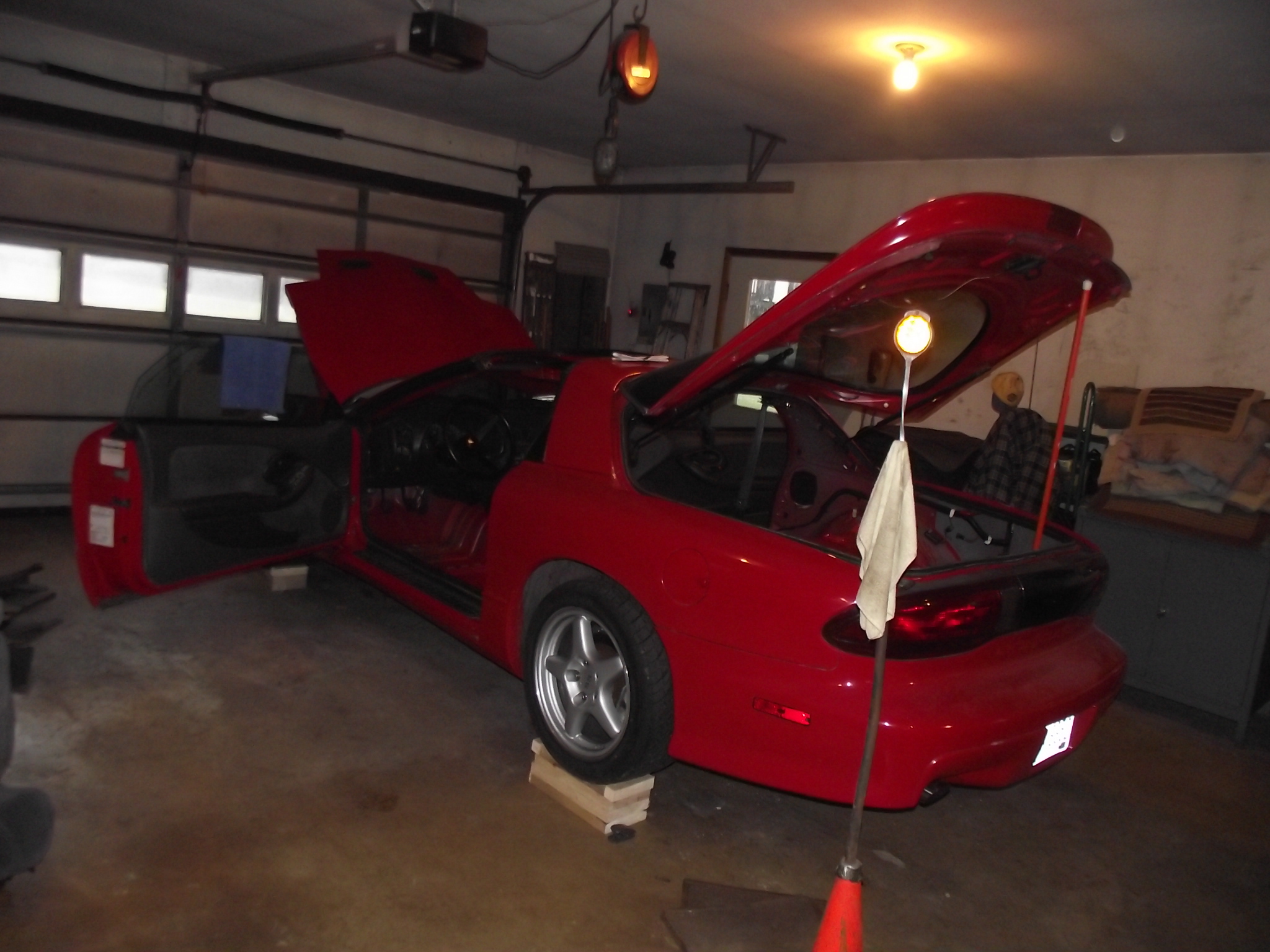

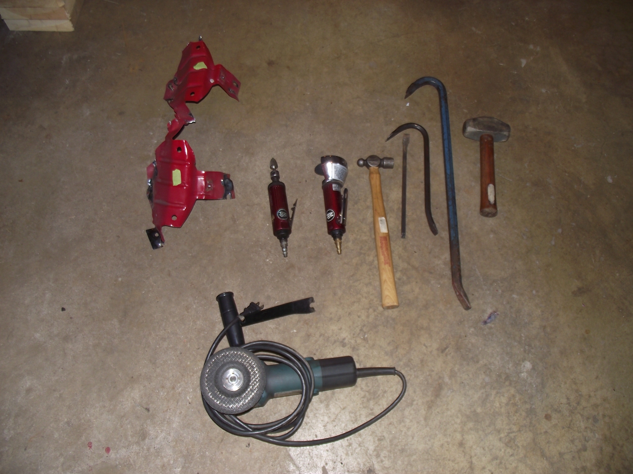

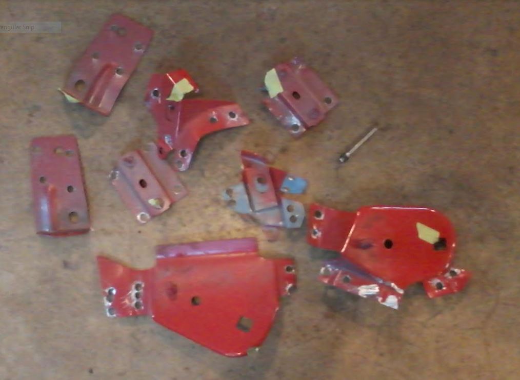

After diner Sunday, I went out to the 32V Garage to see what it takes to remove
unneeded brackets and continue the process of weight reduction. I invested an hour and a half to take those two brackets out. This was labor intensive,
sparks and grinding dust filled the car. When done it looked like a sandy desert
and you can see the damage from this extraction technique.
I have ordered a Spot Weld Drill Kit, expecting this special tool to reduce the huge mess,
eliminate much of the damage and to reduce the amount of time to undo a spot weld.
(OK, it was still fun.)
Spent the afternoon in the 32V Garage using the new spot weld drill.
It still takes some effort but the tool does make it possible to remove
unwanted brackets if you can get at the spot welds. Some came clean, others not so much.
There will be some welding up of holes and damage.
I have red paint somewhere.
(I think I lost more weight than the Bird.)

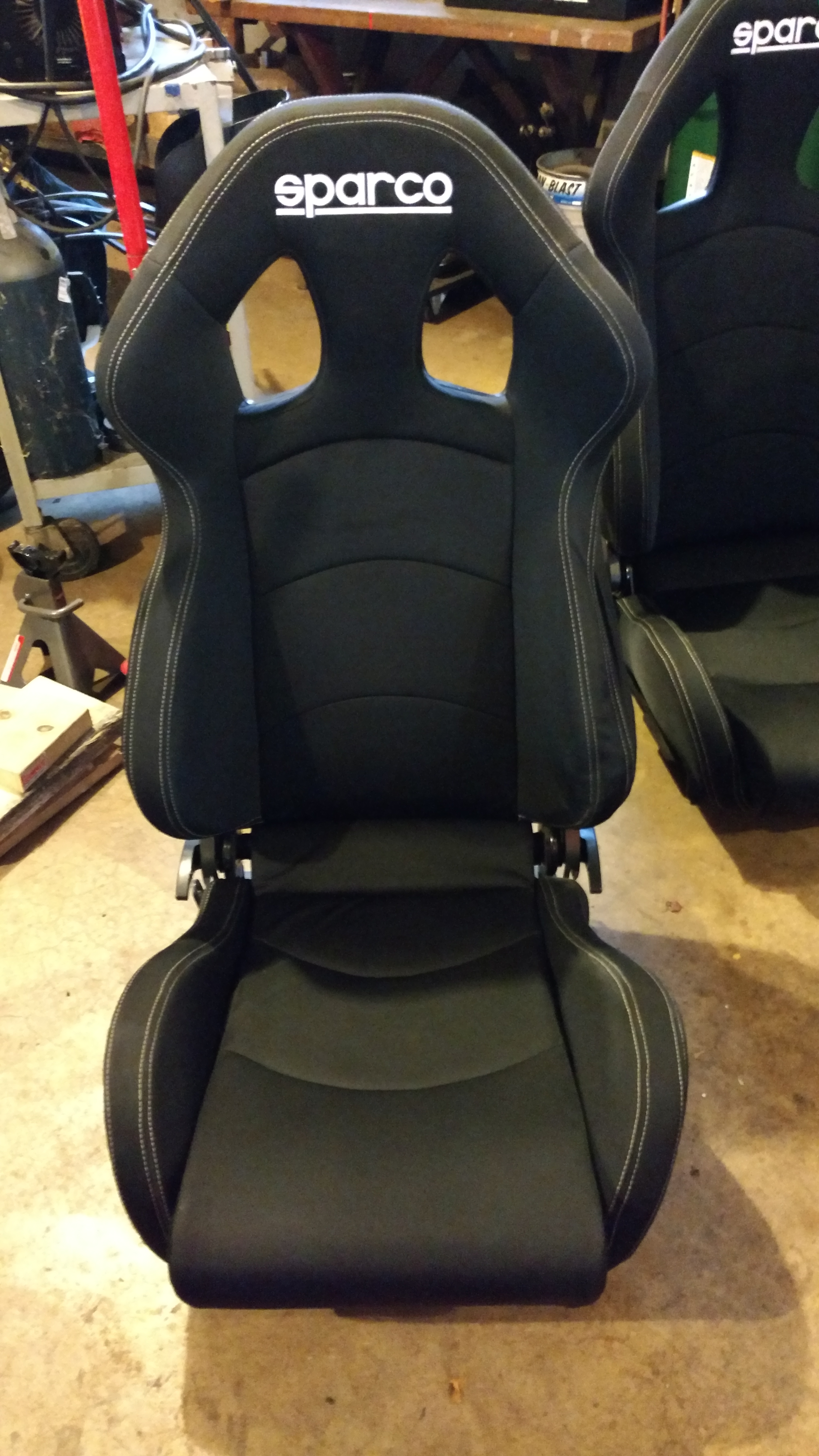

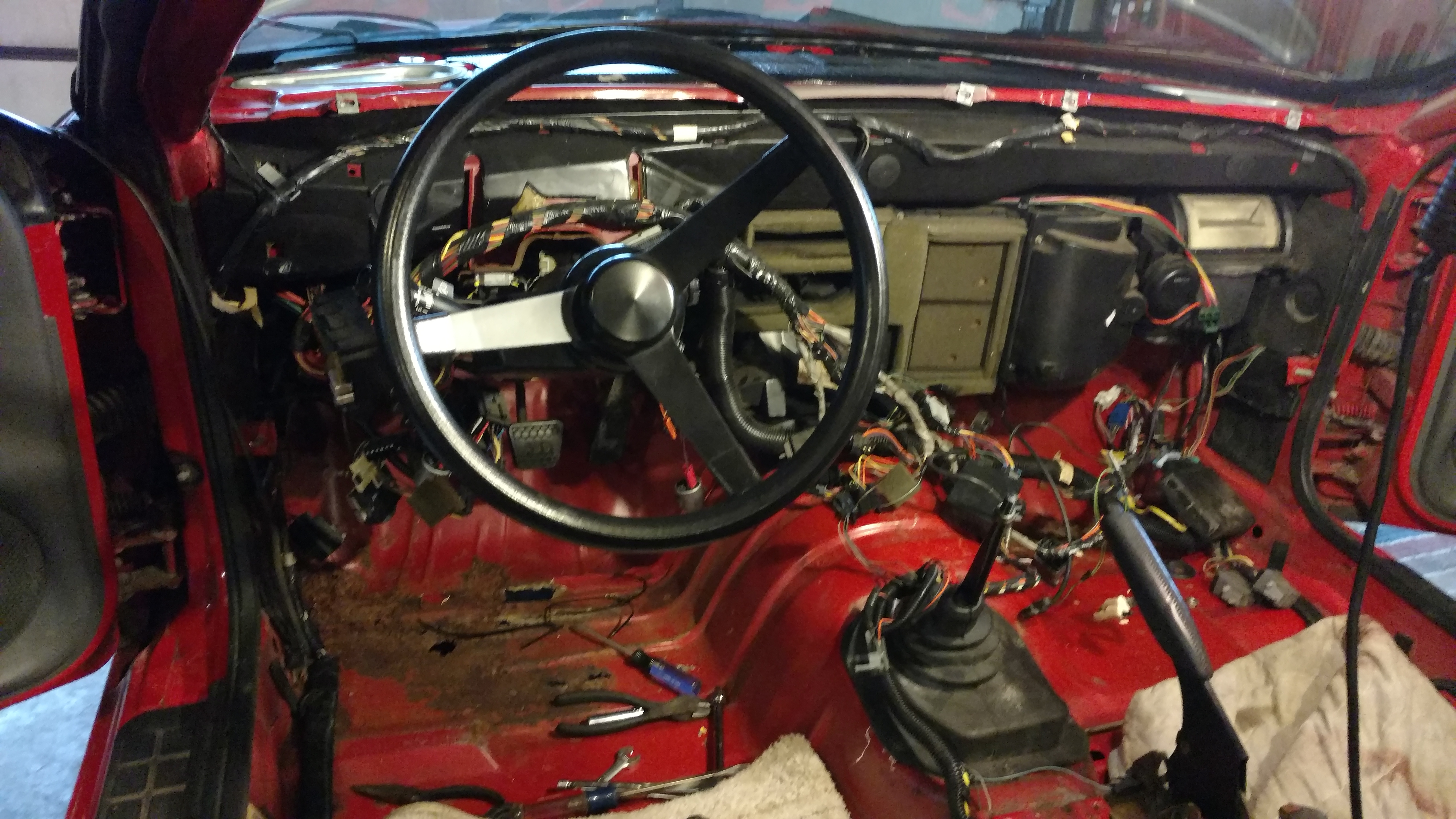

Today we started after breakfast with a trip to The Basement at Tiresmoke Central where we worked a deal with Dave for some nice Sparco seats for the Firebird. These are not for weight savings, they are for support on track. The factory seats have very little support, and these will work much better keeping us in the seat on track.
Back to 32Vs place and I spent a few hours getting the dash assembly removed. This has created some extra work for us, but it was a pretty noticeable amount of weight, so it was worth it.

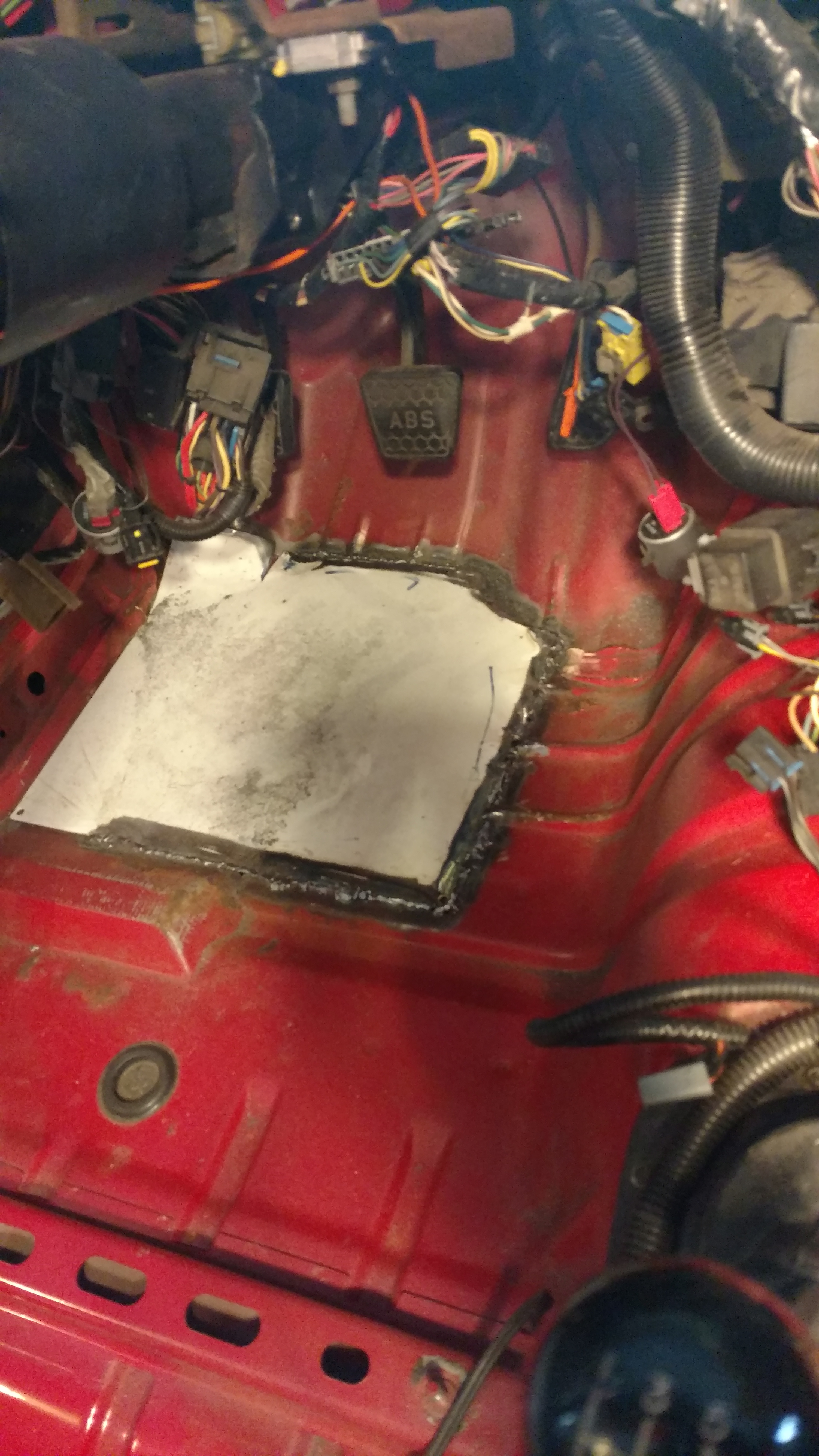

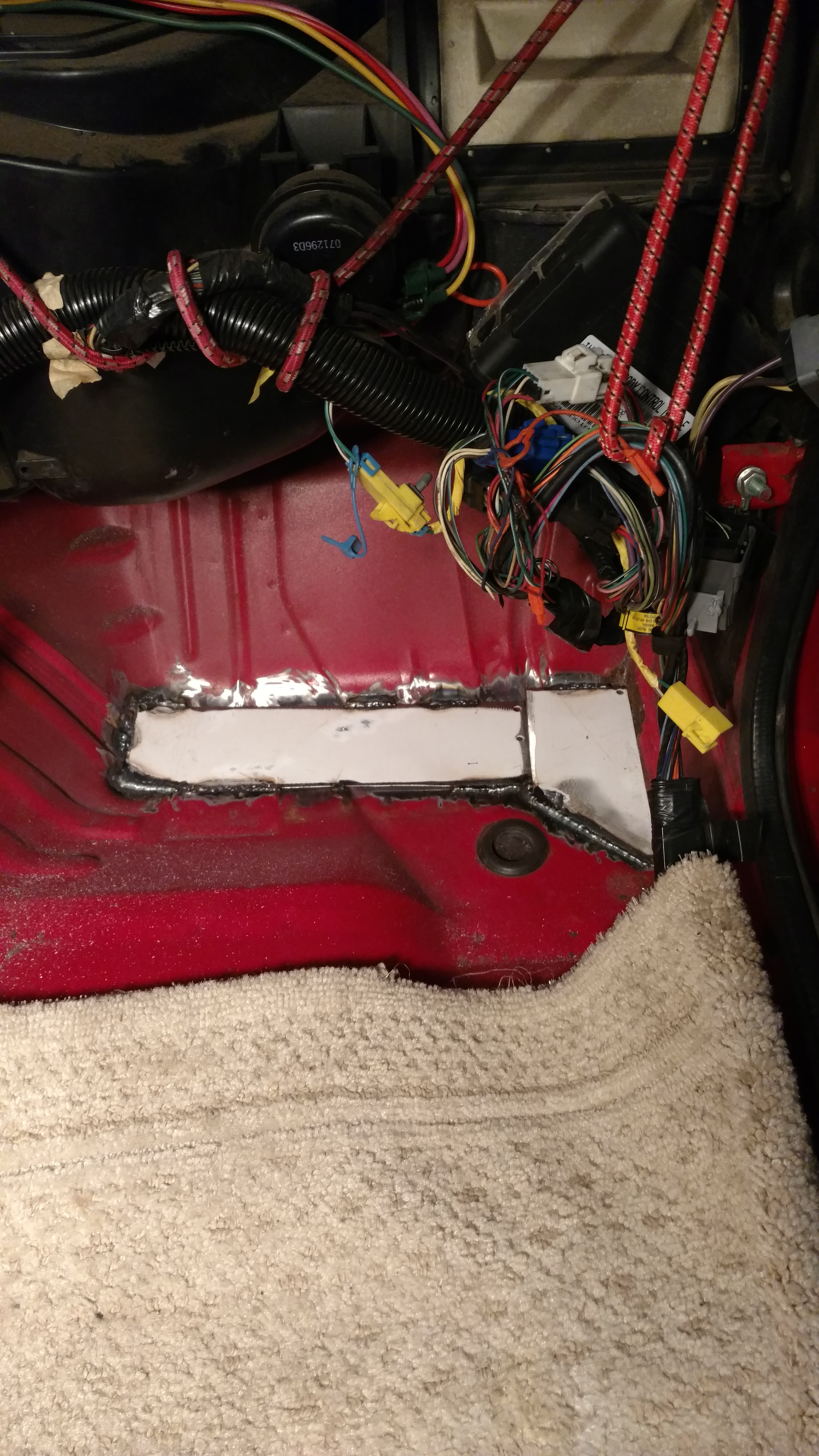

- Posts: 3684

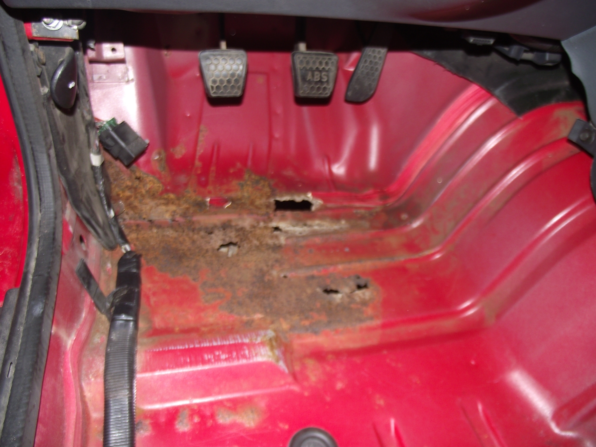

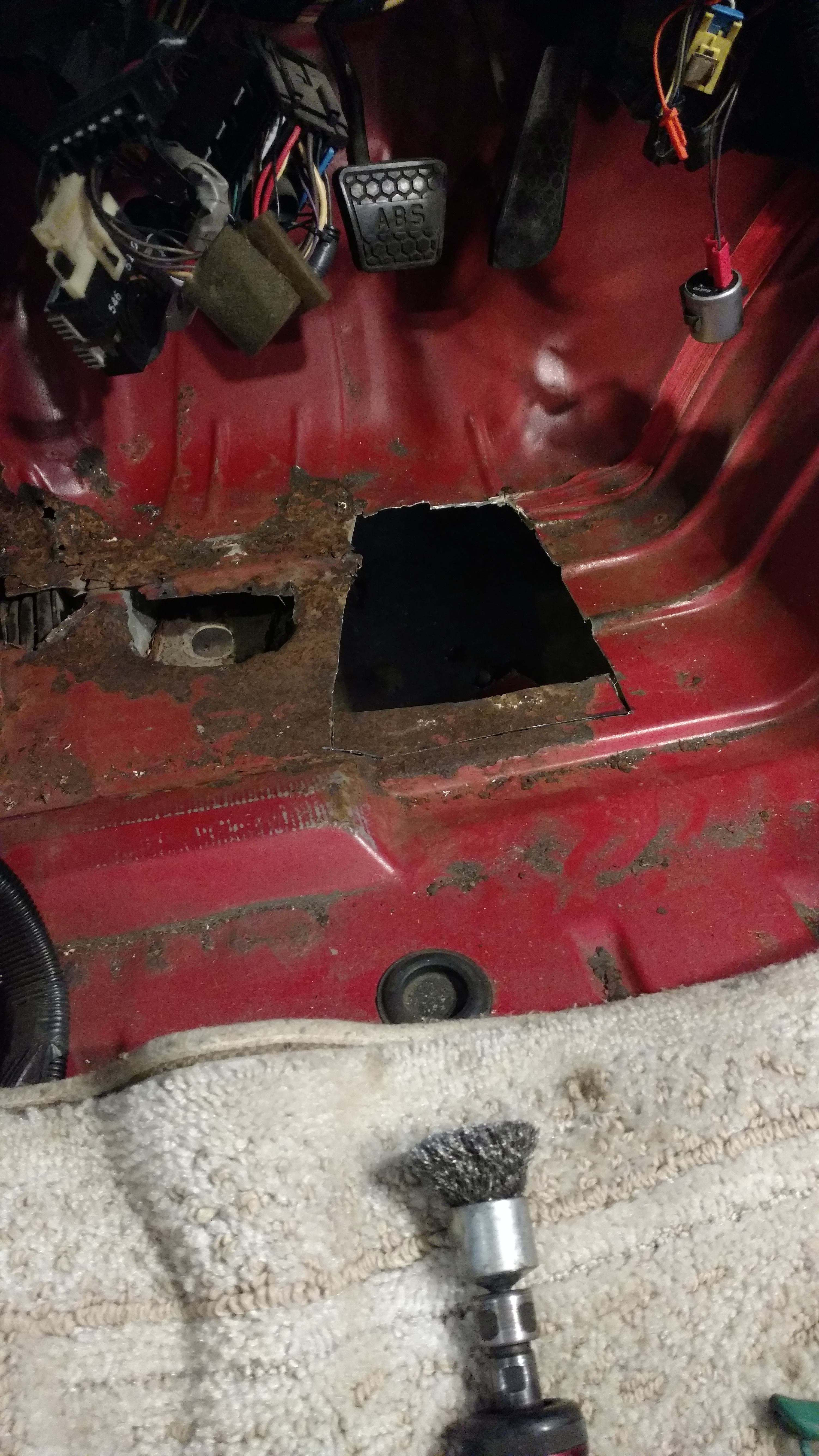

Last Saturday we started tearing up the rusty parts of the floor on both sides. I ran out of weld wire while finishing the driver's side. So today after buying new wire, I went over to finish what we started.
It's not beautiful nor does it make the car faster, but at least the Flintstones won't feel at home in it now. We're still planning to put down paint on bedliner on both sides of the floor in front too.
Then on to the seats, radio, and HVAC.
