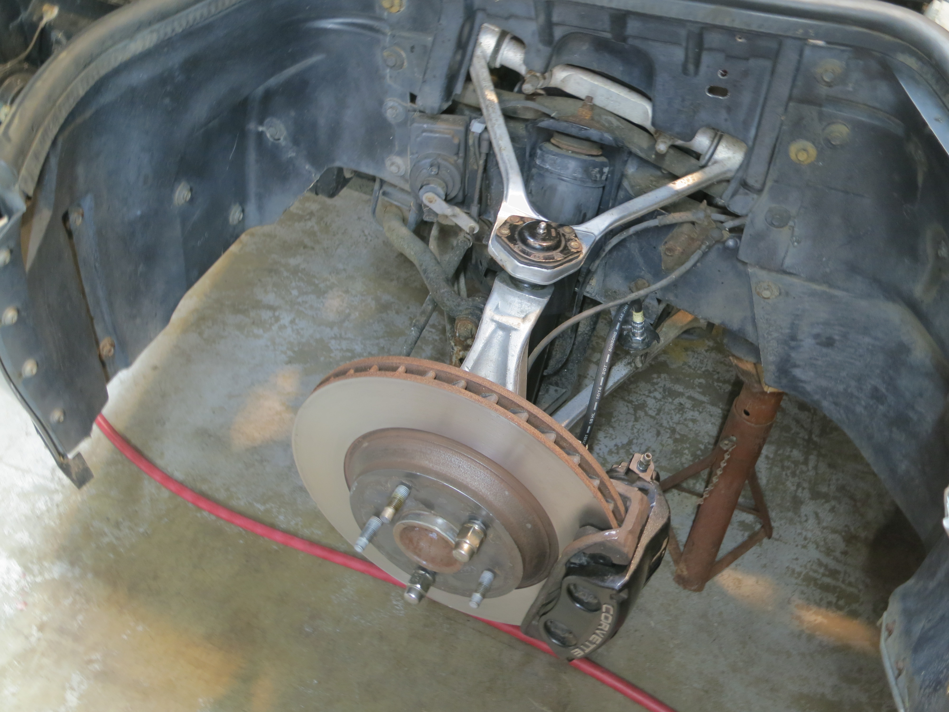

Since I'm waiting for parts to get the engine running again, today I started on the front brakes. First, I couldn't stand the grubby looks of the nice aluminum front suspension. So armed with a putty knife, wire brush and lots of paper towels saturated with brake Kleen I got to work. It was a nasty dirty job, but the outcome is worth it.
