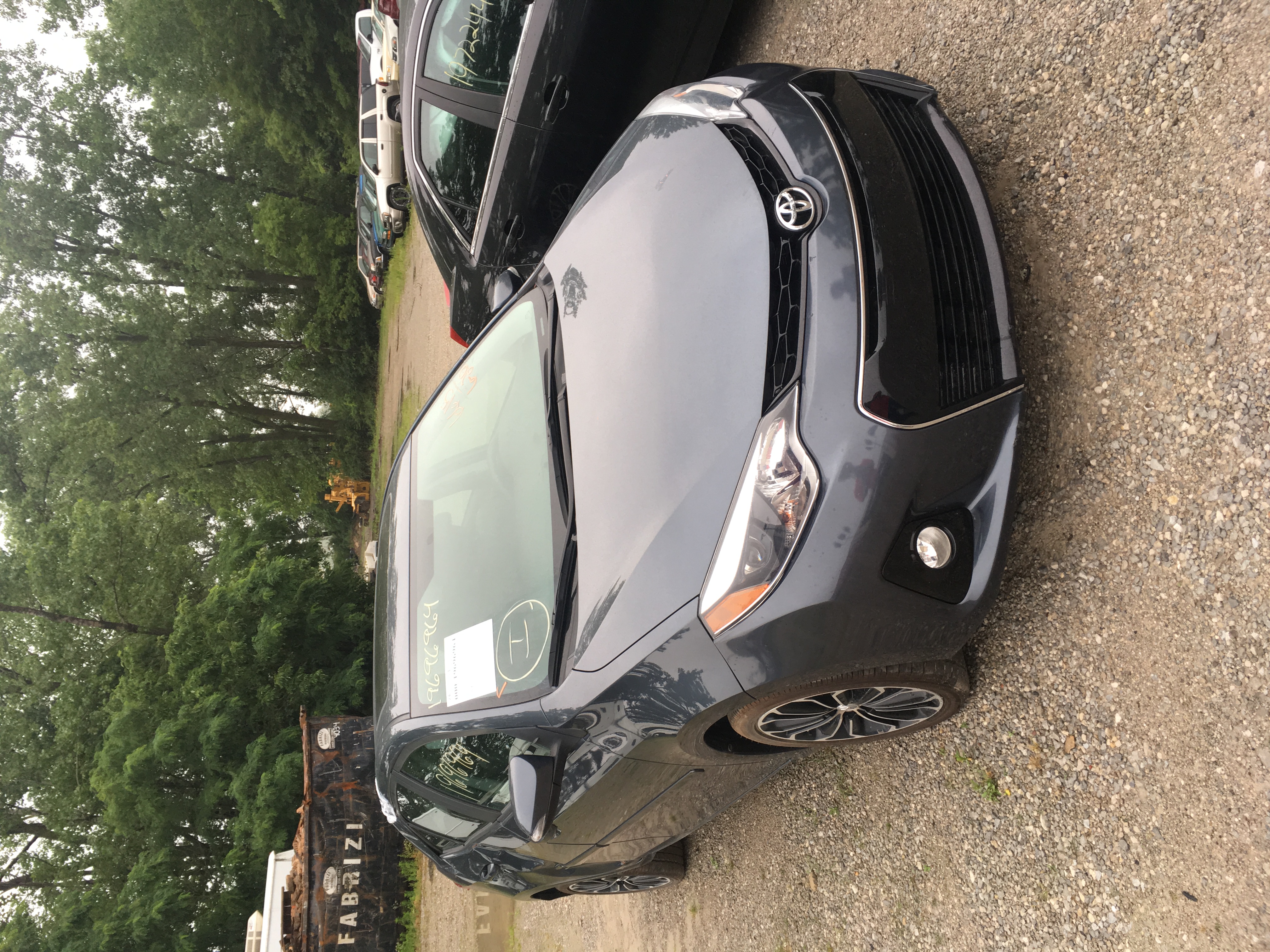

After the last track day I realized Rachel and Kurt need more practice with a stick shift. They learned on the Saturn but that is not practical for regular use. This is the car I selected for that.
The car is a 2015 Toyota Corolla S. It was made in Canada in June 2015 and has 5715 miles on it. I paid $5k for it + tax.
It was sold by a dealership in VA and resided in MD originally. The next step in its journey was to be repossessed by Toyota Finance after it was wrecked. I think the car got hit in the left by a van or SUV (maybe went too wide in a right turn) which punted it into a sign post in RR door and the sign came down on the roof. You can see it was a 4x4 white post. Car was from Maryland have no idea what sign posts are like in neighborhoods there. The specifics of why it was not repaired are not known to me.
The car has considerable damage which has created this opportunity. None of it affects the structural integrity of the car.

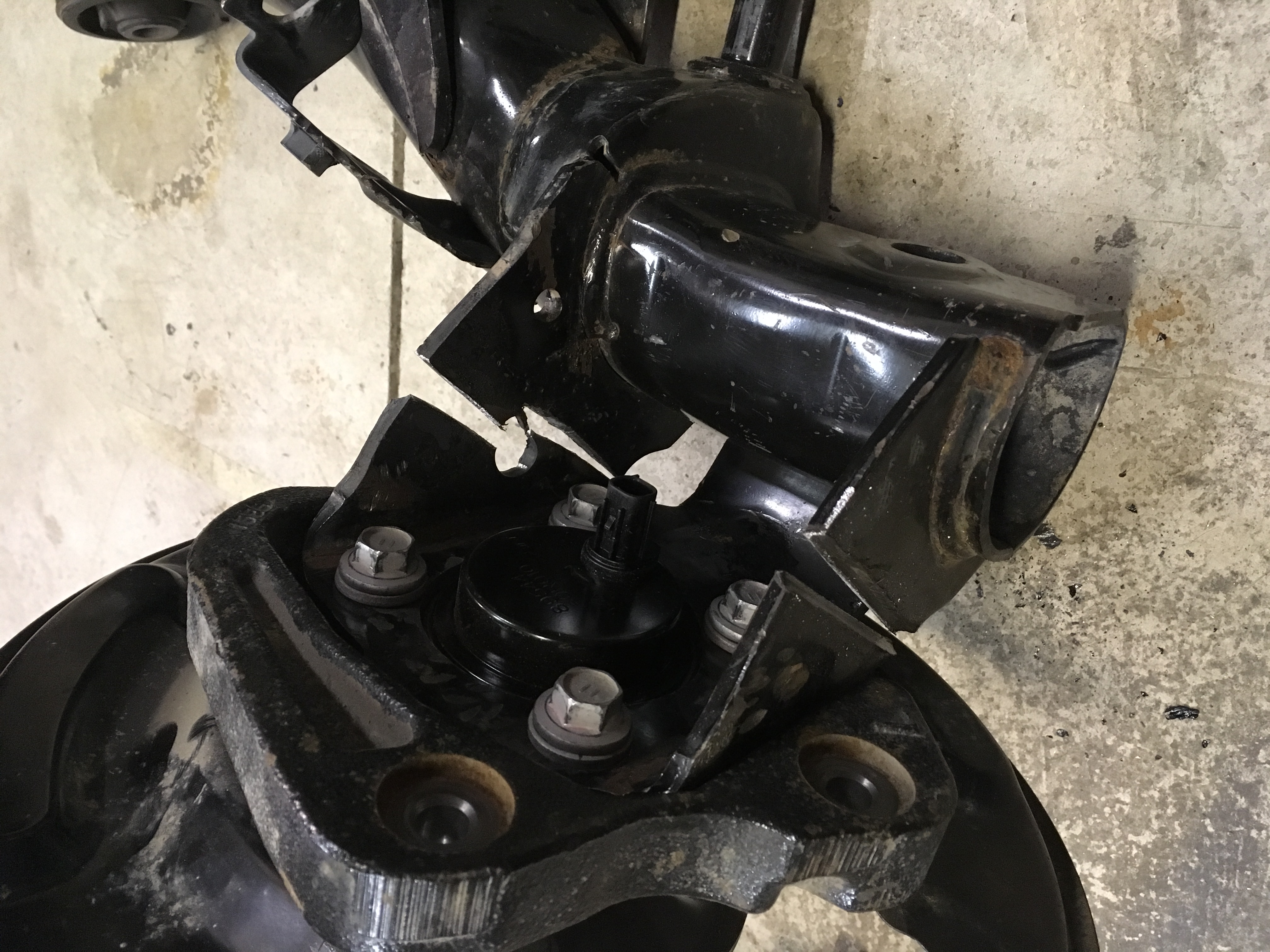

* Rear axle beam is bent giving way too much negative camber on LR. Tire was rubbing inside wheel well near strut. Axle beam Is unique to S model and not easy to find in junkyards yet, new is $1100 and used like $750 - so we will be fixing it. Two words: Kurt welding.

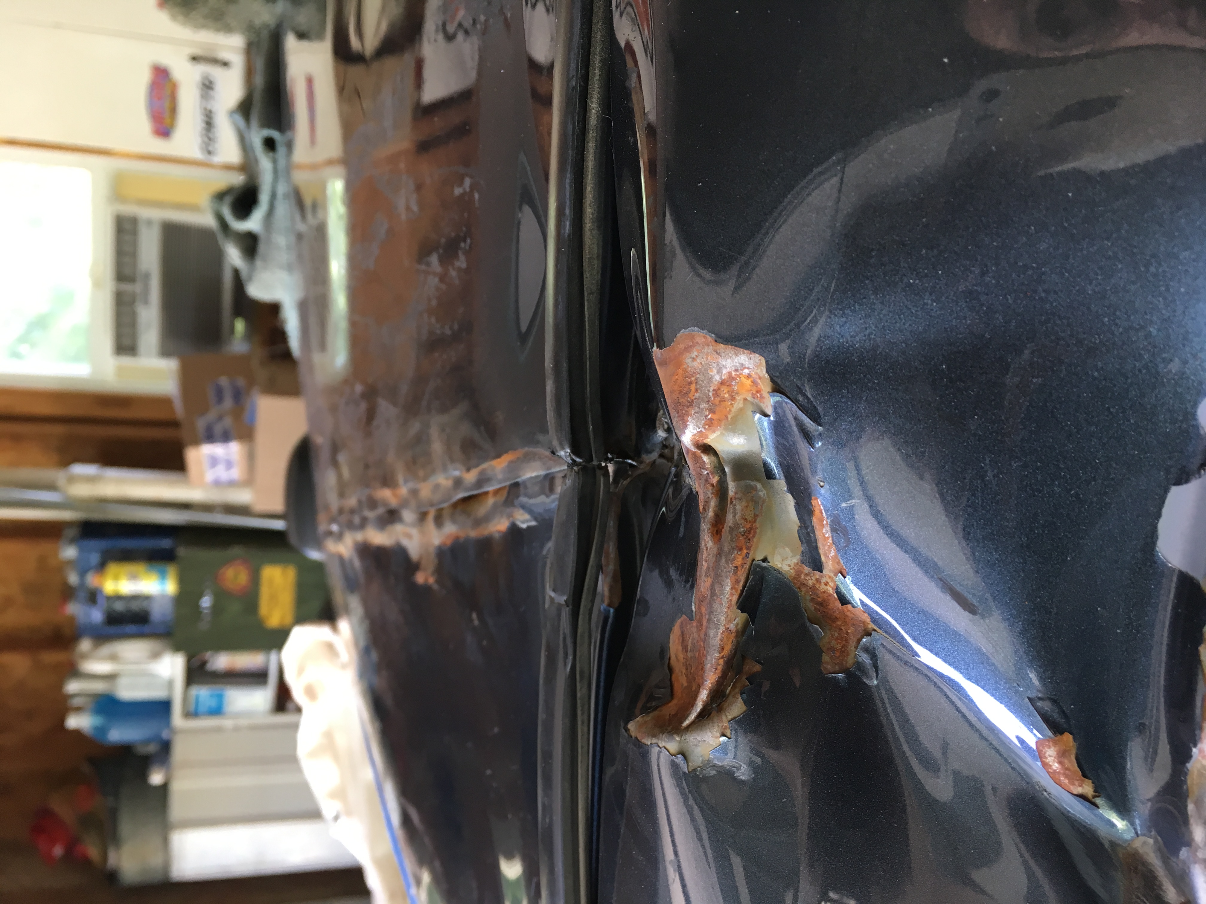

* There is a slicing hole in the roof about a foot long over RR passenger seat. The guy tried to cover the hole but failed so water leaked in and carpet was wet - like there were puddles on the floor.
* The roof is pushed down some where the slice is over RR seat.

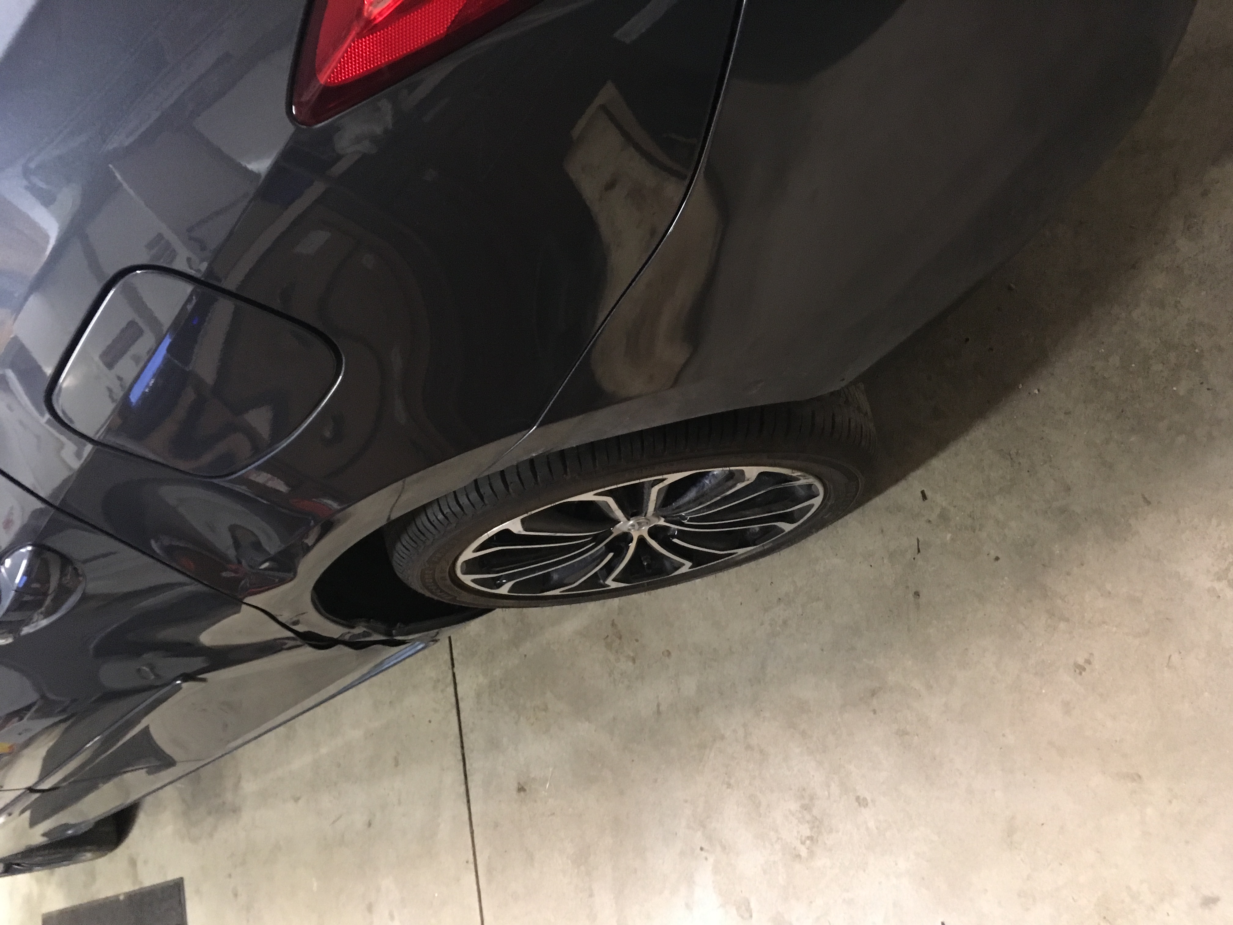

* There is body damage on LR door and some damage to door jam on wheel side or LR door.

* Removed rear axle beam to work on straightening it. Most of the problem is the LR wheel has way to much camber now and it hits the iner fender. Tried a couple things to straighten but still had -6 degrees negative camber and I need to get to -1. To do this I cut the support braces for the LR wheel and repositioned the mount where it needed to go, then made some plates 1/4" thick and had Kurt weld them back together. Camber now appears in acceptable range and while it has about 1/4" toe in this should be fine.

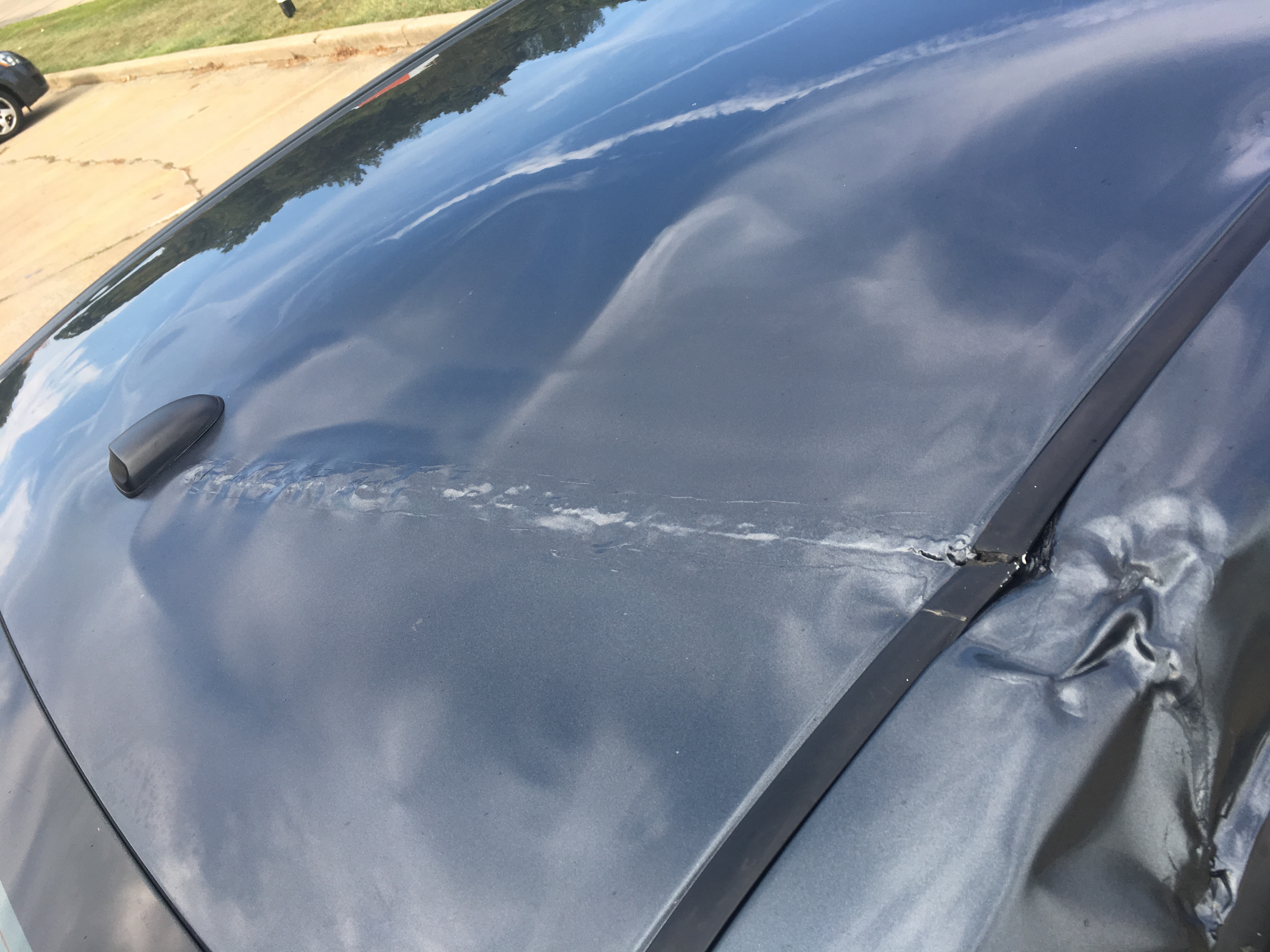

The roof was put back into a reasonable shape and the gash was welded shut
The edge of the roof line was another challenge. I was able to use the porta-power to fix the rest of the roof line, and move this part way back into place but this last section was in a channel and behind the side curtain air bag. My option there was to have Kurt weld some nails to the exterior metal and use a slide hammer to raise the material- then grind off the nails. It worked. (do not have pics of this handy)
I bought a rattle can of 1F9 custom mixed at the local NAPA store, and a can of clear and put some paint on the repair
I also got a 2 ounce ouch up for the other exposed areas
Spent a fair amount of time priming then touching up all these spots
The repaired axle was reinstalled

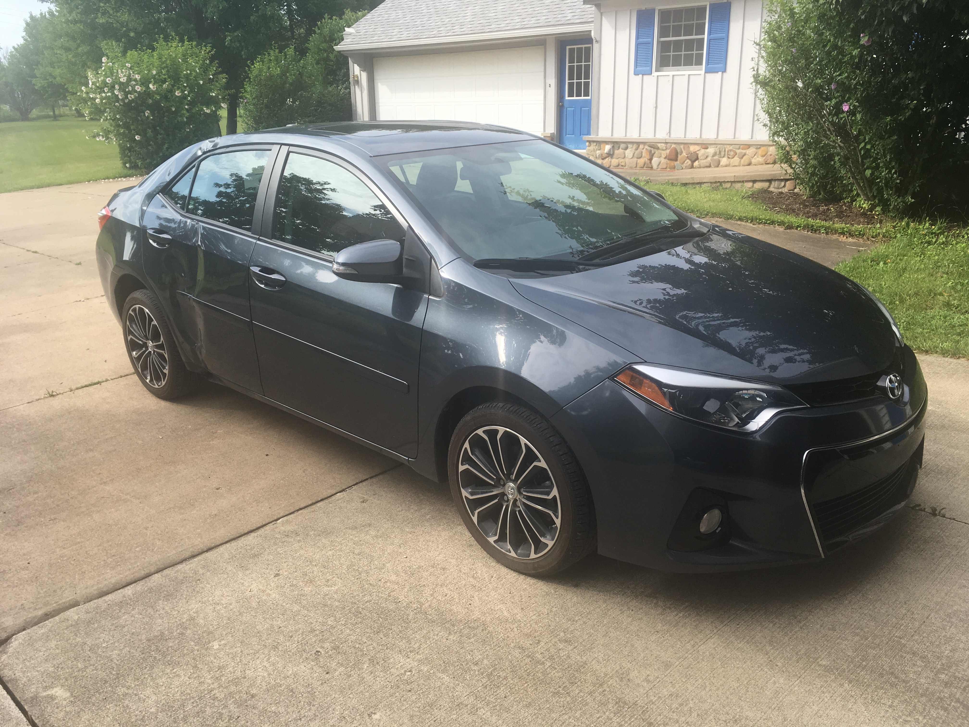

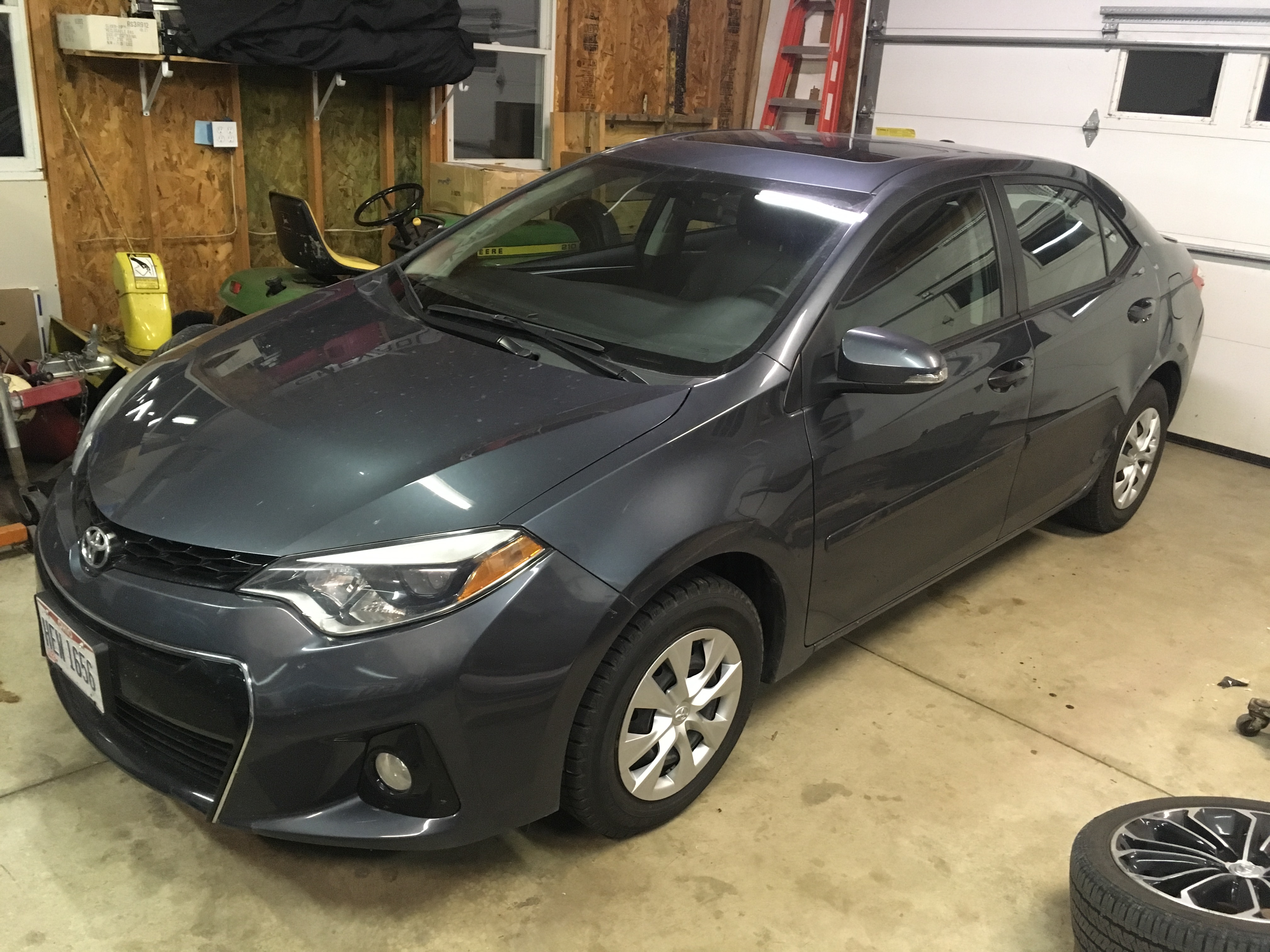

So a couple finished pics of the car:
I bought a set of snow tires with wheels for $350 and a set of factory hubcaps for about $120:

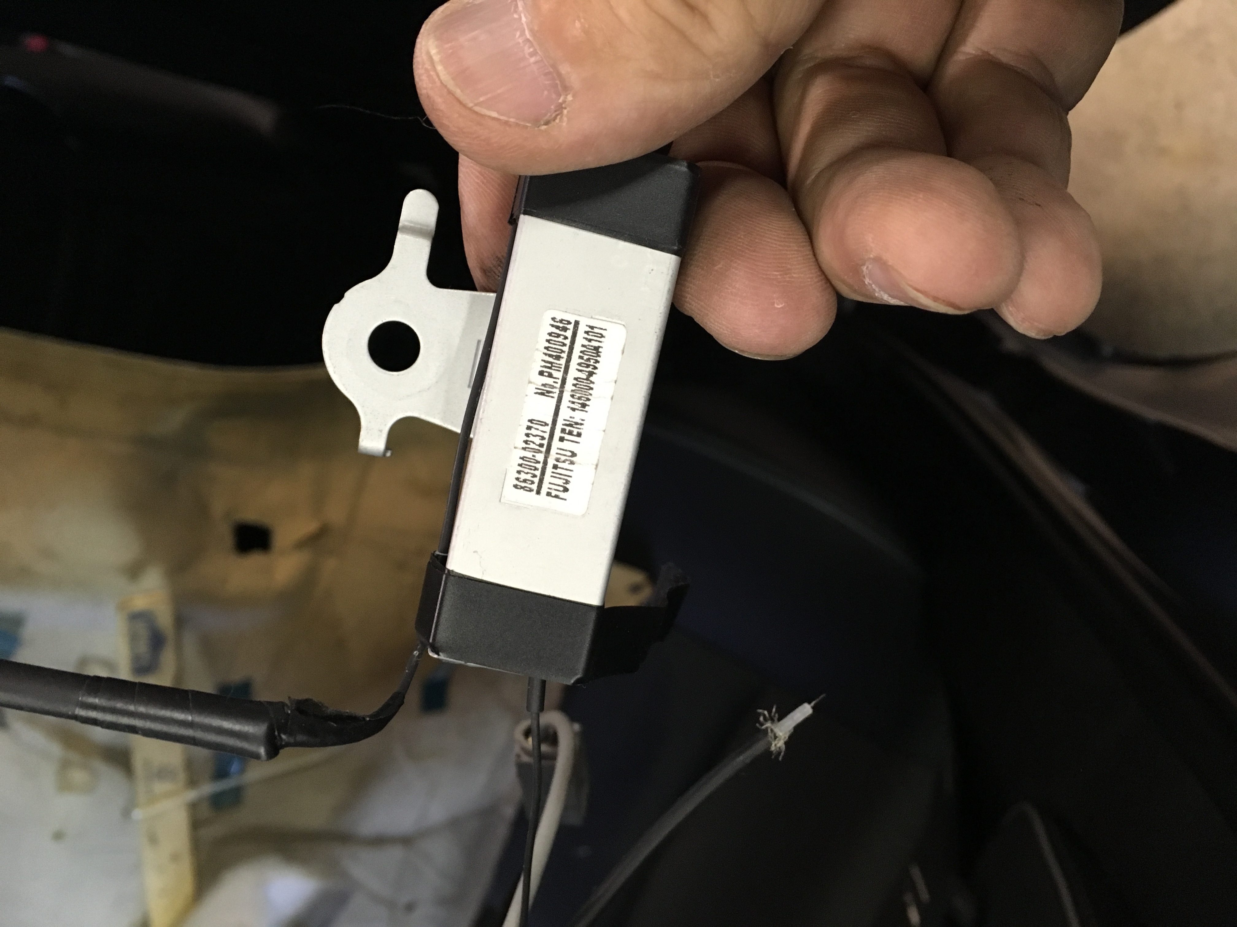

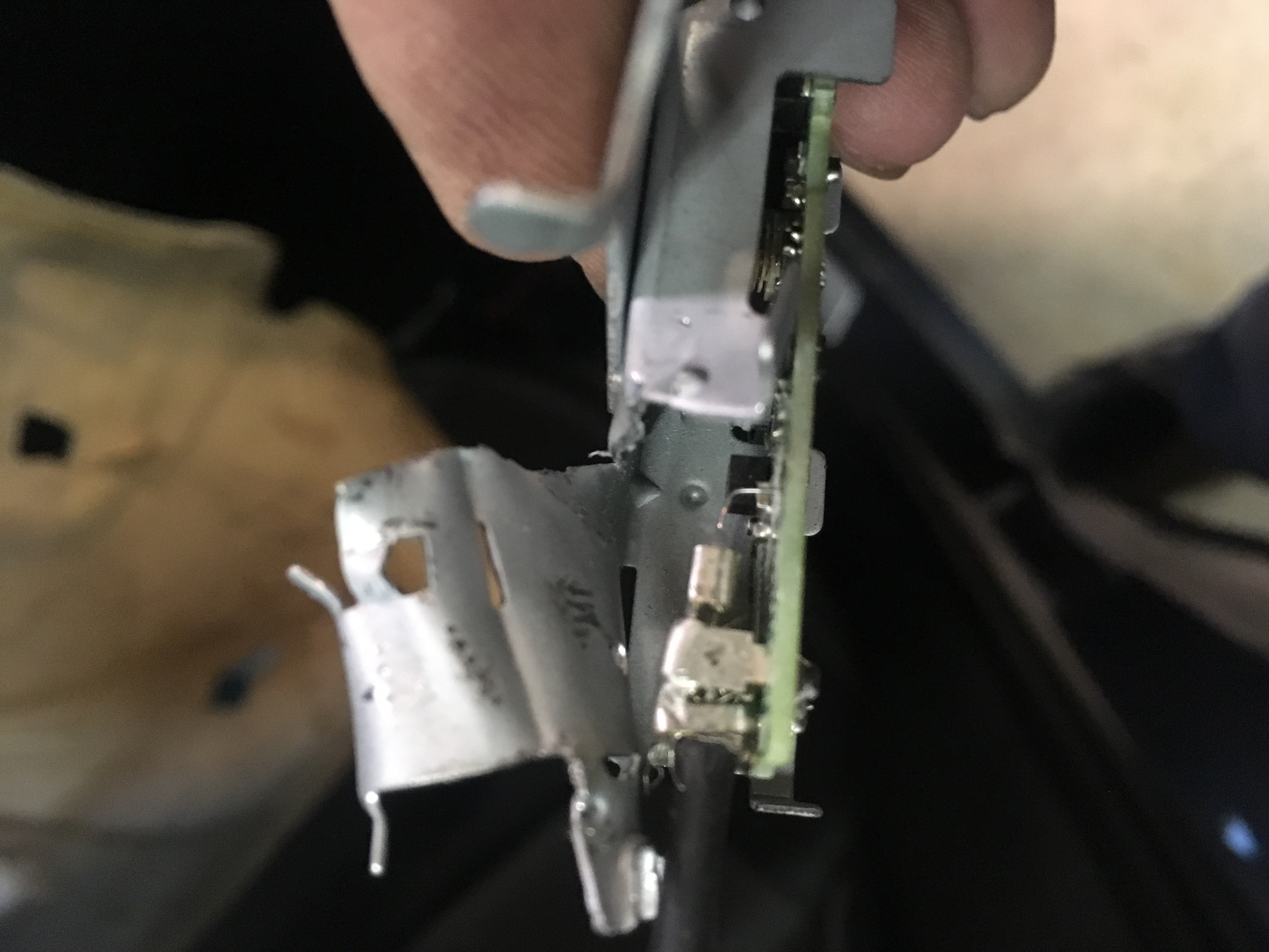

The radio had not been receiving FM signal at all. I finally went after it and found the signal booster was separated from the antenna cable. After finding the replacement to be $120 I decided to try and fix it. I can opened the booster and was able to strip the cable a little and resolder the little wire.

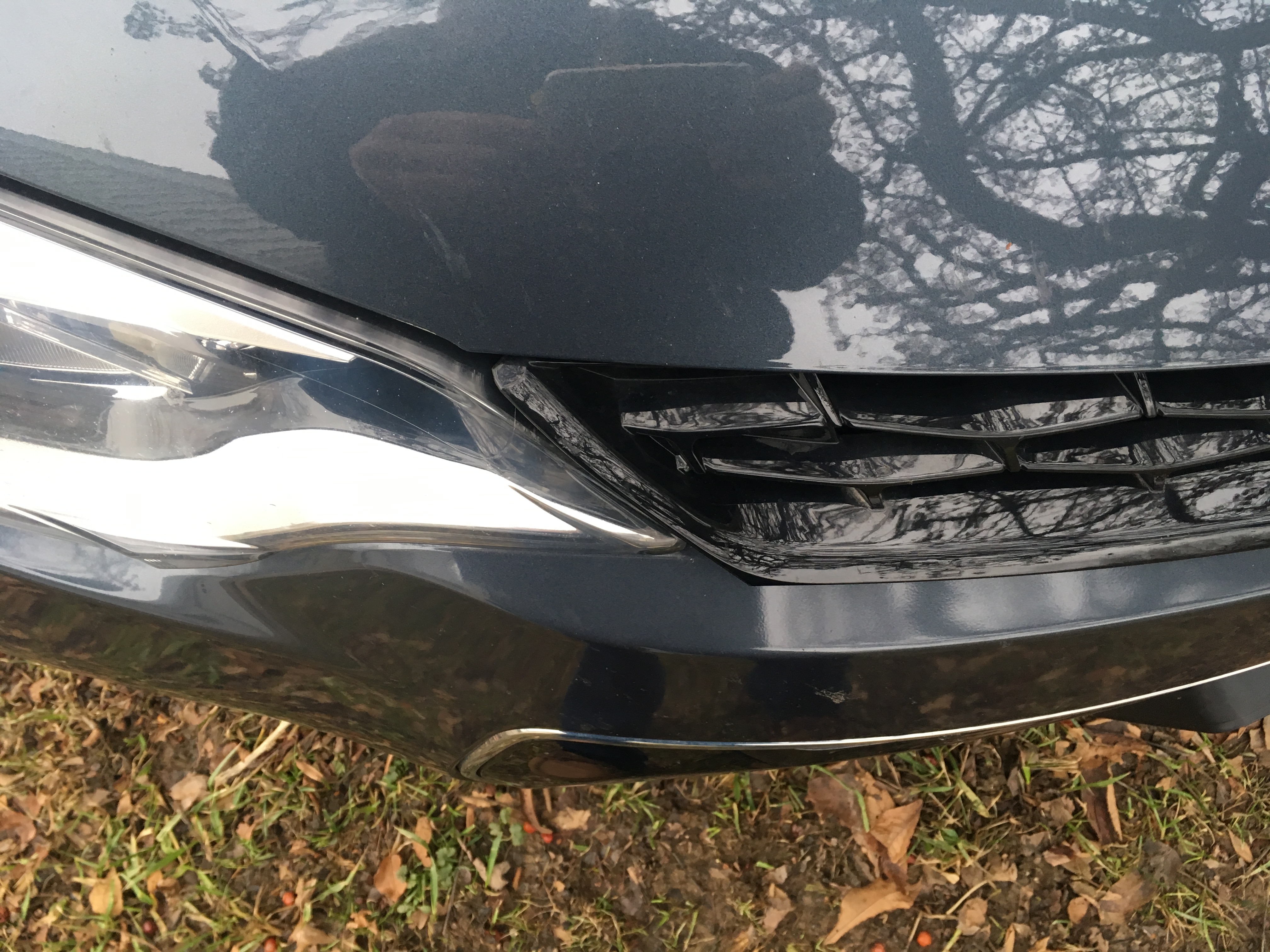

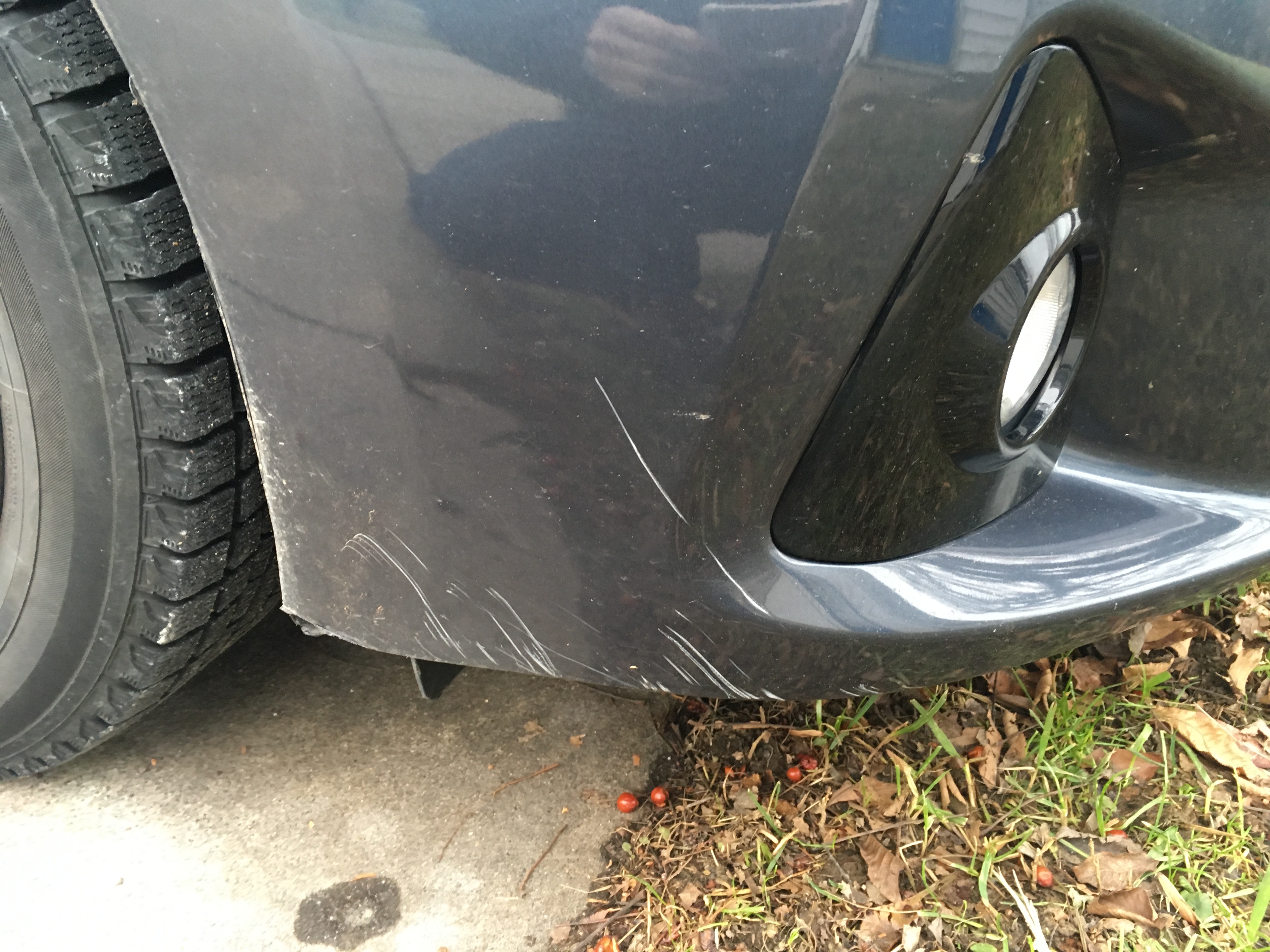

Over a month ago Rachel caught the front bumper cover on a rock backing out of a parking lot and tore it half off the car. She was able to snap it back on mostly to drive and bring it home. The underbody panel got separated from the bottom of the front bumper cover and the was some damage where the grill was attached - all of which I was able to fix with straightening a couple brackets and some zip ties. I forgot to get pics.
The snow tires went on also.

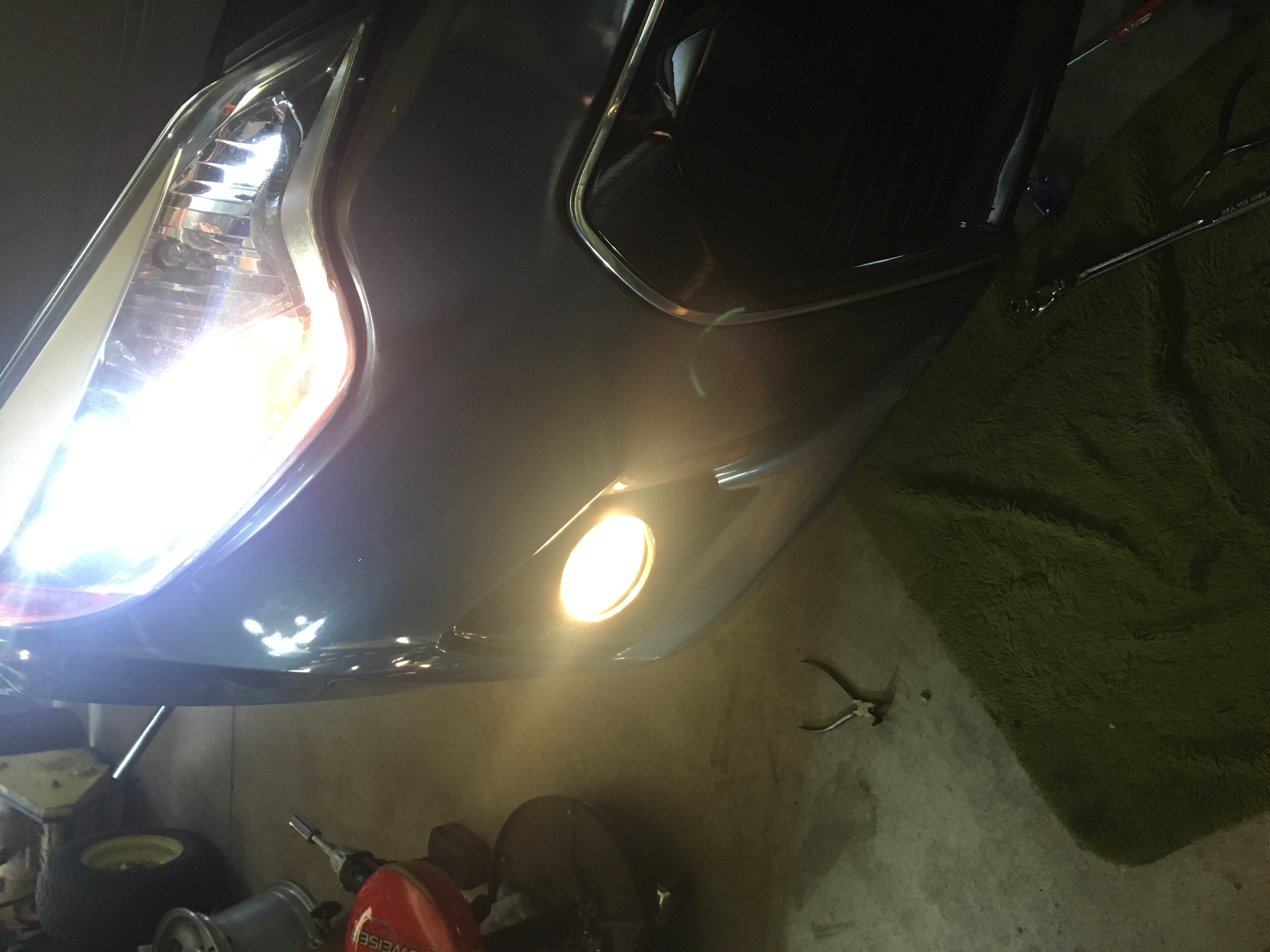

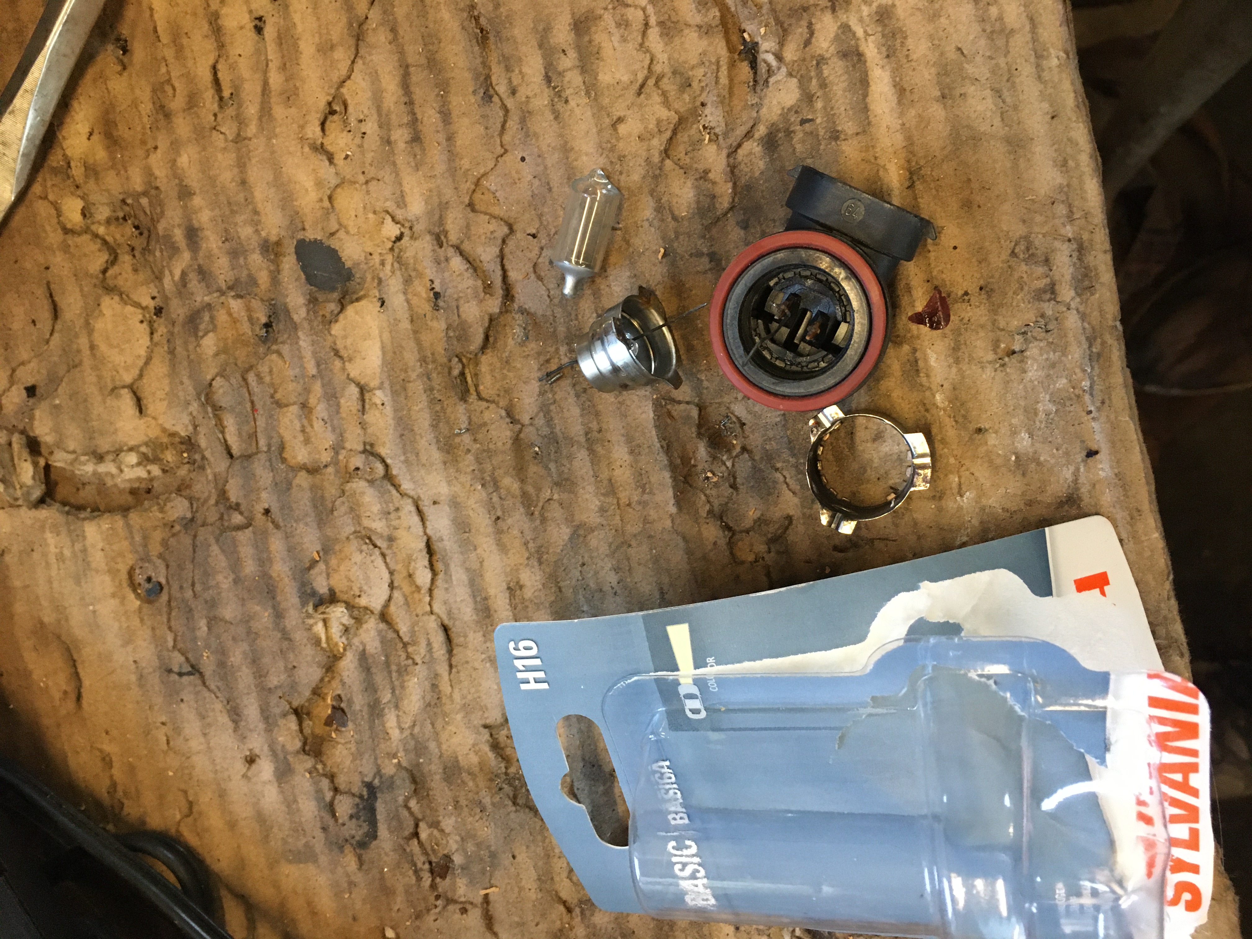

Then I remembered the RF fog lamp was out from the incident in the prior post. The bulb was destroyed and had to remove the fog lamp from the car to get all the pieces out of it.

Last weekend got the car washed, the toe in corrected and the steering wheel is straight. Cleaned the hard interior surfaces and a little finish vacuum work

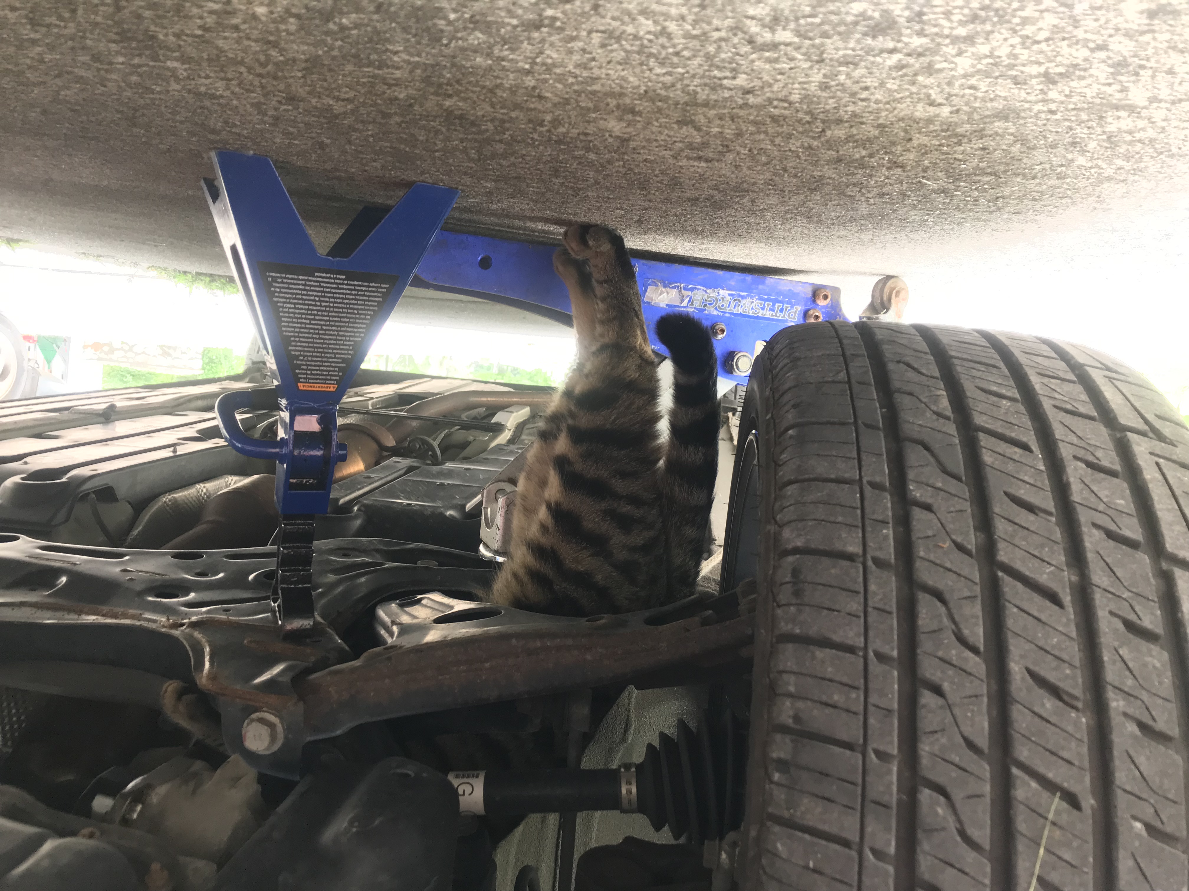

Car now has 51720 miles. Regular maintenance - oil change - had the car up on jacks so I took the opportunity to remove the tow hook underneath in the center. This is at least a lb of weight carrying around for nothing. Last year some time I removed the floor mats, owners manual and the trunk mat (still has the factory "carpet" underneath - this netted about 15 lbs of weight off for free.
Also I decided to improve the factory intake - it has a big loop in it to quiet the intake sound, and it's picking up air from just inside the engine compartment. I removed half the loop and now it gets air from the cavity behind the front bumper.
I also recently learned that TRD offers lowering springs for this car. Not this year - maybe once the race cars are in order I'll consider it.
I cut this off right where my thumb is
And I had a curious cat doing some inspections
