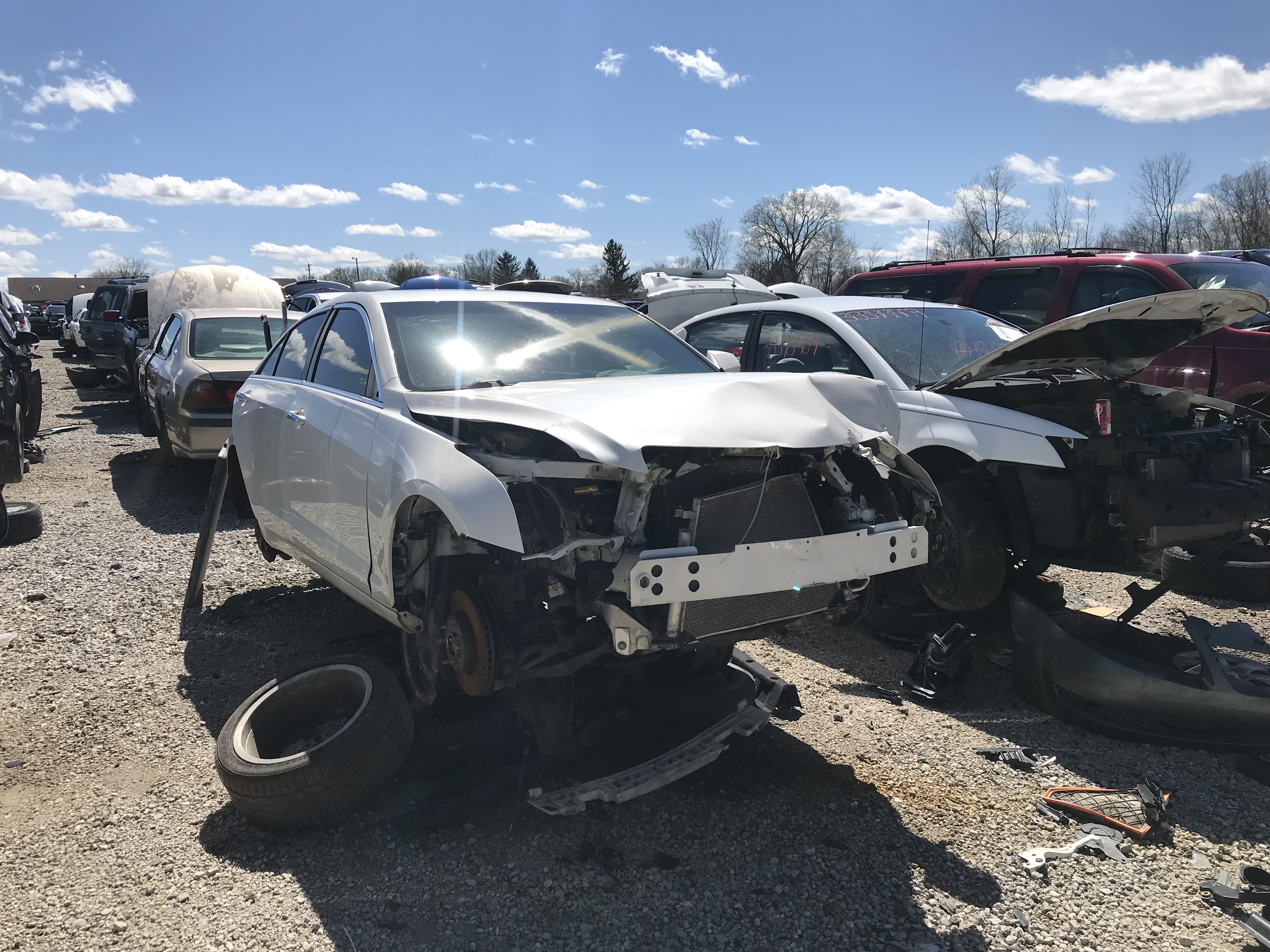

I found an ATS at local pull a part and it still has the diff in it. The car is wrecked in the front and the diff shows no sign of leaking.
The halfshafts and driveshaft all bolt to the diff so you can remove it without removing the halfshafts or even the tires

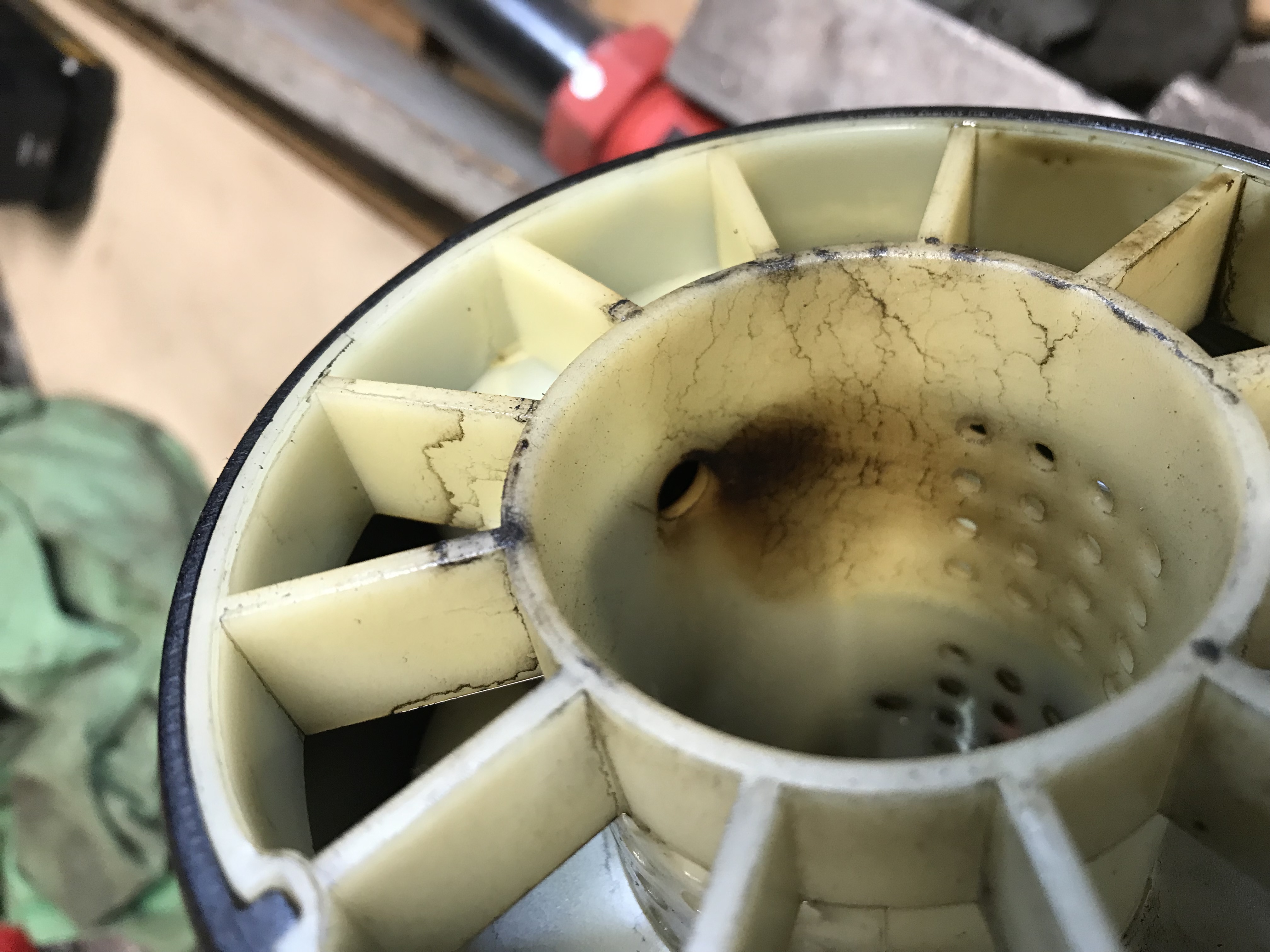

These direct injected Ecotecs can have problems with build up on the intake valves around 100k also so that's probably going to need an evaluation at some point.

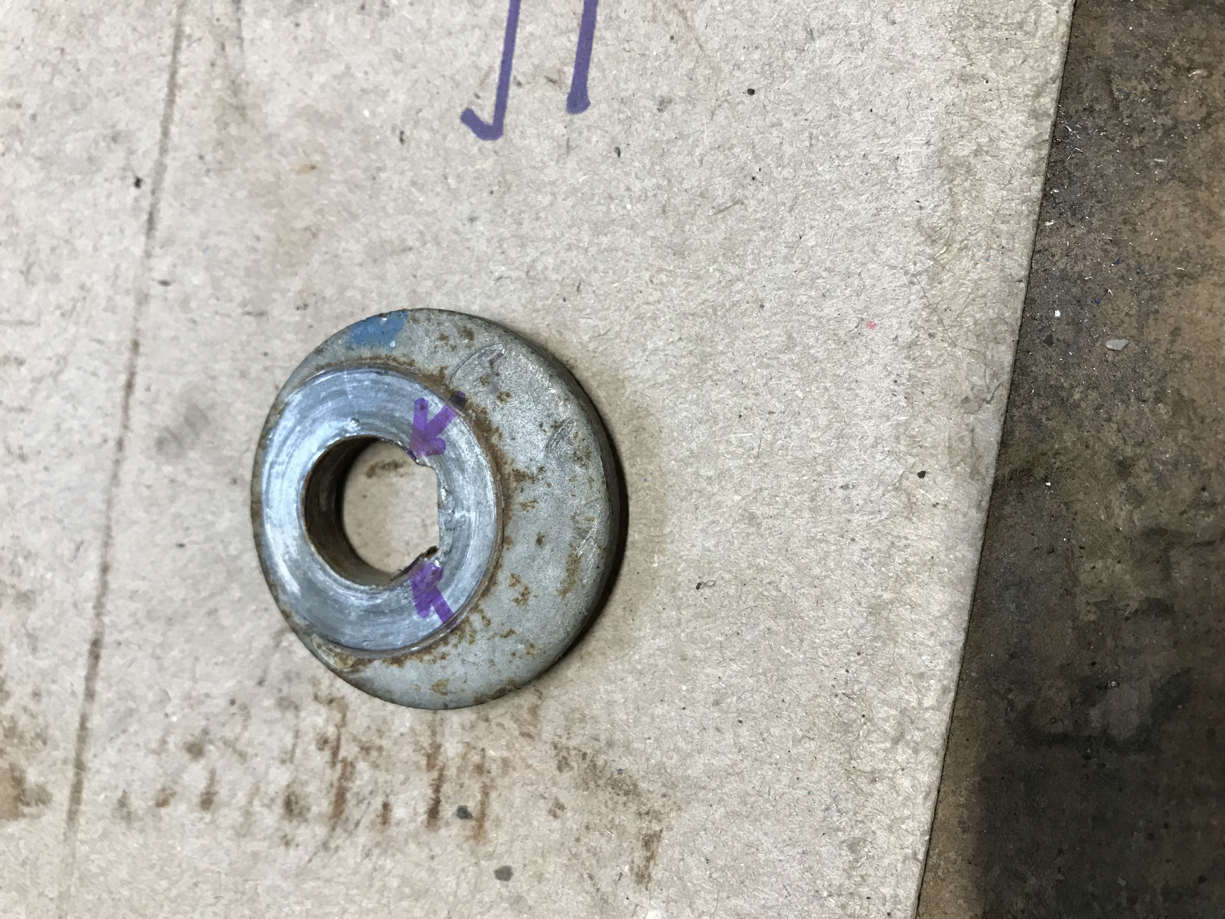

* installed the good offset washer and took some big swings at adjusting the rear toe and camber. It's a lot better but still need a good 4 wheel alignment for the last bit. I need to be able to move the car to get the suspension to settle after adjustments and it's not running. Also IDK yet how to easily get this car in neutral without starting it which I'm not doing with the engine apart * I've gone as far as I can with the cam cover - some of the gaskets still are not here yet. I took time to replace the brittle plastic tubing in the PCV system
