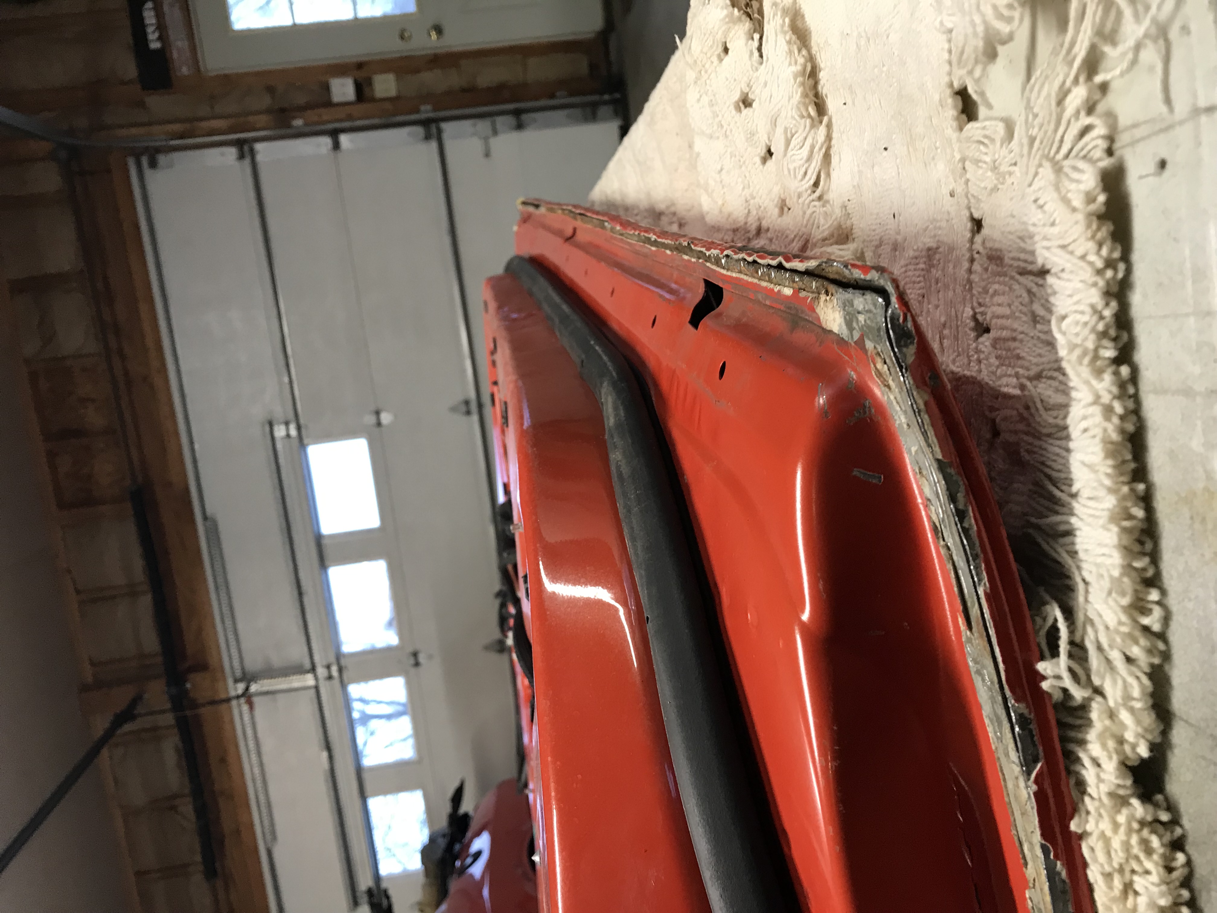

Separated the skin (outside layer) from the structure – this was definitely needed to make straightening the hood possible. First up was peeling up the edge that is bent over the structure to hold the skin in place. I experimented with a couple methods but the best method was using the air chisel at relatively low speed to pry it up then finish with pliers or the wide vice grip to bend it up the rest of the way.
The pieces are also glued together to avoid rattling all the way around the perimeter and at various touch points. I tried making a tool to manually pry but all that did was damage stuff. After regrouping, I put some heat to it. Most of it I was able to heat from the back, and while doing these I learned I could do this without damaging the paint. With a little heat the stuff let go quite easily. There were several of them where I could not get heat to them except through the exterior surface. It was a bit disconcerting putting the propane heat to the paint but it seems like there was no real damage. I just kept the flame 4-5” from the paint.
Once the parts were separated the work started. The skin sheet metal was buckled multiple ways on the driver side and the front corner of the hood was a solid 6” higher than it should be. There was one long bend that ran alongside the side scoop – once I straightened that I was able to take on the rest of the bends one by one. There was a fair amount of hammer and dolly, sometimes hammer and wood block, sometimes taping up the orange paint to avoid damage from the metal work.

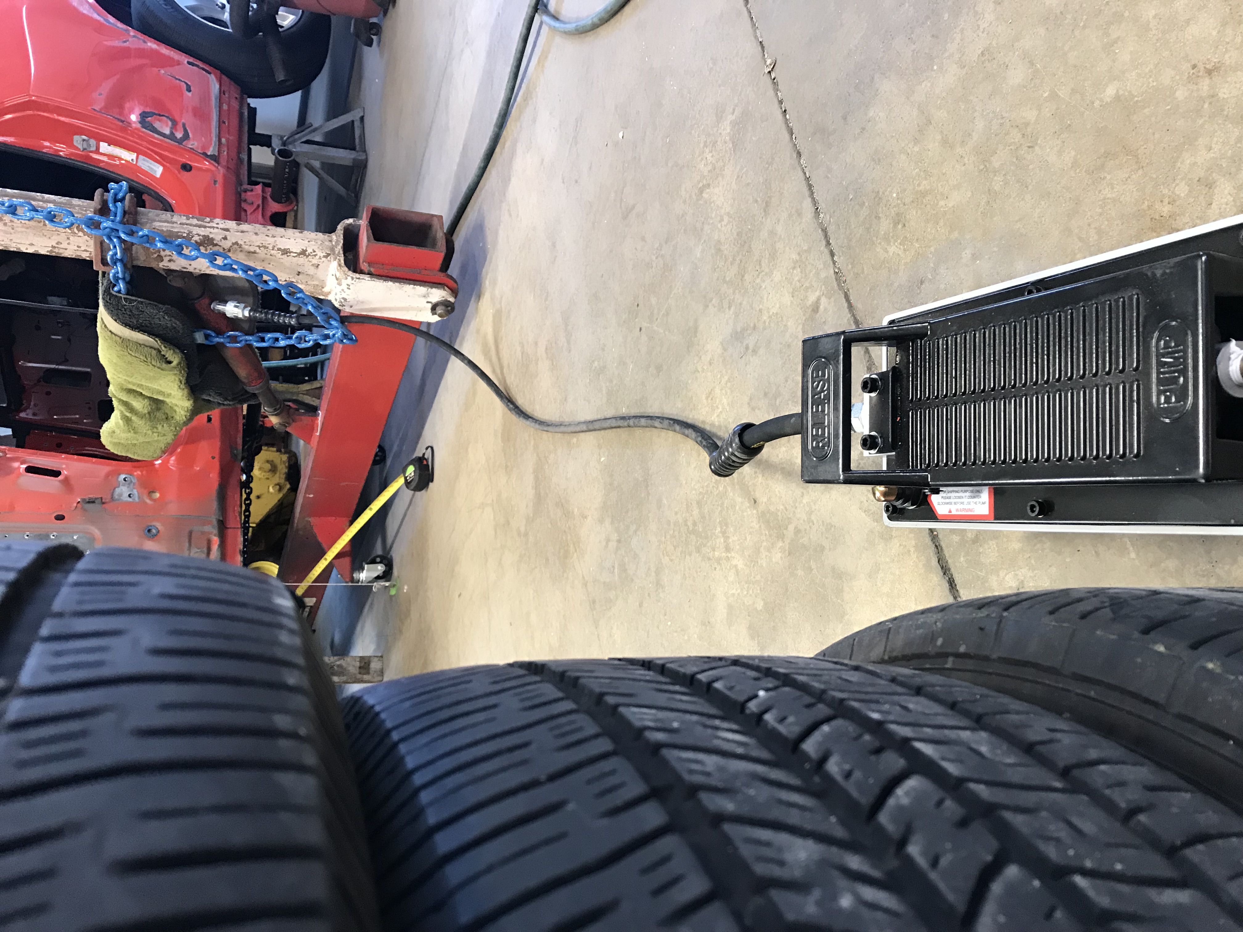

Frame machine

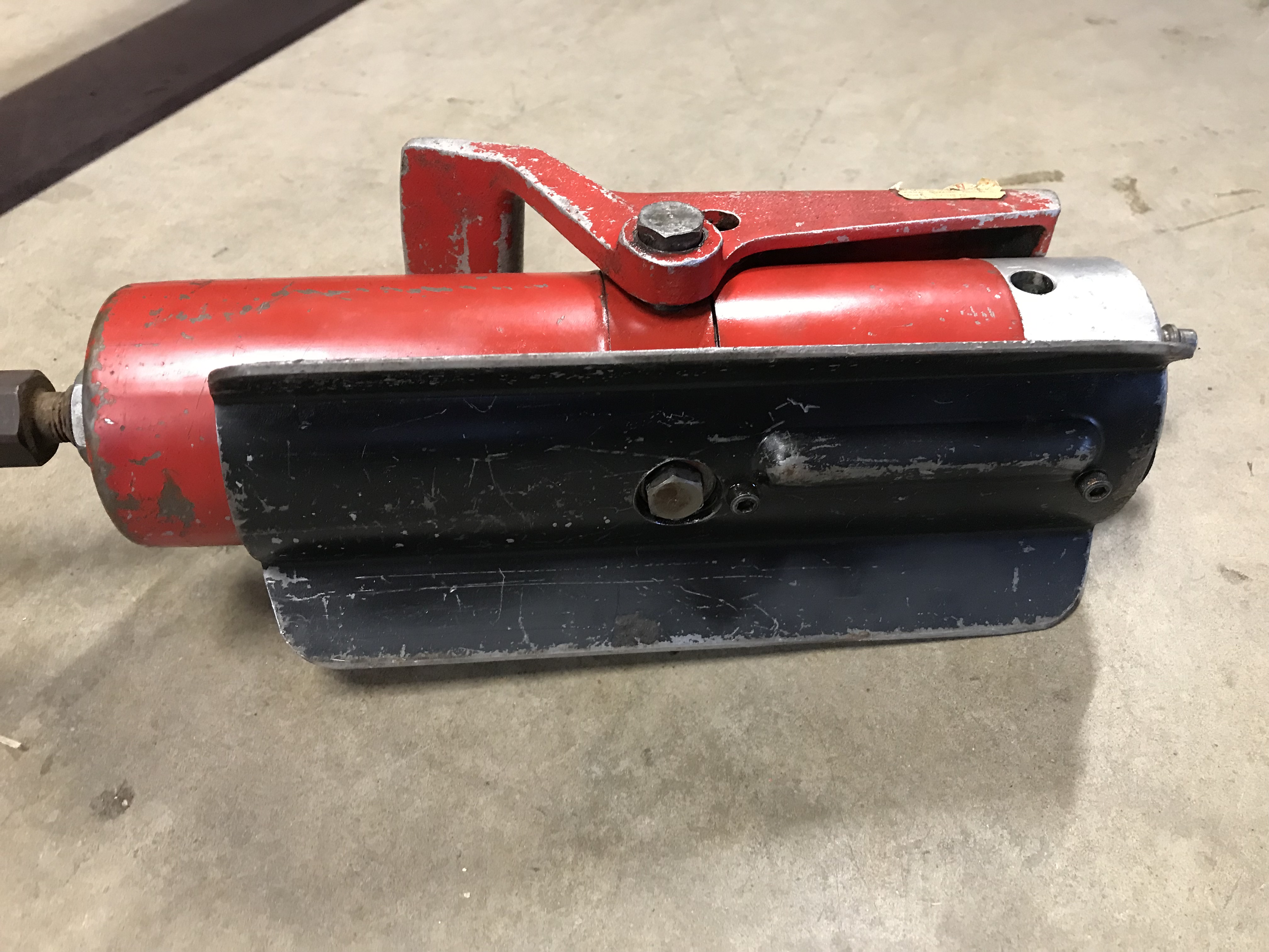

• New air hydraulic unit obtained and installed. This really woke up the Damage Dozer allowing it to work properly
• Obtained a 2.5” OD .25” thick metal tube for bracing. The machine is supposed to have on of these for bracing. At 78” long this this is quite heavy and was over $200 shipped. The clamps to hold this bar to the frame are just over 2.5” diameter, but there were casting burrs in most of the holes making me wonder if the original pipe was slightly smaller or if these clamps were never used
• First serious pull lifted the end of the unit off the ground, and when I released the pressure it dropped to the ground and broke one of the new casters. The wheel is cast steel but the other parts were stamped metal that were not up to the task. I bought a pack of four so I swapped out the bad one
• So far I’m into this frame machine for about $1400 which is more than the winning bid for the car lol. Similar new machines are just under $2k so I’m not sure this was the best decision, though it’ll probably get me most of my money back whenever I decide to sell it.
Operating this thing puts the car under a lot of load and so I'm using the tire pile as a kind of bunker. Also not pictured - always cover the chain with a blanket/carpet to dampen chain action if something breaks during a pull

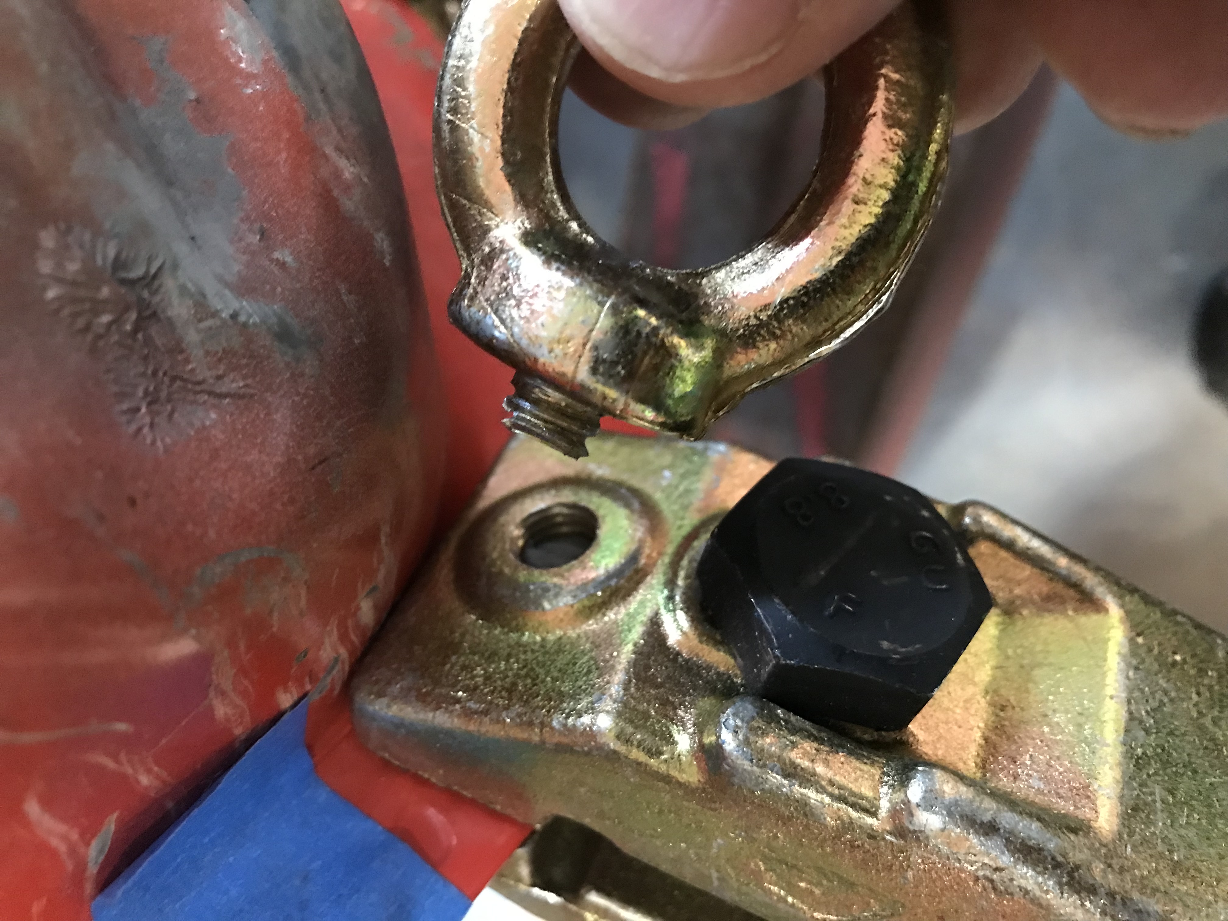

On one of the early pulls I manage to break one of the new clamps. This gave me a chance to see what happens when the chain snaps back, and in this case the blanket did a great job containing the chain - nothing went flying. Still couldn't convince me to stand behind the thing when under load, and the bunker still seemed like a reasonable/cheap precaution.

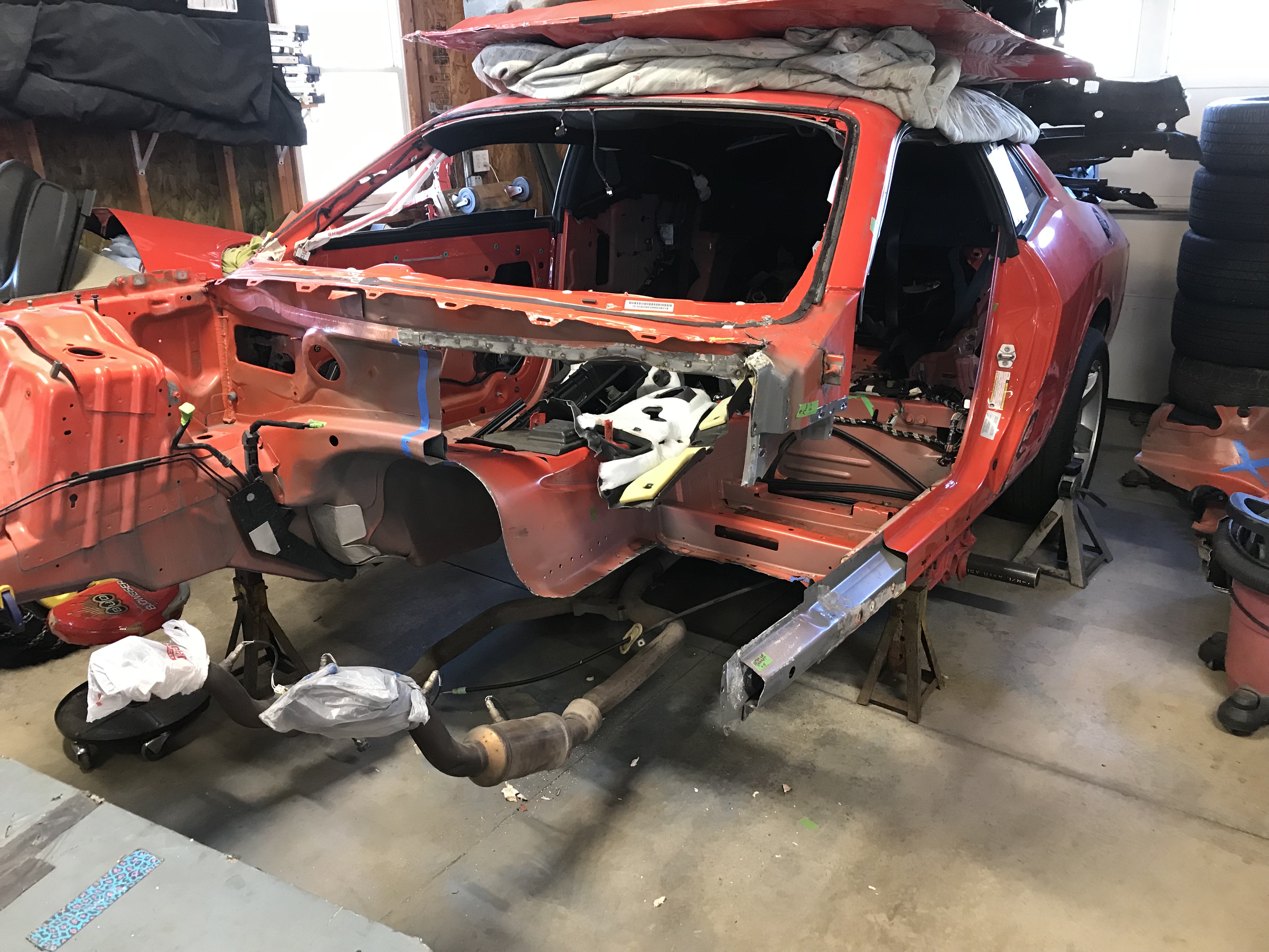

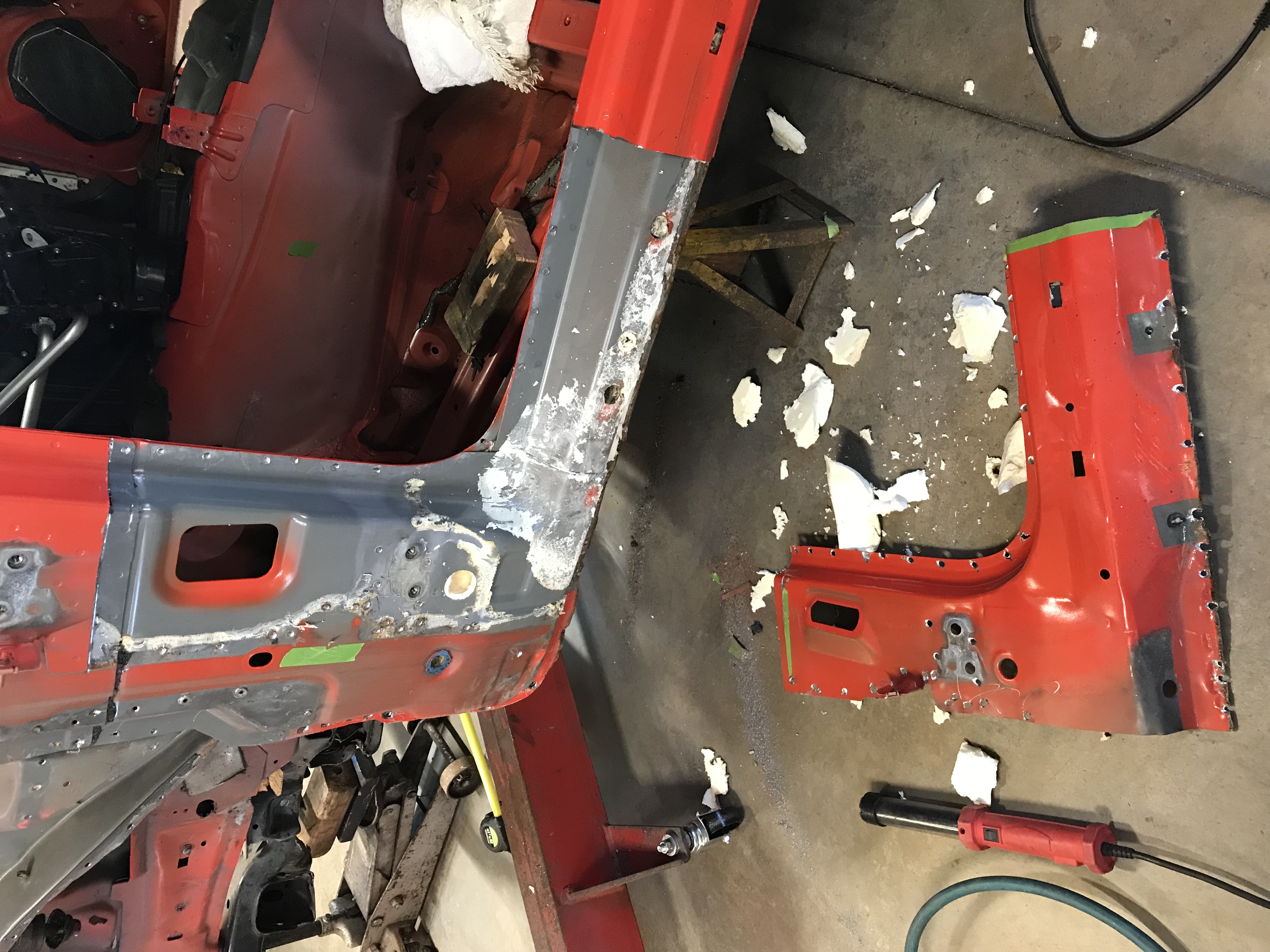

Major parts of left side frame structure removal

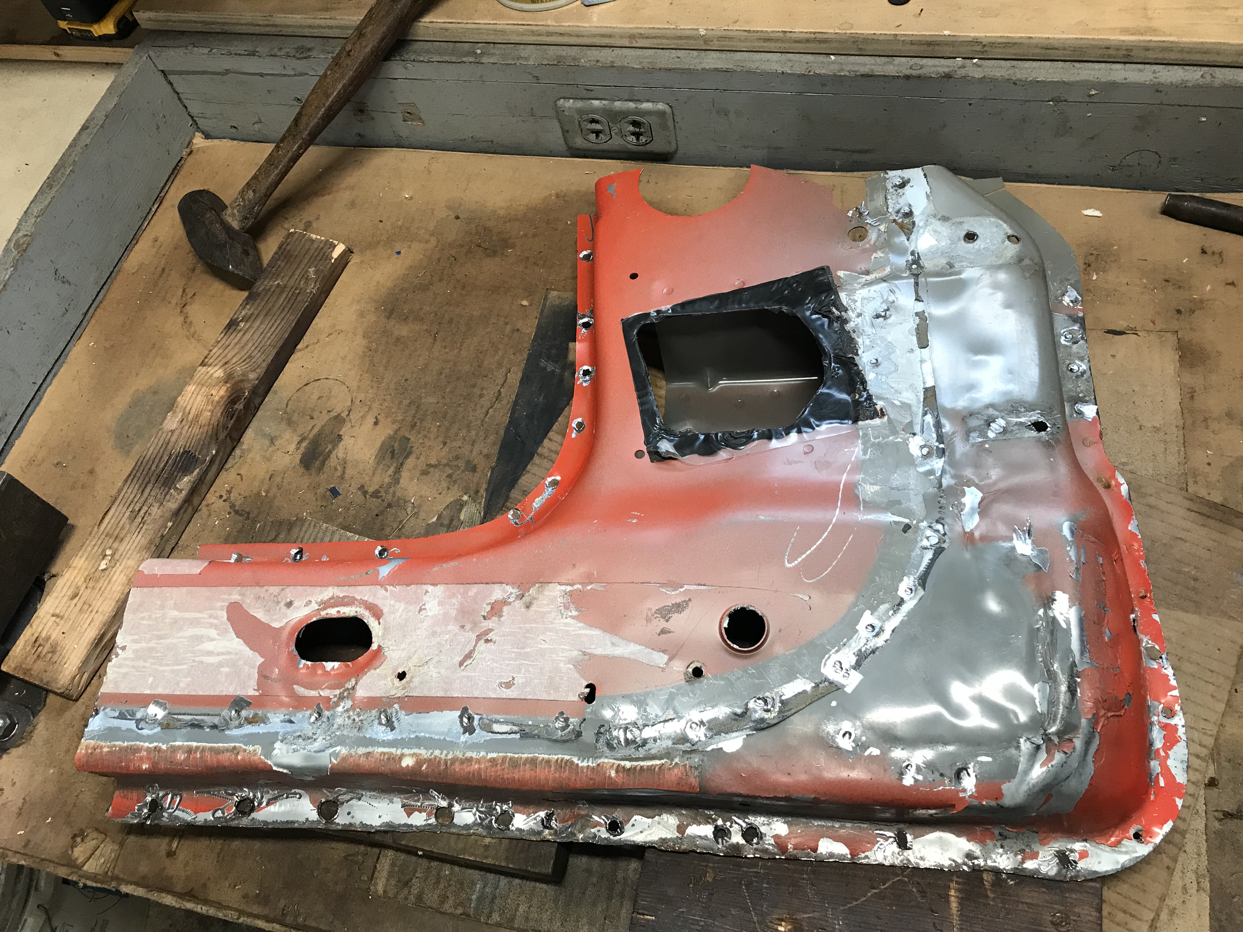

• Chose a section of the sheet metal at the bottom left of the door frame, grind out spot welds, made two cuts to make a section, and remove
(part A)
• Grind out spot welds and remove outside layer of this frame below and forward of the A pillar (part B)
• Chose a section of the left side frame structure to remove, ground out the spot welds and made two cut to remove it (part C)
More parts coming off
• Remove the front subframe and then cut off the left front shock tower and frame
• Remove the main HVAC assembly, shifter cable, sound deadener off the inside and outside of the firewall and under the tunnel
• Remove the rest of the front wiring harness
• Remove the inside rear view mirror and then the windshield
Repairs
• Straighten the lower side beam on the car with the frame machine. Call it less bent
• Straighten the floor for the driver rear passenger
• Pound out damage/straighten out/clean up sharp edges for parts B and C on the bench.
• Spent some time on part C and fitting it to the car
• Straighten the passenger side of the firewall
Further damage assessment
• The base of the A pillar at the top of the door seems to be a bit too far back: https://youtu.be/CCaLGp79iDU
• Pulling off the sound deadener off the firewall uncovered ripples in the firewall all the way to the passenger side
• The beam under the windshield (part D) also has some damage. Once the firewall and floor on the driver side are out I think I can straighten this beam from the bottom. This one had me concerned for a bit. I could use the beam from the Charger but this beam has the VIN tag on it so replacing it will add complexity of moving the VIN which is a sticker. https://youtu.be/TJp9FM8IHqo
• I measured the distance between the A pillar on each side and confirmed it is virtually the same between the Charger and the Challenger so I am not certain how part D is dented and yet this distance is the same
Plan next
• Had to review the damage to the floor, firewall, shock tower to decide what parts to save and what parts to replace. There are a lot of spot welds holding the shock tower and front frame rail to the unibody. Also to fix that cross beam I’ll need to reach it underneath. For these reasons I’ve decided to remove a major portion of the firewall and floor pan on the driver side, and replace them with the parts from the Charger.
Parts car
• Moved it into the garage to start removing the remaining parts I need, and to be a model to compare
• Started removing the spot welds for the section to cut out

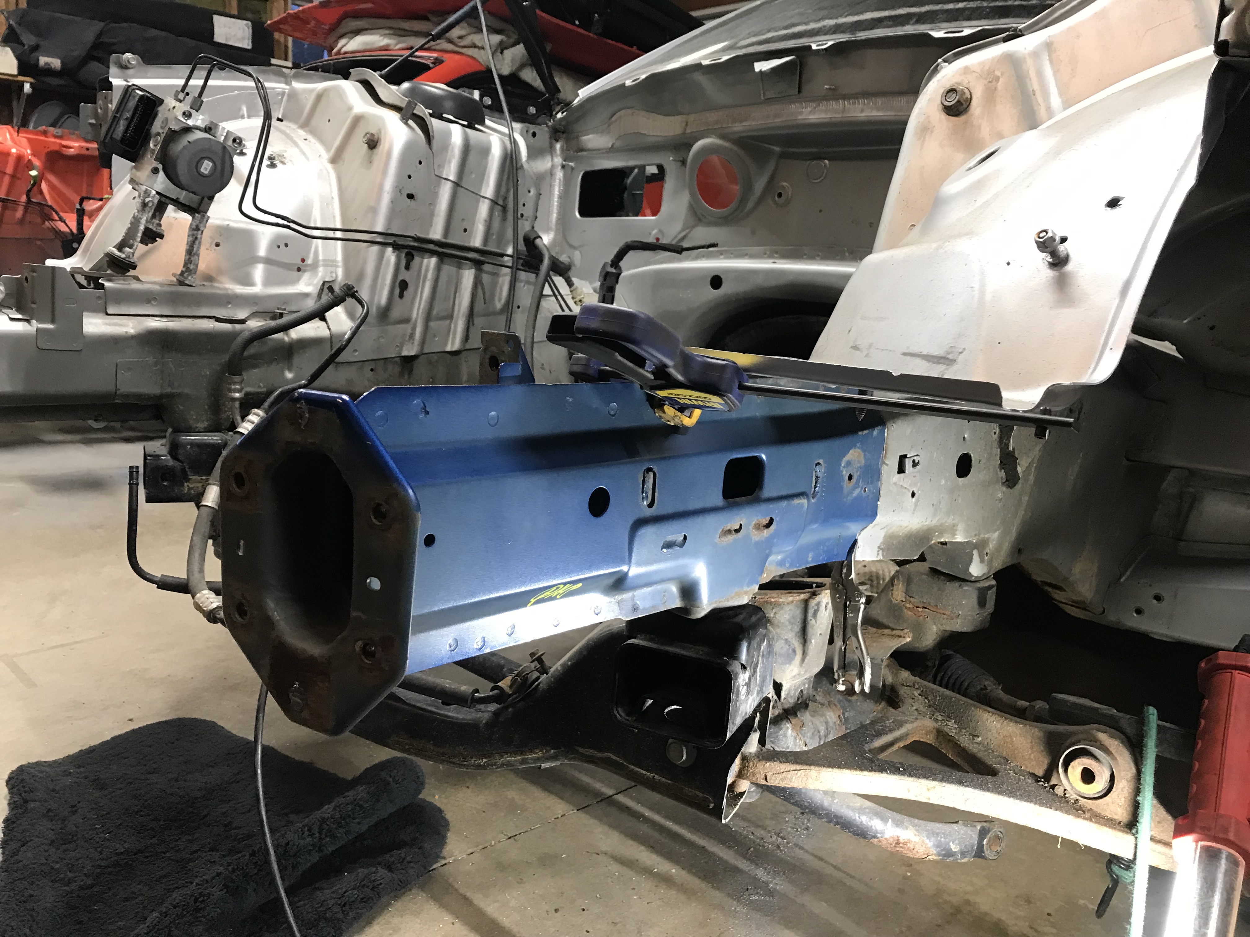

• Prepped the newly acquired frame rail to bumper end plate and installed it on RF frame of parts car.
• Took time to remove the extra metal off the new frame rail piece.
• Spent a good bit of time trimming this frame rail section and the car frame rail to match, then between laser level and measurements confirmed the frame rail is in place.
Had this welded in place. After the weld I test fit the new upper core support and it fit well.

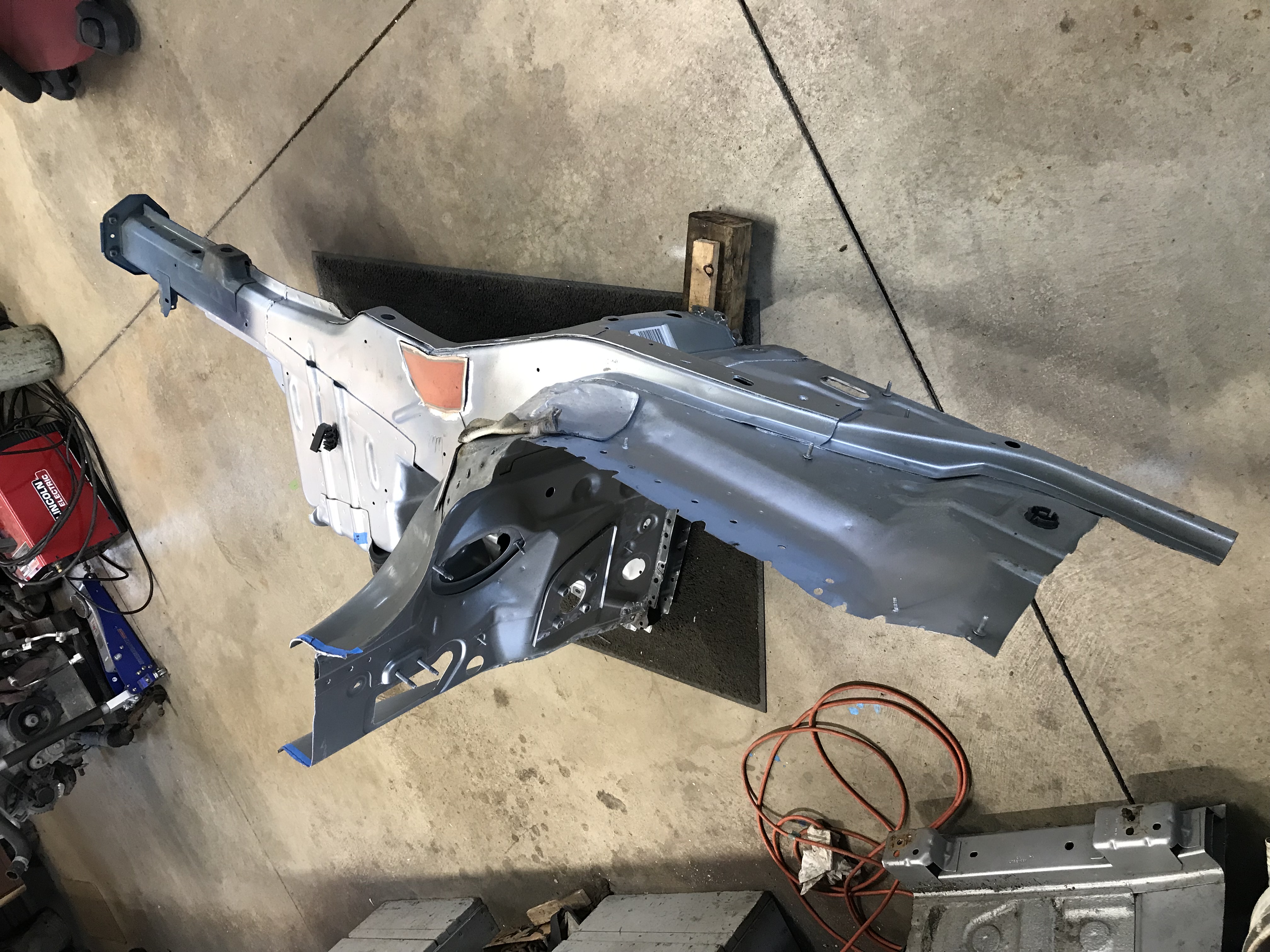

• Went to work removing the LF frame/firewall/floorpan section from the parts car. Ground out some spot welds in some places, cut in some places leaving extra metal for later cleanup, and made precision cuts in a few spots. There were a few stubborn spots where hidden spot welds were holding me up but I eventually found them
Removing damaged parts off the Challenger

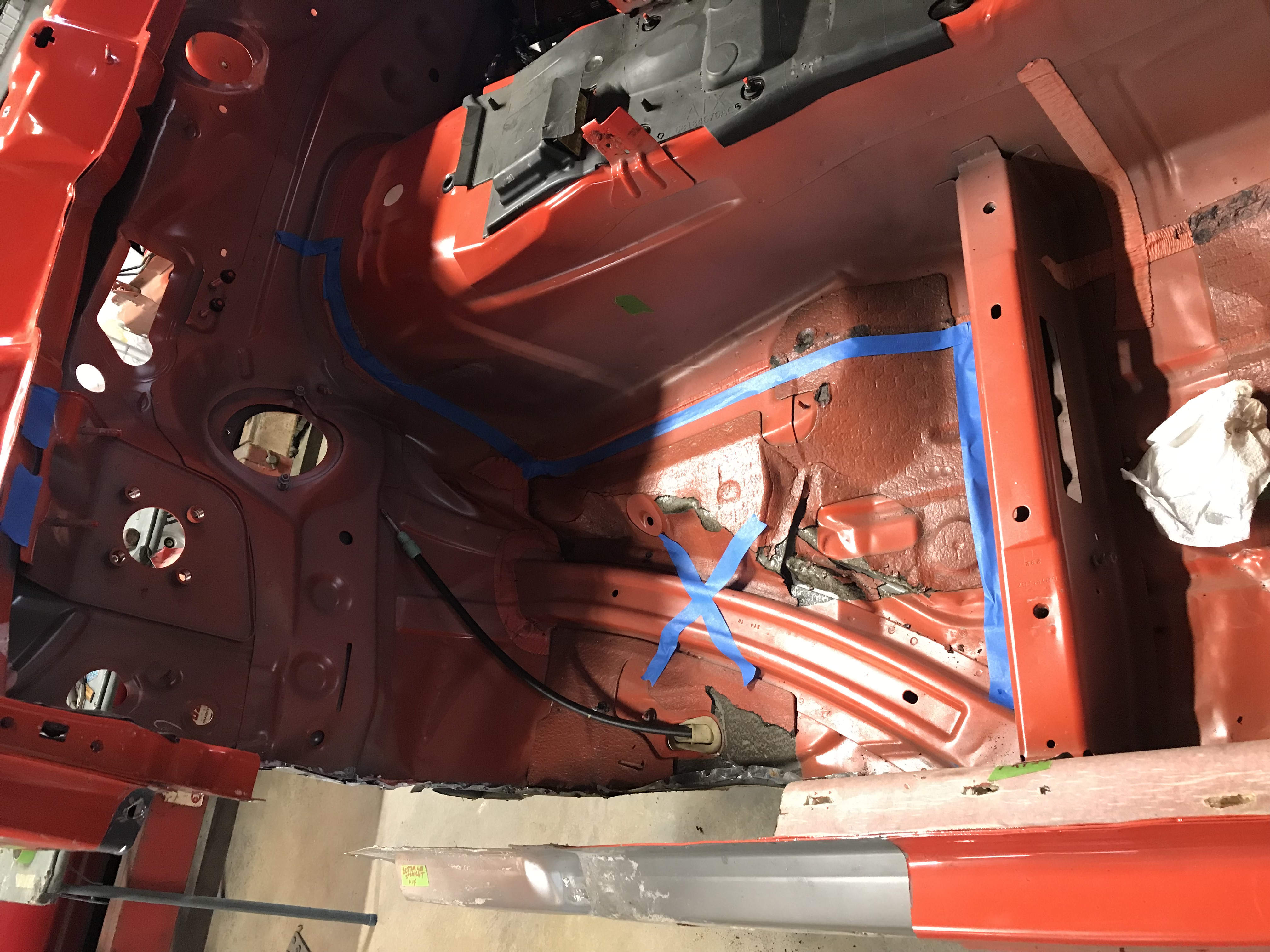

• Finally the time has arrived. With little fanfare I took a Sawzall within the damaged section and cut a big chunk off the car.
• This opened a decent working space and I then went to work removing the rest of the metal. Ground out the spot welds holding top of firewall to the crossbar, then removed the remaining strip of metal. Repeated the process to separate the last strip of metal from the trans tunnel as well. Most of the spot welds were removed with a drill.

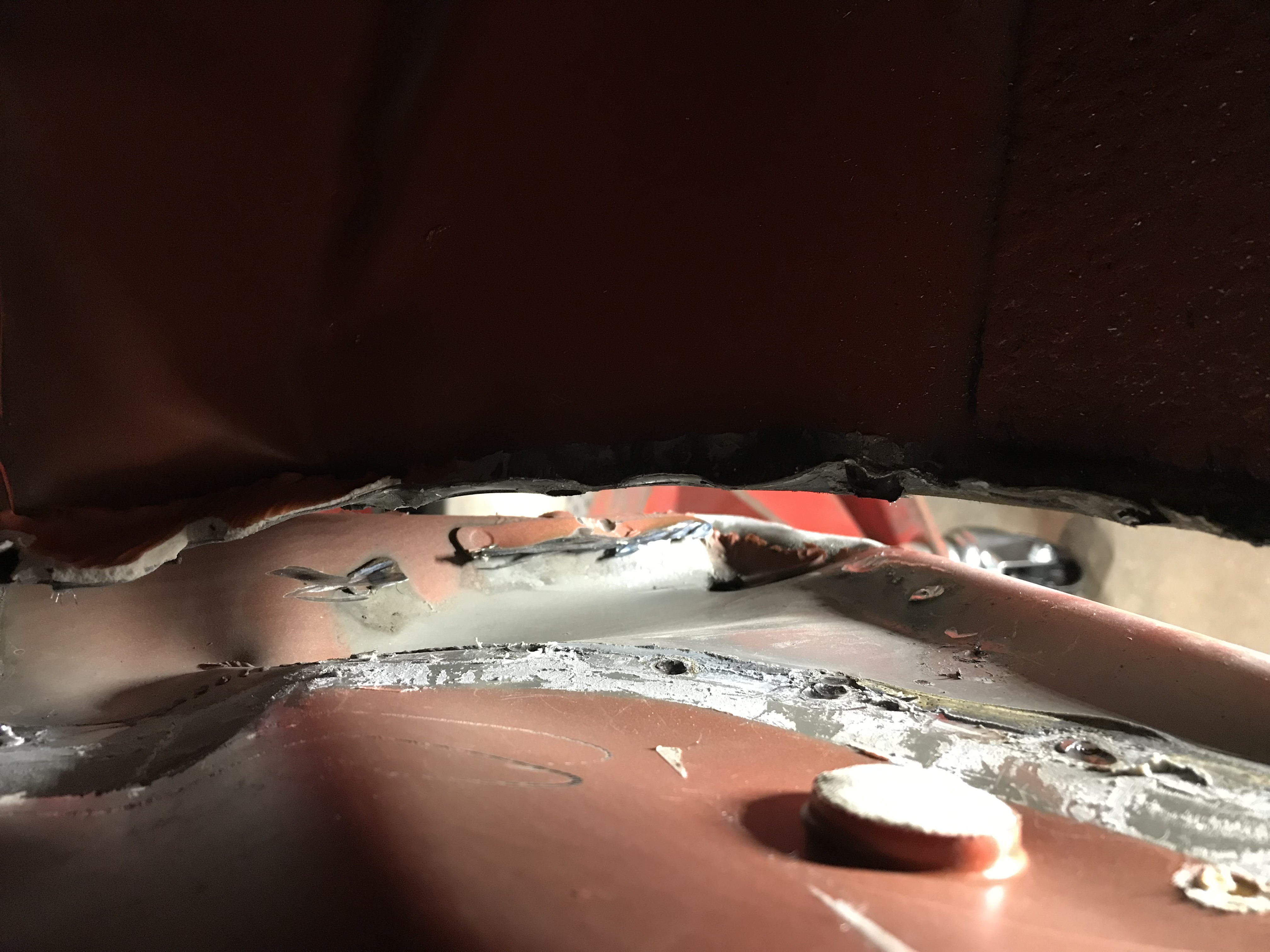

• Fix damage on the inside of the A pillar at dash level

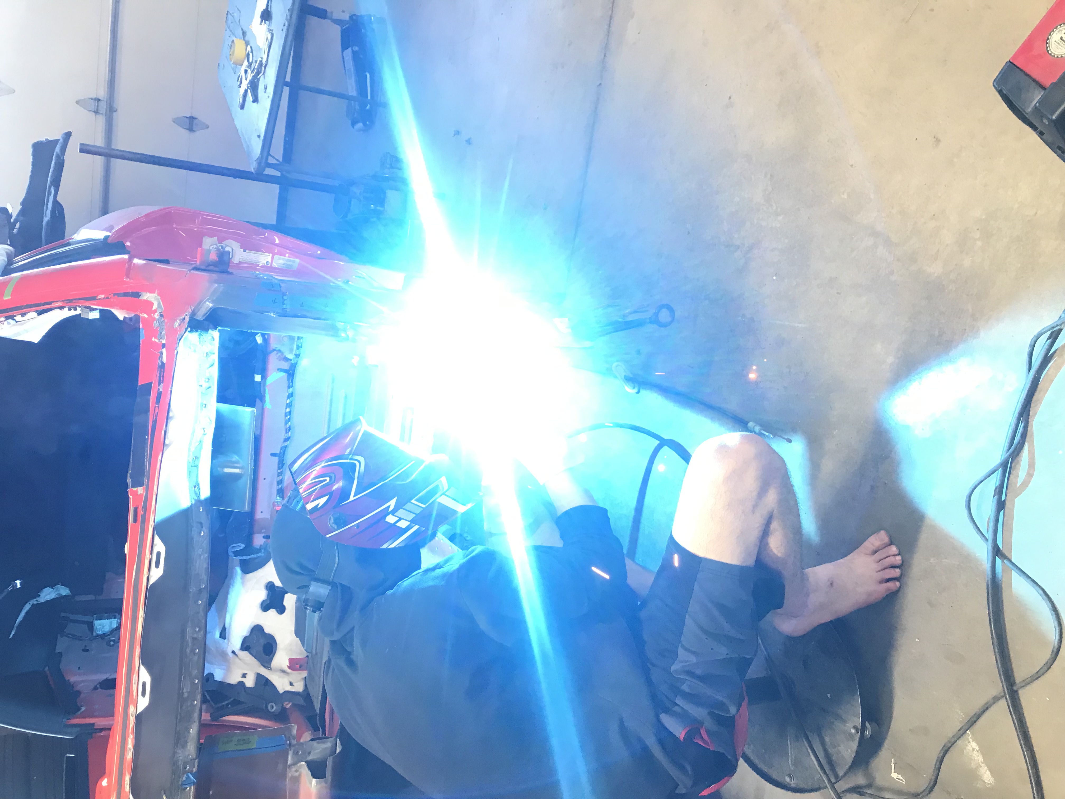

• Kurt did some additional welding – some spots on the RF frame rail, finish the LF frame rail, attach the front seat brace to the frame rail repairing accident damage

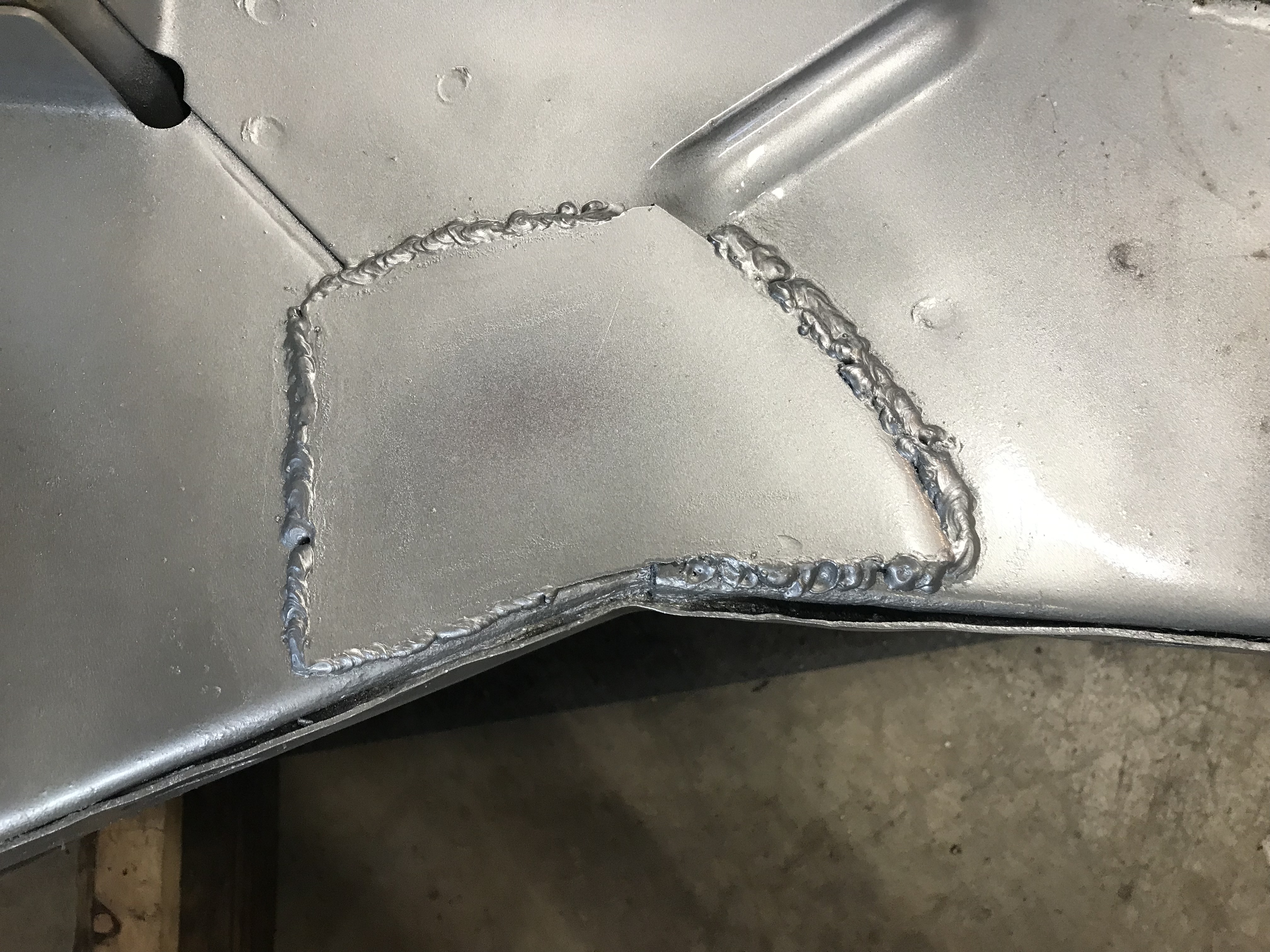

• Clean up the rust spot on incoming left frame rail/floor section, fabricate a patch, have it welded in, prep up the rest of the minor surface rust and paint.
• Trim off extra metal on car and incoming frame rail/floor section.

• Had Kurt do some additional welding on the lower A pillar so the major LF frame/floor/firewall could be test fitted

• Fit this into the car. Required multiple test fits and some adjusting of the car. As it turns out the driver side of the transmission tunnel was moved inward slightly during the crash. Also, as I lined up some sections, others would get out of line. Measurements on the car were telling me things on the original chassis were in alignment, but this piece was not lining up telling me they were not. I made sure the frame rail and the firewall looked right before any welding. In the end everything except the floor pan to frame rail lined up. I was able to tweak the floorpan a bit to close up the gap. Glad this is not a show car lol

• Had Kurt weld some of this into place – major connecting points

• After cleaning, I labeled all the welding spots with masking tape to help catch them all during welding
• Scrapped the parts car. We had a couple decent days which I used to sort through what was left and keep whatever I deemed useful, tugged it up on the trailer with a come along, and took it to the yard

There is still a bunch more welding to do so I’m taking care of other things until that gets done.
