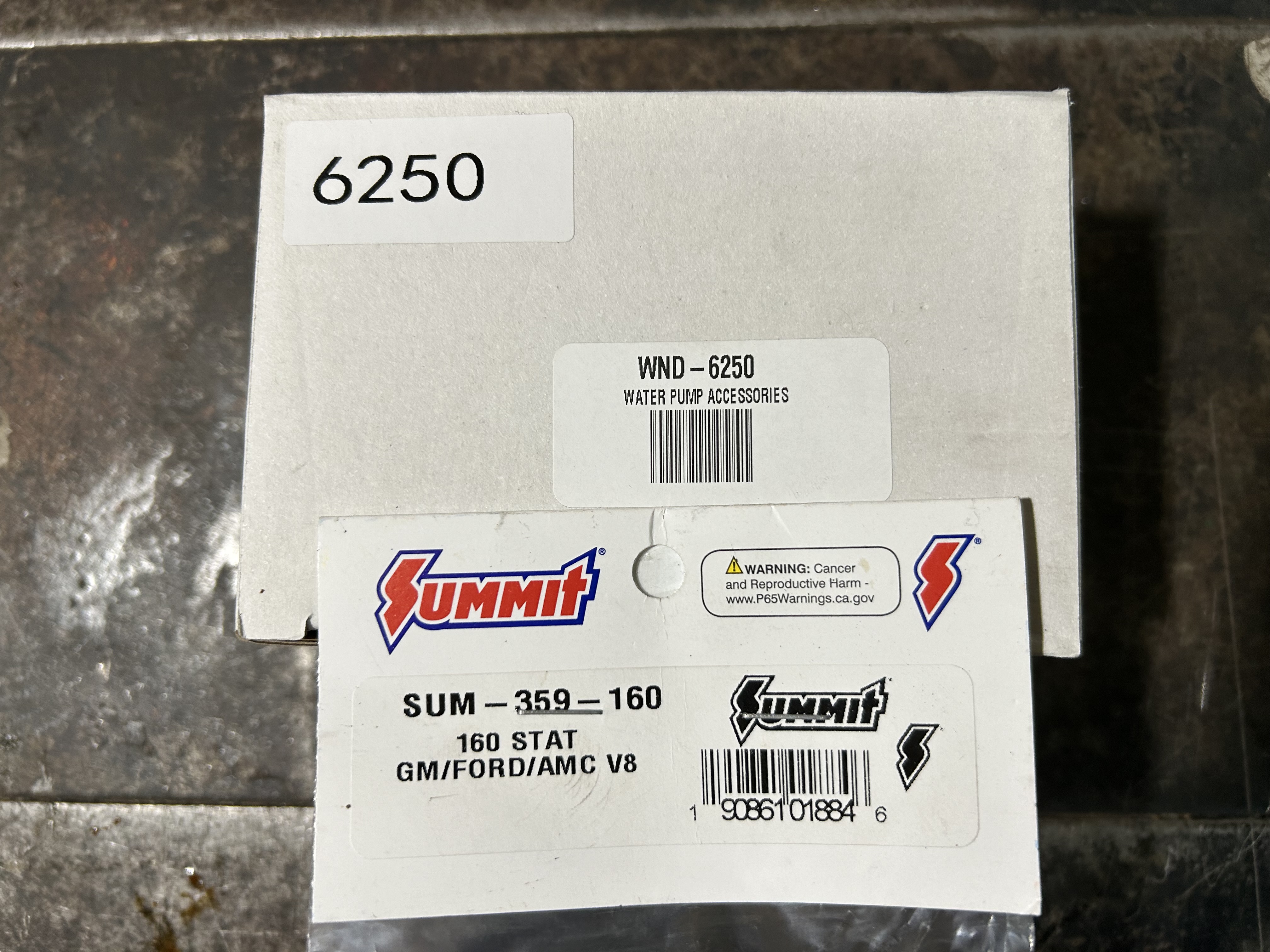

I think I have the spare tire mounted how I want it. The spare is a donut spare with two separate lug patterns on it. At first I wasn’t keen on it, but being that I had to live behind the passenger seat and it’s lighter than a full sized spare, I decided to keep it, at least for now. There’s also a scissor jack that came with the car that worked just fine. I’ll use it too. I need to procure a lug wrench. I will. After fiddling with the spare, I went into the engine compartment. I started by hooking up the tach wire. Then I drained the coolant so I could hook up the mechanical temp gauge. The big issue with this project was that the upper radiator hose was routed right over the hole in the intake for the temp gauge bulb. I bought a Summit Racing 45* swivel water neck to cure the problem. I overthought the issue and the neck had too steep of an angle for comfort. I decided to make the trek to Summit and exchange it out for a 15* swivel neck. Way better! After some engineering that was required to make the alternator bracket stud work (the stud is recessed in the water neck. The bolt hole in the neck had to be opened a bit to accommodate the stud, and the stud was double-nutted so I could torque on it.) I was able to put the new 160* thermostat in, finish mounting the water neck and put coolant back in. I saw no leaks, but I was pretty beat and opted to not start the car. That’ll be next. I think the seat is ready to go in also. To keep from scratching the door sills, I need my wife to assist. More stuff behind me.
