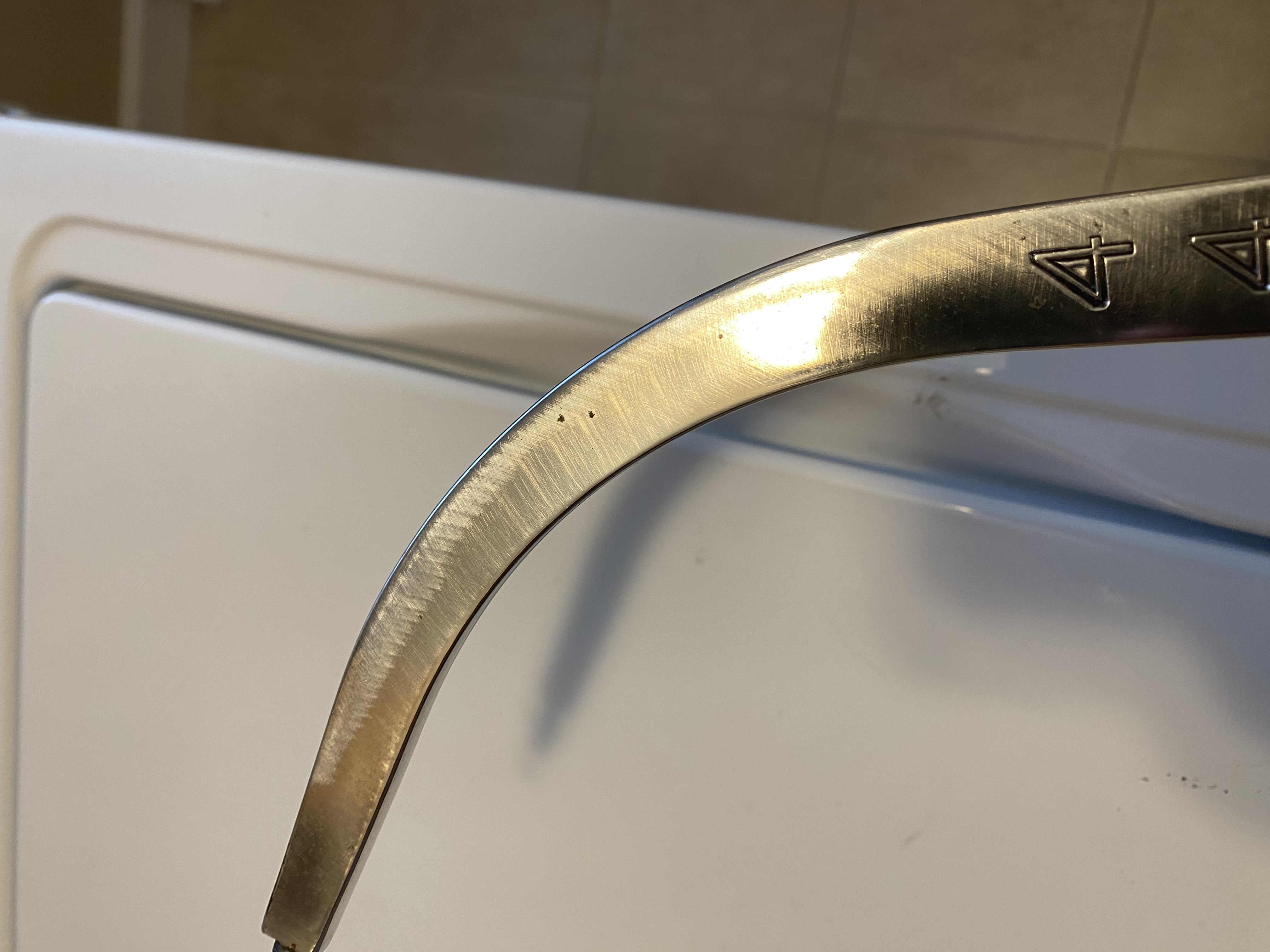

I’ve searched around for a factory shifter lever for the 442 since I’ve owned the car. The lever that’s in the car works fine, but it’s not correct for the car. I was able to score a decent shifter lever for $135 shipped to me last week. The lever I purchased looked like someone took a bench grinder wire wheel to it in an effort to remove the rust. The the threading that holds the ball on was a bit marred up as well.
I decided to jump on it, as it’s the cheapest one I’ve seen for months and months. Typically, these go for over $250. I put a bit of work into it and it turned out pretty sweet! A die on the threads cleaned them up enough where a nut holds tight to them. I spent a couple of hours with my bench grinder wire wheel, steel wool, scotch-brite pads, sand paper and rubbing compound to get the end product I have now. ( I finished with wet sanding 2000 grit then power buffed it.) A coat of clear gloss paint sealed it off and will protect it from rust. It doesn’t shine quite as good as chrome, but it’s a solid 90% of the way there. I have over three hours in this thing, but it was worth it for the look. I’ve ordered the correct thread ball and an adapter to adapt this Muncie shifter to the Hurst Competition Plus shifter linkage in the car. I’ll post those pics when the parts come in. More to come!

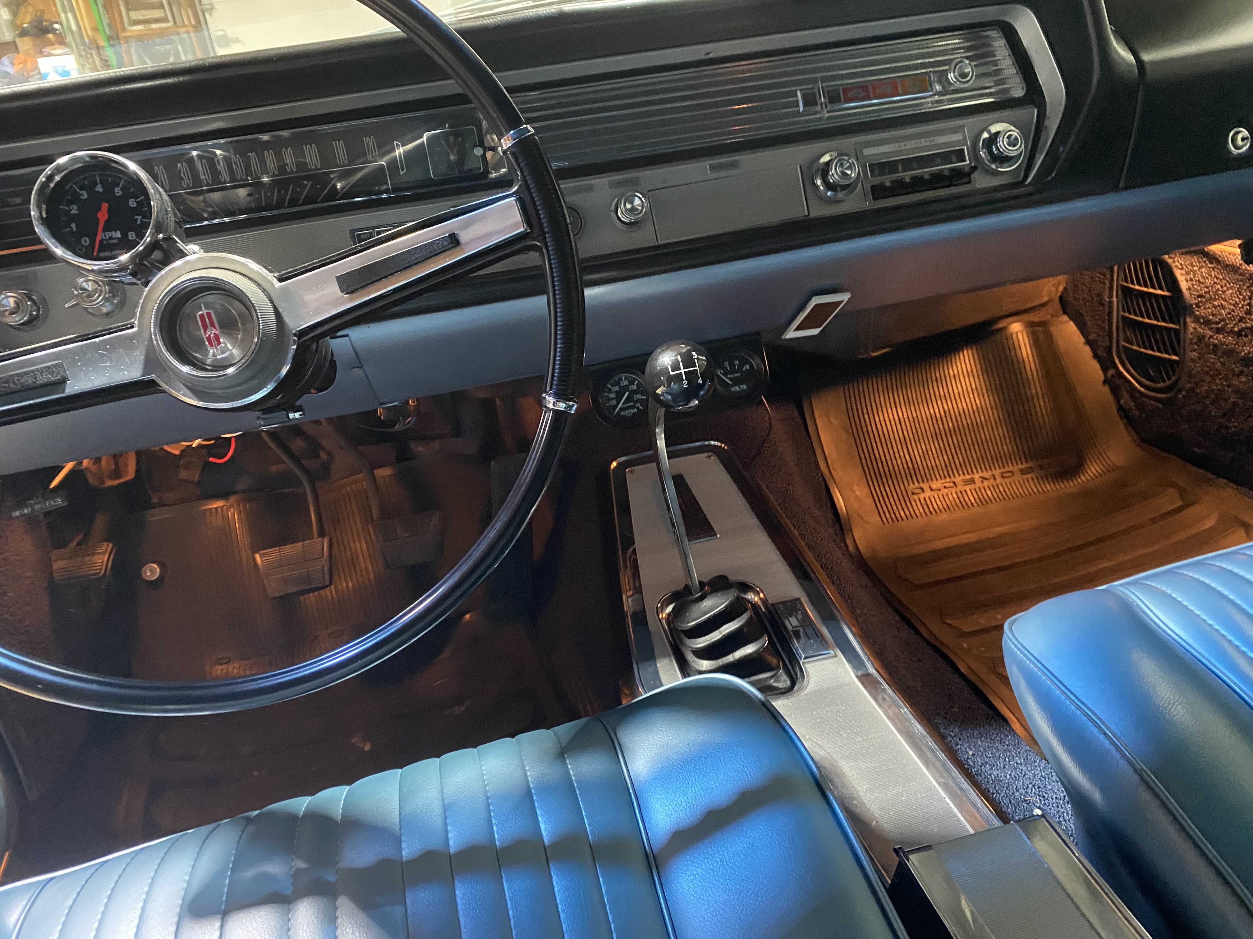

I’m a bit tardy on the post of this, but a before the new year, I was able to get the shifter installed in the 442. It looks and feels great! I think there might be a small amount of tweeking that has to happen to make sure that it’s just right. The “A-Dapter Kit” that I used to make the Muncie shifter line up with the Hurst linkage is making the bottom of the shifter contact the inside of the rubber console boot. I think I can modify the bolts that I used and grind some rubber off of the grommets that are between the kit and the shifter itself and loose about a half inch, which would be perfect. My concern is that it might pop out of 2nd and 4th gear the way it is. It’s hard to say with the car stationary in the garage. I can deal with this in the spring. It takes 15 mins to get the seat and console out, so it’s just a minor job to get to it. Here are some pics of it in the car, new black shifter ball installed.

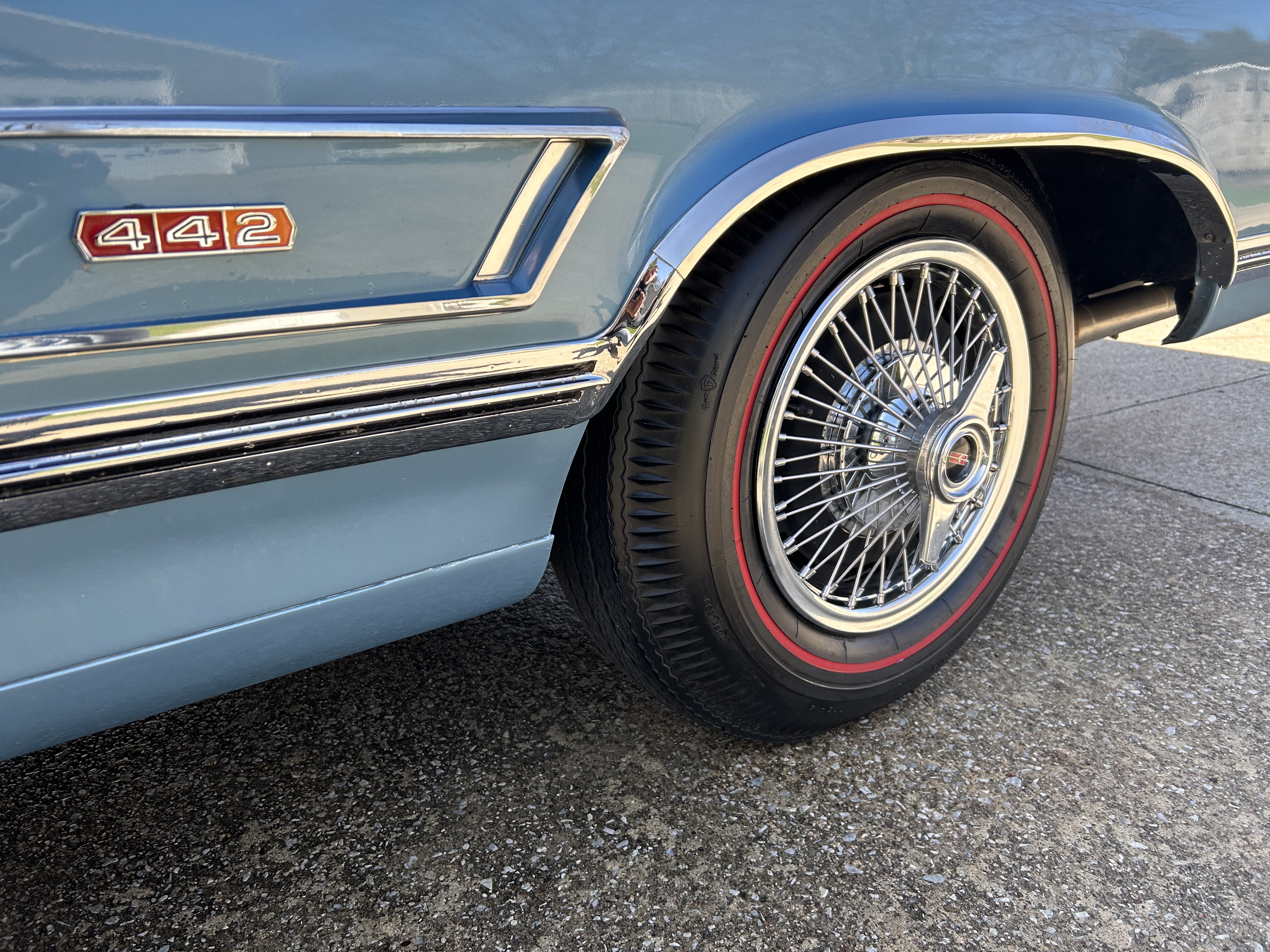

So here’s the final outcome of the redline tire project. The tires and caps are factory stock look for the ‘65 442. The 7.75 x 14’s are narrower and taller than the 225/70/14’s I took off. The tires look pretty good, but need a good cleaning. If the weather had been a bit warmer, I would have taken the tires out and cleaned them, but it was right at 32 degrees and I wasn’t up to freezing yesterday. I put new lug nuts on while I was at it. I can’t wait to feel the bias ply and skinny tire feel! I’m going to hold on to the chrome wheels and RWL tire combo for a bit. I might want to go back and forth between the different tire combos.

Those look cool because nobody runs their cars that way, but I like the mags way better. I still think you're going to really dislike real bias tires. I remember them on my Pinto and they sucked. Now, yours are a lot skinnier than mine, so maybe that will help somehow. But like you said, you have both, so you can switch back and forth as desired.
Posts: 2746
Re: 1965 Oldsmobile 442
The red walls look good.
I would not run those skinny tires on a car that heavy. If the manufacturer used current rubber technology it should at least have more grip than the original bias ply tires from the 60's.
The Saturn came stock with 195 tires (7.67") and weighed like 2500-2600 new. On the other hand Rachel's 2013 Charger police came with 225 tires and it weighed 4300. So who knows?

These skinny redlines were what came on the car from the factory, in 1965. I’ve seen guys with tires that are as wide as
10” on the rears, maybe even more. There’s no argument that wider, radial tires ( or coil-overs, or maybe an LS motor)
will be a better option from a performance standpoint. Modern tires and everything about modern technology leaves this car in the dust. That’s not the point of running this type of tire or vehicle. I might hate the way it rides, it’s been a few years since
I’ve driven on bias ply tires. We’ll see..I miss my manual steering on my last 442, so one never knows.
