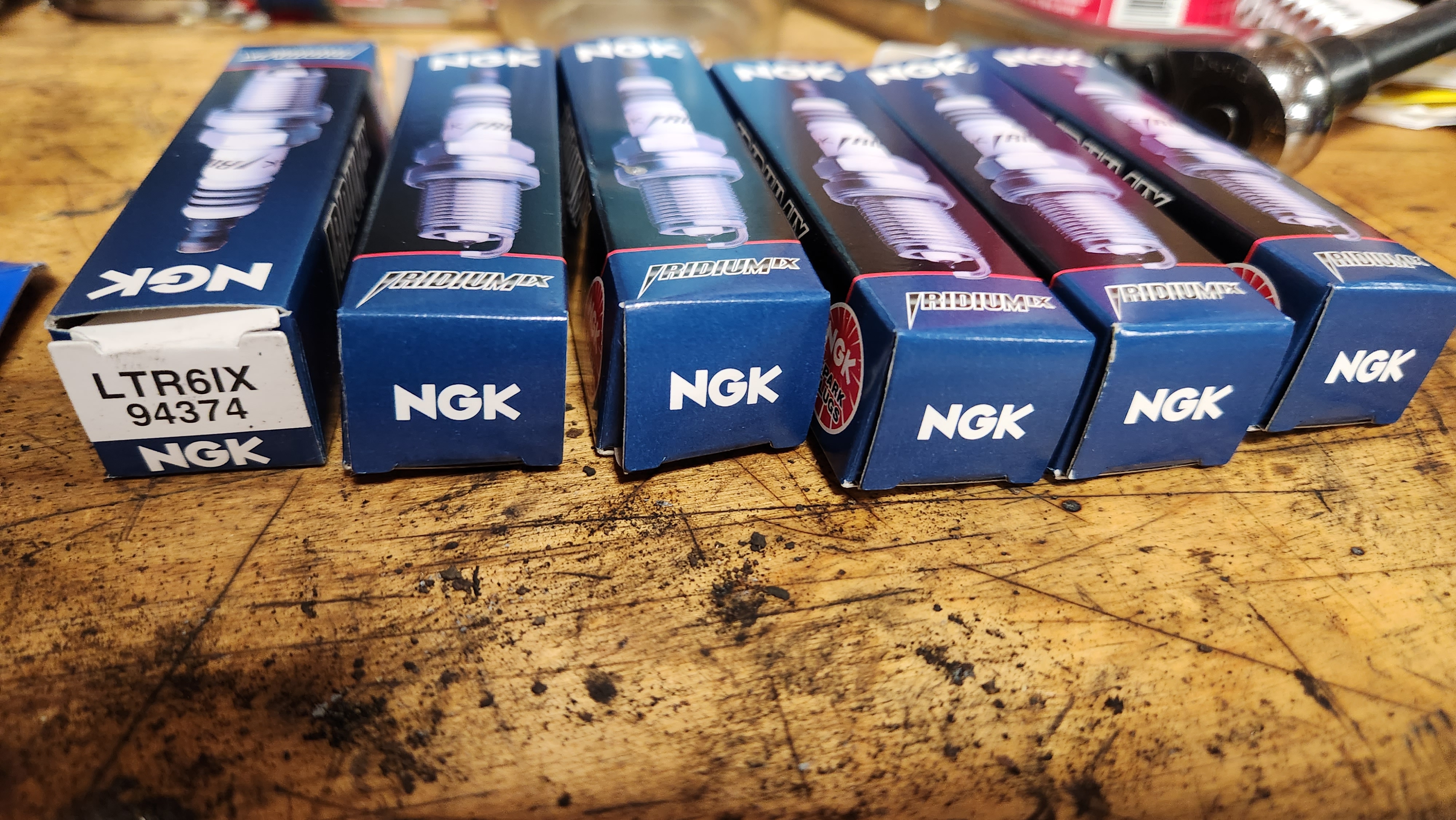

80,067. Plugs and coils are done. All said, it was a pretty painless job. It would've been easier with a spark plug socket that has the rubber insert, but I just used a short piece of fuel hose to retrieve the plugs out of the hole, and a piece of vacuum hose over the tip to re-install.
The old plugs have a Ford logo on them, so they are likely original. New NGK LTR6IX 94374 plugs with Delphi GN 10638-11B1 coils. A short test drive confirmed that it no longer misfires under heavy load.

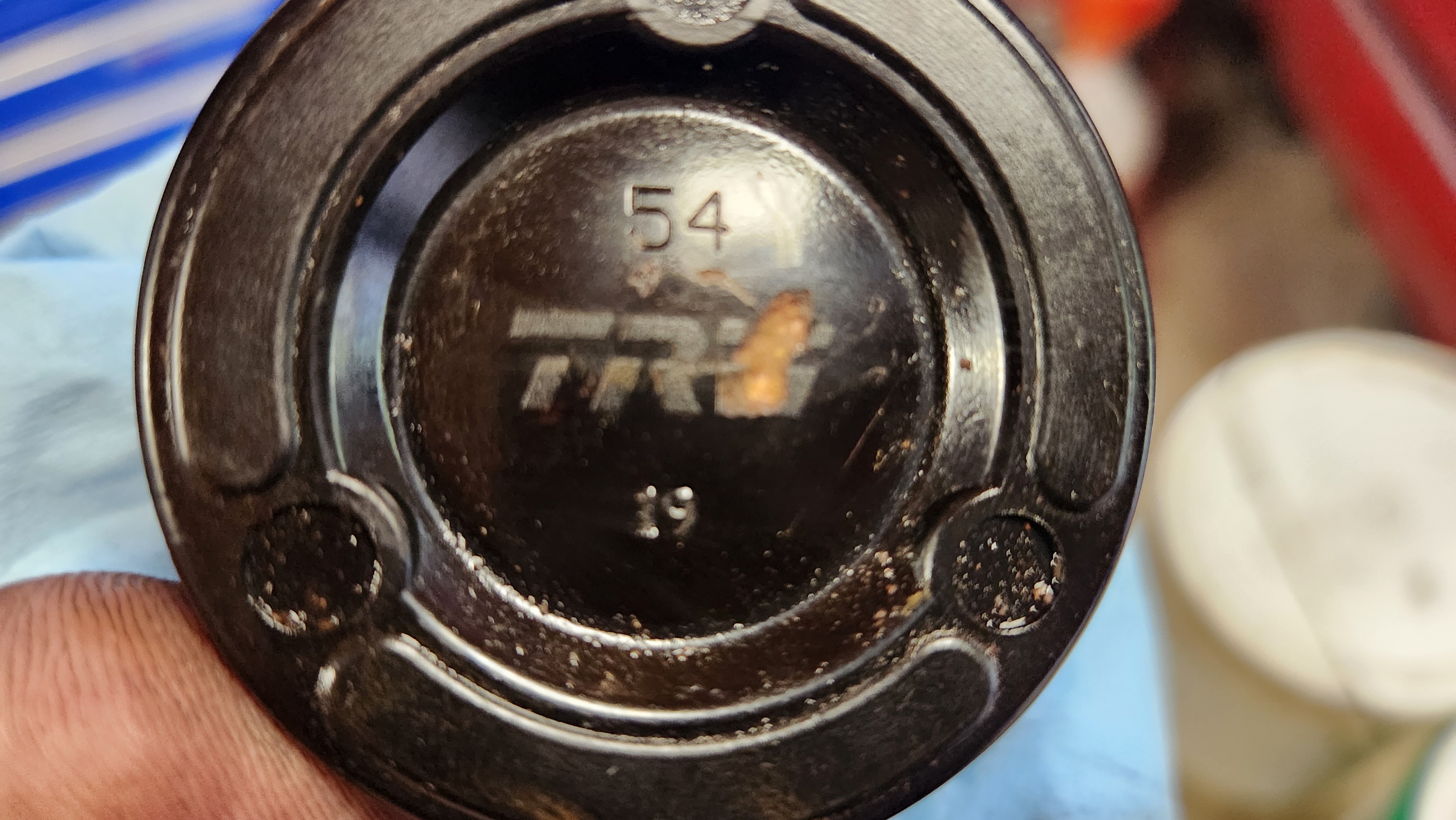

After that, the caliper swap was actually pretty quick and painless. Pads looked a little thin, IMO, for only 2-3k miles.
We bled it and Chris added a slathering of NeverSeize to the hub face area on brake rotor. Wheel back on and everything seemed to work fine.. Whew..
Check out the caliper piston.
