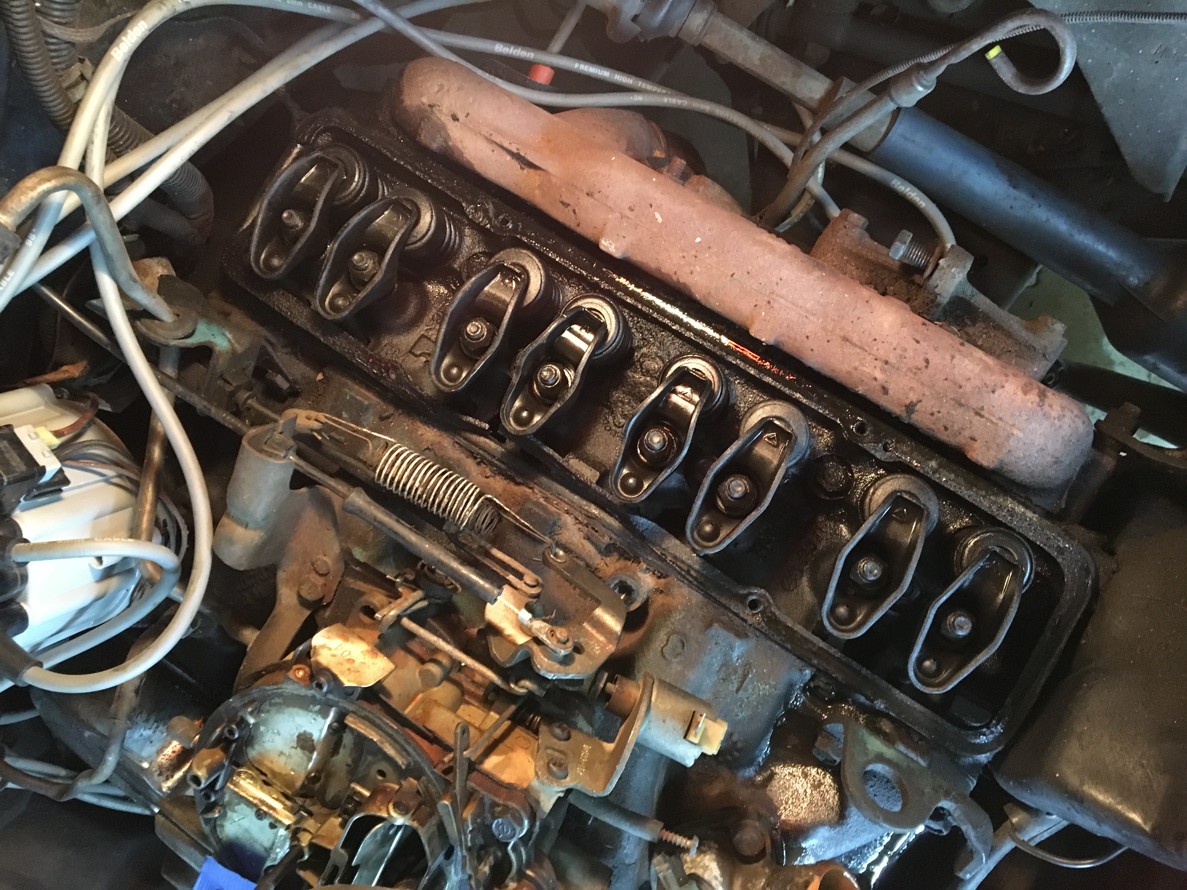

So I pulled the radiator and begin tearing off the top end. I took off the valve covers and smelled gas. I am thinking the valve seals are bad. Plus when I moved the car there was a puddle of trans fluid under the car. So I am going to go ahead and yank the engine and trans. Then we will see. Hopefully a simple rebuild/reseal kit and it will be fine. Time will tell.

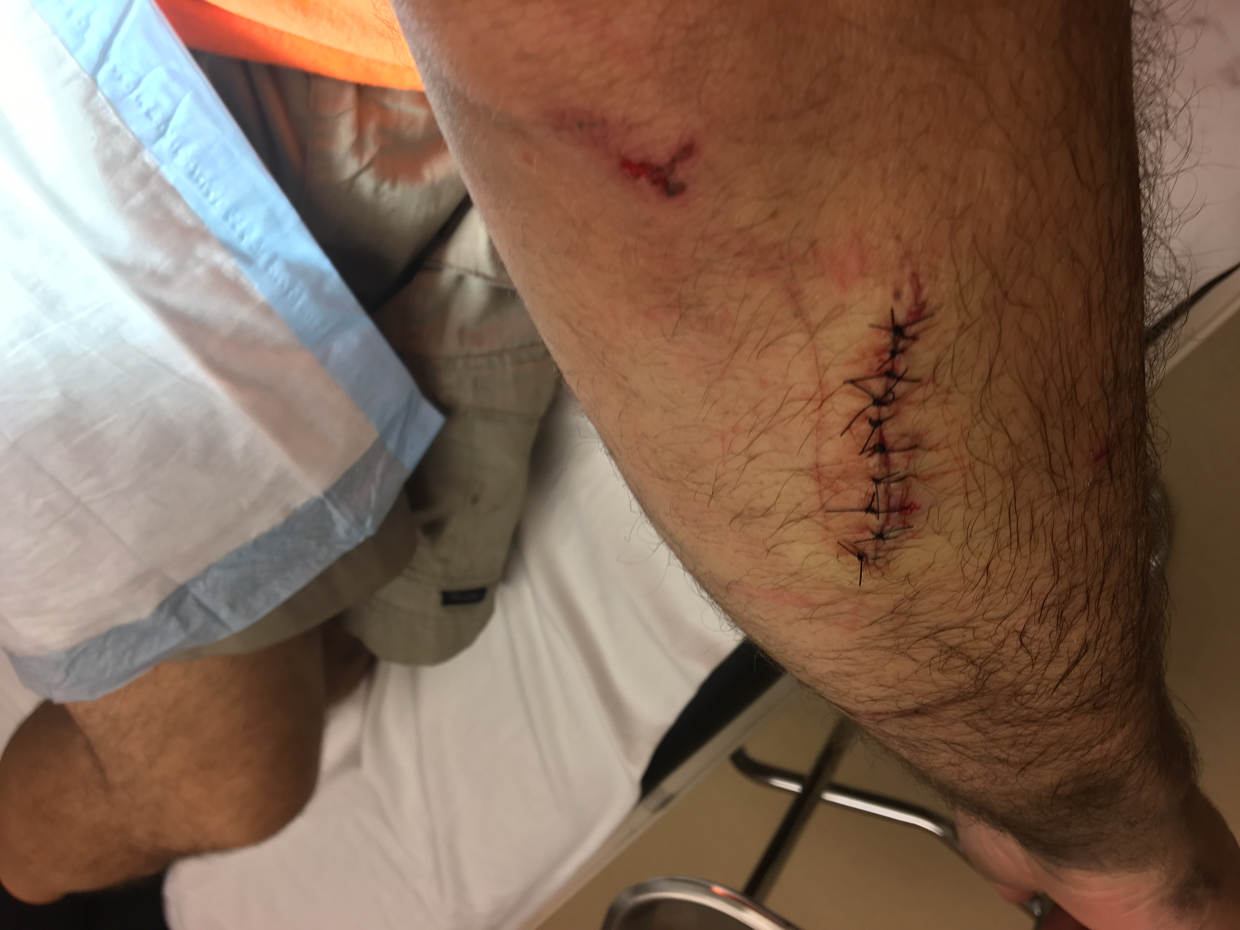

So on Saturday I was removing the engine by myself, which isn’t too bad but it’s always nice to have company. Well as I was taking out the last 2 bolts my hand slipped and I sliced my arm open. 10 stitches later........

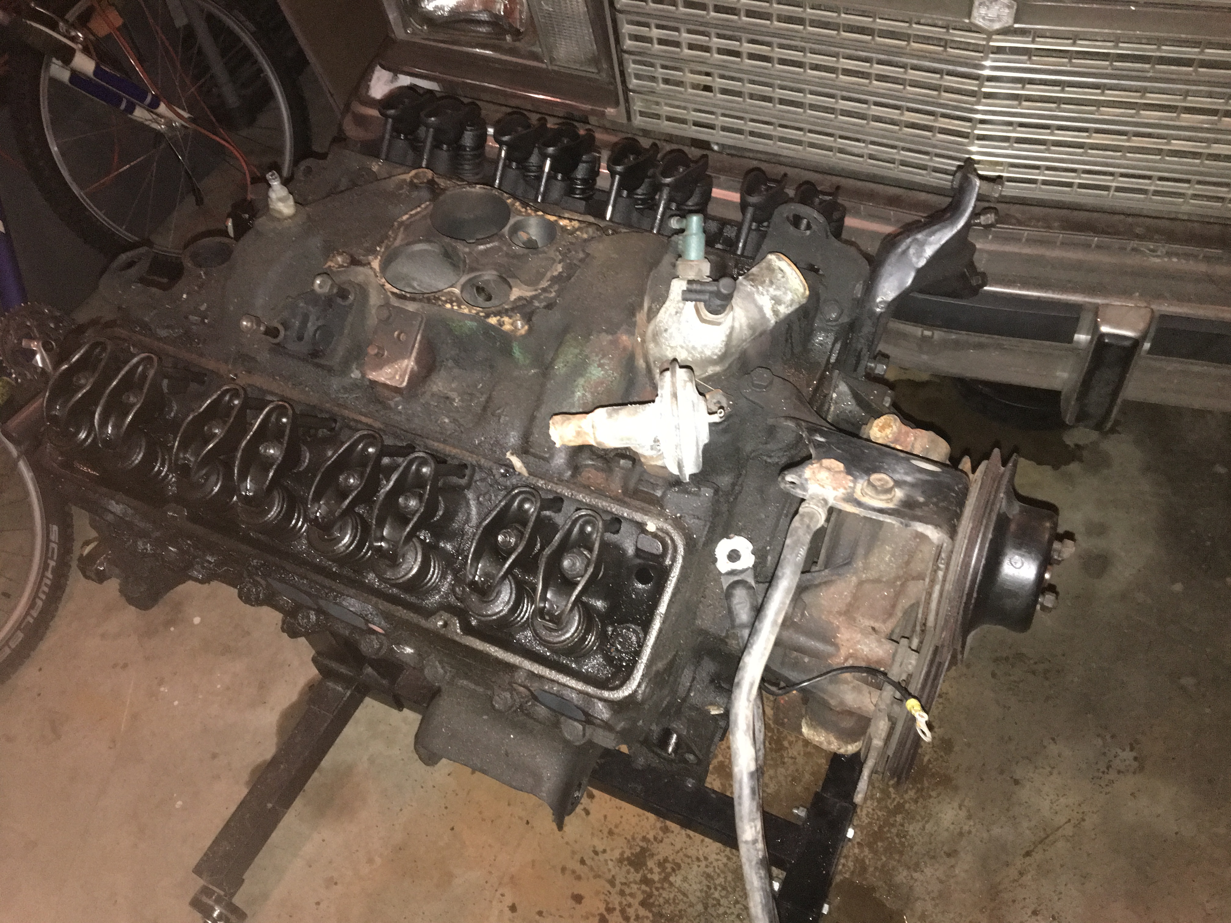

Tonight I felt motived and a little irritated because I didn’t get the engine out Saturday. So I removed the2 motor mount bolts and extracted it from the engine bay.

So now is my question. The engine turns over easily by hand. It is caked with dirt though. Since I plan to re-gasket it and probably re-ring it if the bores look okay. Should I seal the engine back up before degreasing it and pressure washing it ? I don’t think I care that I get some water in it since it’s coming apart (as long as I don’t let it sit with water in before disassembly).

Bummer about your arm. That looks pretty rough.

ttamrettus

I’m more thinking about water down the intake, in the plug holes, where the distributor was and into the oil pan area through the area around the pushrods.

Re: 1979 El Camino
I pressure washed the engine after removing it from the '81 Camino. Spark plugs, valve covers and distributor were installed. Taped up the intake holes and avoided direct blasting of the holes. Pulled the pan after power washing to remove any water that did get in. Worked OK.

Re: 1979 El Camino
If u are not planning to clean the block inners I would be generally hesitant to clean the outside without covering up the holes. My concern is not water getting in there you can take it apart and dry that up easy enough. All the dirt and grime and loose paint from the outside needs to stay out of the insides of the engine. With a pressure washer that crap flies everywhere I would not want that to get inside.
