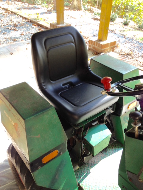

The new seat came in on Friday. Installation was straight forward. Pulled the adjustment rails (which were frozen) off the old seat. Cleaned and lubed them and they bolted right up to the new seat. Put it all back together and now I have an adjustable seat.

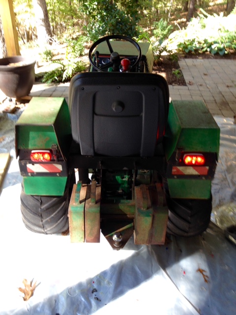

The new LED tail lights and headlight bulbs arrived and I finished the installation today. Unfortunately none of them light up. The condition of the connections is tenuous at best. Someone has replaced the terminals on most of the ends of the wires and I'm afraid of disturbing anything that doesn't need to be disturbed. I found one red wire that is connected to nothing. It's time to dive in and figure things out. Good thing I have a wiring diagram to work with.

Lights are functioning now. There were multiple problems. The first thing I fixed was the wiring to the tail lights. I had them hooked up backwards and the LEDs wouldn't light. Once that was fixed I ran into a dirty, corroded light switch. Since it was so old, I was able to open it up and clean and lube the slide and now it's as good as new. Just to be thorough, I cleaned all the connections to the switch and that was it.
