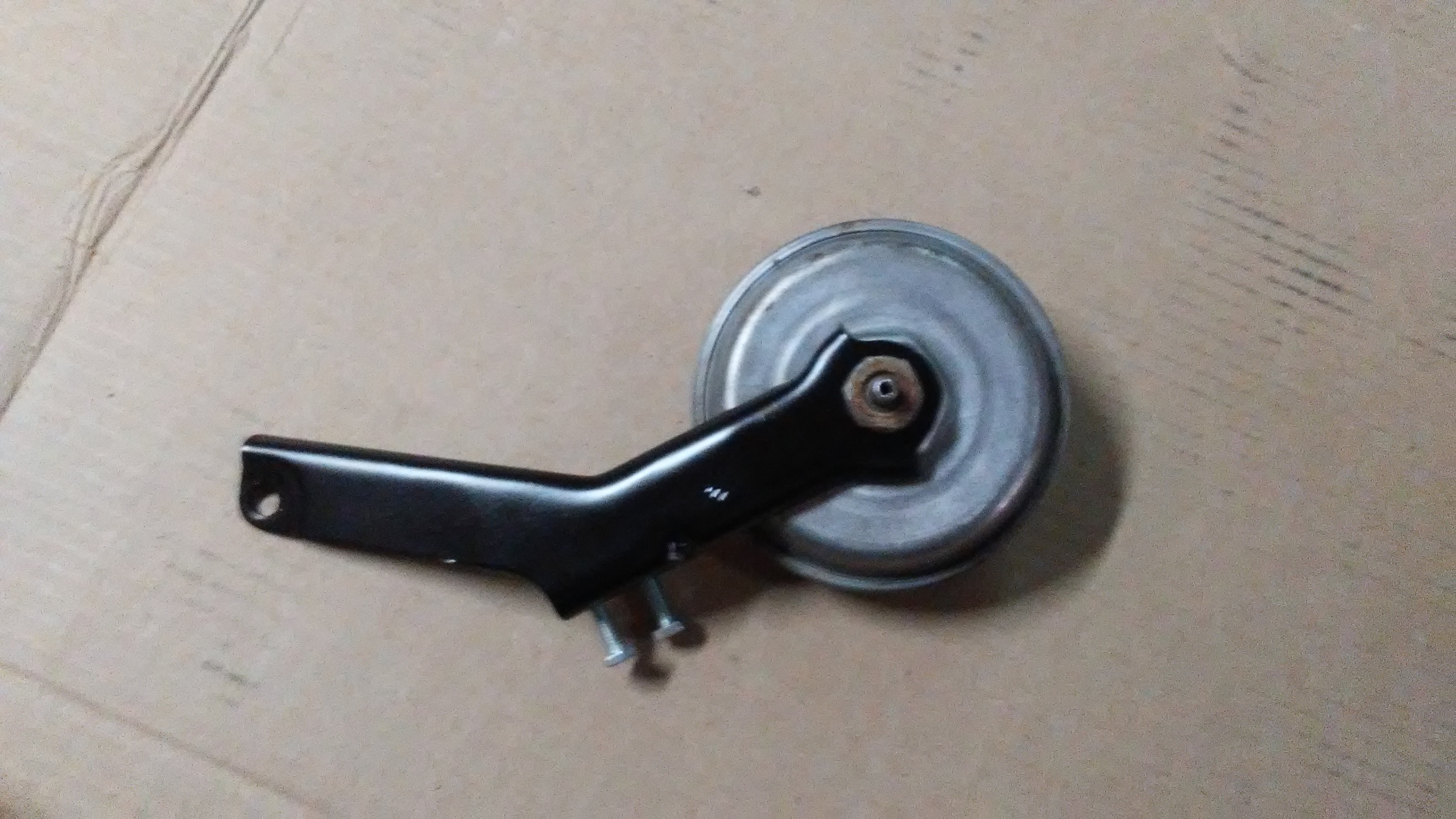

The second batch of cruise control parts arrived, incl the vacuum servo. Tested the servo with a vacuum pump and found it leaked down in about 5 seconds. Found a TINY hole in the diaphragm. A dab of sealer and it holds vacuum.
Still need to test the coils in the transducer for proper resistance.
Looks like some fab work will be required to mount the servo. A bracket came with it but it appears an additional one is required. The speedometer cable from the transmission to the transducer is included in the parts and should work fine. A custom cable will be required from the transducer to the speedometer head because it screws on to the Autometer head rather than the original, slip-on attachment.

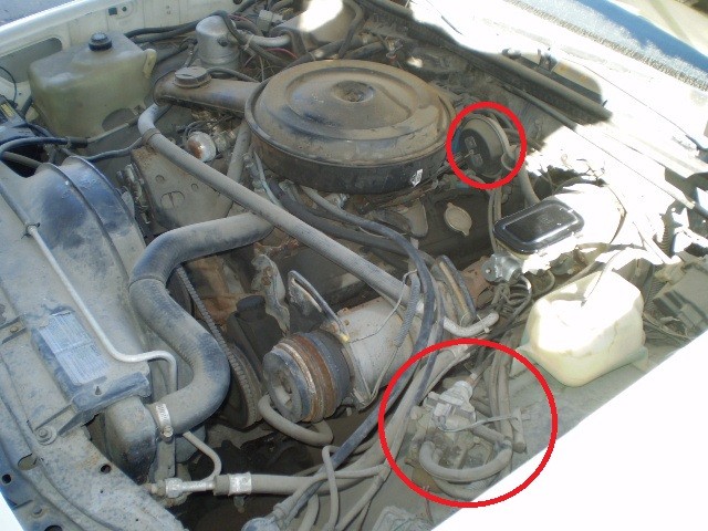

This picture shows how the cruise transducer and servo mount on a '79 which Is probably the same on my '81.
I have one bracket for the servo but apparently another is needed. I think this bracket bolts to the back side of the head and another bracket bolts to the 1/4-20 welded-on nuts.
In the first picture it looks like a second bracket bolts to the first one and also to the area of the brake booster but that makes no sense since the engine needs to move.
Any of you G body guys familiar with the carbed cruise servo mounting?

I'm no help to you on this one. My G bodies were all Oldsmobiles and they had a
different set up. It also has been forever since I owned one, and we mostly looked
at cruise control as extra weight back then, so these parts were always scrapped.
I'd guess it bolts to the back of the cylinder head. I'd bet you end up fabricating
a bracket for it.
