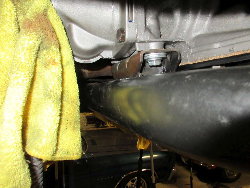

I put some miles on it today, drove it down to Andy's to help swap the trans on the Saturn after the failure at VIR, then to Fred's to drop off a couple items from Andy, then into Chardon, and then home. Probably at least 100 miles. There's still some vibration that I believe is driveline-angle related. It's fine under 60mh, but over that it starts to get noticable. I need to get under it with the suspension loaded so I can get some measurements. JagsThatRun sell some angled shims to go under the lowering blocks to adjust the pinion angle (if needed), and I need to also resolve the way the trans sits on the crossmember. I believe the trans need to sit lower. It doesn't sit properly on the pad of the crossmember. I either need to move the crossmember back, or I need to cut out a section in the middle of the crossmember. Looking at the frame of the truck, I don't have much room to move it back and drill holes without it looking all hacked up.
I'd rather modify/change the crossmember. I've been looking on craigslist and ebay to find an extra, but they're hard to find. The Blazer crossmember is different than the S10 truck crossmember. Trans-Dapt sells one that is for a TH400 in the trucks, and it's relatively cheap at $60, but based on the lengths from the bellhousing to the trans-mount listed here, http://www.tciauto.com/tc/trans-dim/ the Trans-Dapt might be too far back. But it might be easier to modify than the stock one. I was going to buy it today from Summit after leaving Andy's, but the work took longer than expected and I needed to get home.
