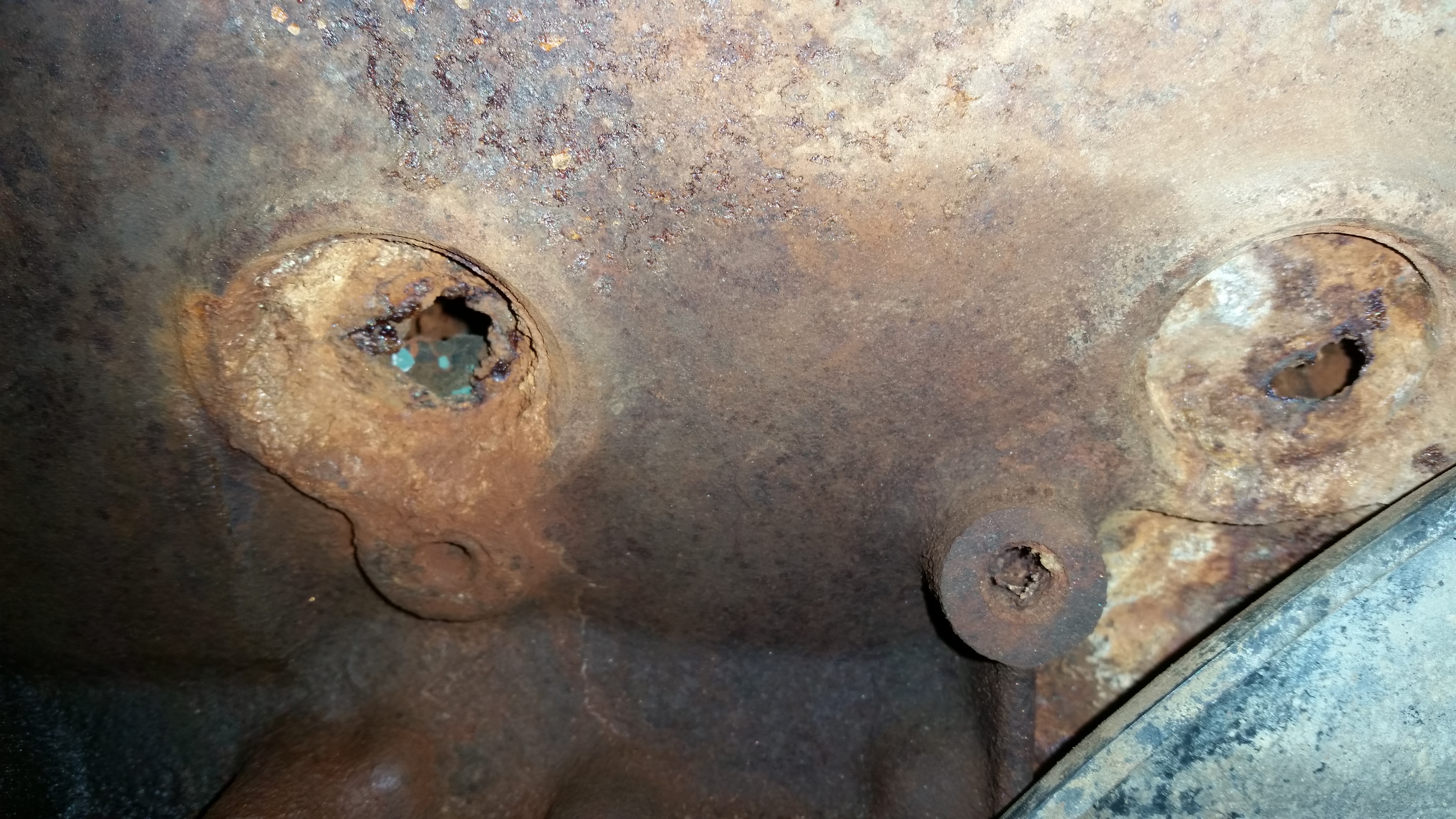

This Ranger belongs to the son of Maverick's and my friend Jim Hall. Today we drove to Greenville, NC to retrieve the Ranger. It will go under the wrench soon.

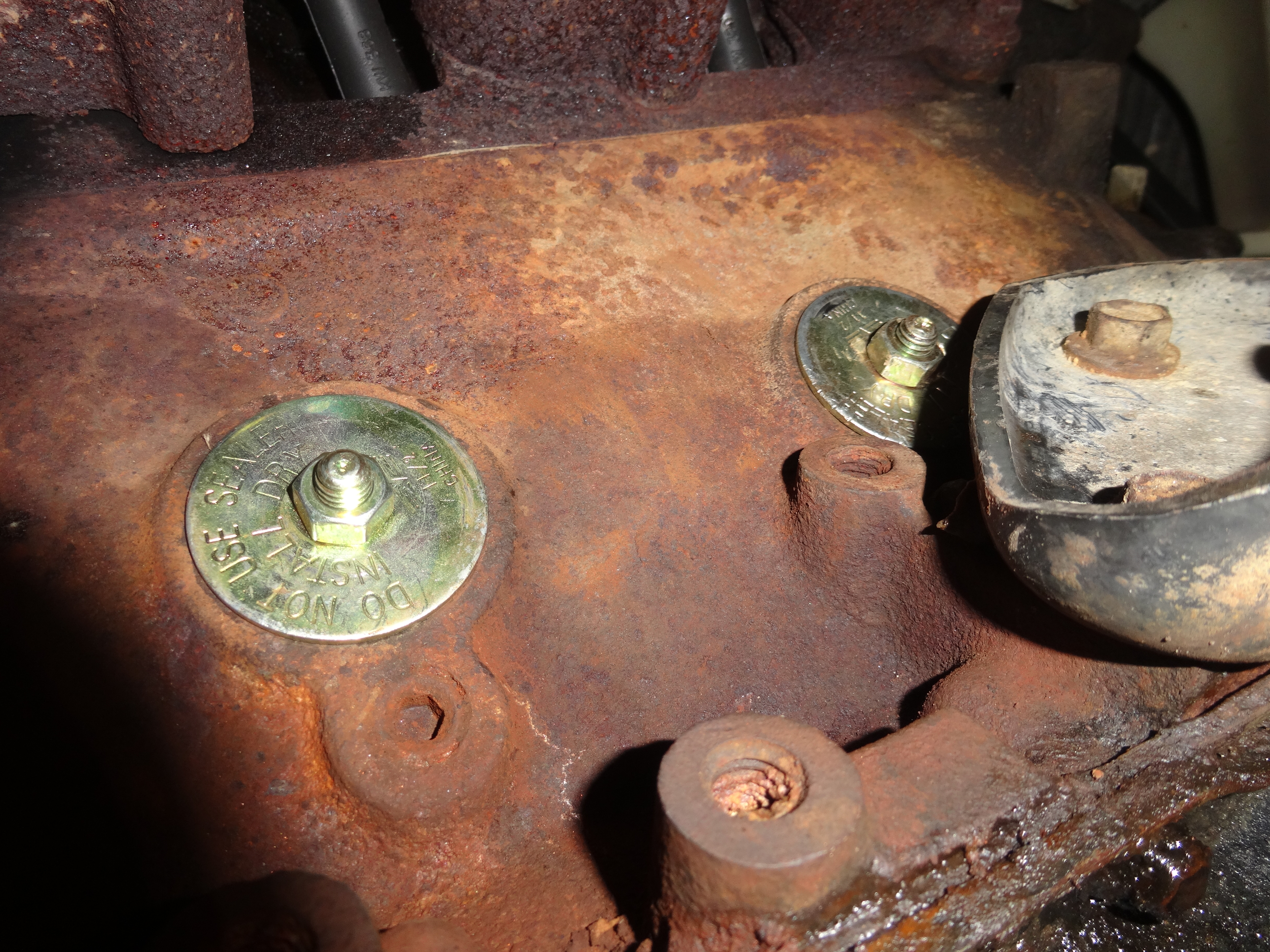

This from Jim Hall:
Jim was able to remove the damaged freeze plugs this morning. In fact Jim had already removed the really bad, rear one before I got to his house. Both of us beat and prodded the front one near the motor mount until Jim was finally able to knock it loose with a hammer and screwdriver. We then cleaned the ports on the block with emery cloth and then began the real challenge. We both pounded and pounded the new brass freeze plugs but could not get them to submit. They were not going into those holes.
Jim recommended that we take another look at adjustable rubber freeze plugs and we took a break to do some internet research. There were a lot of statements about the temporary nature of these plugs but there were successes ranging from 2 years to 30 years. We decided we would go with the rubber plugs and I fetched them. We flushed the cooling system and installed the rubber plugs. The rear one went in fairly easily but we had to pry, prod and pummel the front one for some time until it finally settled into place. The motor mount was not helpful.
We flushed the cooling system again, this time with the engine running, before filling up with anti-freeze. Jim drove the truck to my house and pronounced it operational before I took him back home. The truck is making a little noise which Jim diagnosed as a bad idler pulley and we will replace that in the near future.
Re: 1993 Ford Ranger with bad freeze plugs
We wish we could have installed the brass freeze plugs but we used our discretion and decided to go with the rubber. I expect they'll be good for a few years and it would be fairly easy to replace them every couple of years. We might have been able to do the brass ones if the exhaust manifold and motor mount were removed but the exhaust manifold bolts and studs were quite rusty and I was not optimistic they'd come out without breaking.

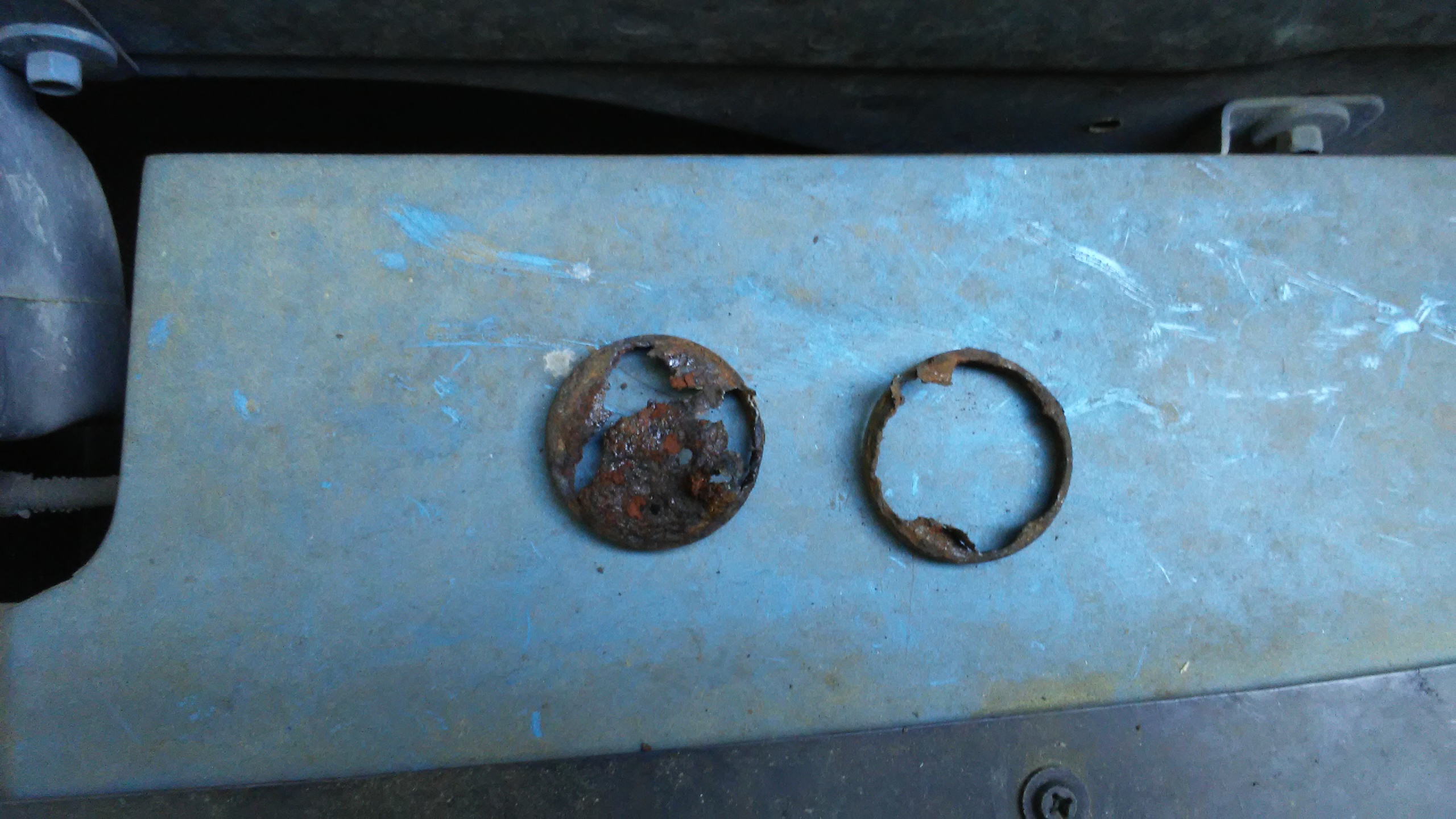

Here's what's left of the old freeze plugs.
Wish this had been in focus.
I'm thinking that if the brass plugs would have spent a couple of hours in the freezer prior to
install you might have been able to get them in. Maybe??
Wish I'd thought about that. Good possibility that would have worked, at least for the one that wasn't partly behind the motor mount. Maybe next time.GMJohnny wrote:I'm thinking that if the brass plugs would have spent a couple of hours in the freezer prior to
