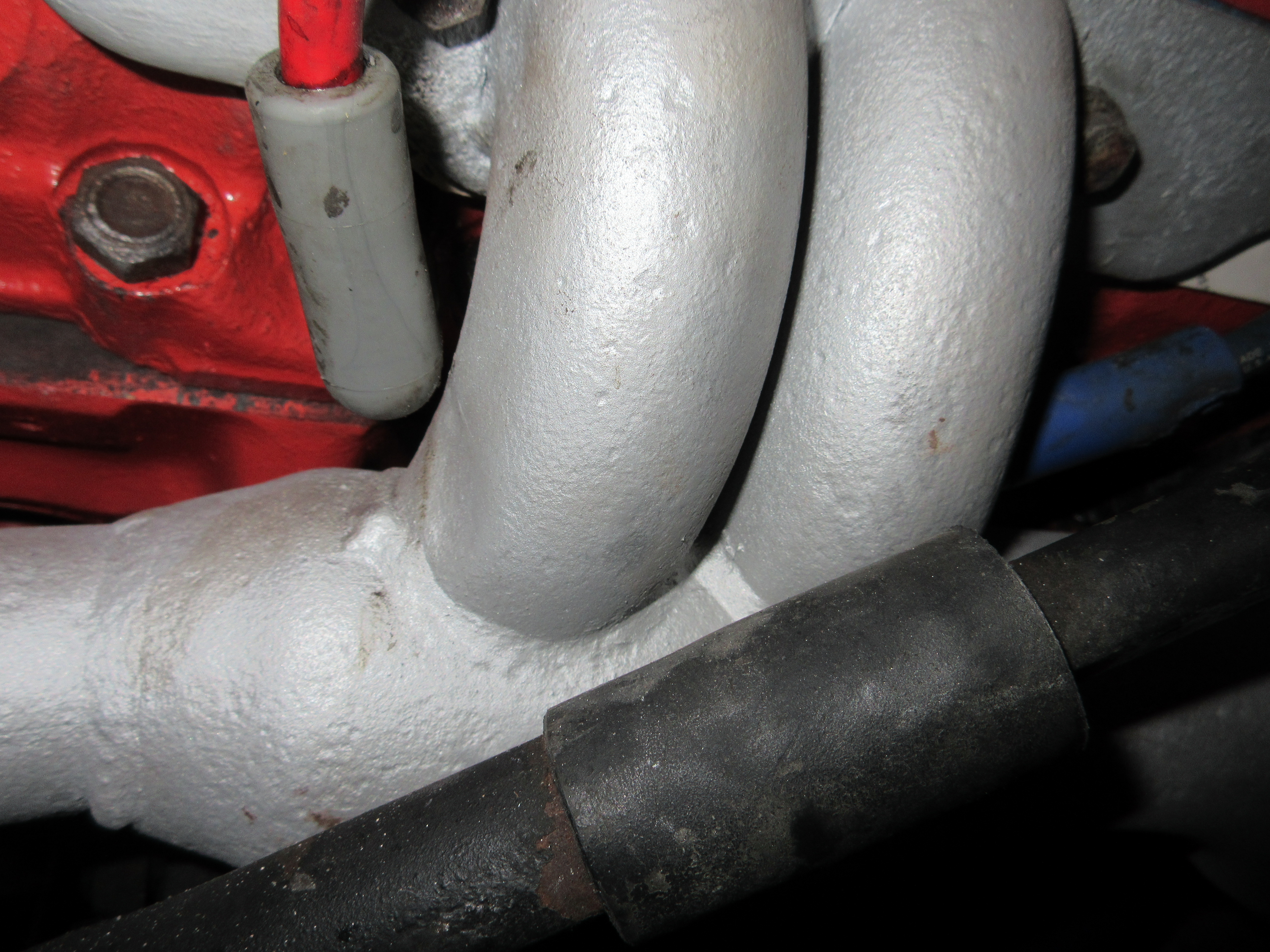

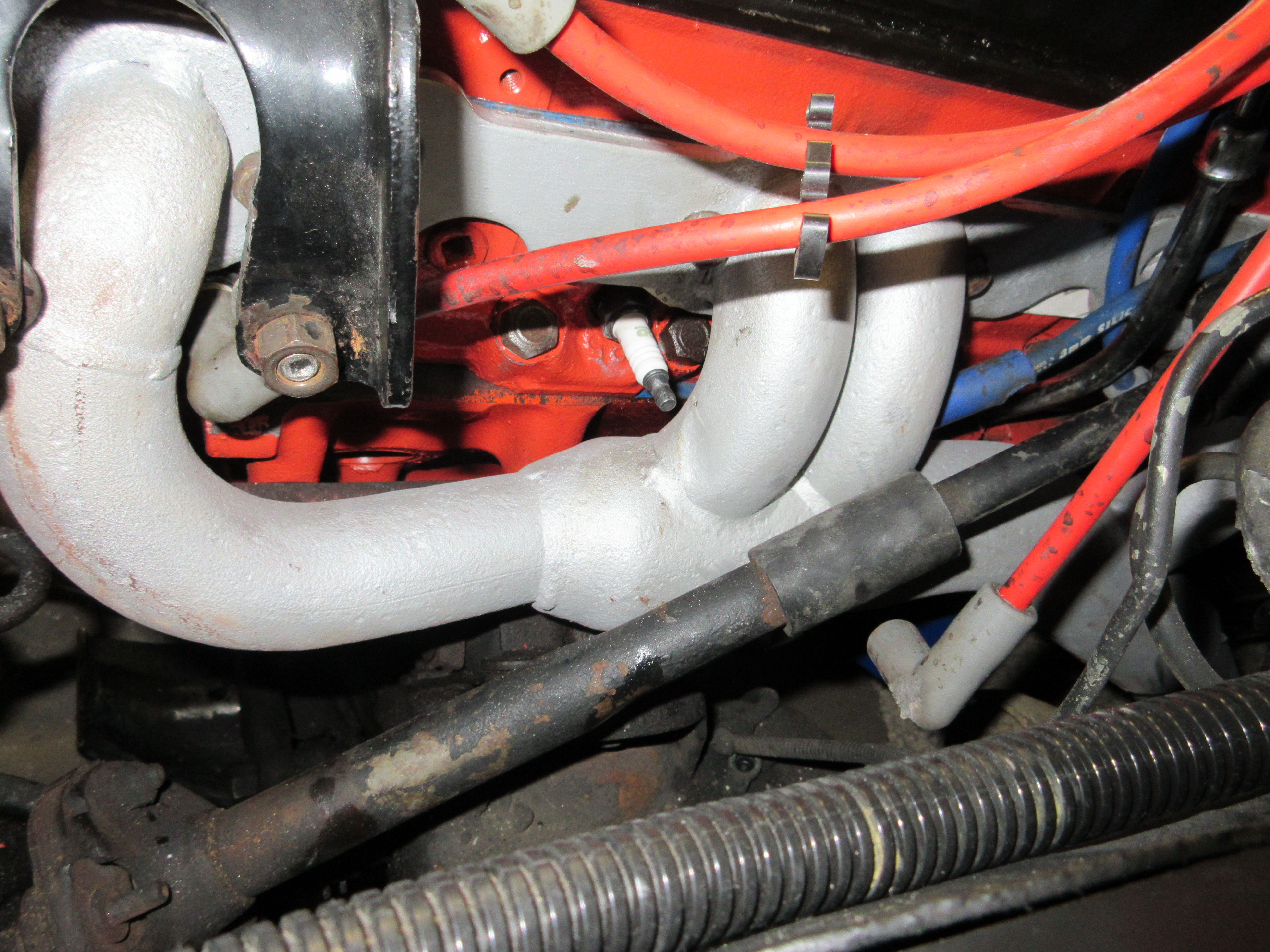

Well, I've got a problem and I'm not sure how I'm going to solve it. The Vortec heads have the spark plug holes positioned slightly different compared to other heads. The plug wire is really close on #3, close enough that the boot is melting and then the spark is arcing to the manifold. #5 looks almost as bad, but not quite, but maybe because it's more difficult to see. #1 looks ok, and I can't see #7 well enough yet, but I suspect it's ok. The passenger side is a-ok, as they don't run the manifold pipes so close to the engine. The driver's side needs steering shaft clearance.
I have some options:
*) shorty spark plug -- not sure how much clearance I'll gain, because the boot will still be very close
*) try to clearance the manifold --possible, but risk cracking/damaging the manifold, because there is a weld right where I need to clearance it. I'm imagining setting the ball end of hammer against the manifold and striking the flat end with a 2nd hammer to try and create add'l space. It also looks like I'll need to remove it from the vehicle to do it.
*) wrap the manifold -- not sure I'll end up with enough clearance. But there's some left over header wrap in the garage from when Gwen wrapped the exhaust on her bike
*) ceramic boot spark plug wires -- they really pricey -- $100+ for a set, and I really only need 1 or 2. I'd never heard of these till researching this problem tonight.

Dave: For the time being, can you use "sleeves" like I had on my wires?

Dave - the design on that header does not look to be very efficient.
I think you should try and clearance them. If you break them I know a guy who can weld. If that fails then I think it would really like some true 4 into 1 headers. https://www.summitracing.com/parts/hed- ... /model/s10 - I am quite confident these little pipes would be better than what is in there now though I would look harder for larger pipes. I don't know the vehicle well enough to know if a full length header would be better or worse.

Tony, I do have some of those sleeves around.. somewhere. I was thinking about that, but the gap is so small that they would literally be against the manifold all the time. Not sure if that would be safe? I'm not even sure where they are -- are they at your house by chance?
Andy, those mid-length headers are constantly frowned up over at v8s10.org. I believe the biggest gripe is that they are hard to tighten at the collector, because that collector ends up right around the very tightest spot, which is where the exhaust goes past the bellhousing -- I had to cut both ears off the 700r4 just to get the current exhaust to fit. Previous TH350 had passenger side ear cut off. Full length headers would be nice, but they're ~ $475. While they would defintely provide a performance improvement, I'd still need additional exhaust work done to accomodate. I'm trying to avoid that route -- for now.
I guess I'm gonna pull it off and bang on the manifold first, maybe combine it with one of those sleeves. Hopefully that will do the trick.

I ran those sleeves on my V6 where the wires were just about touching and the sleeve was touching the whole time with no issues. I reused them on the V8 where necessary, but it's not quite as tight on the LS and I now have ceramic coating. I did NOT have that on the V6 and all seemed well.

Well, I found the sleeves and it certainly seems to have helped. The boot is burned through on the corner, so while the sleeve is a heat insulator, I think I need to get a different wire on there to guarantee its still not shorting. I can't see it, but there is still an occasional roughness to the engine. I think new wire + sleeve will probably do the trick. I want to get this fully sorted before I make up a new set of wires with the ones Paul gave me.

Ended up making up the new set of wires tonight and I sleeved 3, 5 & 7. New wires made a noticable improvement. I think I might as well pick up a new cap and rotor too.
